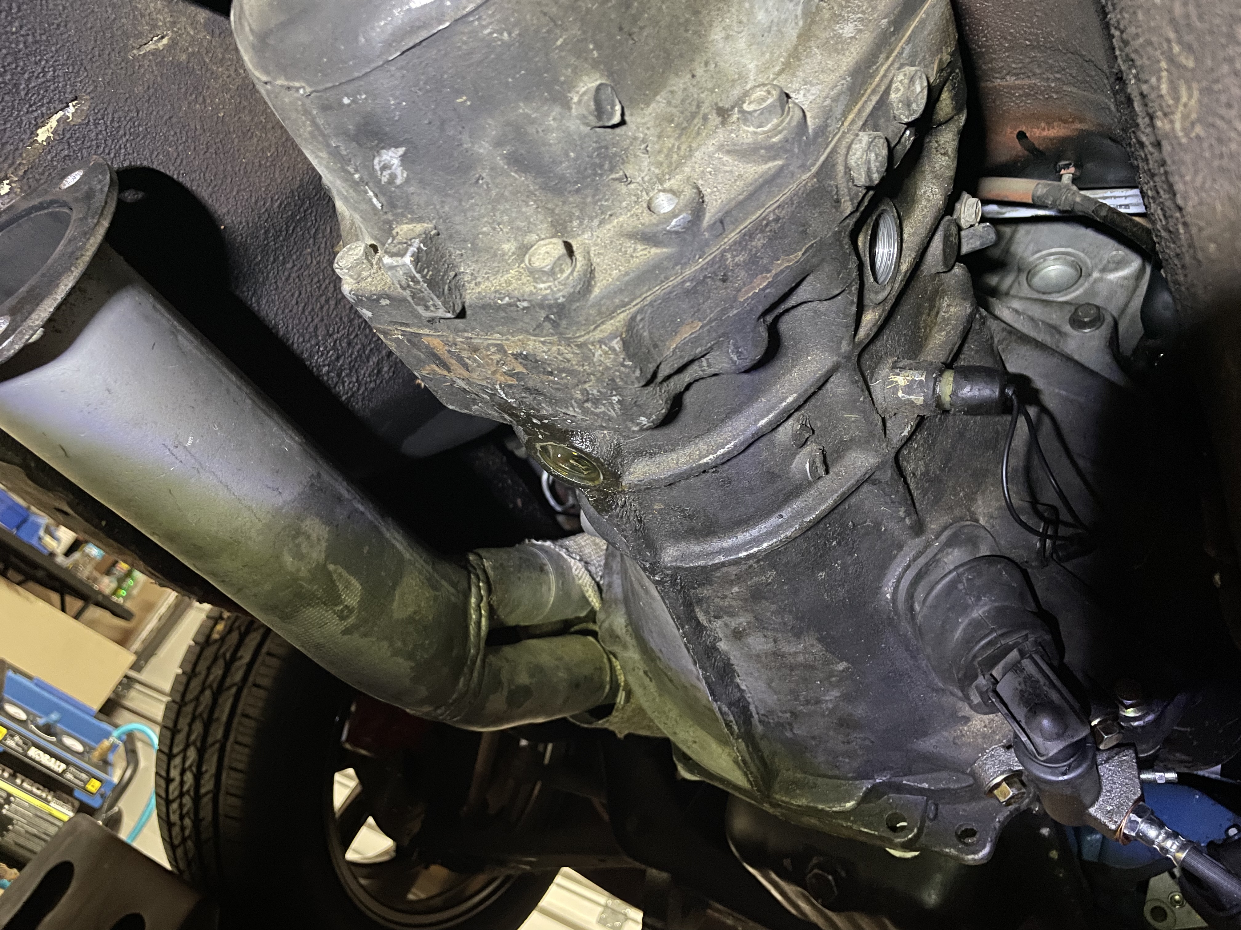

MM569457 Posted March 17, 2023 Author Share #205 Posted March 17, 2023 At the transmission. Link to comment Share on other sites More sharing options...
MM569457 Posted March 17, 2023 Author Share #206 Posted March 17, 2023 At the transmission. Link to comment Share on other sites More sharing options...

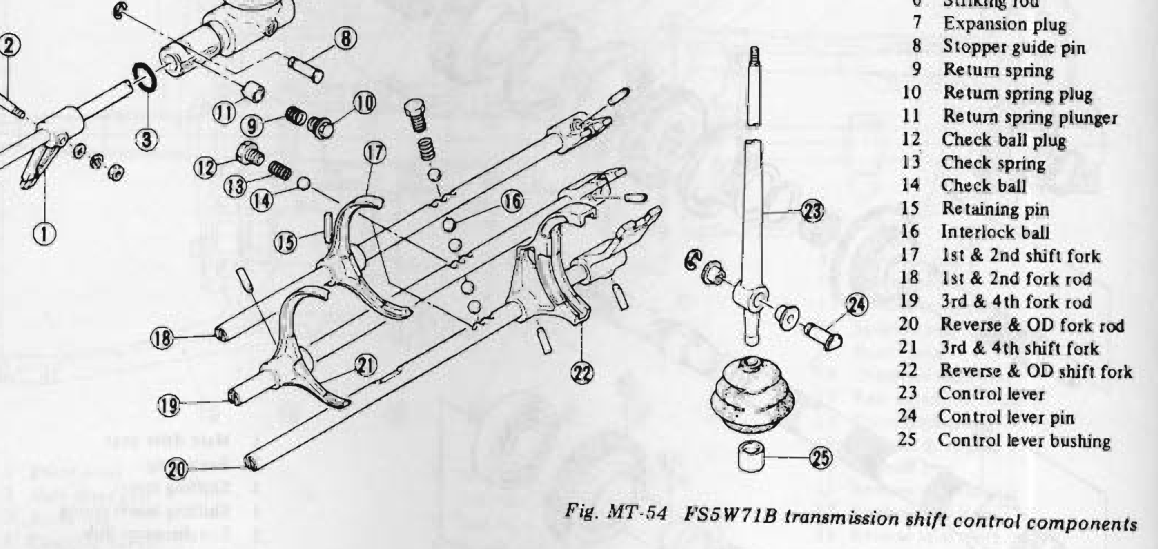

SteveJ Posted March 17, 2023 Share #207 Posted March 17, 2023 There is nothing that would affect polarity at the transmission. Testing: Get the car where you can safely get underneath. Put the transmission in reverse with the engine off. Disconnect the reverse switch from the wiring harness. Use an ohmmeter to make sure there is continuity across the switch with the transmission in reverse. From the voice of experience: @Zed Head helped me figure it out with the reference drawings. 1 2 Link to comment Share on other sites More sharing options...
Zed Head Posted March 17, 2023 Share #208 Posted March 17, 2023 Yes, it's just a simple switch. Somebody had problems fairly recently with a switch that didn't switch. There's a button inside the transmission that rides on the shift rod for reverse and 5th. The rod has a ramped notch cut in to it and the button gets pushed in when the transmission is put in to reverse. It's easy to unscrew and I think it's above the level of the fluid. A meter will tell you if it's good. Or you can just disconnect it, put a meter on it to measure continuity and put the transmission in to reverse. The Nissan draftsmen even drew the notch on to the rod. Part #20. 1 Link to comment Share on other sites More sharing options...

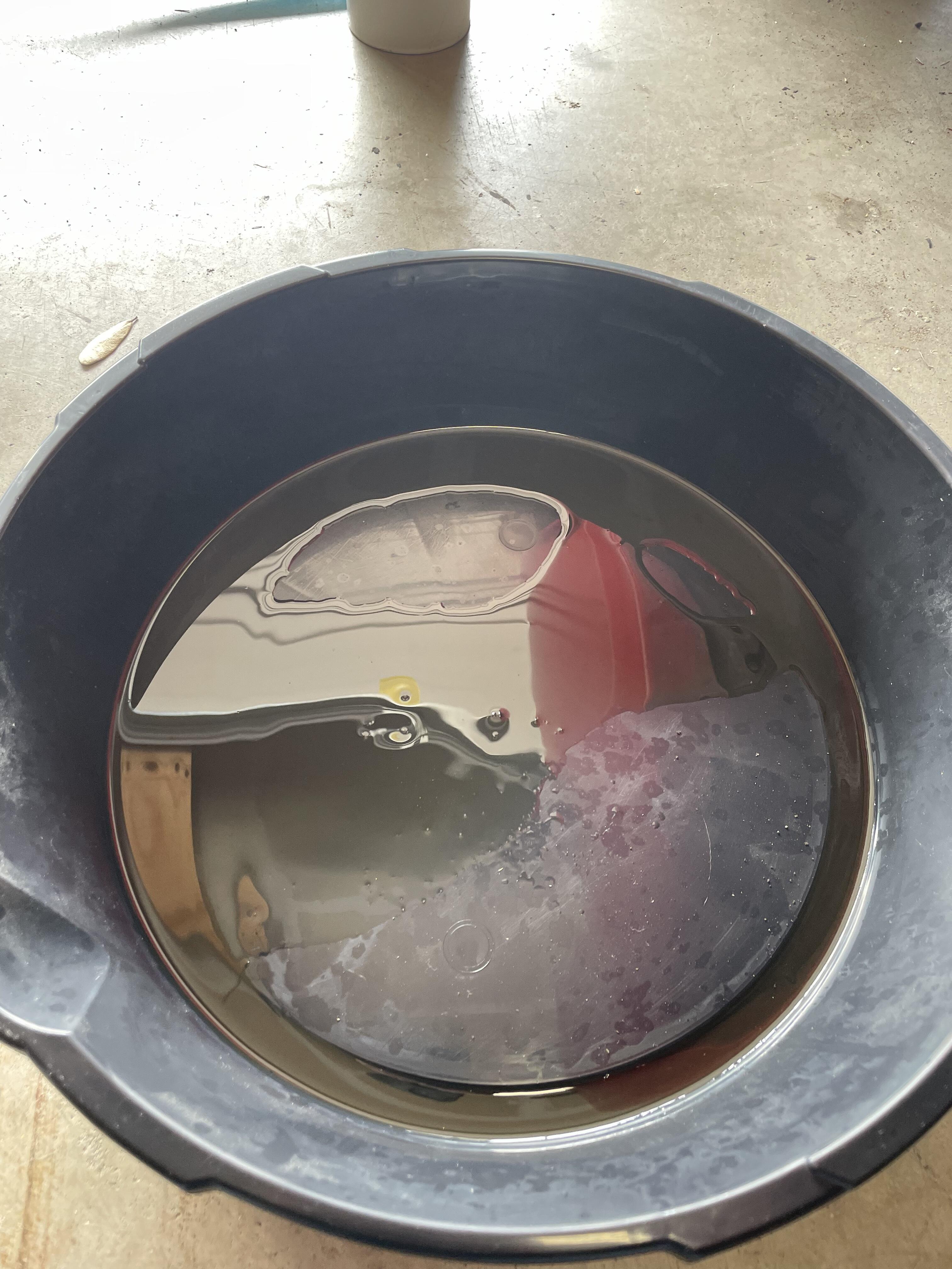

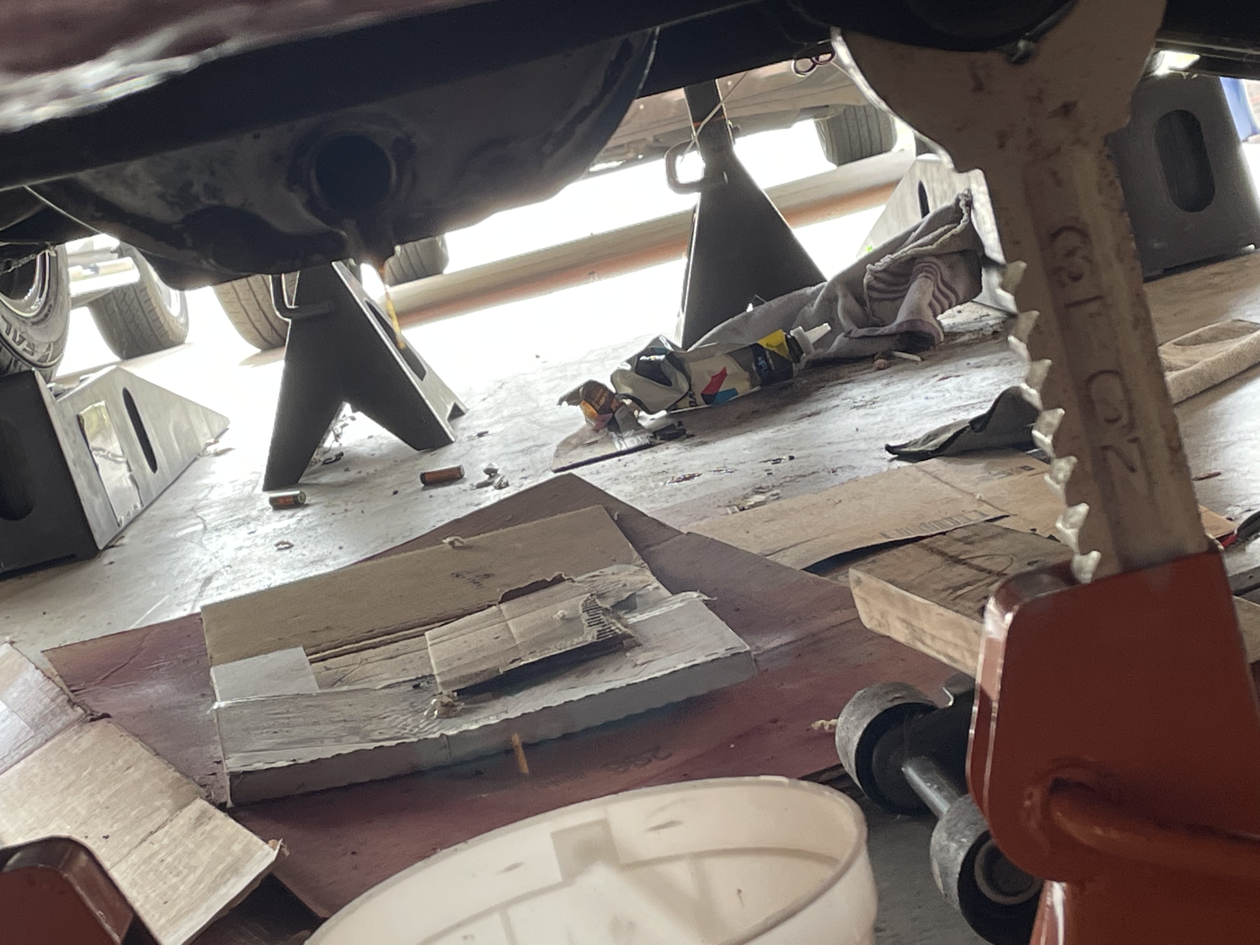

MM569457 Posted March 18, 2023 Author Share #209 Posted March 18, 2023 I’ll get to it. Draining the old gear oil. Virtually dry. Link to comment Share on other sites More sharing options...

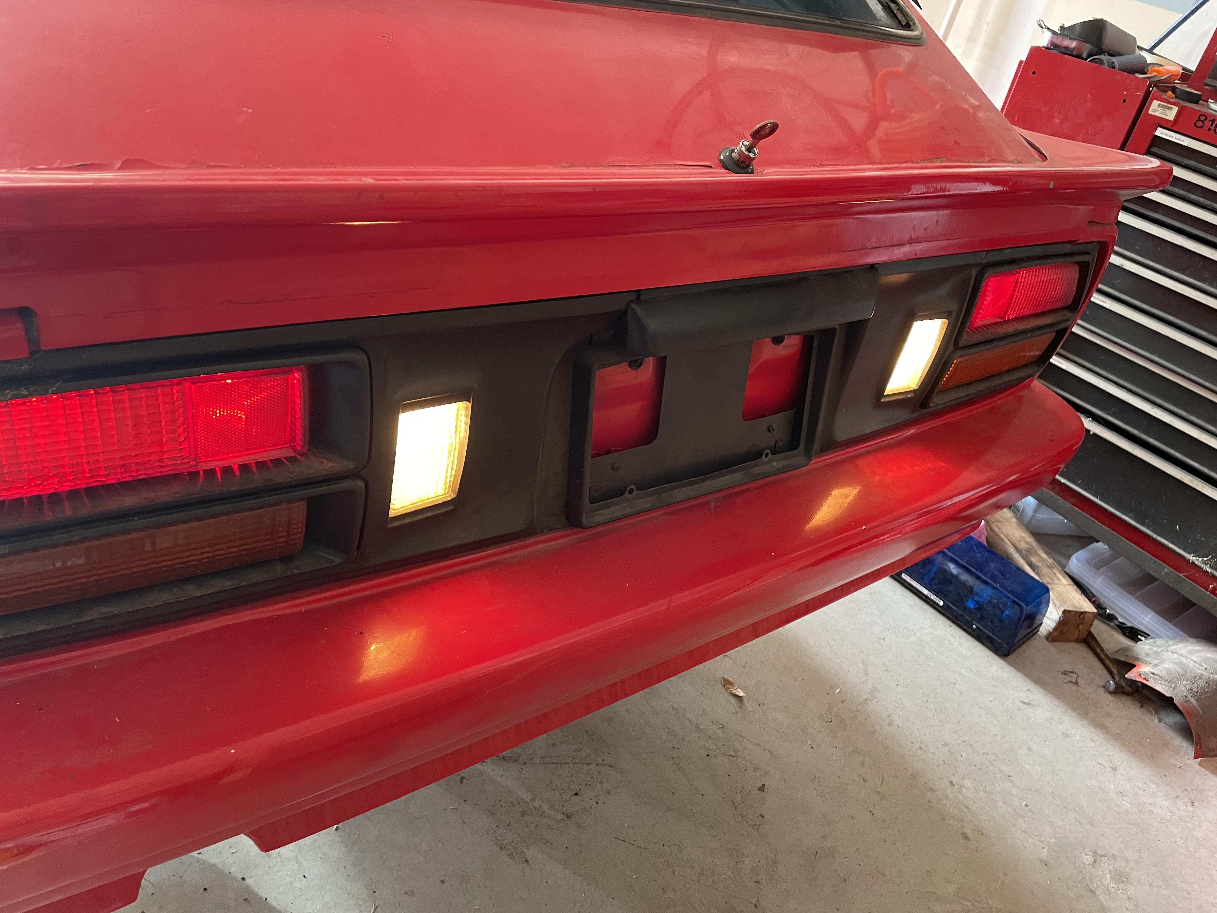

MM569457 Posted March 18, 2023 Author Share #210 Posted March 18, 2023 Thanks for the heads up @Zed Head, luckily I had a simple fix: the wires connecting the the switch under the rubber grommet were disconnected. I have reverse lights now. 2 Link to comment Share on other sites More sharing options...

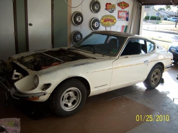

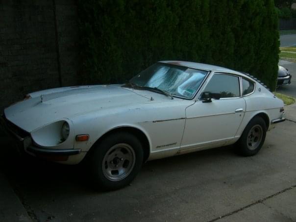

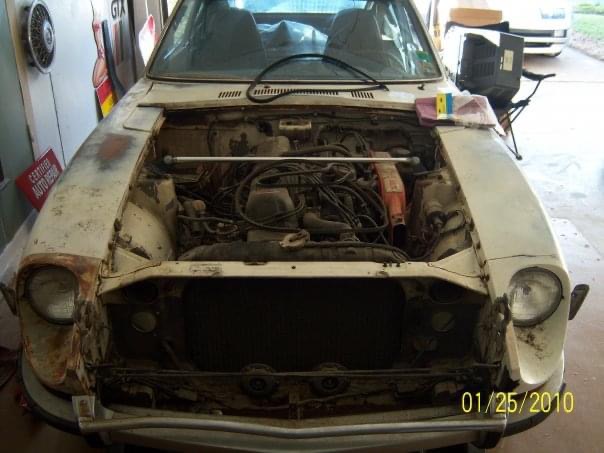

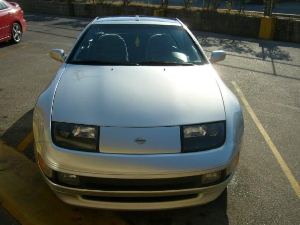

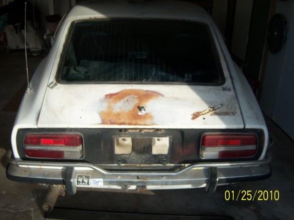

MM569457 Posted March 19, 2023 Author Share #215 Posted March 19, 2023 (edited) So to recap. Dad bought a “71 240Z about the time this 280Z had issues starting up. I figure an ignition relay went bad within the EFI. He daily drove the 240Z until 2004 when the engine was smoking very bad. Dad gave it to me and my intention was to drop the Rebello stroker into it and restore. The car had issues as you can see. Ended up selling it to a friend (all parts I collected for it, was going to go BRE styling, but I kept the Rebello Stroker) who still has it, albeit its now a V8 conversion. When I returned to the states in 2008, I got a 1992 300ZX NA. When everything works as it should, it’s a GREAT ride. But once something goes wrong, it’s not so great. the ZX to me was a mantainence nightmare, but I still loved it. The only reason I sold the car was to finance the 280Z dad finally gave me. Edited March 19, 2023 by MM569457 1 Link to comment Share on other sites More sharing options...
