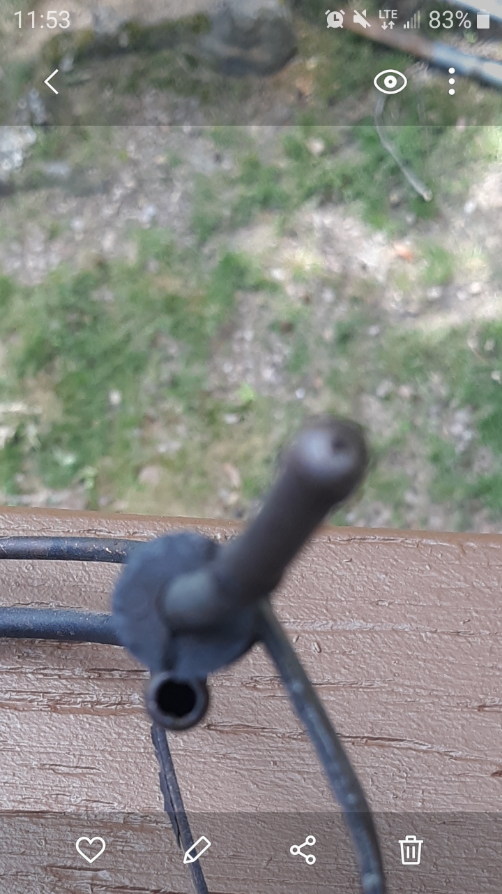

April 23, 20231 yr comment_652921 On 4/9/2023 at 6:01 PM, siteunseen said: Are you using a carb fuel rail, supply and return? That's where the reducer is. Small hole on return keeps it bottled down to 3-ish pounds. I found this early this morning looking for a paint brush. The return is the small hole and as I understand it's the restriction that makes up the fuel pressure for our carbs. Link to comment https://www.classiczcars.com/forums/topic/60341-resurrecting-a-1977-280z/?&page=23#findComment-652921 Share on other sites More sharing options...
