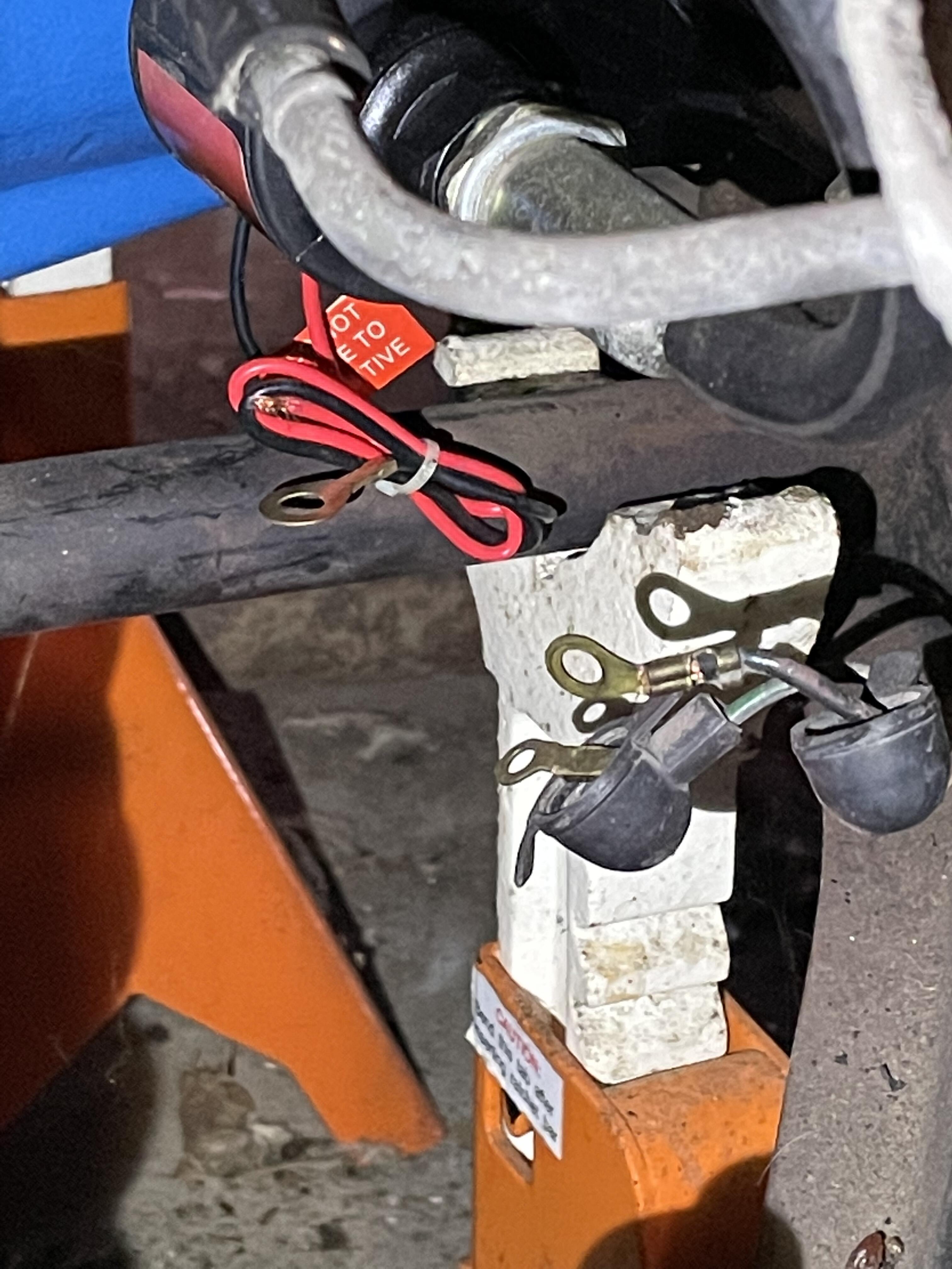

There are only two wires.  One ring is bigger than the other.  Some pumps are set up so that they only fit the right way.  They usually put a + and a - on the terminals.  If you have a meter test the wires first.  Pretty sure green with white stripe is positive.  The black one should be continuous to ground.   Meter.
Replace the rings. Use connectors like this: https://www.amazon.com/Pupilash-Terminal-Insulated-Electric-Connector/dp/B08T5P9Y2N
For the green wire in the harness use a female connector and a male connector on the red wire on the pump.
Use a male connector on the black wire in the harness and a female connector on the black wire on the pump.
Put some dielectric grease on both male connectors.
To crimp the connectors, I recommend a ratcheting crimper like this: https://www.amazon.com/Klein-Tools-Ratcheting-Crimper-10-22/dp/B07WMB61J5/
