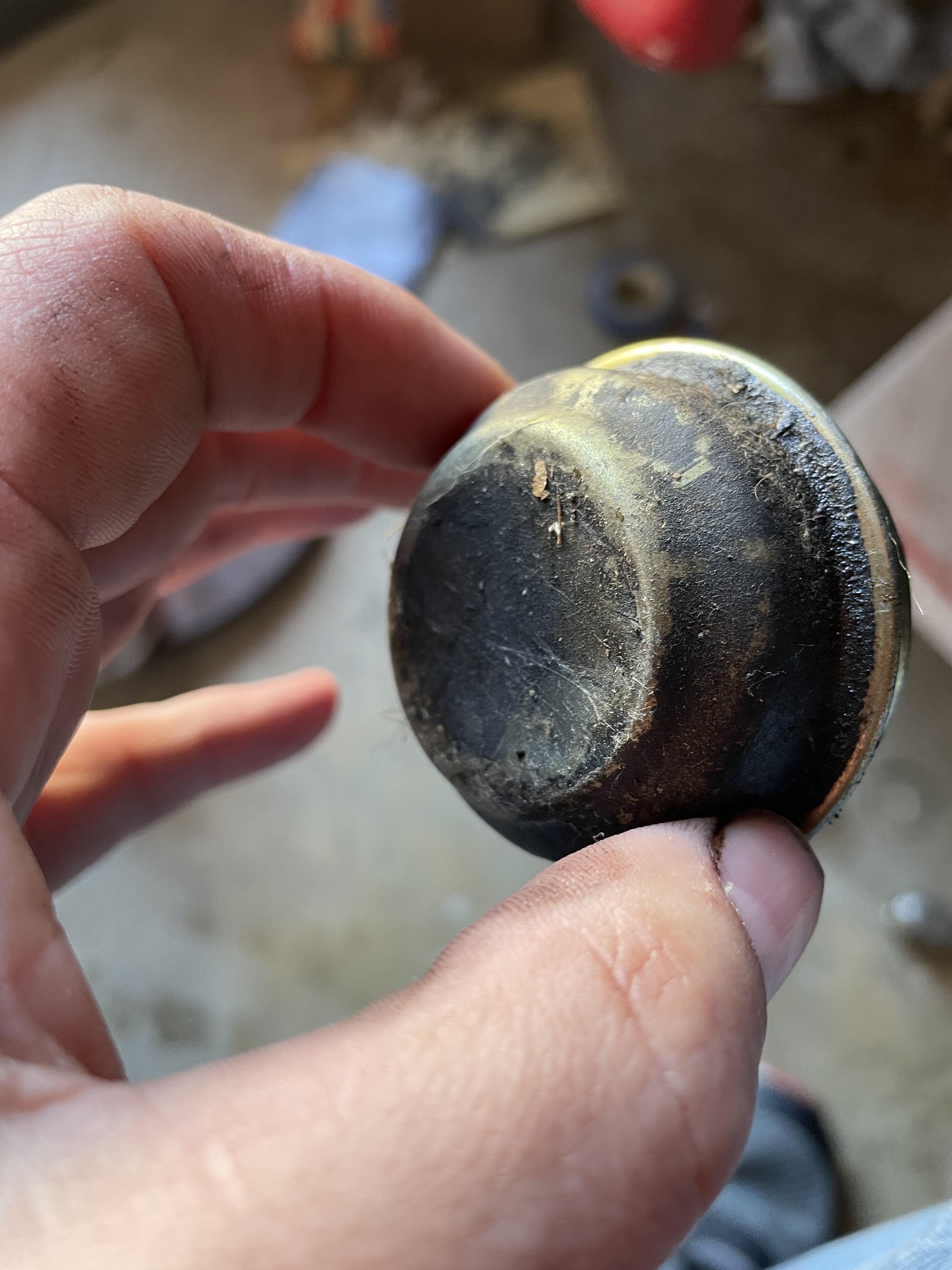

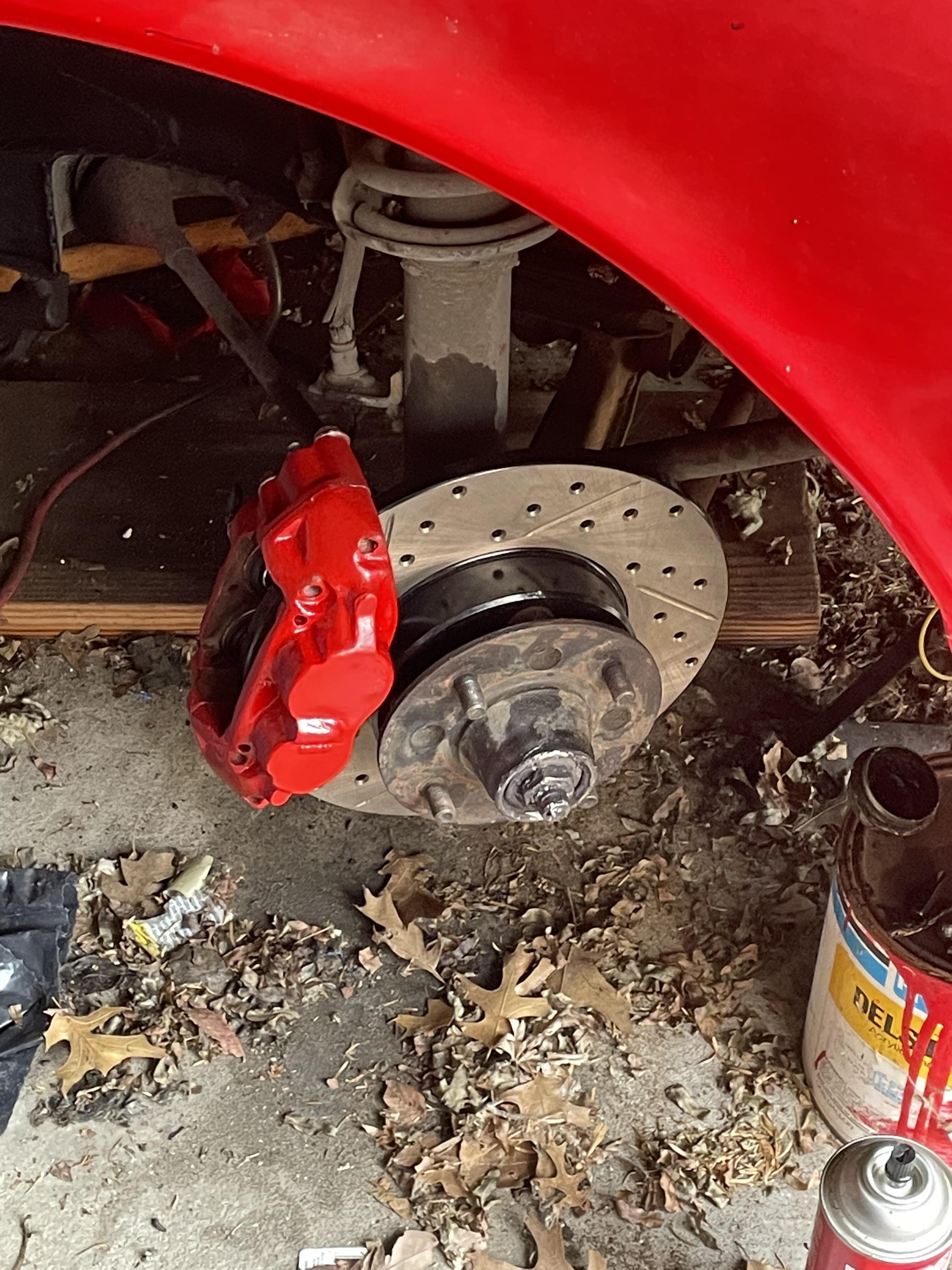

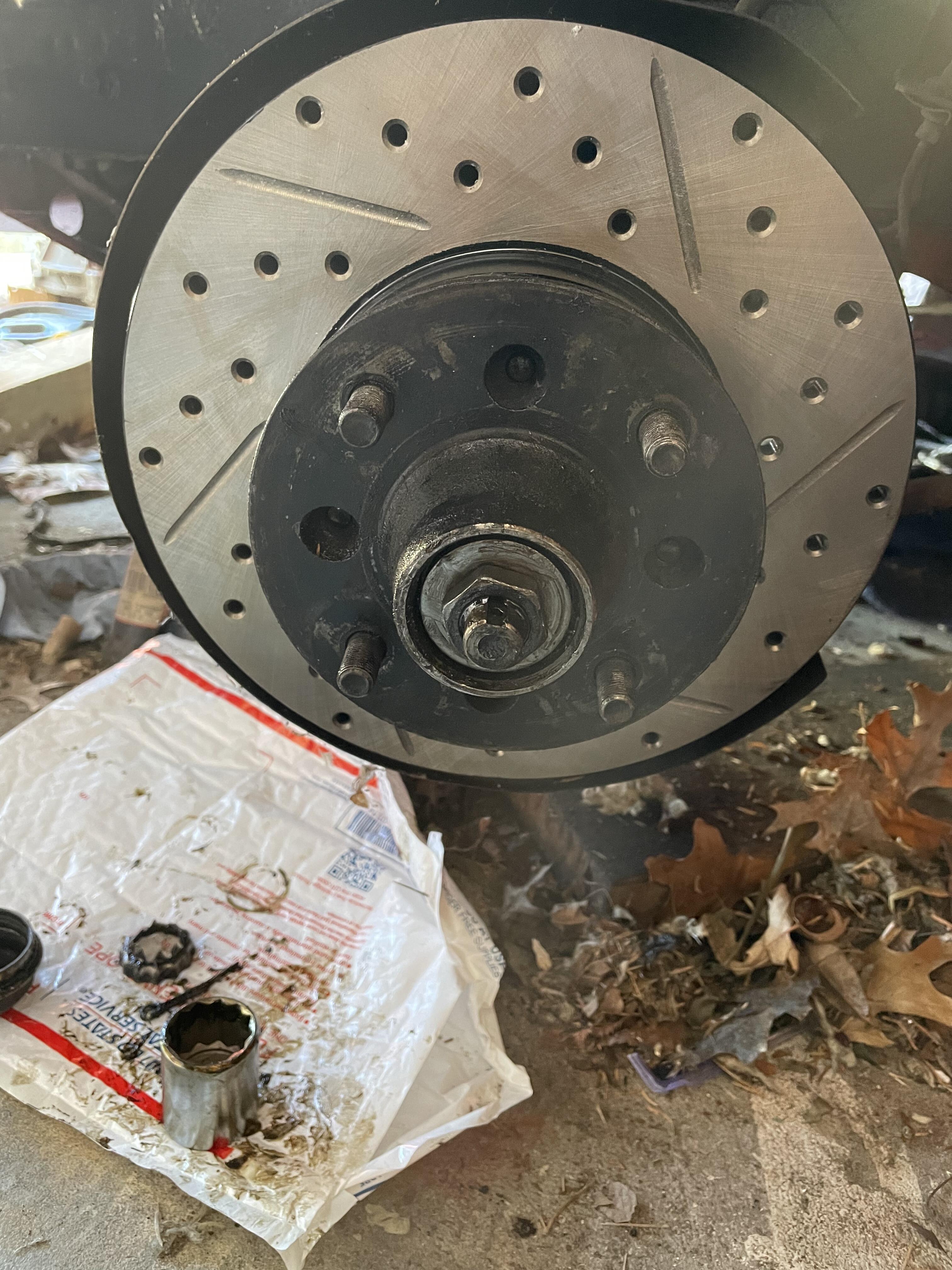

February 6, 20223 yr Author comment_635507 Had some warmer weather. Swapped out the driver-side rotor. With Konig rewinds they say the bearing cover needs to be shaved down a quarter inch…. Does this cap look like it’s already been done? Edited February 6, 20223 yr by MM569457 Link to comment https://www.classiczcars.com/forums/topic/60341-resurrecting-a-1977-280z/?&page=8#findComment-635507 Share on other sites More sharing options...
February 6, 20223 yr comment_635508 How would you shave stamped steel? Looks like a normal cap. Link to comment https://www.classiczcars.com/forums/topic/60341-resurrecting-a-1977-280z/?&page=8#findComment-635508 Share on other sites More sharing options...
February 6, 20223 yr Author comment_635509 From the Z-store: Note that as with all Konig Rewind wheels that we offer, the center caps are slightly too short for the front bearing caps. To run these Konig center caps in the front of your early Z-Car, the small, metal factory bearing caps must be flattened slightly (less than 1/4 of an inch) to allow room for the Konig center cap. i mispoke, not shaved. They do already seem flattened. Not sure if mine are normal or not Link to comment https://www.classiczcars.com/forums/topic/60341-resurrecting-a-1977-280z/?&page=8#findComment-635509 Share on other sites More sharing options...

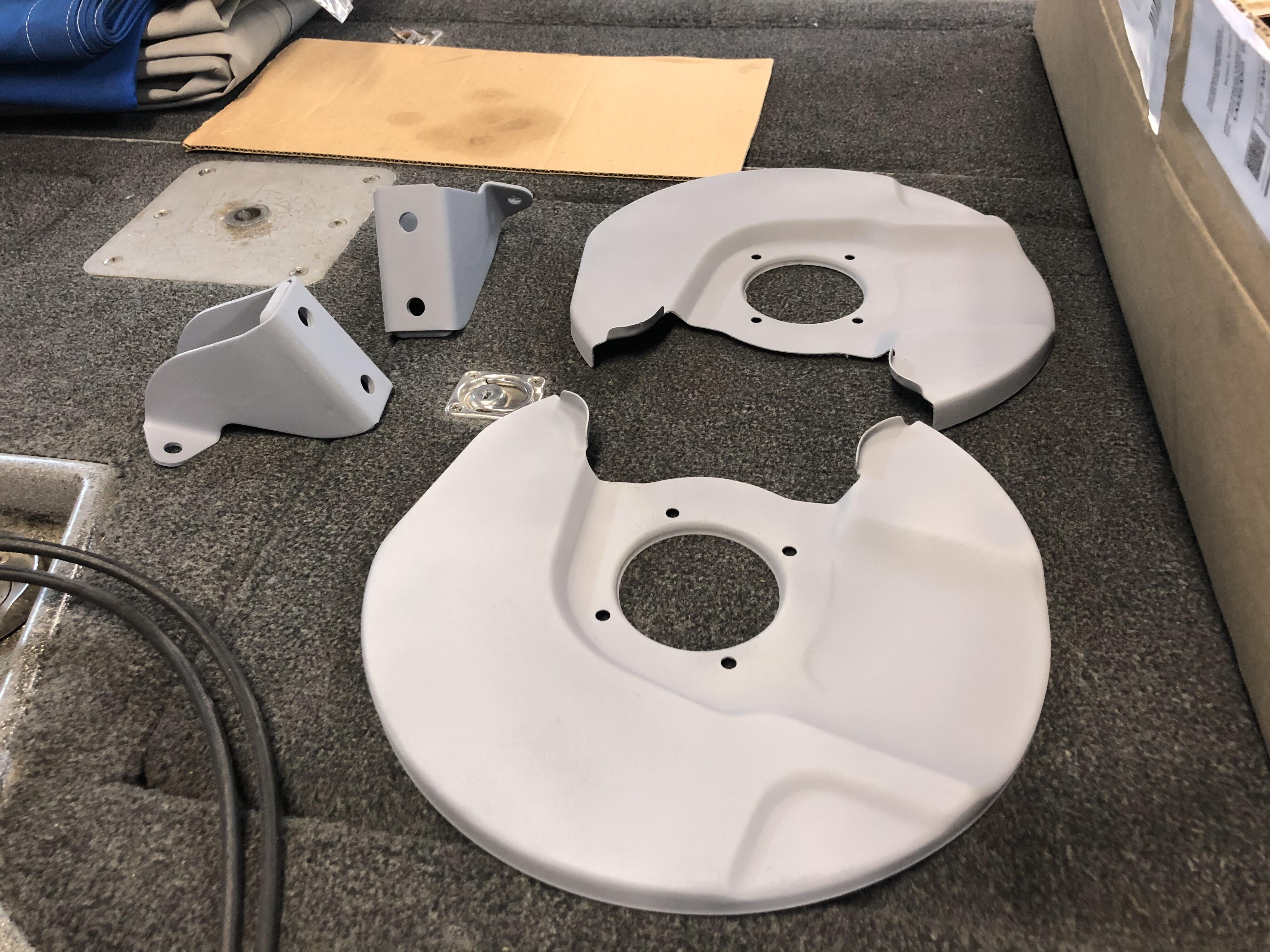

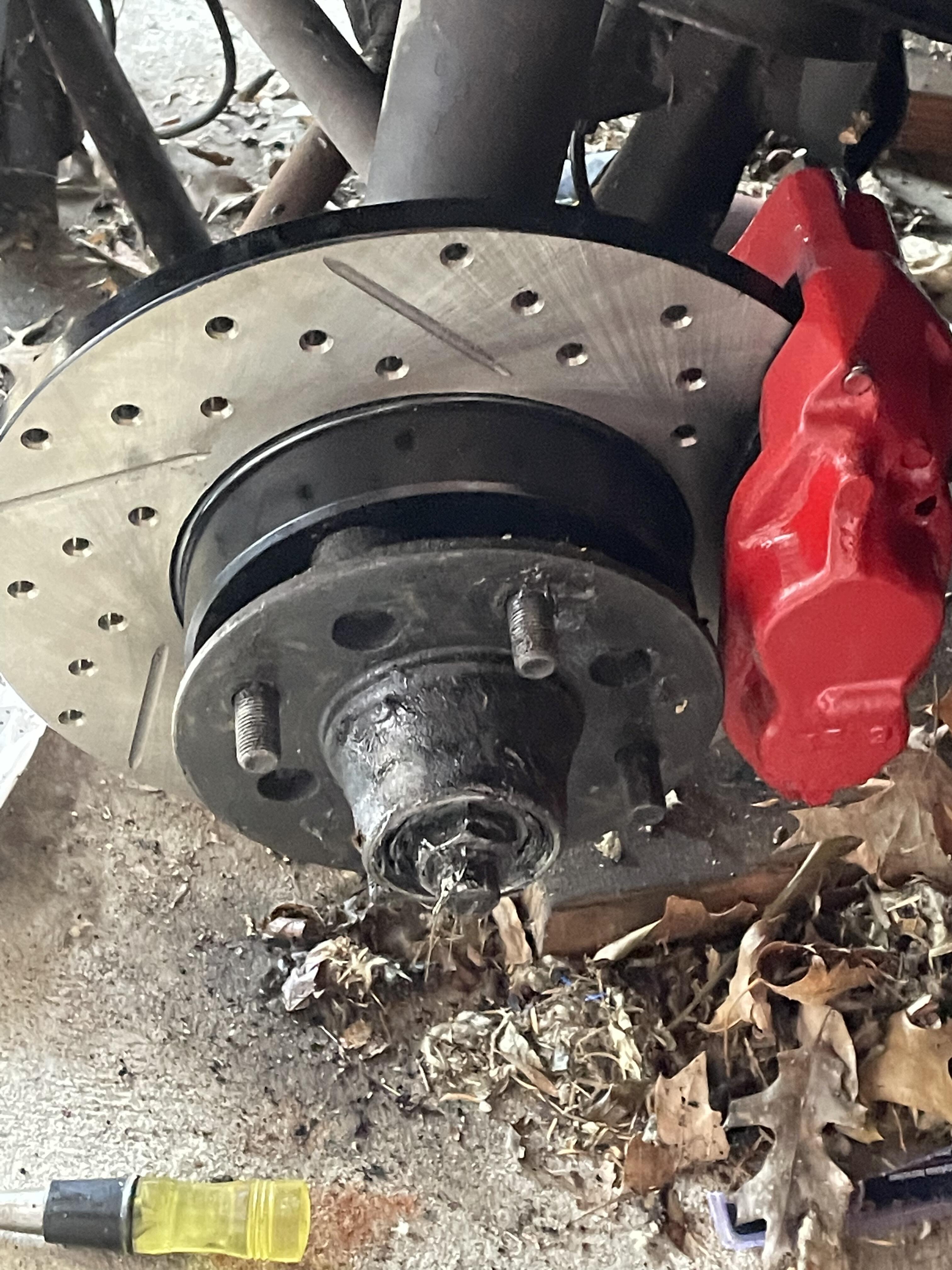

February 12, 20223 yr Author comment_635782 I tried to install the S12+8 calipers after in installed the new rotors and backed the bearings. they don’t fit, it seems the backing plate is too small to allow the calipers to fit. should I just cut them down to allow the calipers to fit? Link to comment https://www.classiczcars.com/forums/topic/60341-resurrecting-a-1977-280z/?&page=8#findComment-635782 Share on other sites More sharing options...
February 12, 20223 yr comment_635783 Do you mean the "baffle plate"? Link to comment https://www.classiczcars.com/forums/topic/60341-resurrecting-a-1977-280z/?&page=8#findComment-635783 Share on other sites More sharing options...
February 12, 20223 yr comment_635784 Yes you have to notch them here are before and after pics. Link to comment https://www.classiczcars.com/forums/topic/60341-resurrecting-a-1977-280z/?&page=8#findComment-635784 Share on other sites More sharing options...
February 12, 20223 yr Author comment_635785 Thanks! I threw down penetrating oil on the bolts. I’ll wait a few days. I’ll probably remove them, put the brakes on and reinstall them after they’ve been trimmed later down the road. Link to comment https://www.classiczcars.com/forums/topic/60341-resurrecting-a-1977-280z/?&page=8#findComment-635785 Share on other sites More sharing options...

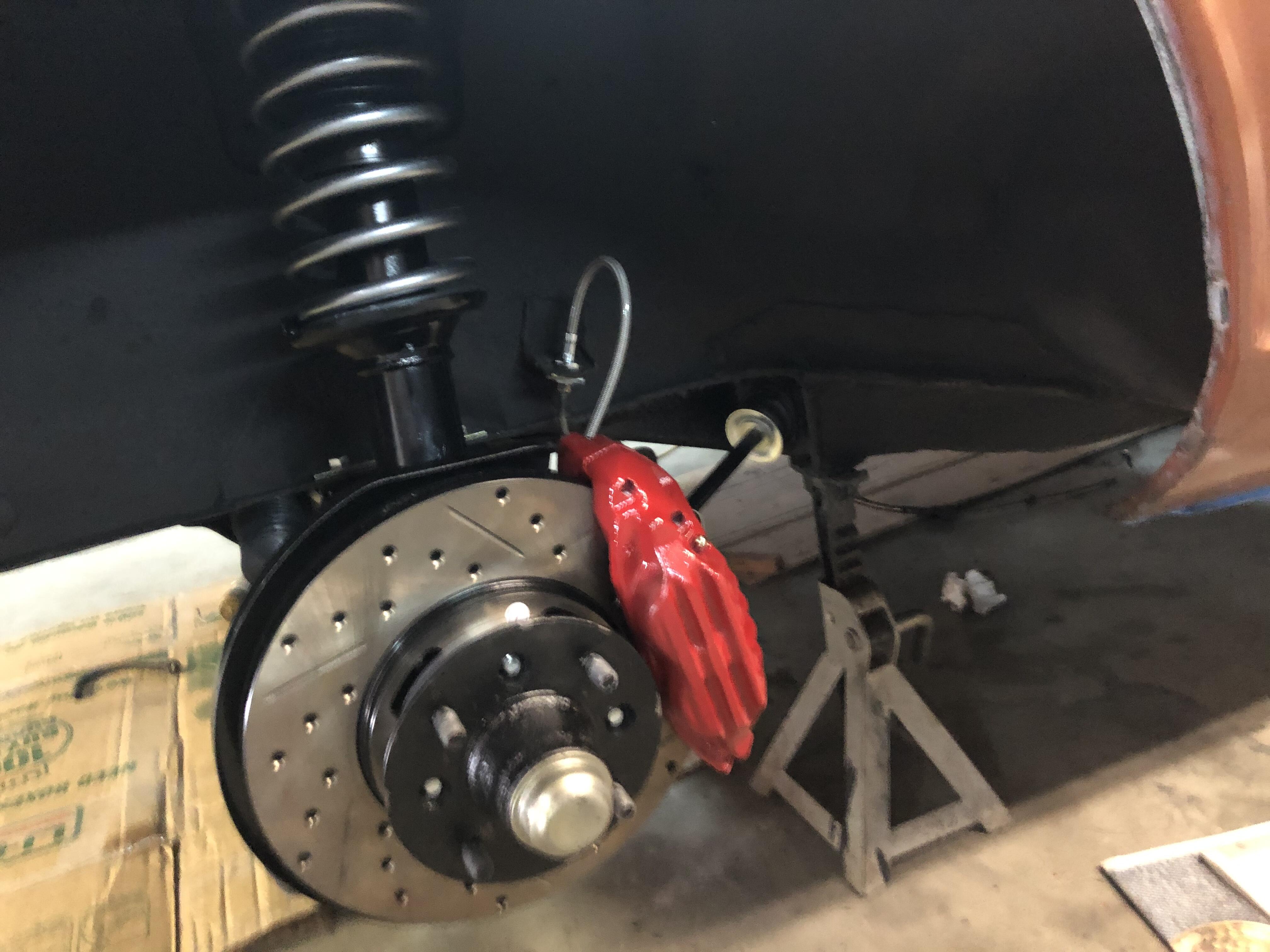

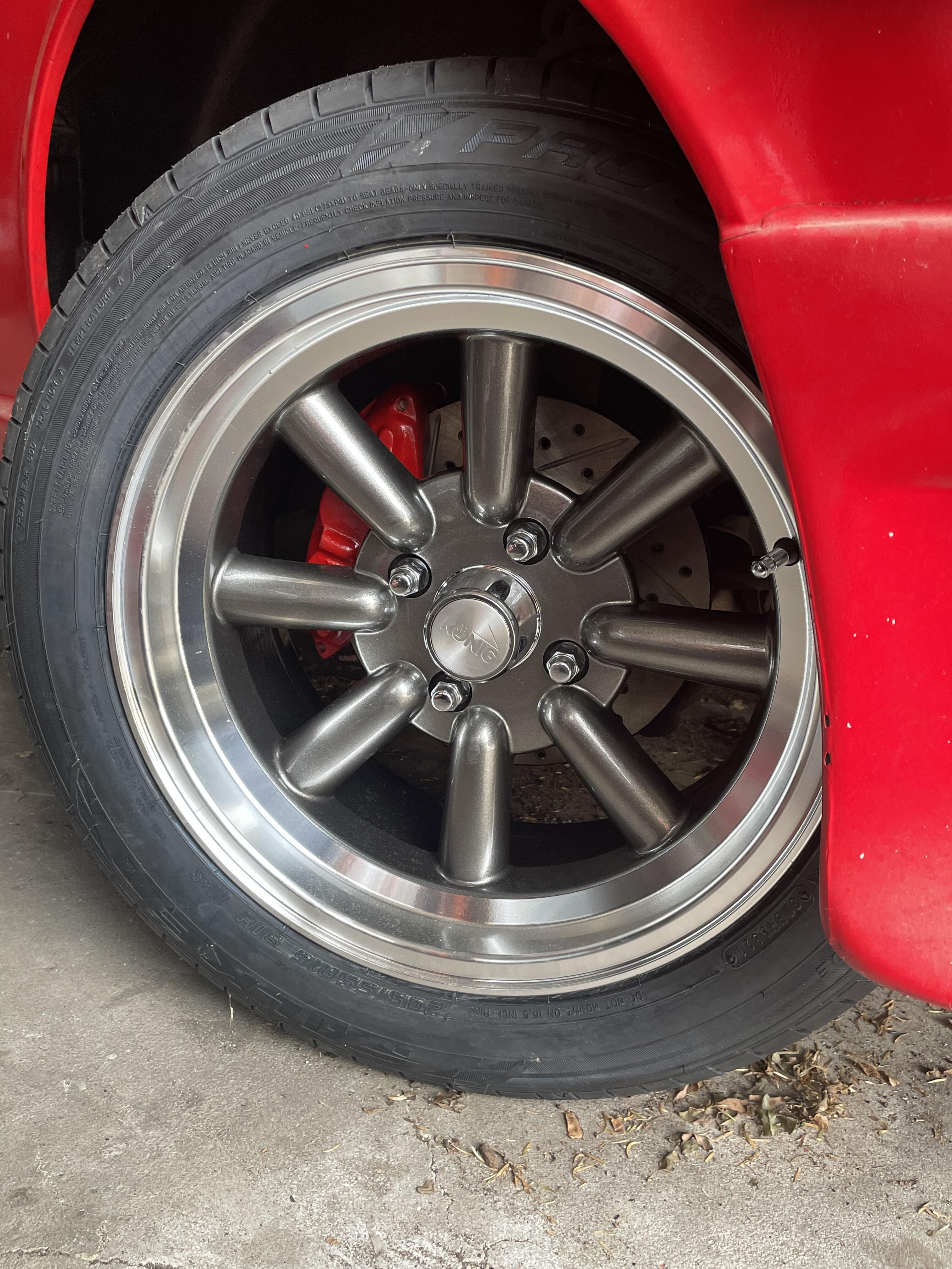

February 20, 20223 yr Author comment_636163 Took the baffle plates off to cut down and reinstall later and installed the front wheels. The dust caps were hammered down to make room for the previous American racing wheels. It’s good to move to my house next weekend weather permitting. Link to comment https://www.classiczcars.com/forums/topic/60341-resurrecting-a-1977-280z/?&page=8#findComment-636163 Share on other sites More sharing options...
