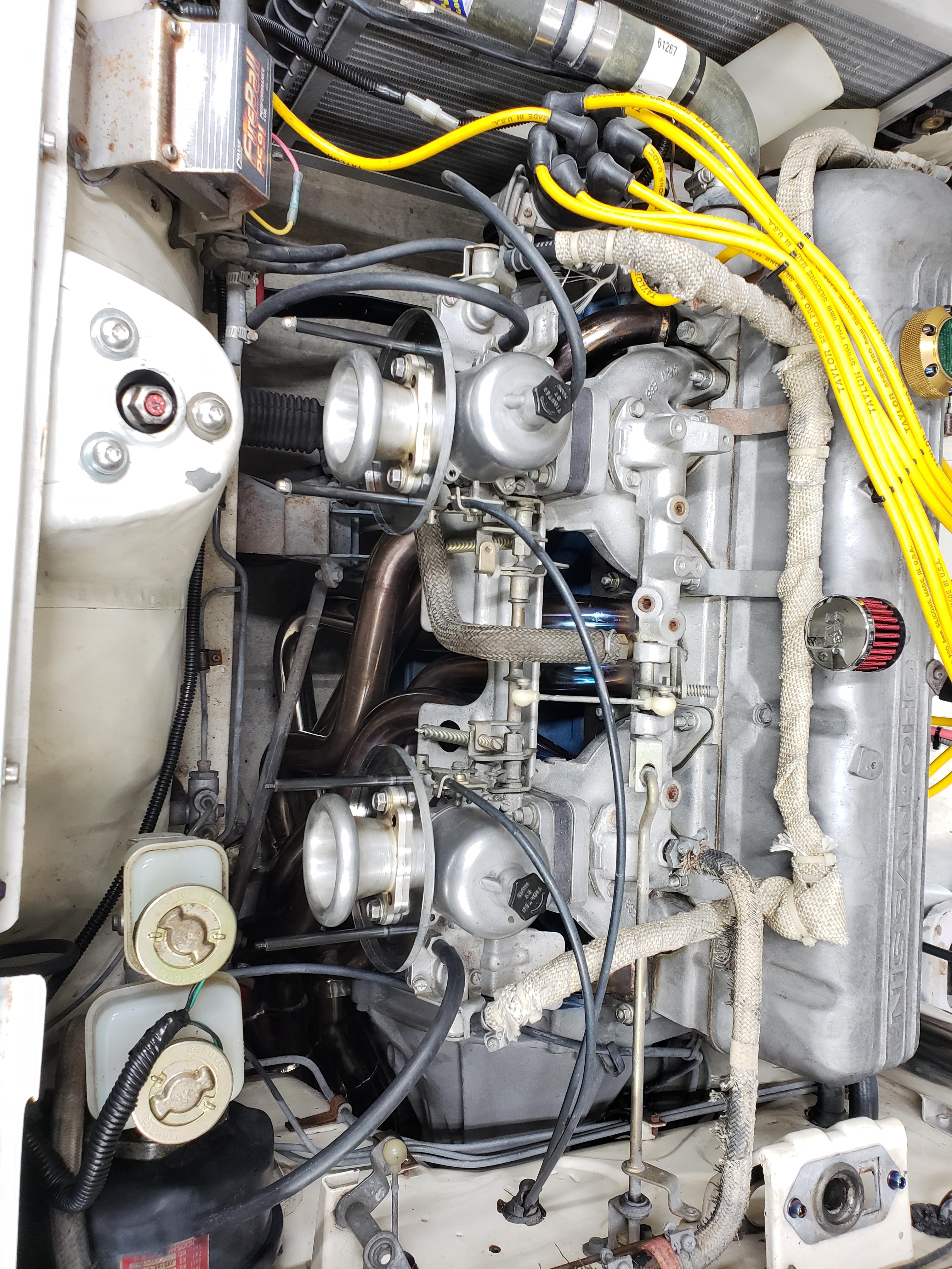

The Z has an electric fuel pump installed. Zstory header and exhaust. Su round tops with k&n filters.
Could the su need rejet? Clean out? Am I thinking right with the fuel system? And is there anything I should be looking for or at whole under the car?

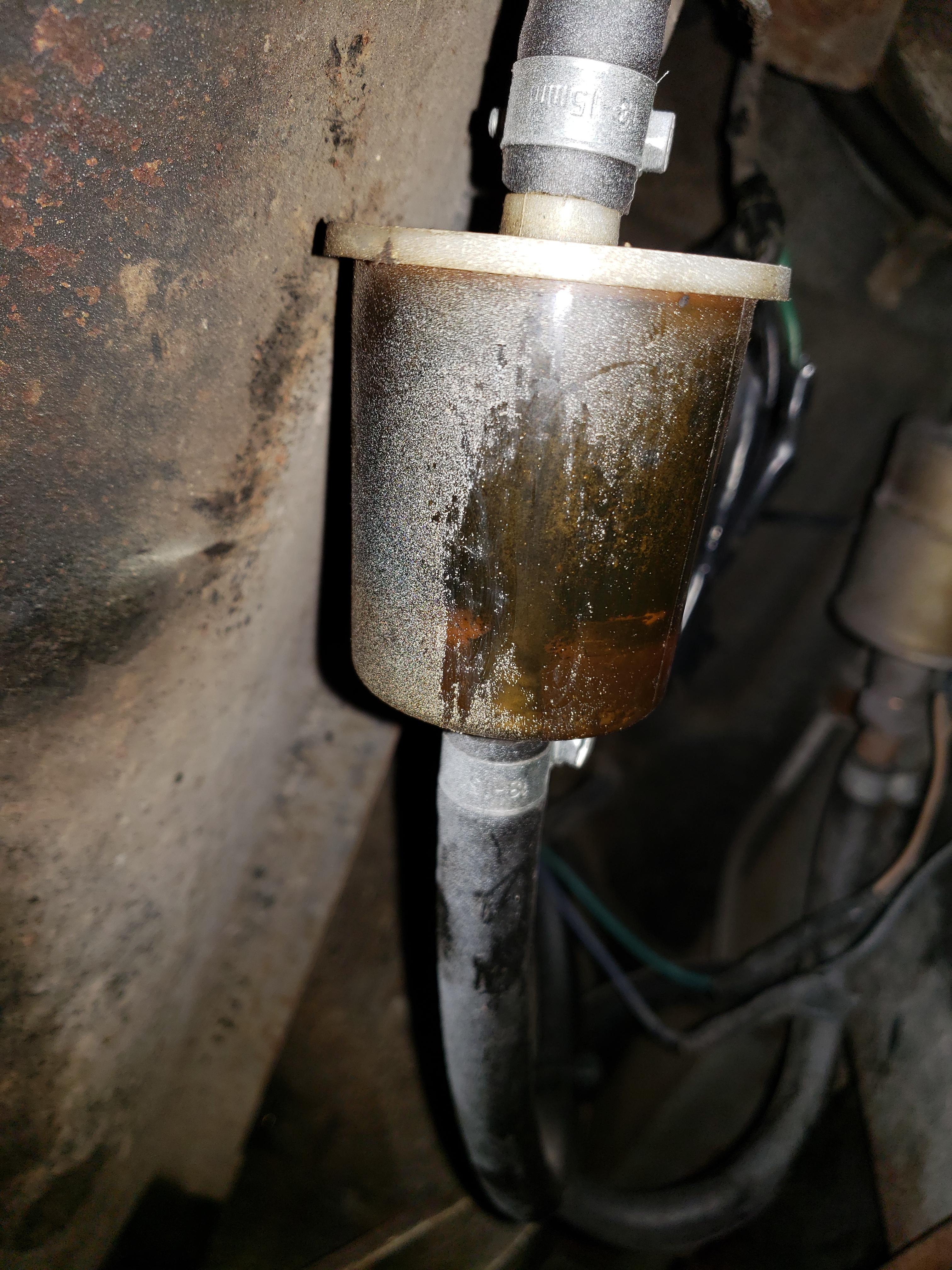

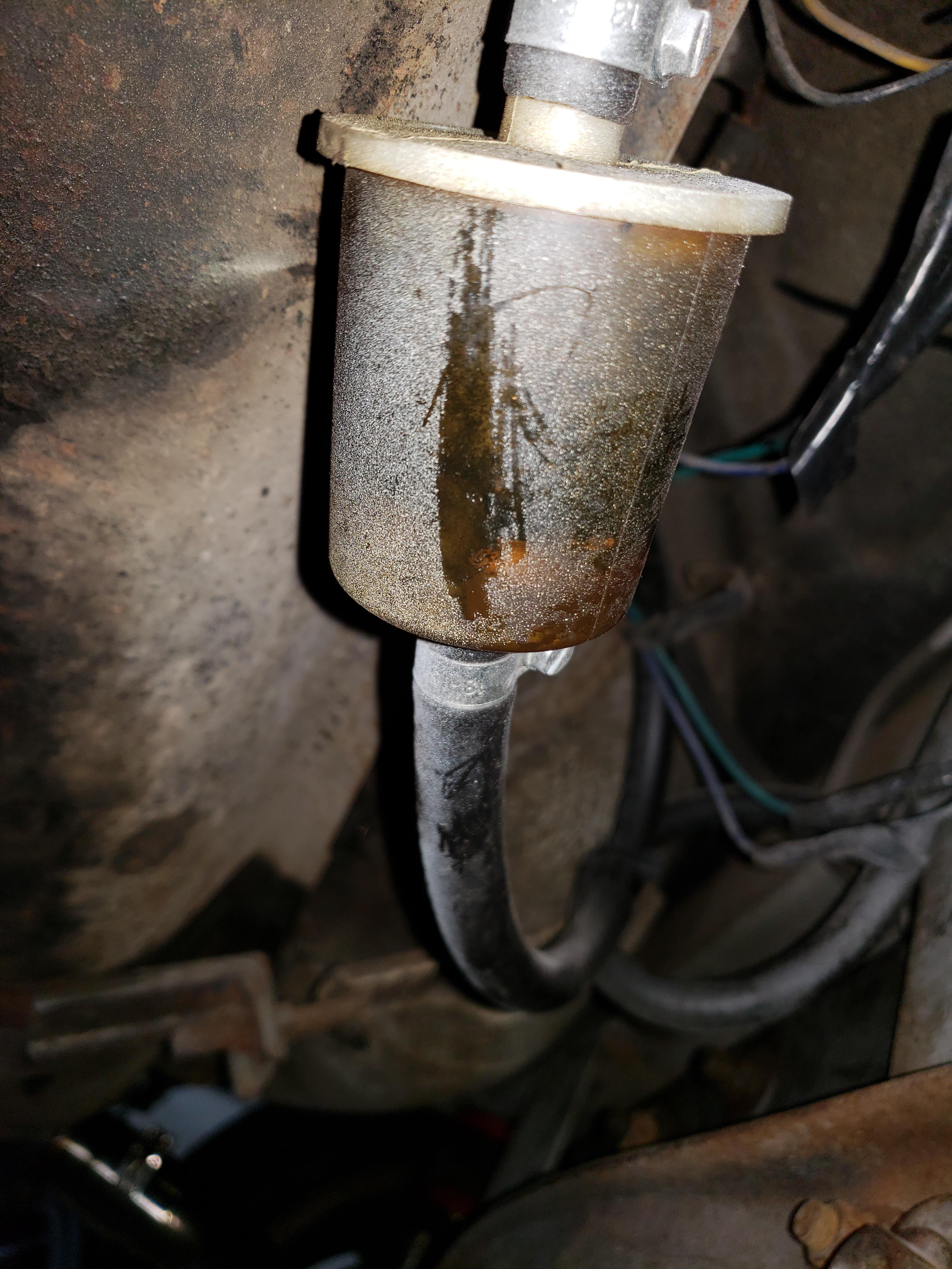

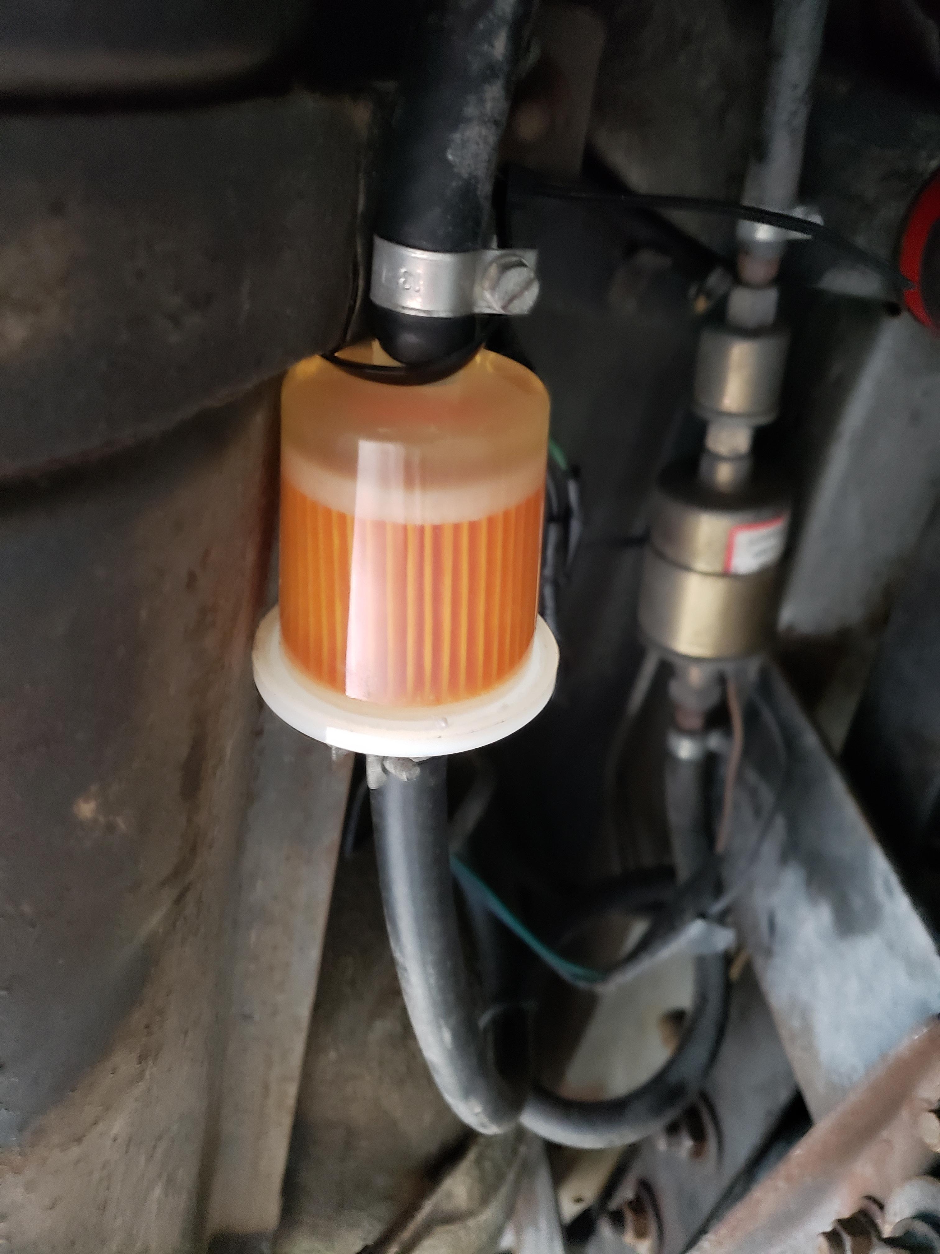

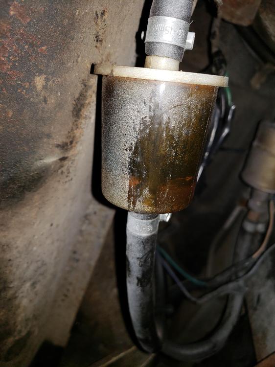

That filter looks NASTY! I would agree with your suspicion that there is junk in the tank.

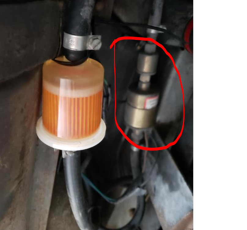

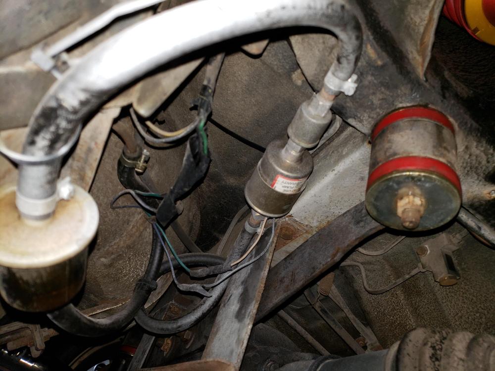

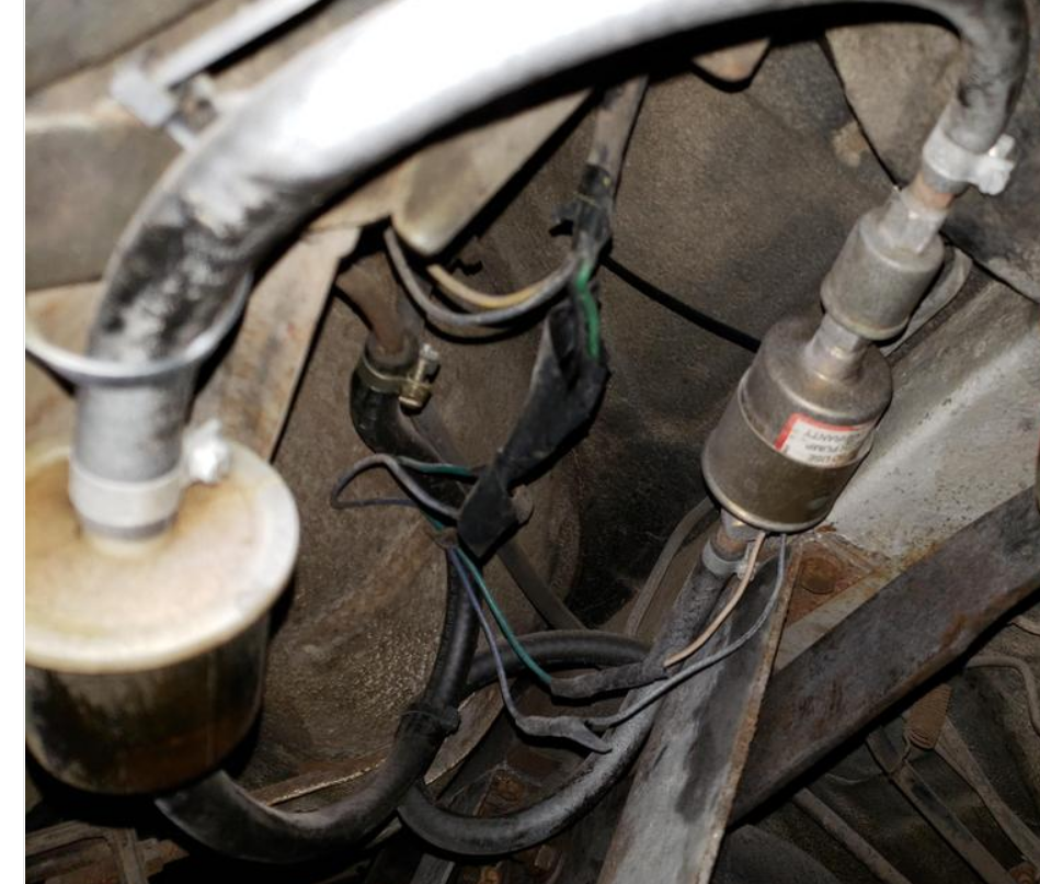

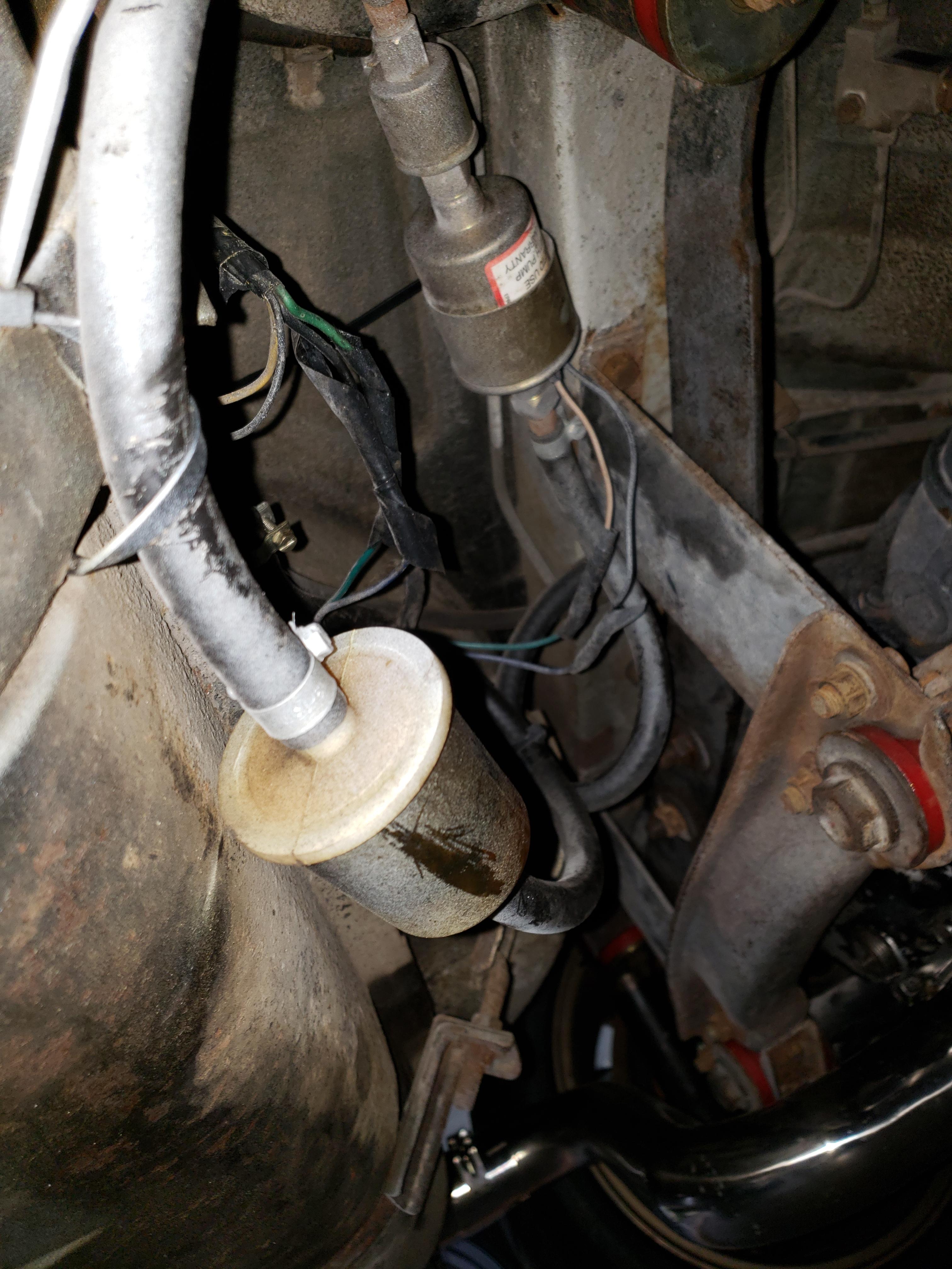

To add to and follow SteveJ's comment, replace those filters.  With just one.  Each filter adds a pressure drop, even when clean.  Pretty sure I see three in serial.  That's a lot of work for the fuel pump.
Replace that fuel filter, and at the barb of where the hose from
The fuel rail goes into the float bowl, there’s a filter located inside the barb, I would take those out and make sure they are clean as well if the issue persists after that filter change.
people forget about those filters and they get nasty over 40 plus years. ?
It's the one that goes over the bolt, "internal gas filter" below.  I took mine out when I rebuilt the carbs.  I installed one of those glass filters right before the mechanical pump.  It stays nice and full now that I have the floats adjusted correctly.
Image result for 240z banjo bolt classiczcars.com

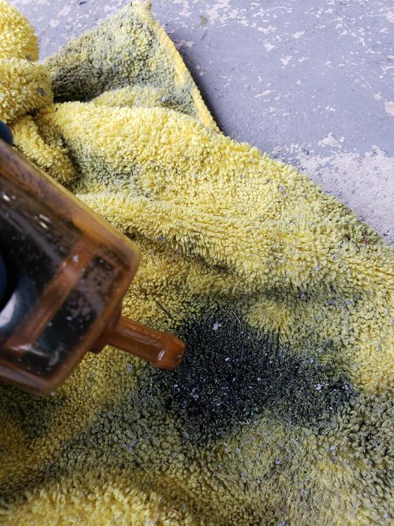

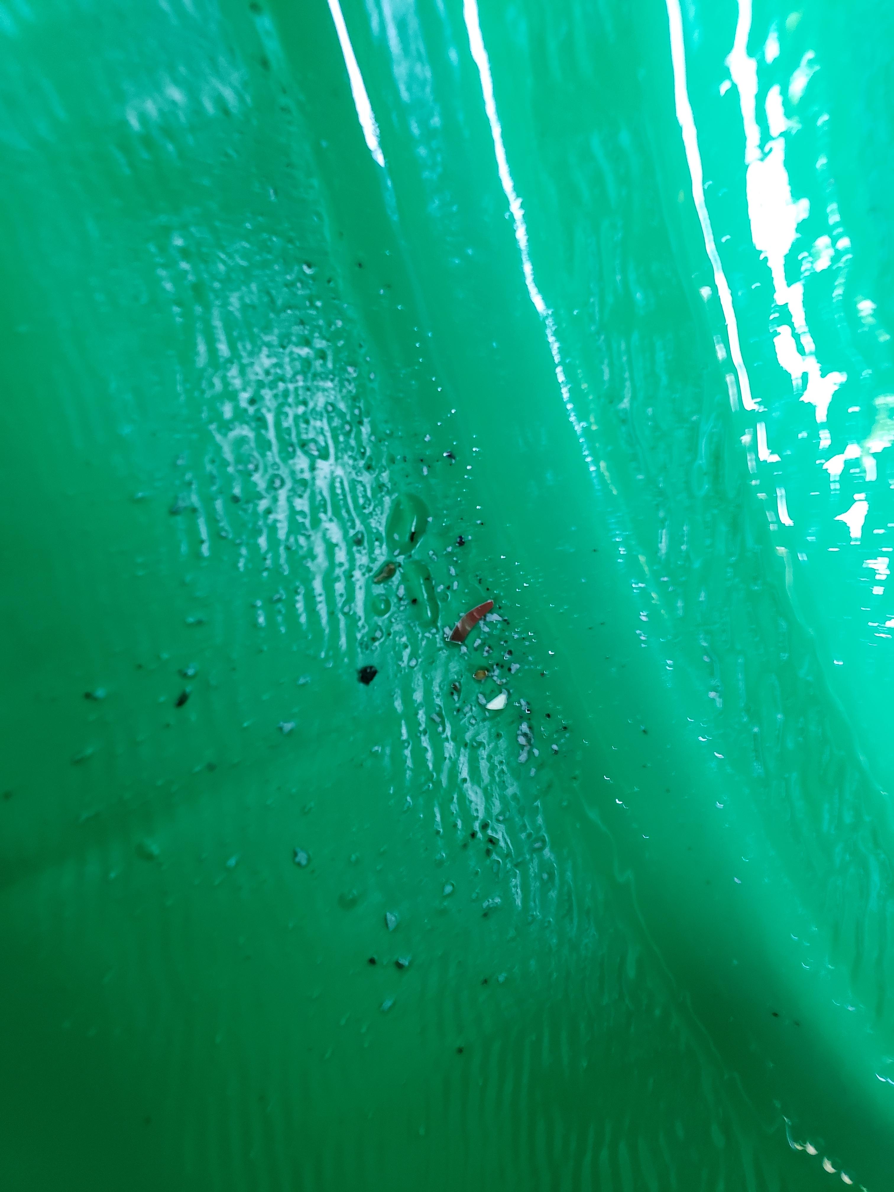

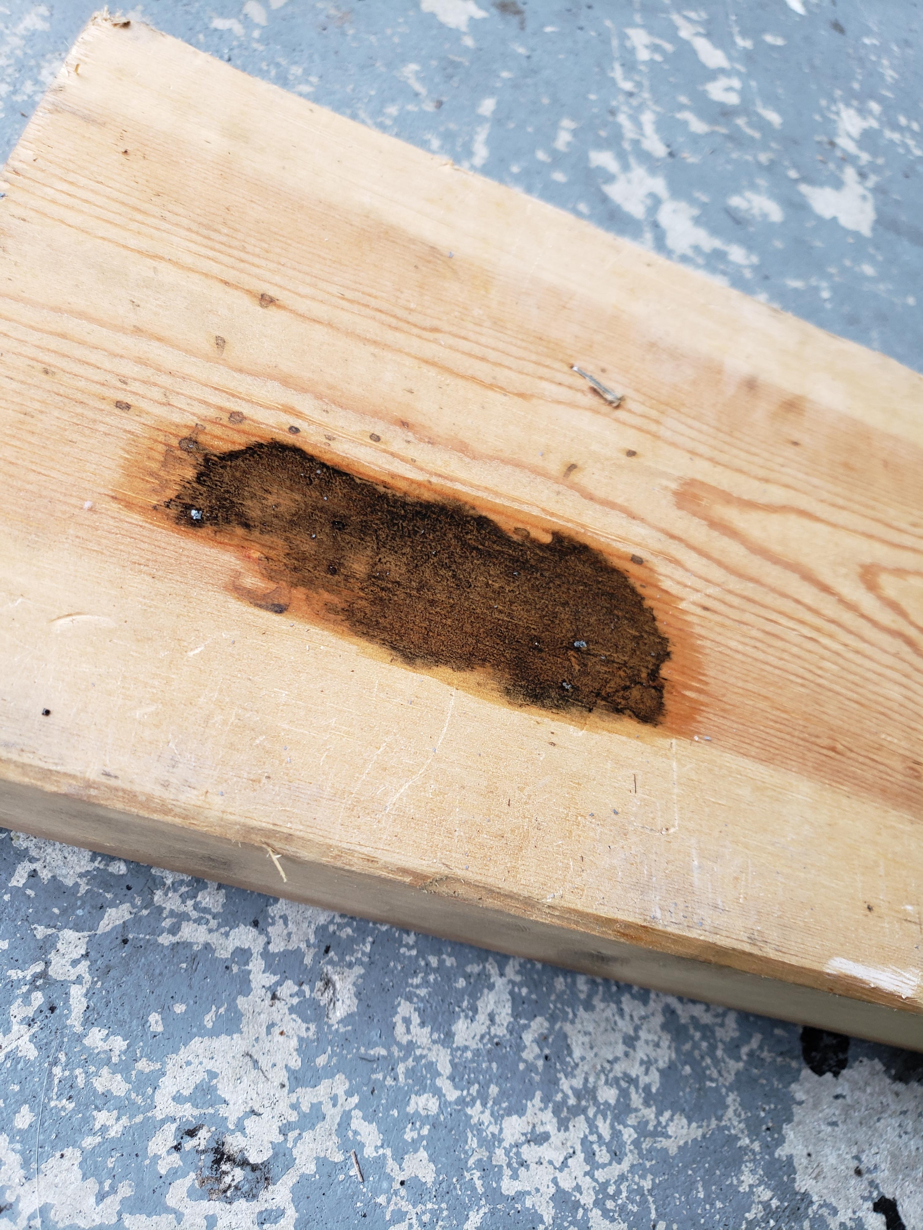

Replaced the filter tonight. Drained some gas and the tank looks ro be clean. It does has some particles. Sand like. The old filter was FULL of soot doing its job. I purchased a new fuel pump as well. Plan on changing that if nothing changes with this simple fix.

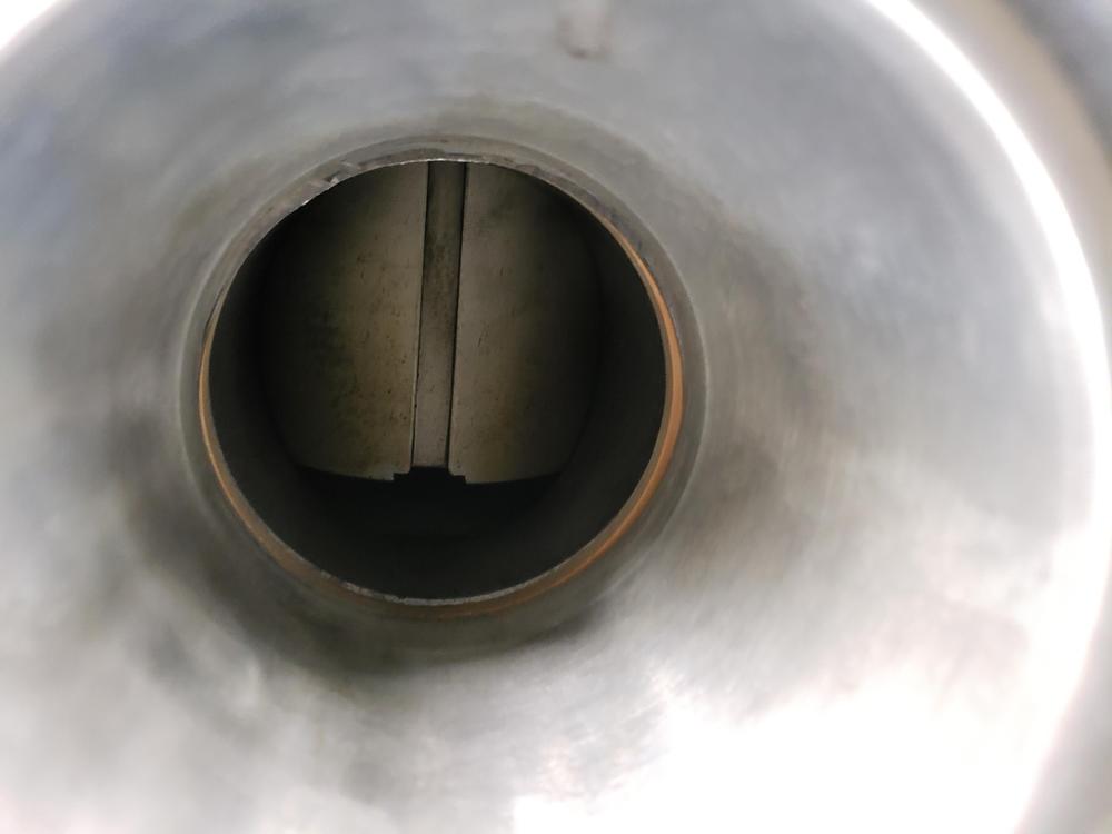

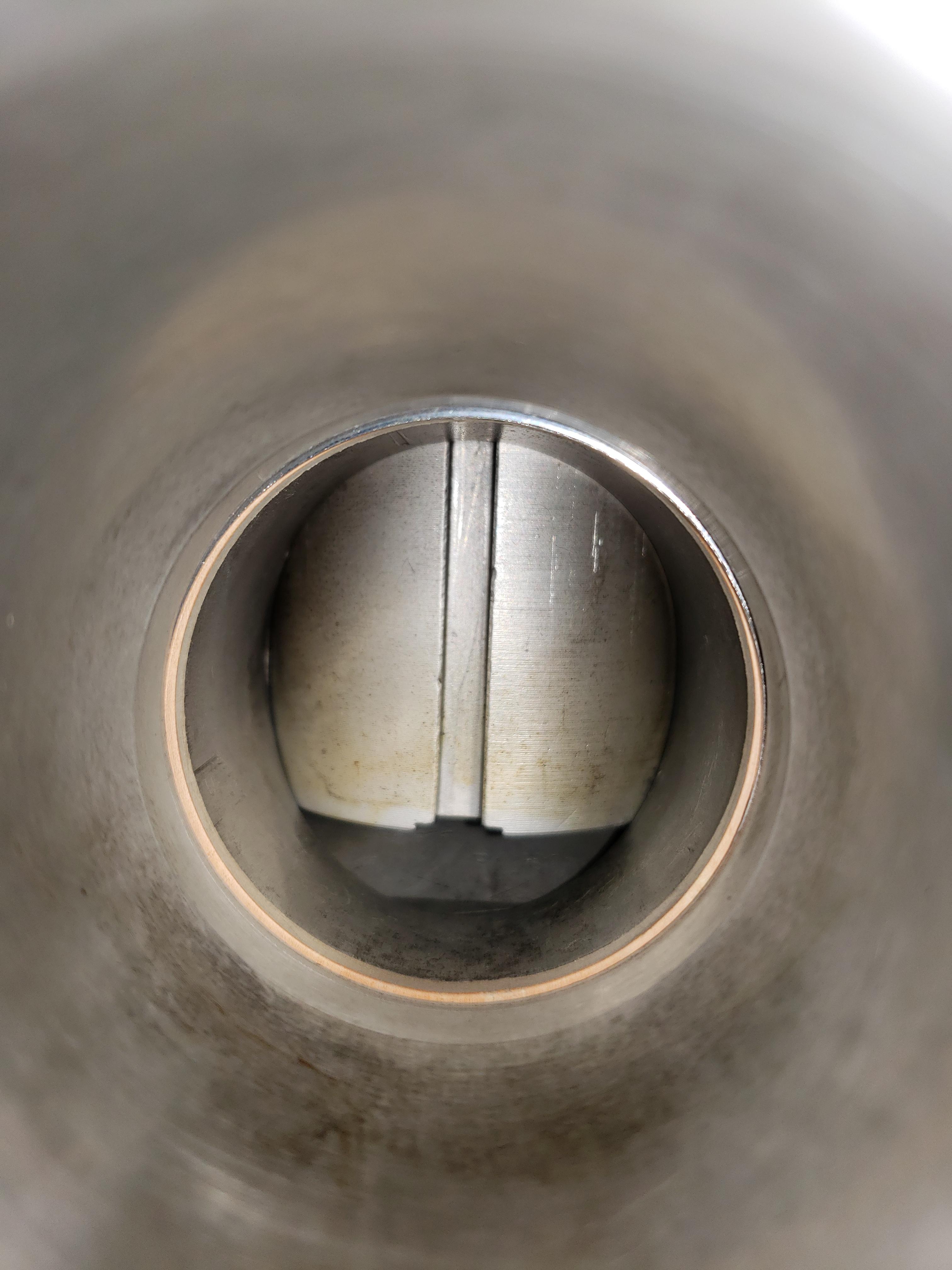

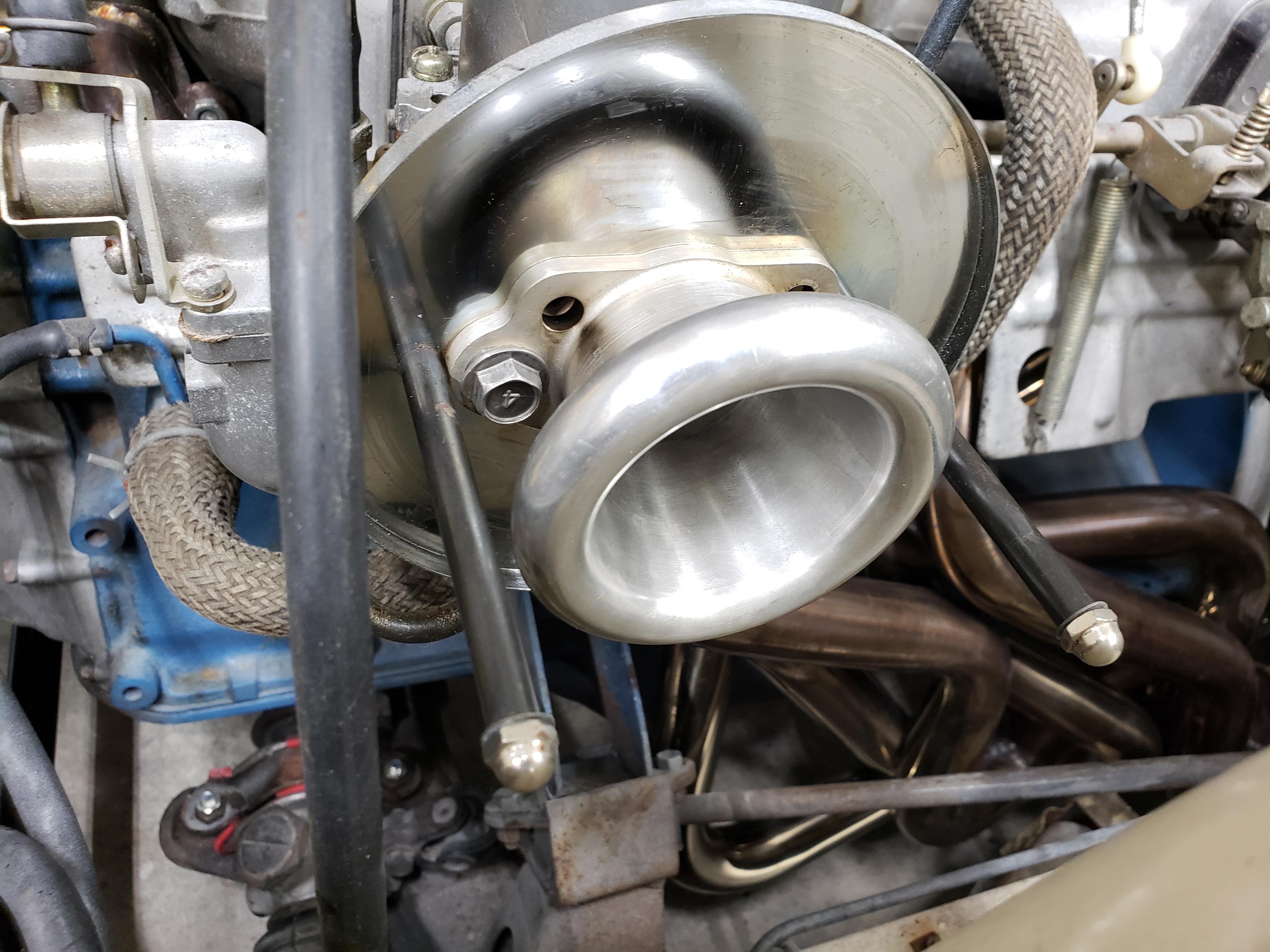

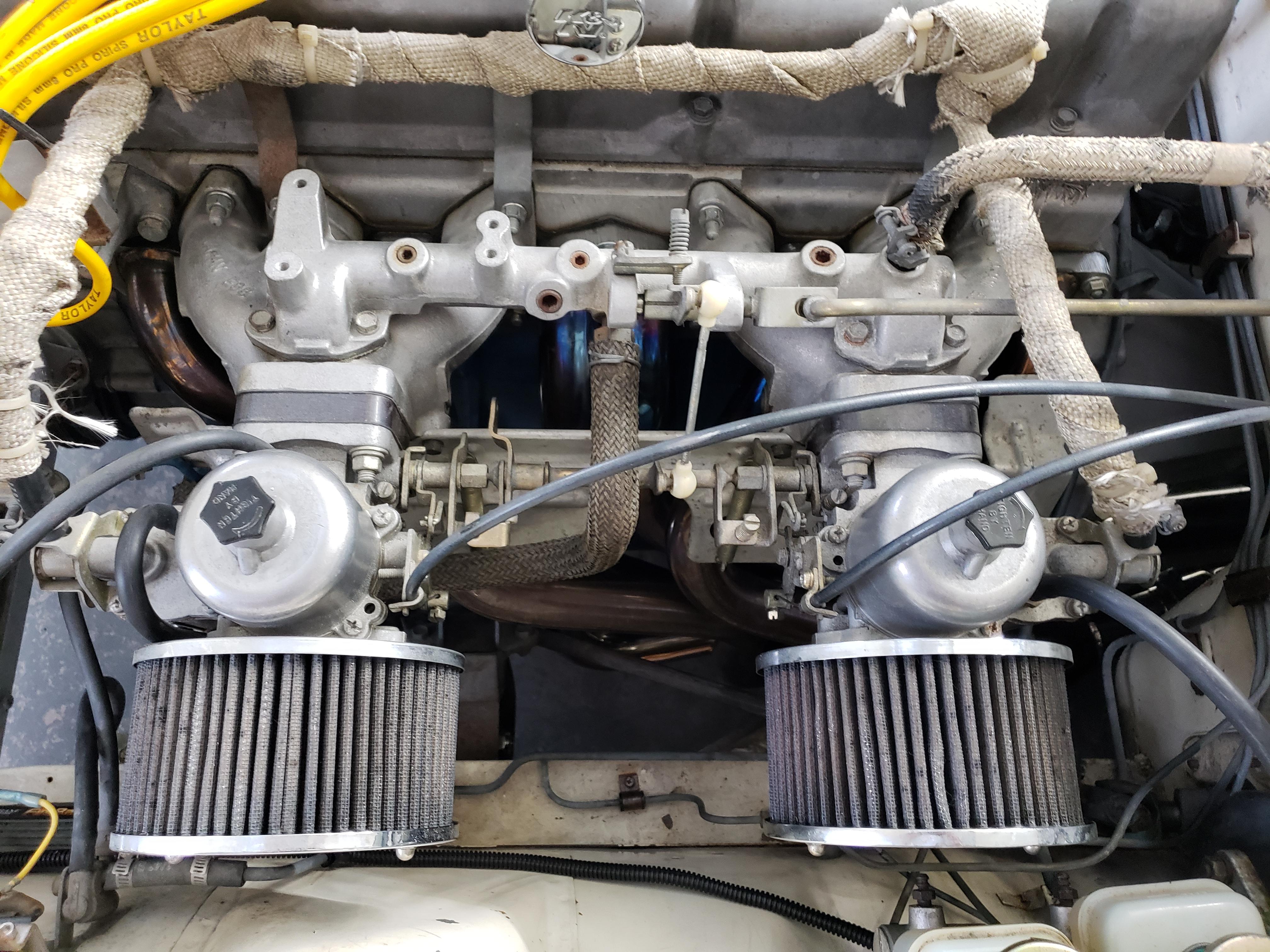

I have never messed with carbs but tonight I dis remove the filter and find some velocity stacks in there. I am going to clean the K&N filters.

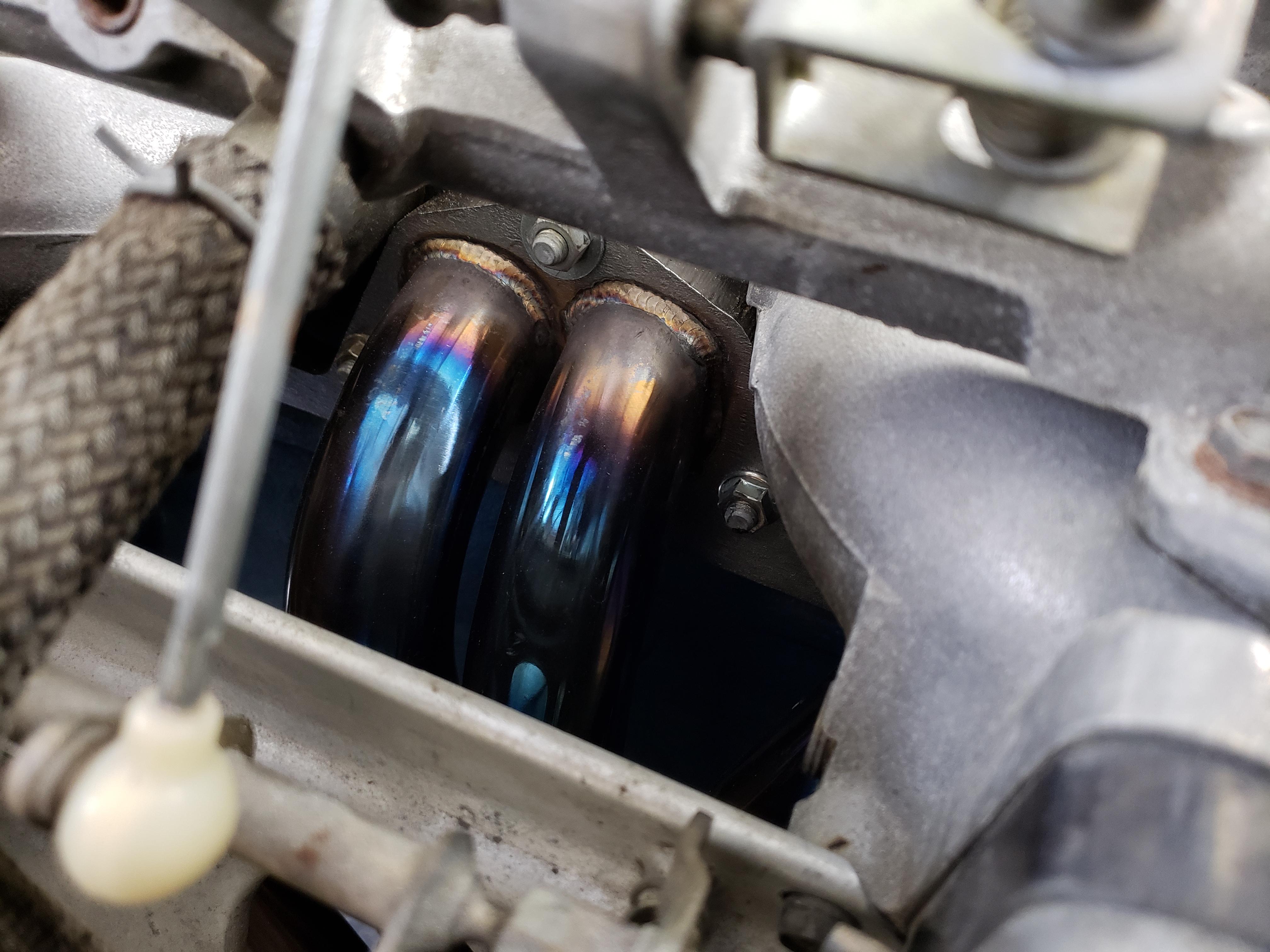

Would changing the exhaust cause the car to lean out or become to rich and cause this sputter?

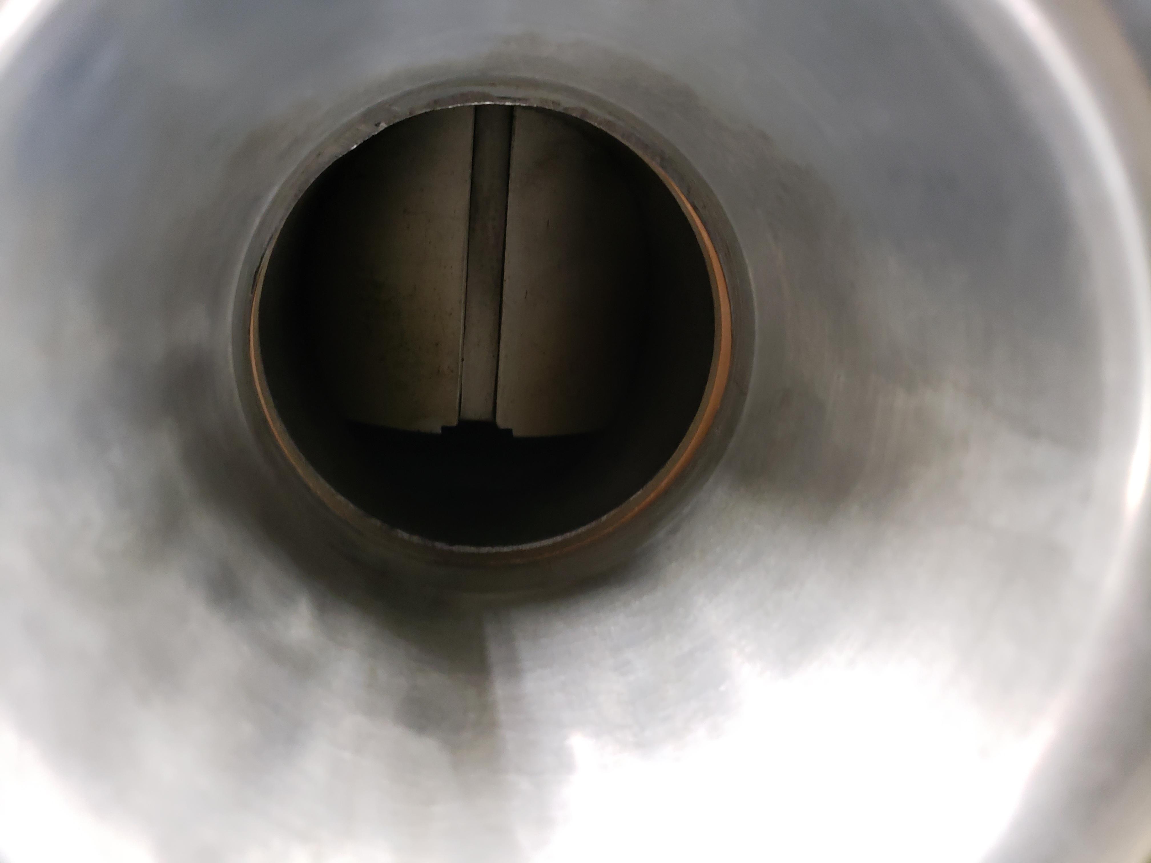

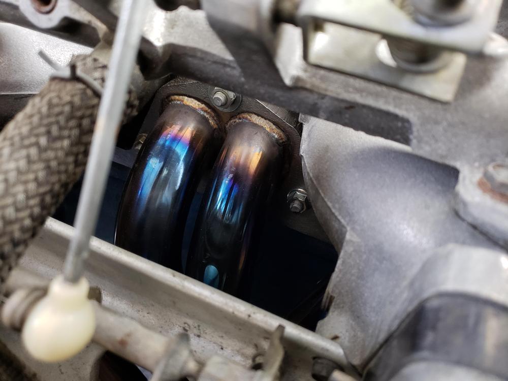

Some pictures attached.

That first pic is the fuel pumps correct? I believe it is the one off zcardepot. I just bought the one autozone has on their shelf. 53$

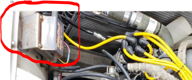

I was posting in another thread recently about the Fireball system.  If you have the optical trigger under your distributor cap in place of points then some trickery will be necessary if you want to keep avoid getting a new distributor.  Or you can just get a 280ZX distributor.  Or a 123 ignition system.  Many options.
