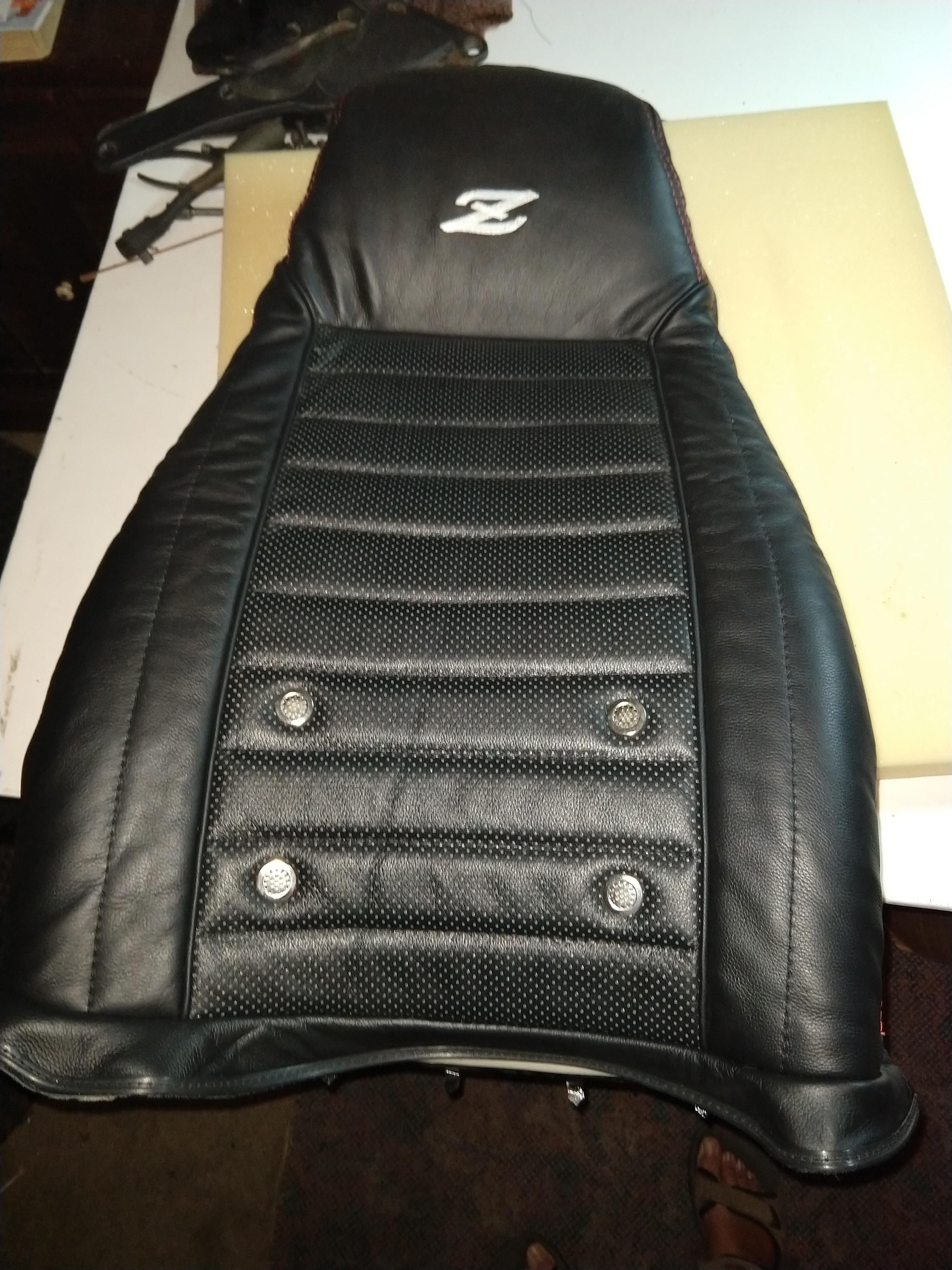

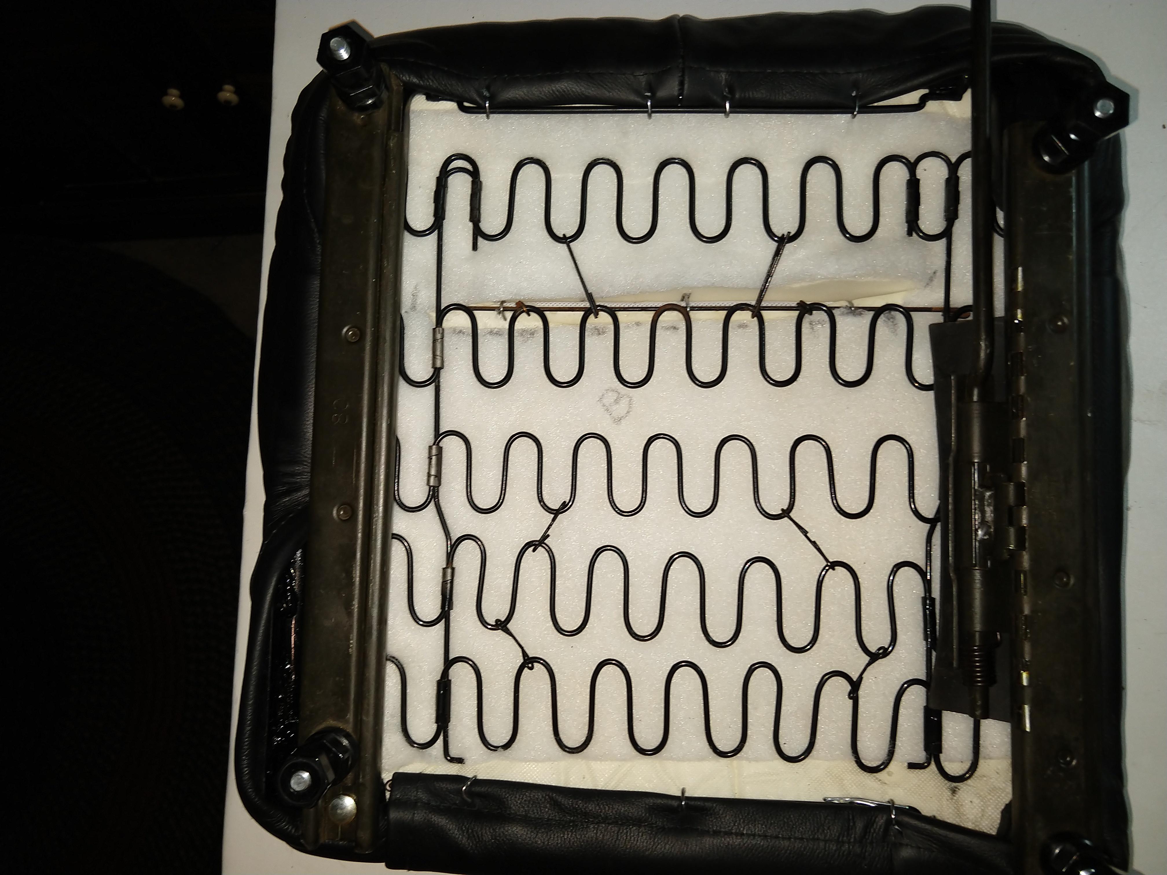

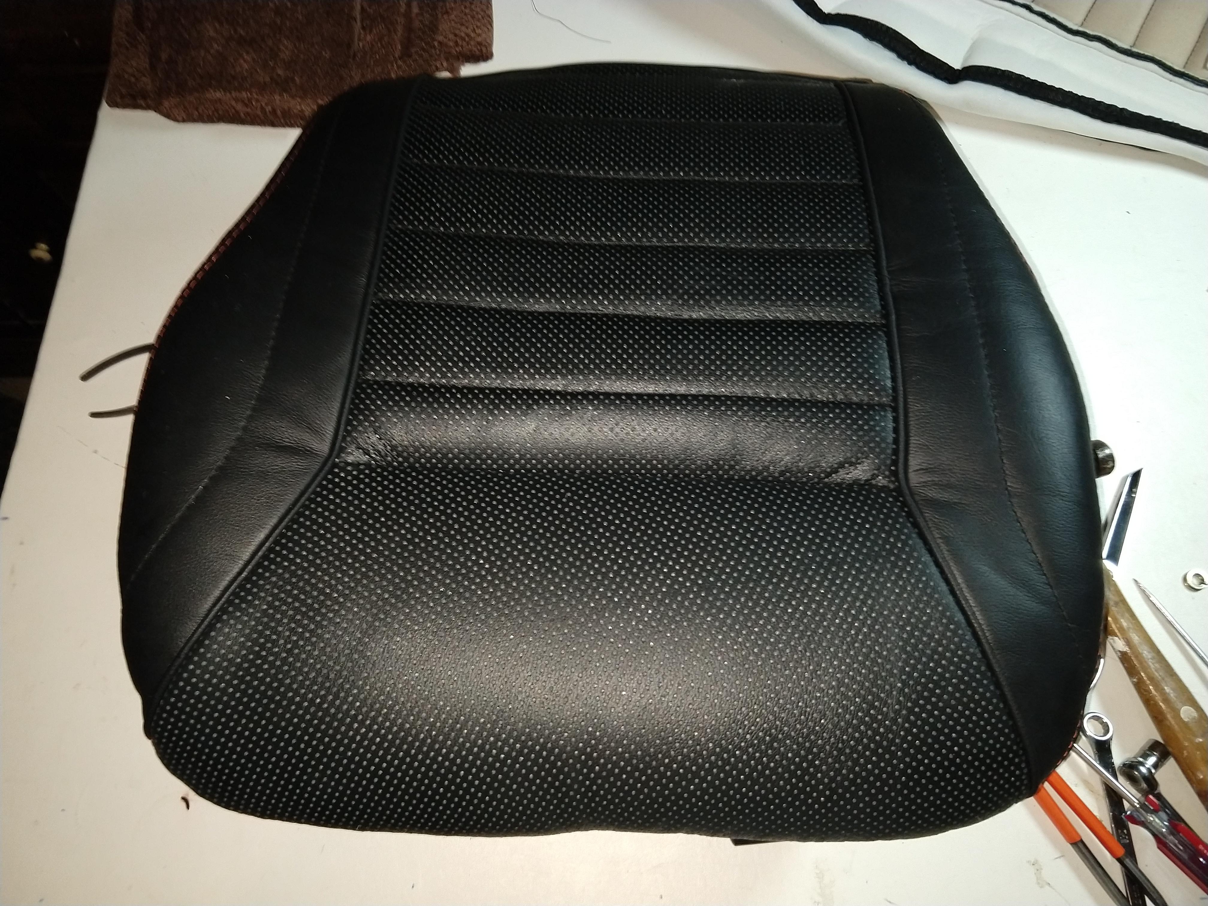

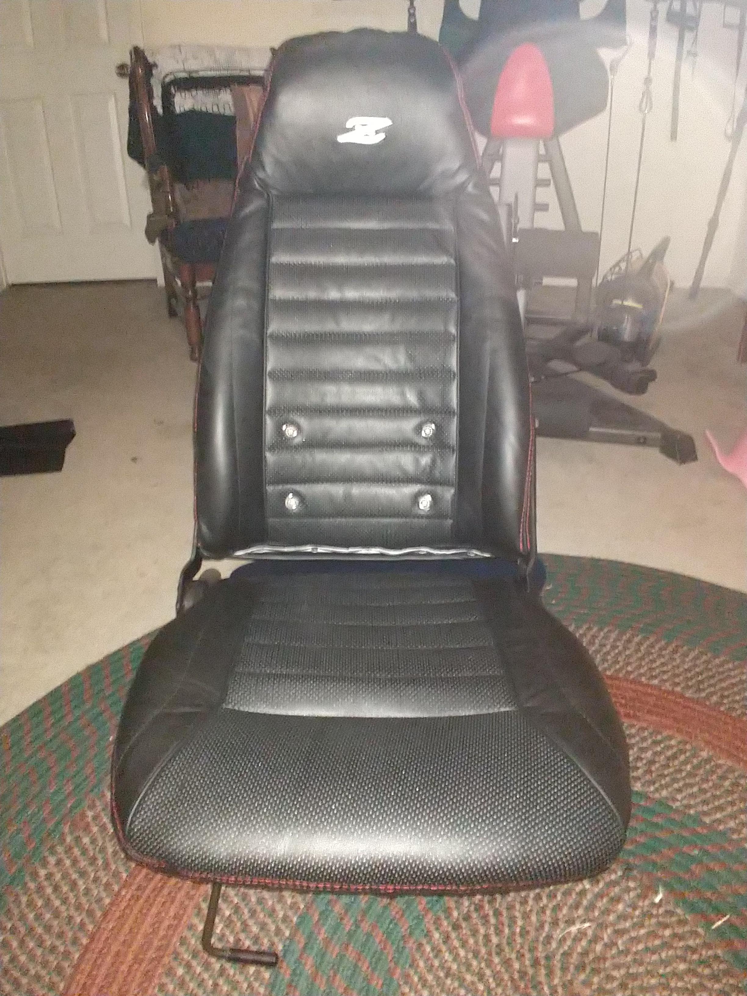

Here's more pics and I did use new foam from MSA. The leather fit fine as shipped. MSA told me I'd have to trim the foam for a 77 seat back, but that wasn't the case it seemed to fit perfect. There was an issue with the seat bottom foam. The mold halves appeared to be offset front to back so that there was an overhang on the top front of the seat bottom foam. We cut the foam back with an electric knife so the contour of the top half of the cushion matched the bottom half. It looked like the mold top half of the shell had slipped about an inch or so forward on the top. Sorry, no picture of the foam issue. We just drilled out the track nuts in the seat frame so they were large enough to mount the 71 floor rails to the bottom or the seat, they dropped right in and lined up just fine with the floor mounts in the cabin.
You can see that we haven't pulled down the seat back leather to hook on the spikes yet. A steamer helped with fitting the leather. No seat heaters, leather is much warmer than Naugahyde in the winter. For the last 2 weeks we've been between 95 and 102, need to get my A/C hooked back up!

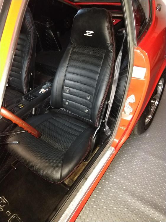

Finished and in the car. I think they turned out very nice. The spring bottoms in the '77 seat bottoms vs the old 47 year old straps in the '71 seat bottoms raises you about 1.5 in. which is noticeable. I can now comfortably put my elbow out the open window.
