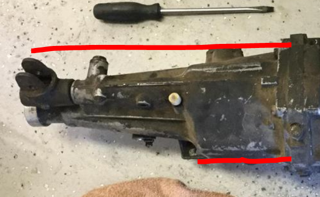

I found an old 200SX manual that I had that shows the 71B as the 200SX transmission.  So if you get a Z car front case/housing it should bolt to the engine.  But, as I said, it's been reported the the length might be different.  So it might not be "just like" a Z car 5 speed.
And, if the tail shaft housing is different the crossmember mounting points might be different, along with the exhaust system hangers.  So, you could probably make it work but it might not be worth the effort.
That seems to be what mine are.  So with a front case swap it should work.  You shouldn't have to do any extra work either, bearing swaps or grinding, since the bearings and clearances should be the same.  But the ratios are more like a 280Z, not a 280ZX, apparently.  The Haynes manual that I have says the ratios are 3.321, 2.077, 1.308, 1, and 0.833.  So a 3.54 diff ratio would be about right.
