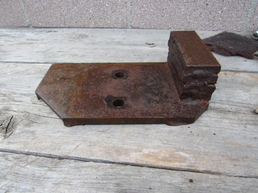

Posted July 22, 20186 yr comment_553608 Does this crude looking thing actually work at quietening down the R200 diff? Wondering if I should reinstall? Link to comment https://www.classiczcars.com/forums/topic/60428-vibration-dampener-thingy/ Share on other sites More sharing options...
July 22, 20186 yr comment_553617 It would be interesting to know why its there. My 77 doesn't have it and never did. I know another owner that does not have it either. So if it was there for noise deadening, or what ever reason, then shouldn't it have been on every 77? Assuming it's from your 77 280. I don't recall seeing it in the FSM either. I'll have to look for it when I get home. Edited July 22, 20186 yr by rcb280z Link to comment https://www.classiczcars.com/forums/topic/60428-vibration-dampener-thingy/#findComment-553617 Share on other sites More sharing options...
July 22, 20186 yr comment_553641 My 78 with an r200 has itSent from my iPhone using Classic Zcar Club mobile Link to comment https://www.classiczcars.com/forums/topic/60428-vibration-dampener-thingy/#findComment-553641 Share on other sites More sharing options...
July 22, 20186 yr comment_553642 My '75 coupe has it. Link to comment https://www.classiczcars.com/forums/topic/60428-vibration-dampener-thingy/#findComment-553642 Share on other sites More sharing options...
July 22, 20186 yr comment_553643 My dad's 78 has it and I think my 75 has it. I have always assumed it was a jacking point.....and have used it as such. Link to comment https://www.classiczcars.com/forums/topic/60428-vibration-dampener-thingy/#findComment-553643 Share on other sites More sharing options...
July 22, 20186 yr comment_553651 It's a " Mass damper " . I believe Nissan used it to combat a noise issue from the diff of the R200's. Some of the gear whine or singing which seems to be fairly common on the R200. There may be TSB on it... Edited July 22, 20186 yr by Chickenman Link to comment https://www.classiczcars.com/forums/topic/60428-vibration-dampener-thingy/#findComment-553651 Share on other sites More sharing options...
July 22, 20186 yr comment_553652 That Lead Noise Damper for the Differential By Gary L, August 29, 2016 in Engine and Drivetrain found this here on this site. Guess it was standard equip. Why mine doesn't have it I have no idea. Edited July 22, 20186 yr by rcb280z Link to comment https://www.classiczcars.com/forums/topic/60428-vibration-dampener-thingy/#findComment-553652 Share on other sites More sharing options...
July 22, 20186 yr comment_553653 These dampers get added when a manufacturer discovers an unwanted truth about their drivetrain after it's too late to come up with a more elegant solution. And you know how car companies hate adding invisible items to a vehicle that don't add to the profit margin, so there has to be a substantial problem before they'll add something like this. When I worked with a manufacturer (who shall remain nameless) on the public launch of one of their prestige-class models ten years ago, I found a very similar device attached to the rear diff casing on the versions with the optional AWD powertrain. And this was well into the era of CAE, FEA and computer-driven lab-baseddrivetrain testing. I expect that the usual issue is a buzz or drone at a key highway cruising speed. An 'enthusiast' owner, of course, may never notice the issue. Link to comment https://www.classiczcars.com/forums/topic/60428-vibration-dampener-thingy/#findComment-553653 Share on other sites More sharing options...

July 23, 20186 yr comment_553699 Yep, mine had one. But once it was off it never went back on and since I don't track my car, I haven't noticed any difference in noise or performance. Maybe my hearing or expanded waistline has something to do with it?? Link to comment https://www.classiczcars.com/forums/topic/60428-vibration-dampener-thingy/#findComment-553699 Share on other sites More sharing options...
July 23, 20186 yr comment_553714 On 7/22/2018 at 7:02 AM, rcb280z said: It would be interesting to know why its there. My 77 doesn't have it and never did. It probably had it at one time. What's surprising is that Nissan didn't at least polish them up after their introduction. 1978 is just as ugly as my 1976. They make a good portable shop anvil. Your link didn't come through. Here it is... Link to comment https://www.classiczcars.com/forums/topic/60428-vibration-dampener-thingy/#findComment-553714 Share on other sites More sharing options...
