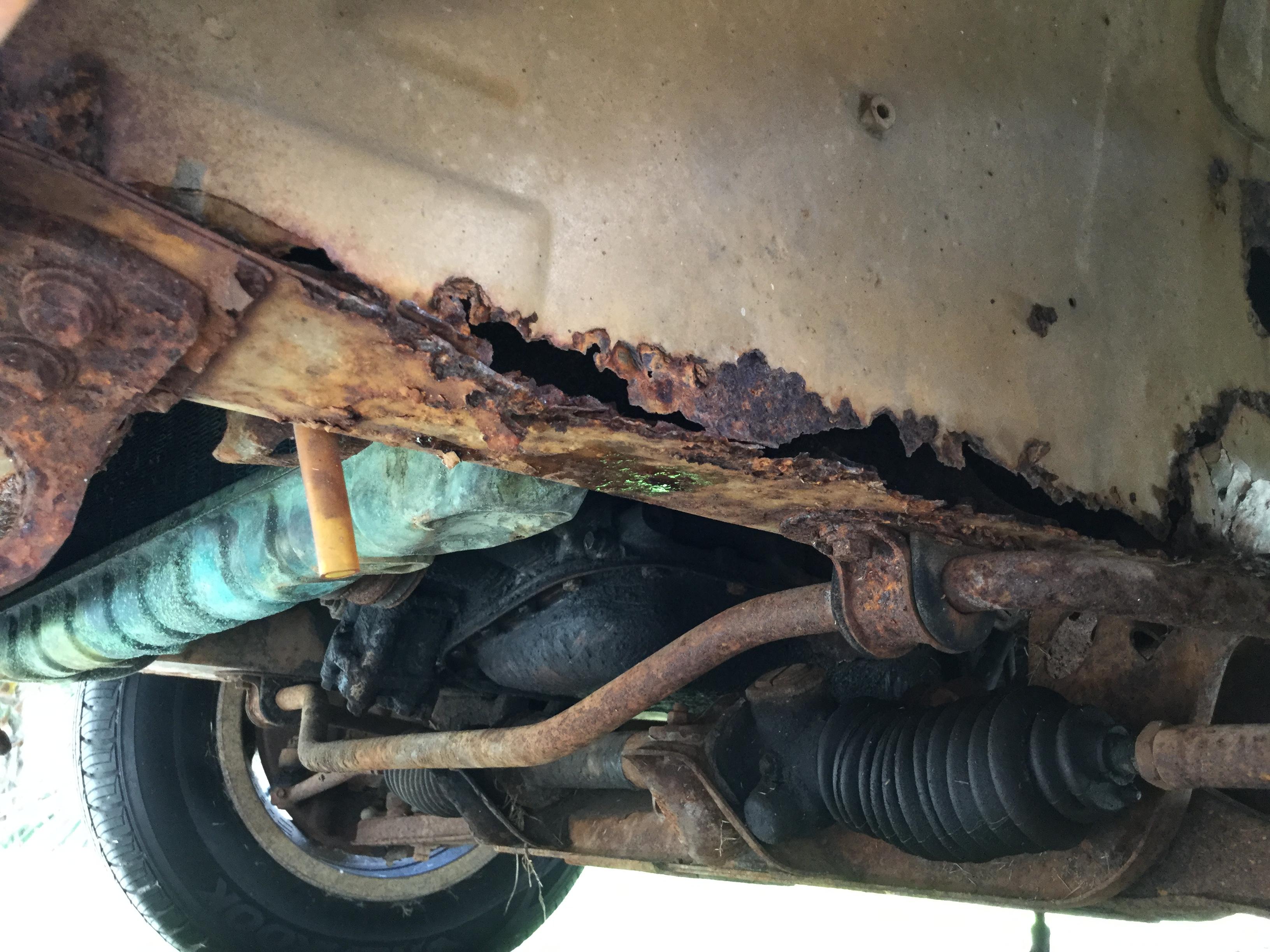

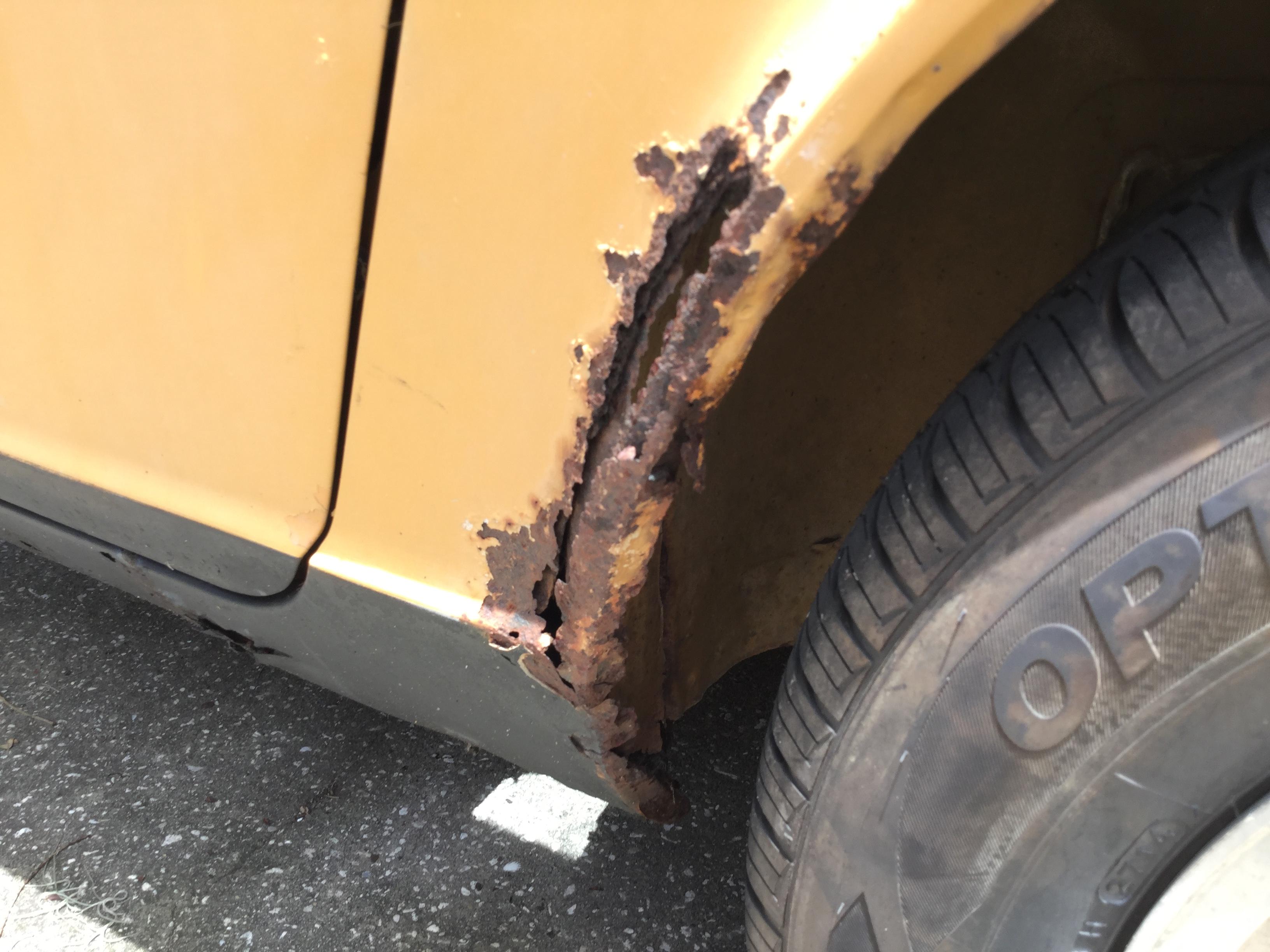

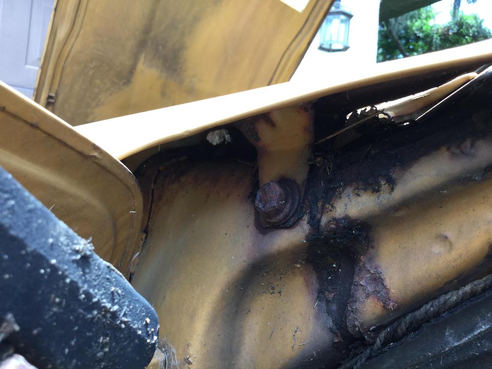

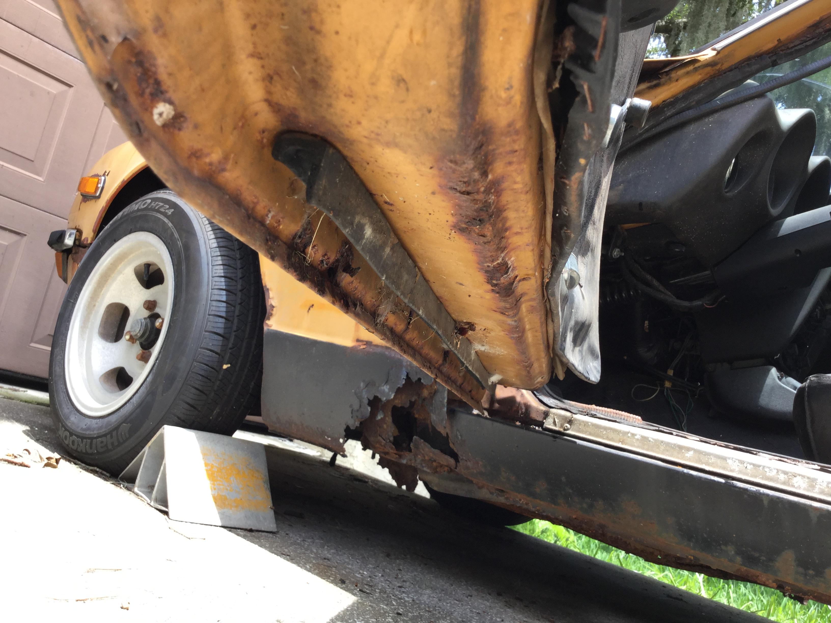

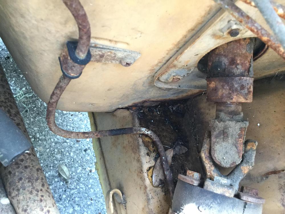

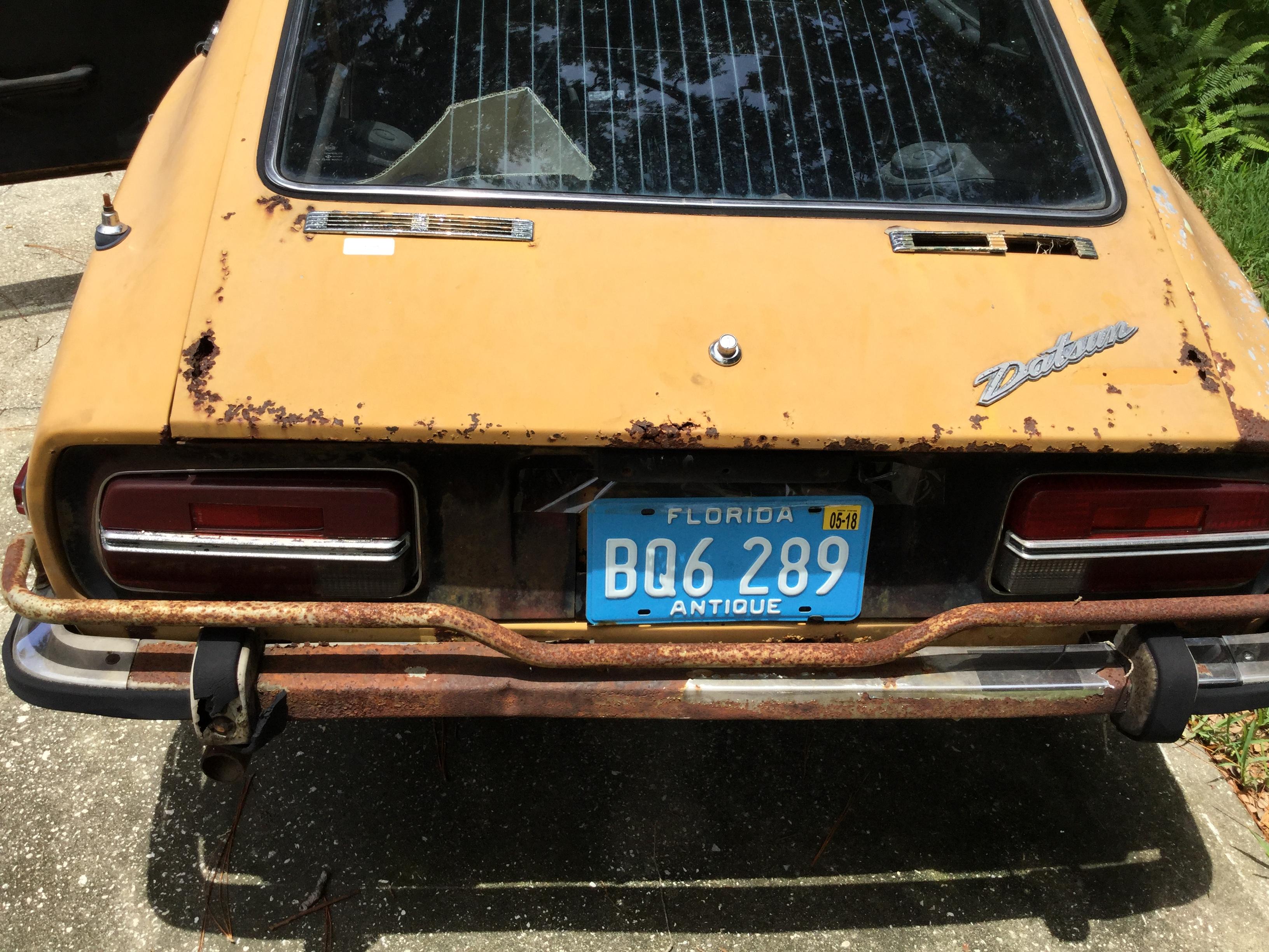

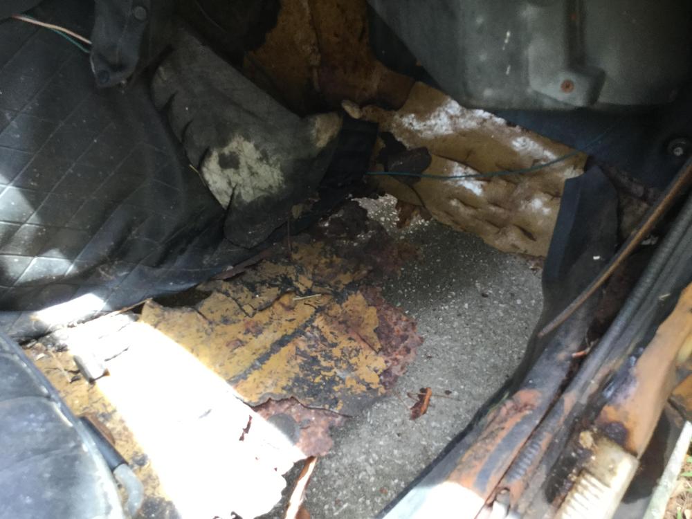

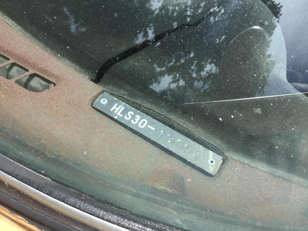

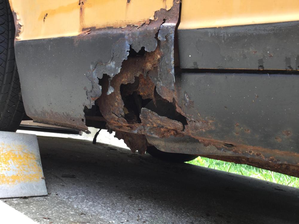

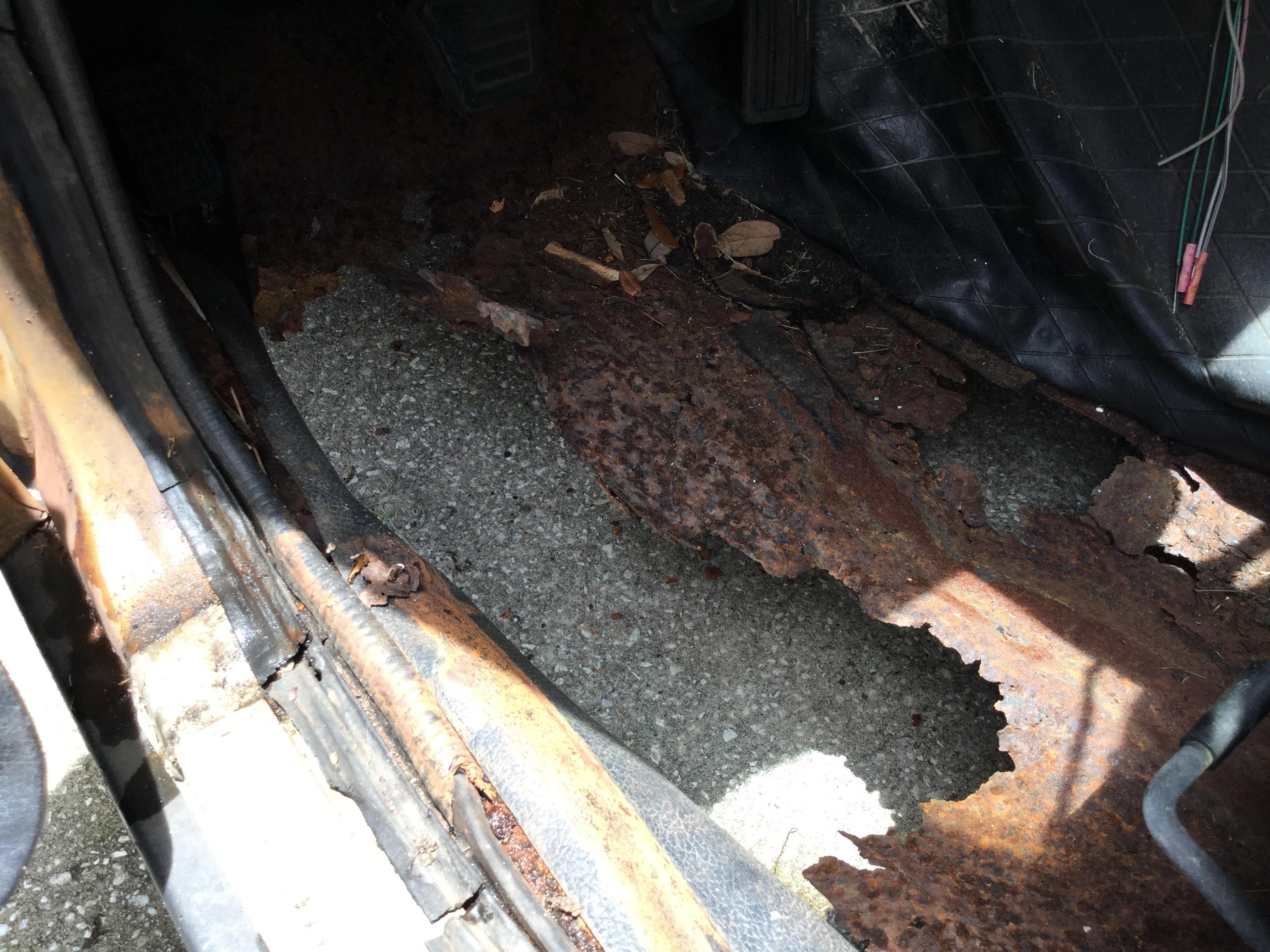

I have a source on a car not listed currently. It is rusty and he wants $4500. Needs floors and I’m sure a whole lot more. Vin he said is in the 13000 range.
He is second owner and really no docs of any kind. Original owner parked it in a field in 84 and thus the condition.

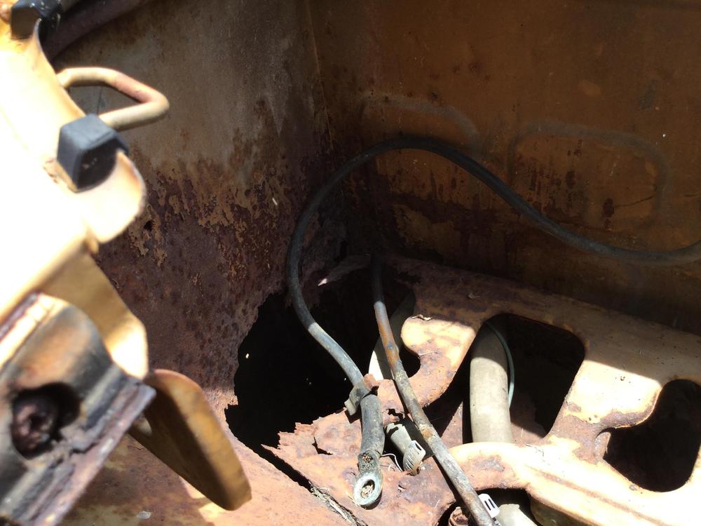

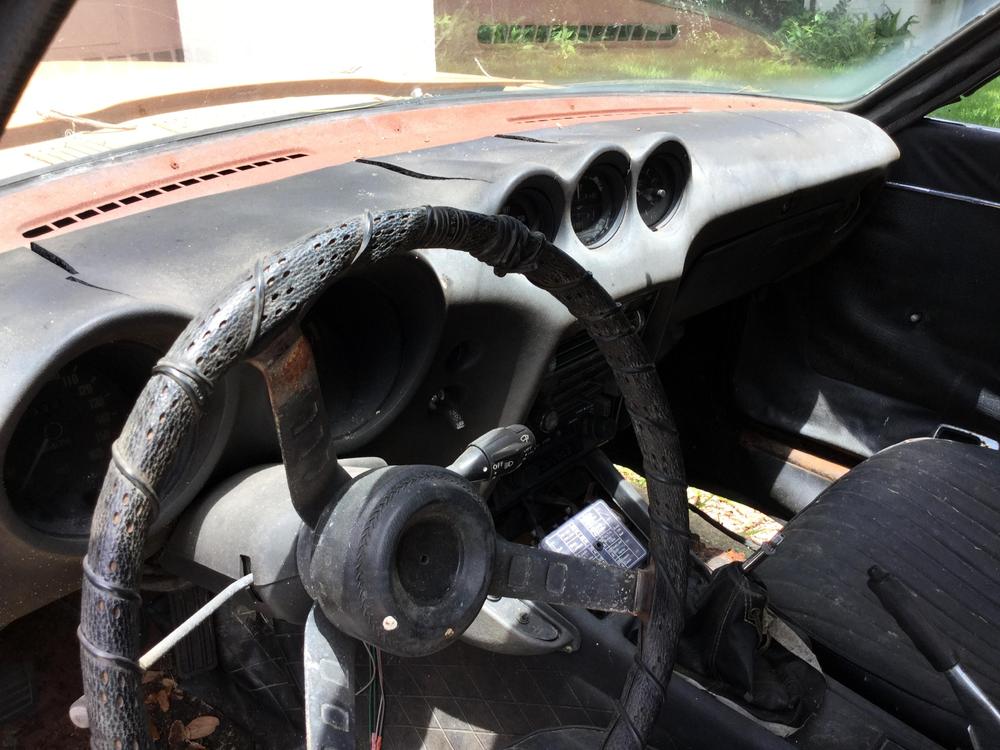

Engine is locked, missing correct valve cover, air cleaner is wrong, carbs may or may not be included, and maybe more hidden rust that I may not even see. What really is left for value? E31 head, steering wheel and some misc stuff? Those items may bring $1200. Otherwise I just can’t see it.
I think there was more concrete than floor!
I was going to make a joke before about how the car seemed fuzzy.  The pictures, of course.  Now I see why the seller went with fuzzy pictures.  You really wore your camera out.

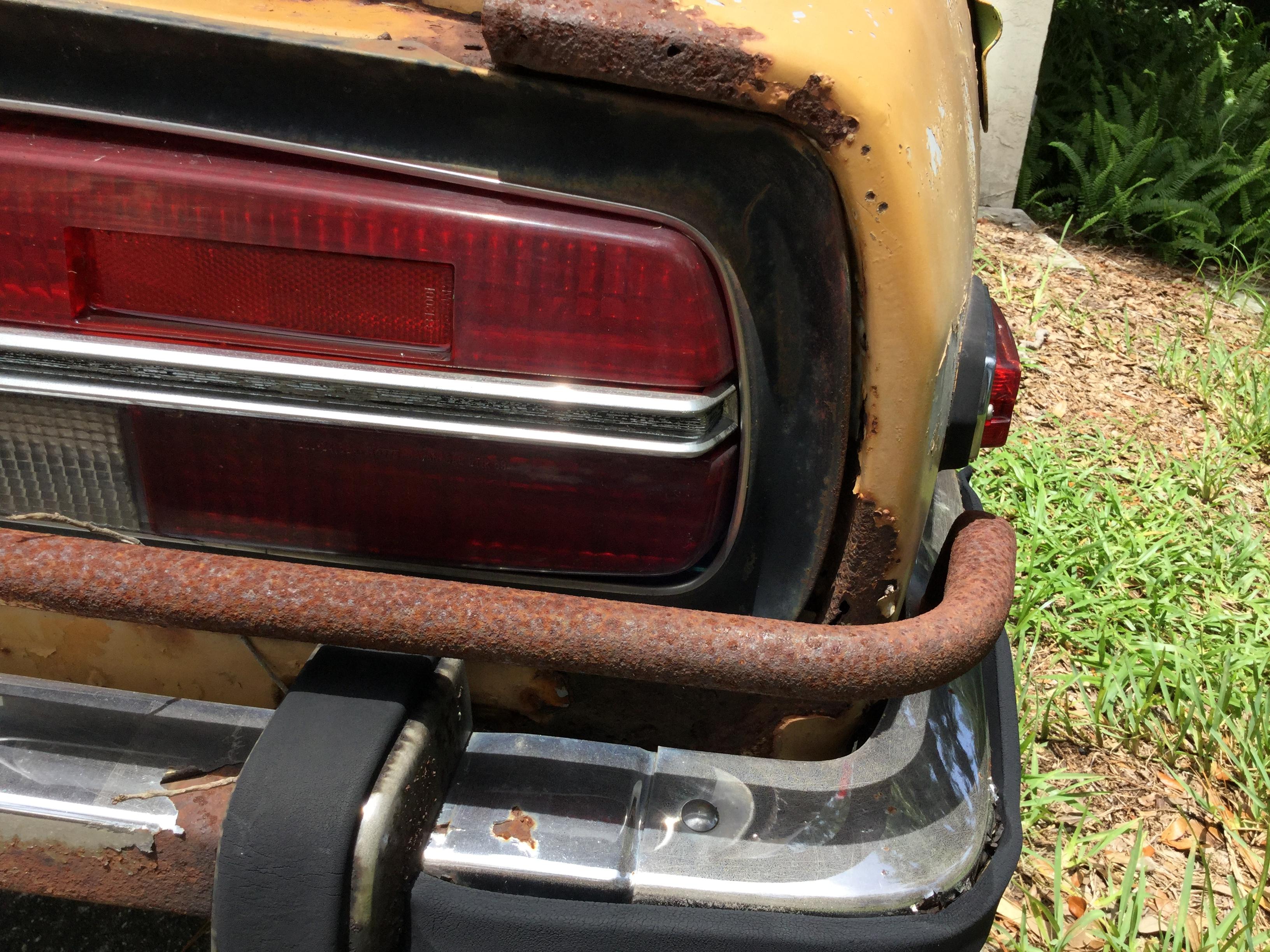

Tail light lenses.
"Series I" back glass.

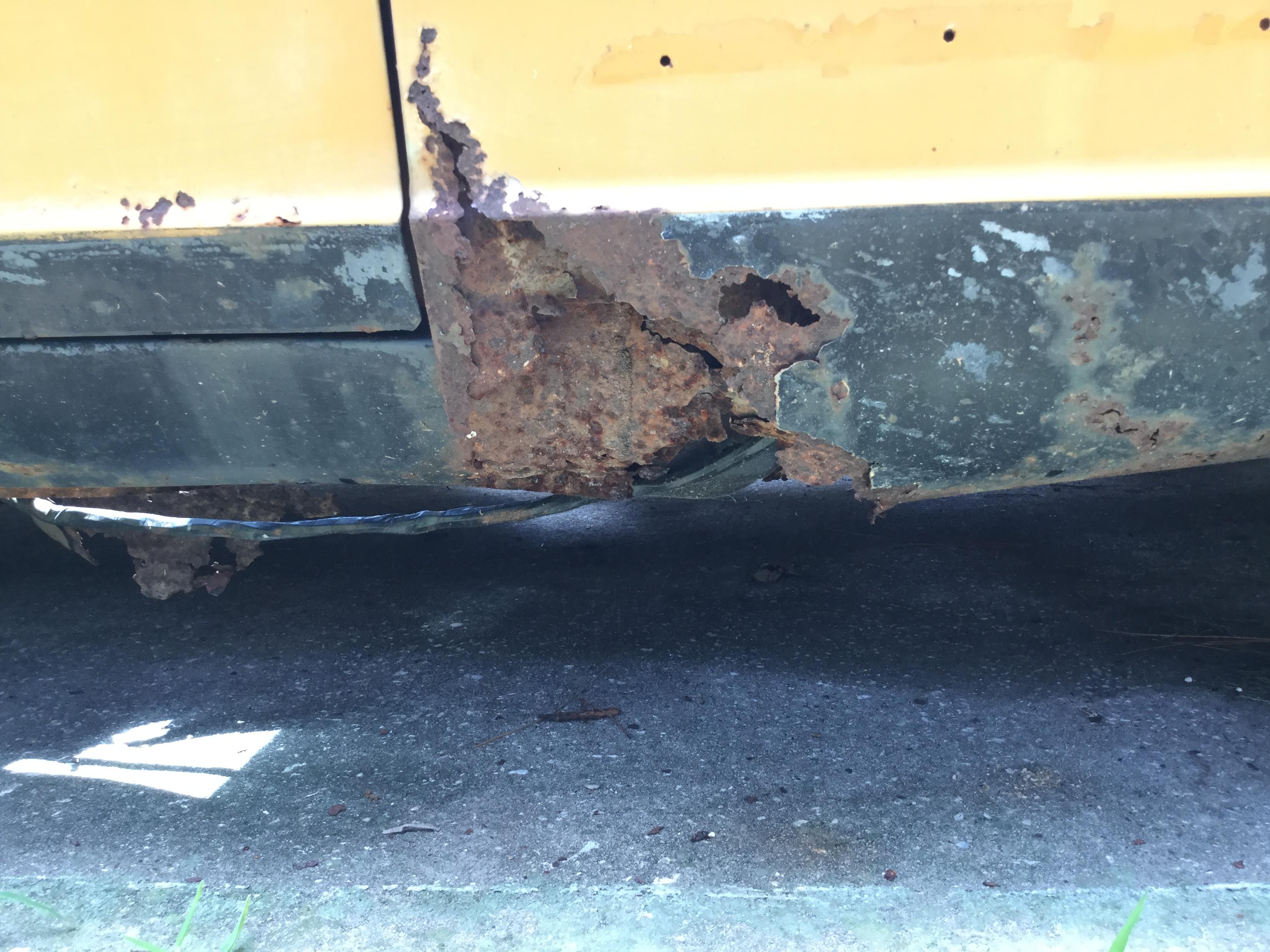

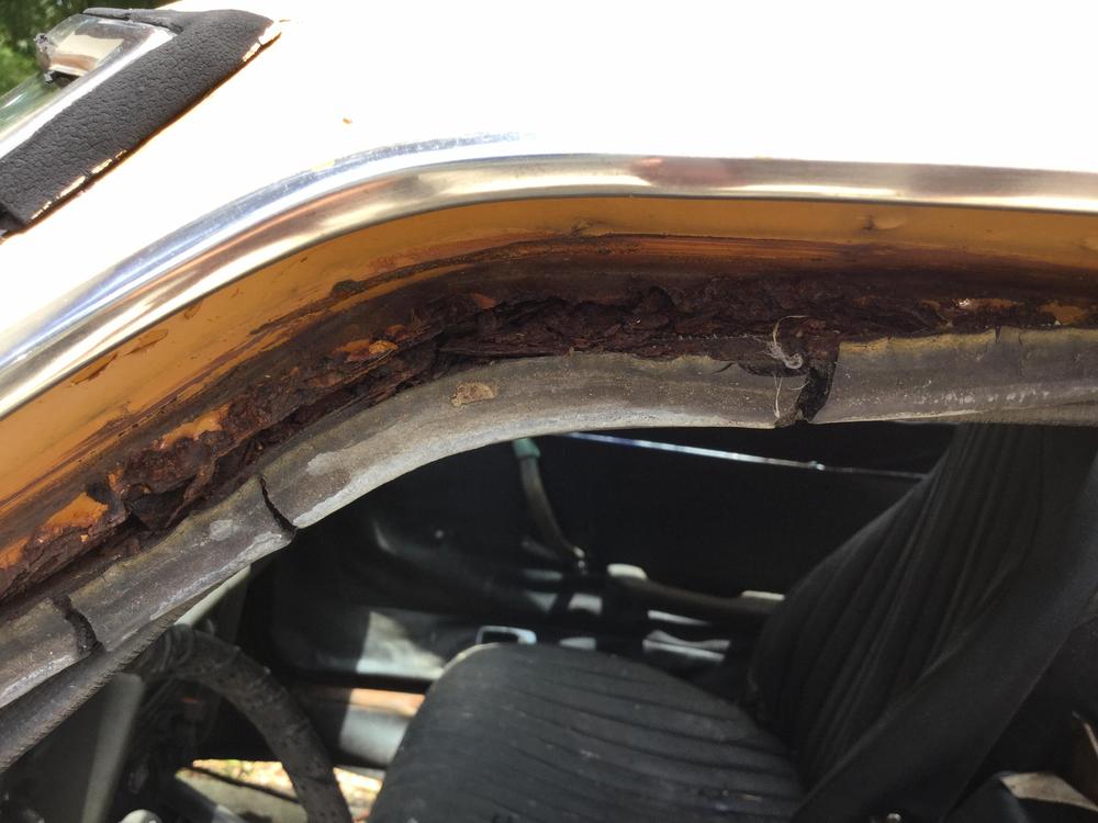

seems like it would be a good project for someone that really really wants to learn welding and body work. Stuff like the rotted "A" pillar pinch welds, wow, don't recall seeing that. I was saying the same thing about the hatch glass as ZH. Also JSM noted the early steering wheel.

I hate to say it since I hate to see any Z destroyed, but that's a parts car. My early '71, which IMO is not worth fixing, is many times more solid than that car. And with a VIN of 13xxx, I'm surprised it's titled as a '70, and not a '71.
OMG, E31 head, steering wheel, glass, roof, maybe the slot wheels, I wouldn't give him a cent over $800.  The integrity of the unibody is gone, it's already sagging.

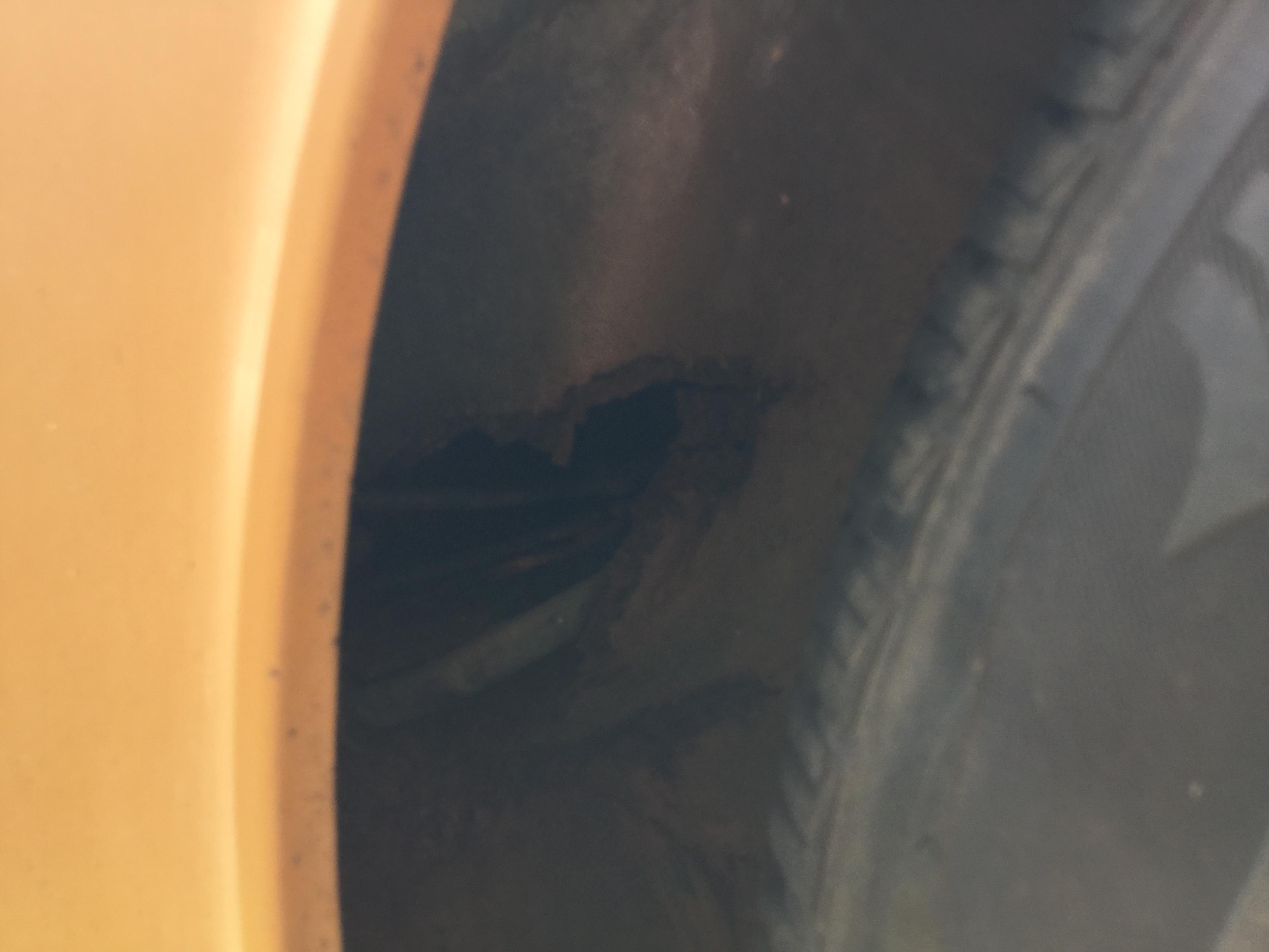

I agree with others about this car though. It's done! The problem is you would need a ton of new metal. I suspect a lot of the panels rotted from the inside out due to the salt air. That means when the car gets cleaned up, a bunch of these panels won't be usable. 2 Quarters, inner and outer rockers, roof frame, rear hatch, both complete front rails, inner wheel wells, front strut towers, floor pans, 2 doors. Almost nothing would go untouched. Many of these parts would have to come from other donor cars. It doesn't make sense to use so many parts on just this one car when a good donor car could be used to save a bunch of other cars instead of this one. If it was a really low number car I might view that differently, but it's not.

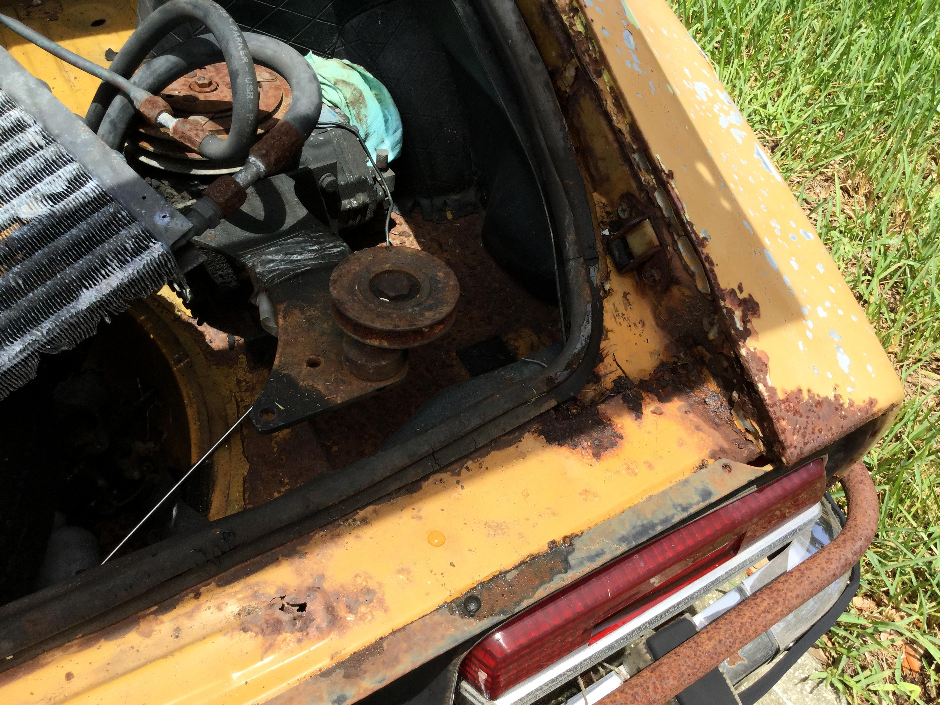

Yep. Drivers door opened and closed fine, passenger would not. I honestly think it was hit in the rear too. True color is safari gold, but there appears to be a bend in the rear deck right where the strut tower meets on passenger side which I thought was odd, but then also look at the non original gas tank lid and the lime showing through and under the bumper as well. Plus the rot from the inside where the emblem was is really bad and looked like bonds too. To many unknowns.

The a/c compressor is vintage.  How's the wiring harness?
