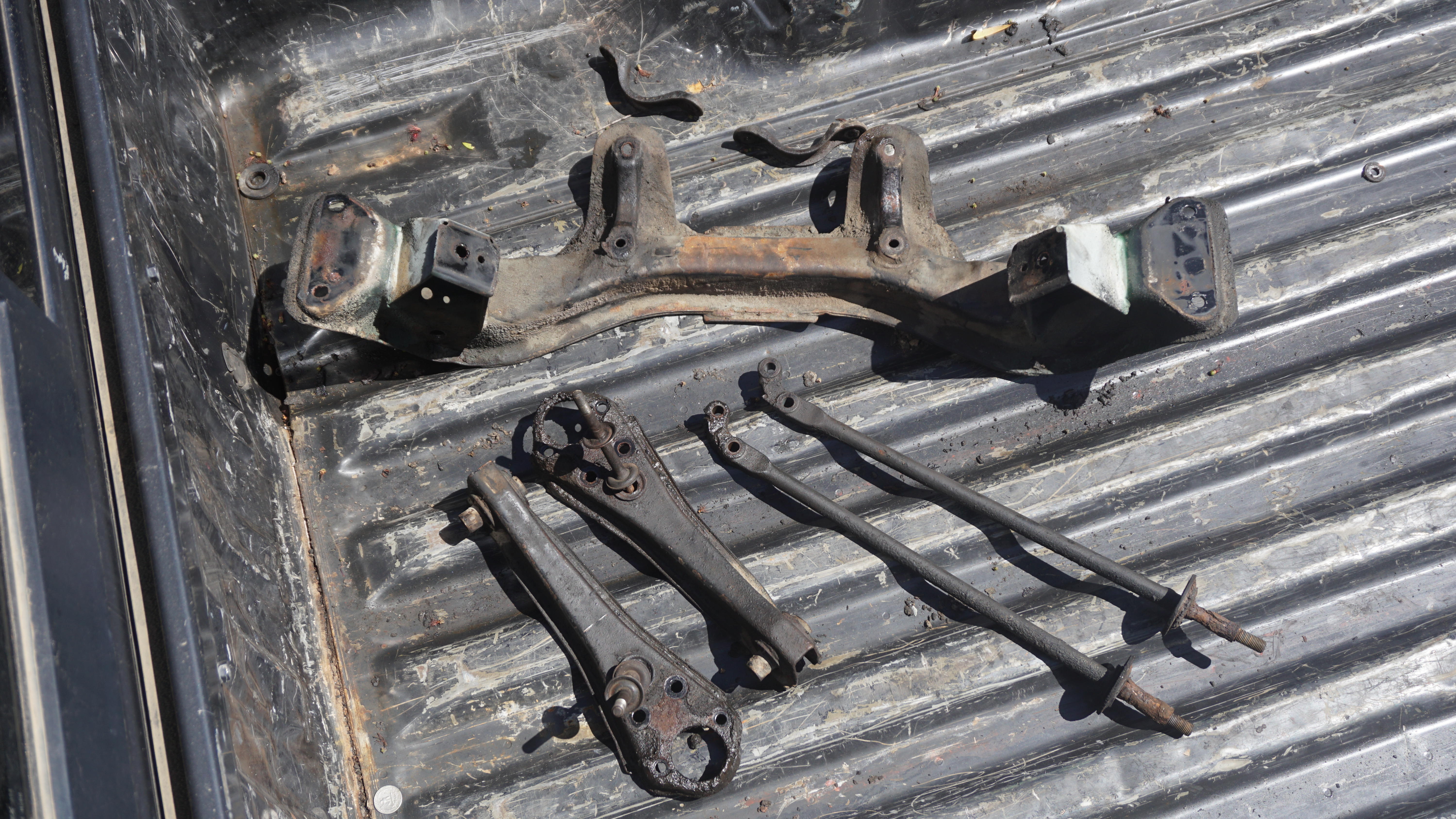

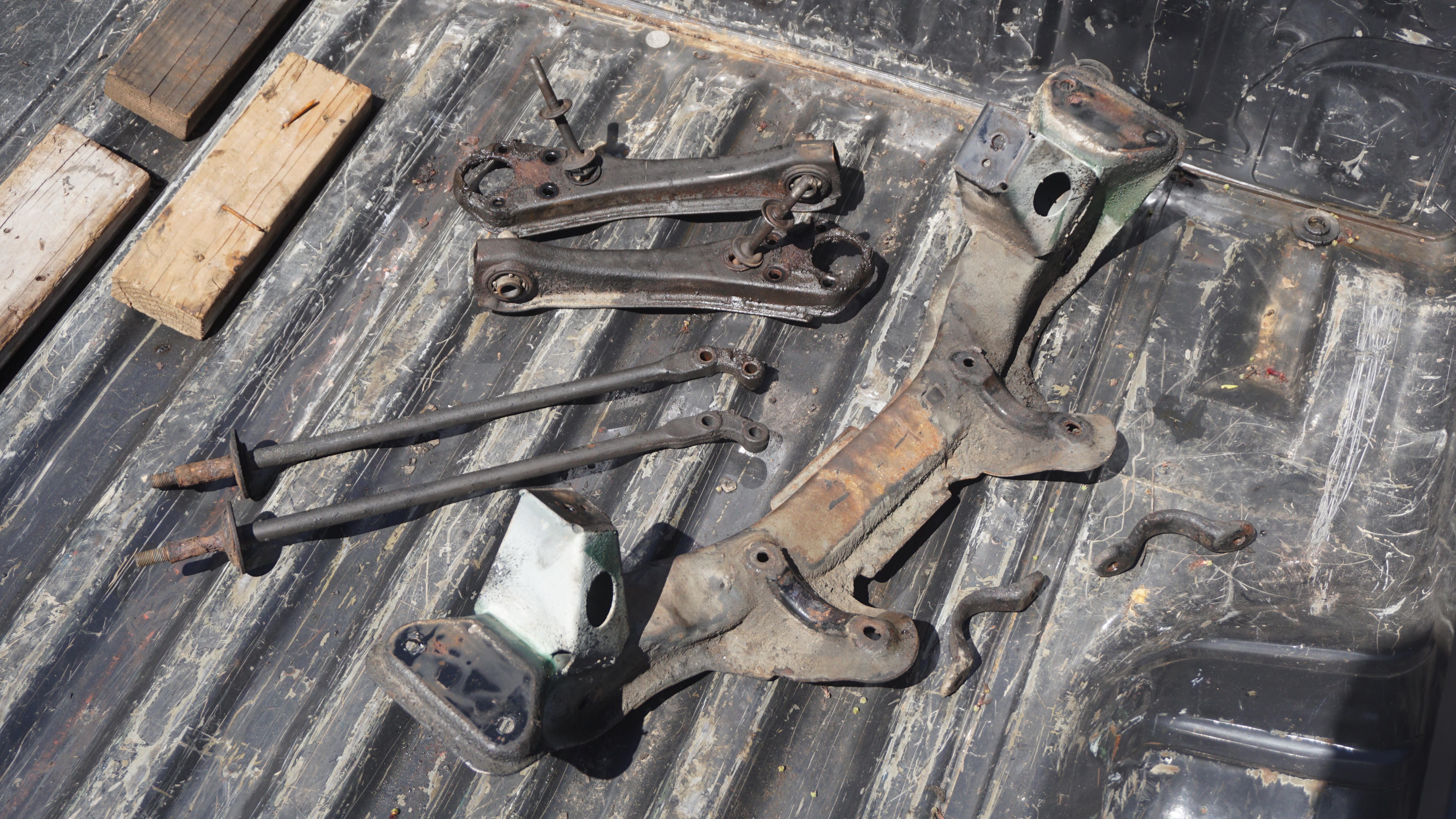

August 5, 20195 yr Author comment_581192 Well I managed to get everything taken apart today and ready to be blasted and powder coated tomorrow. Link to comment https://www.classiczcars.com/forums/topic/60500-california-1978-datsun-280z-restomod/?&page=10#findComment-581192 Share on other sites More sharing options...

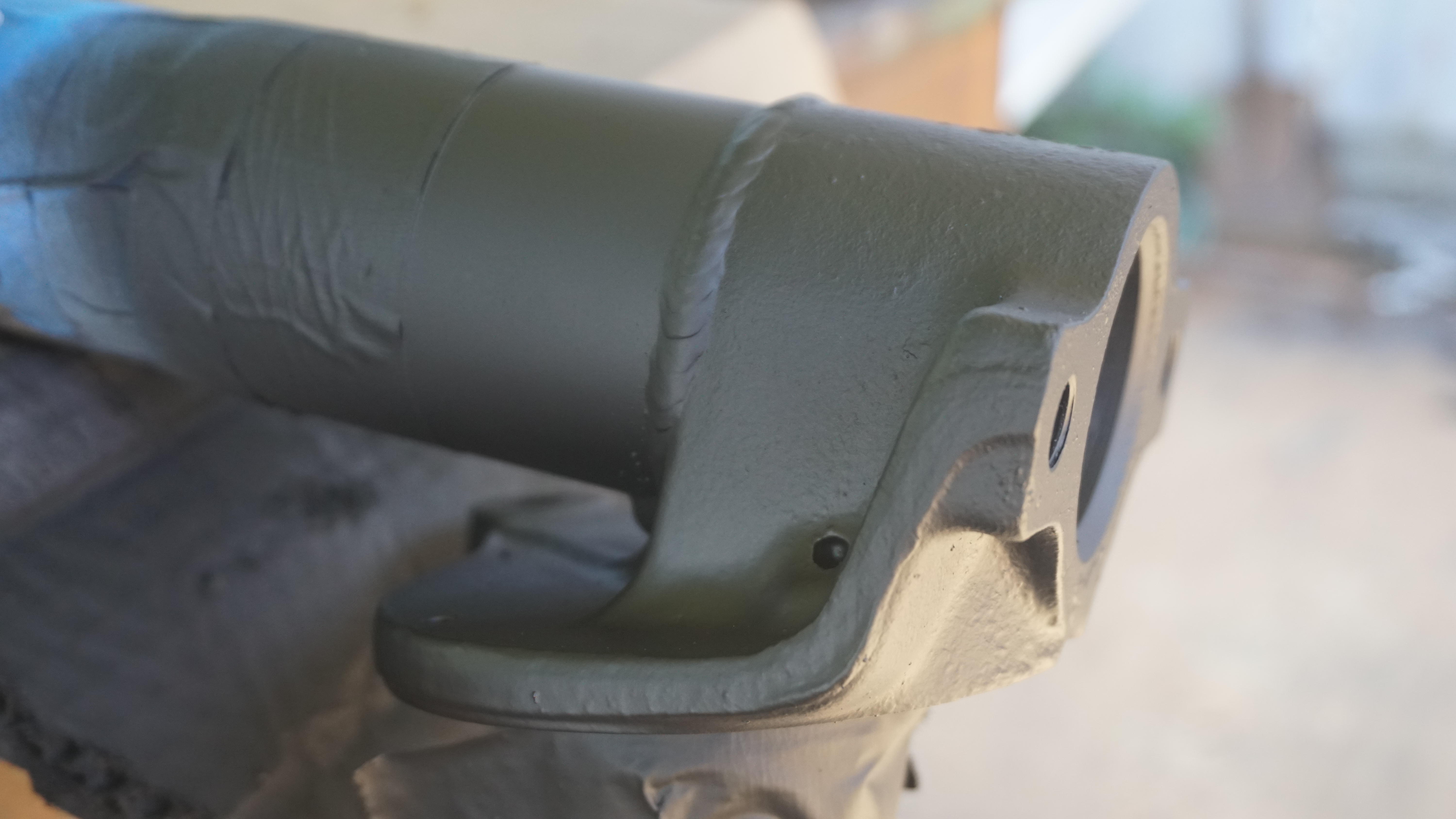

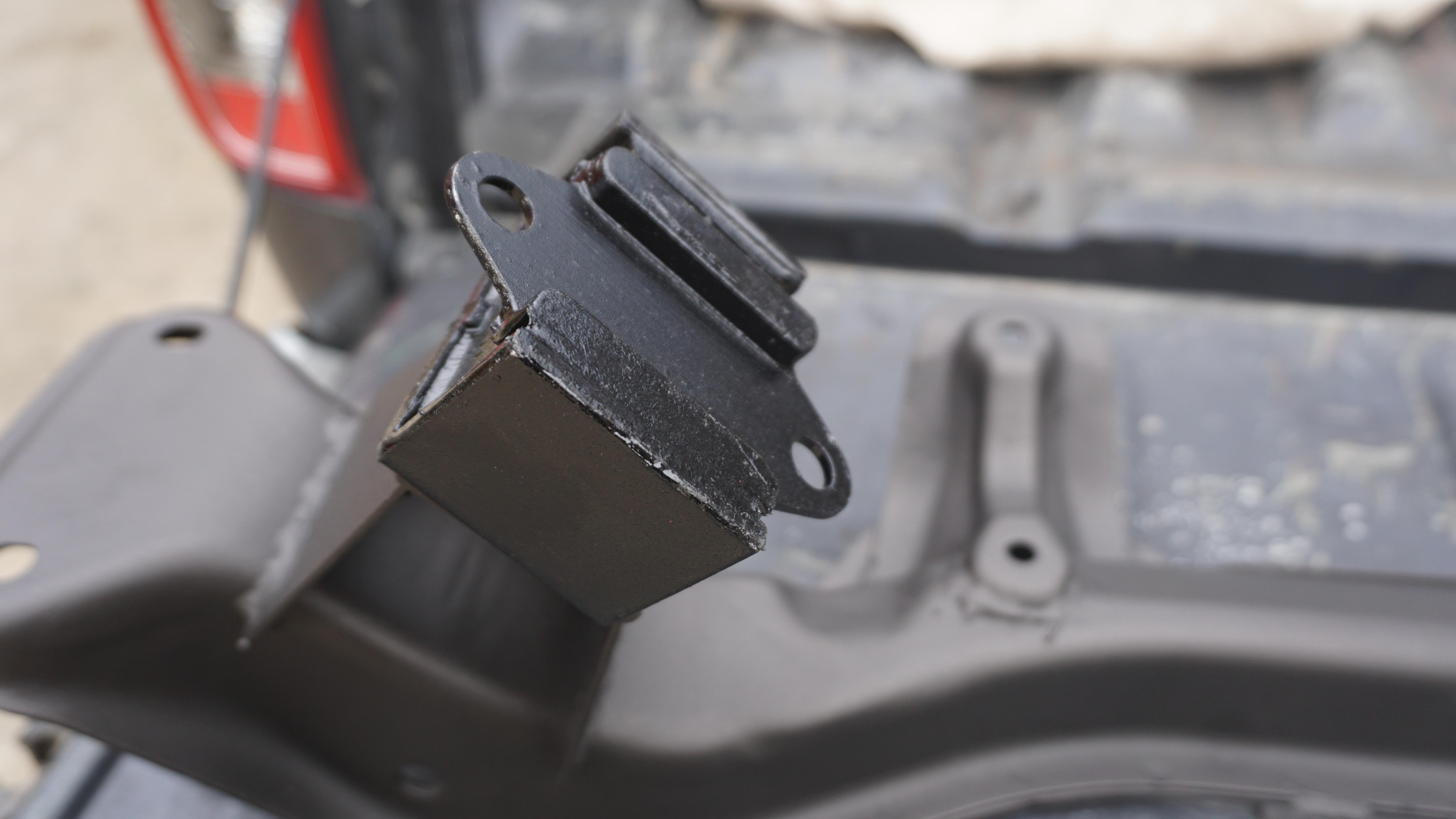

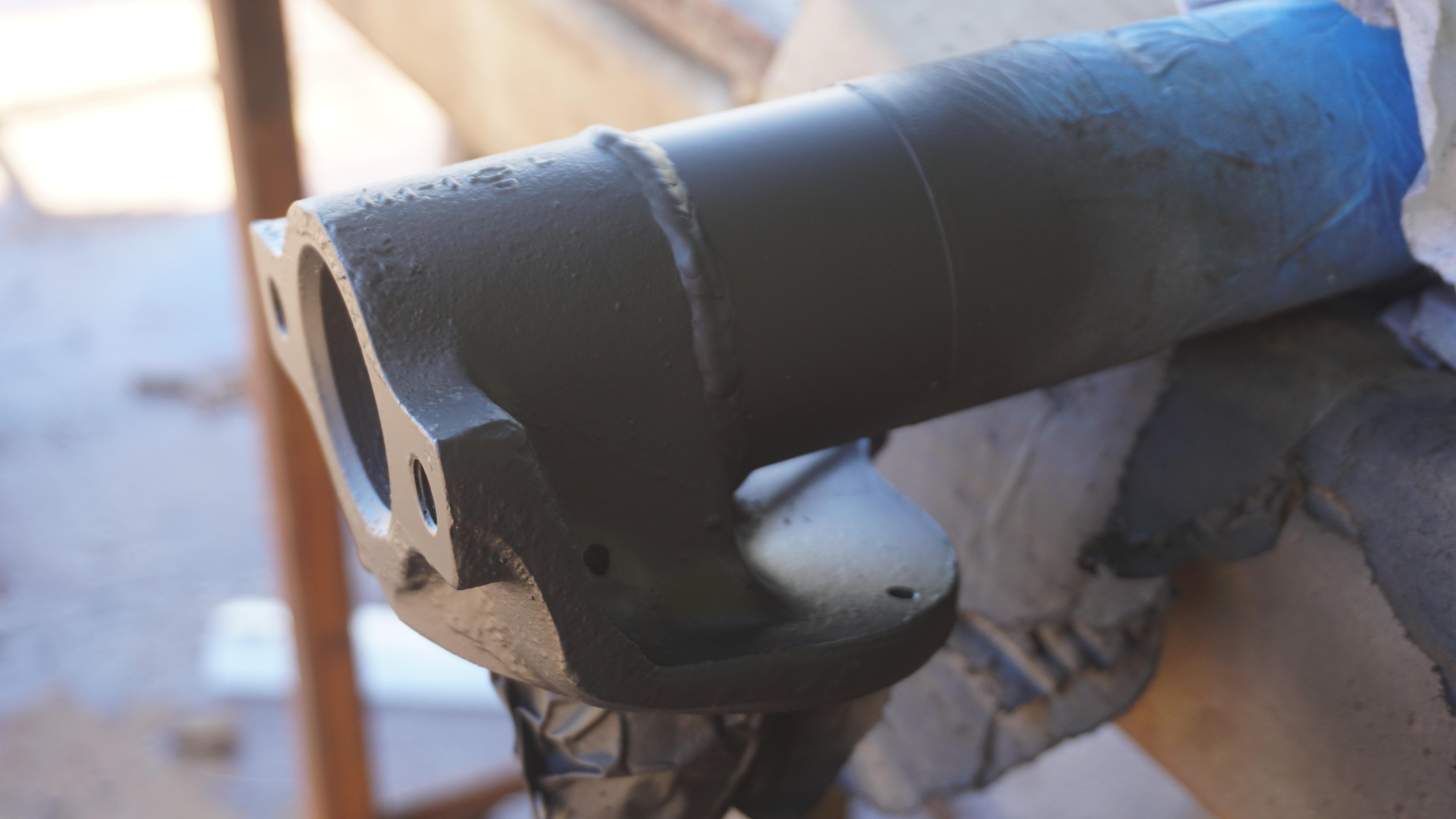

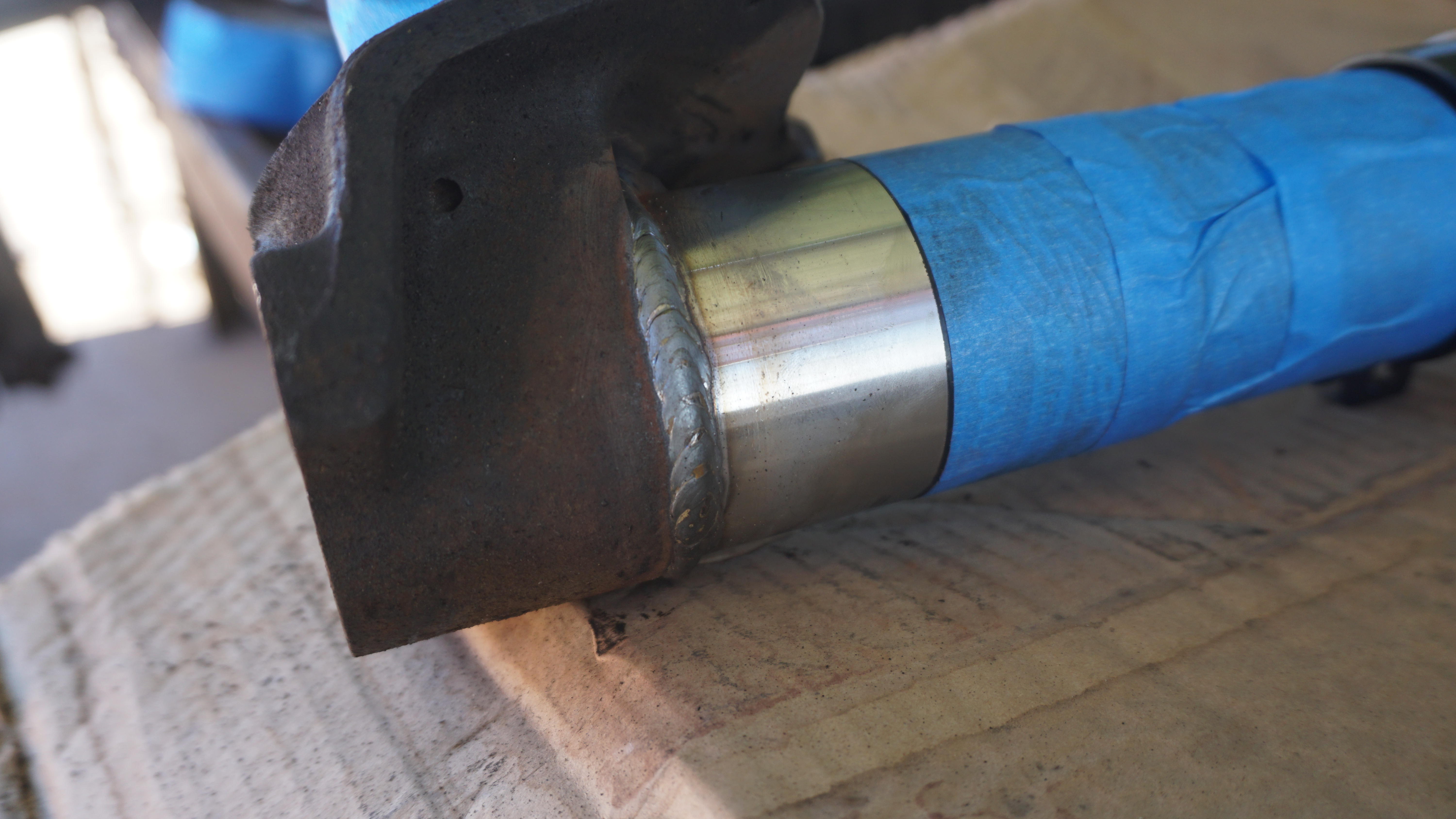

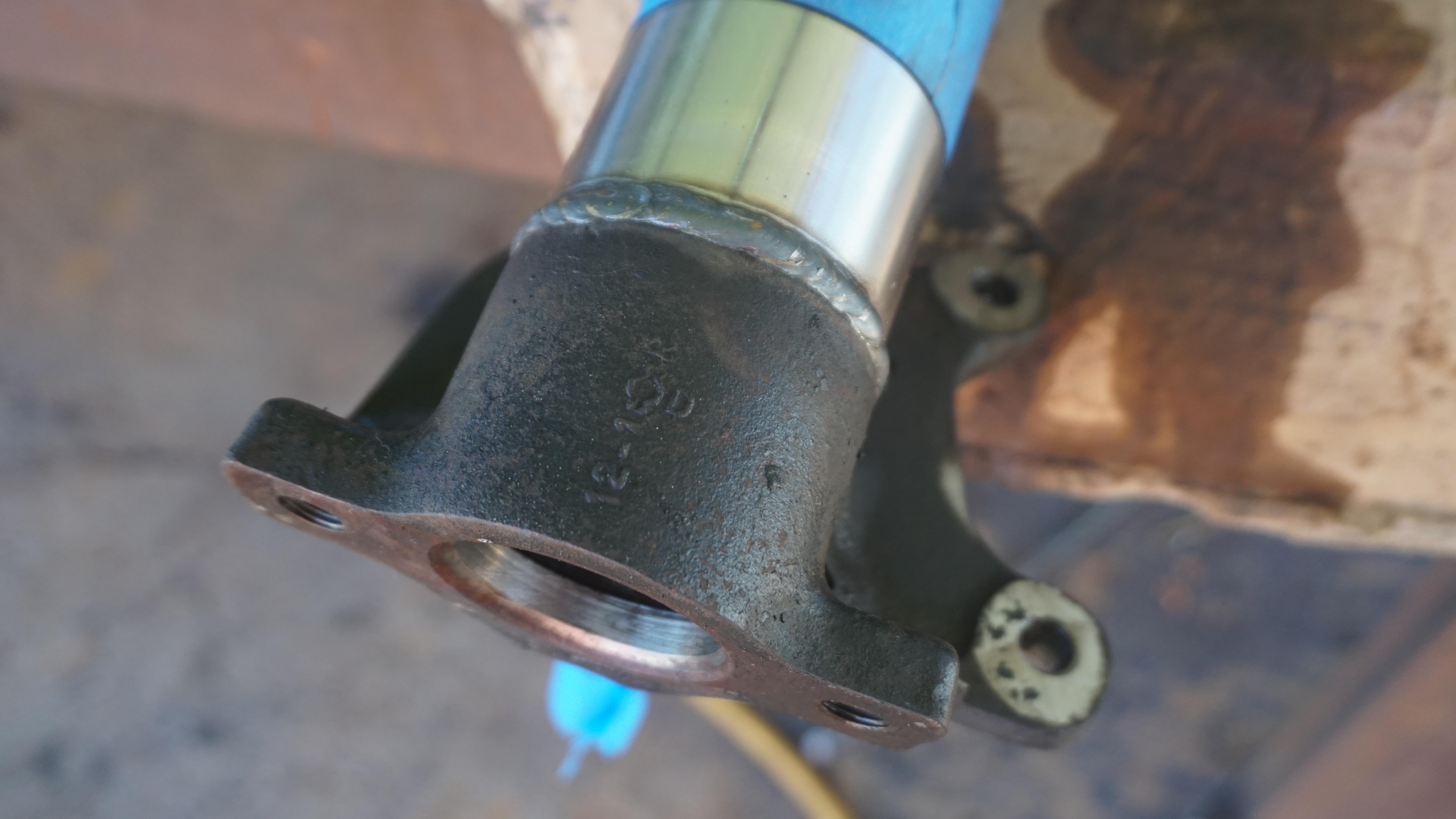

August 5, 20195 yr Author comment_581193 I also got the welds from yesterday cleaned up and painted. Not sure what the standard is here but I did a couple of coats of SEM self-etching primer followed by several coats of Rustoleum Flat Black Enamel. Should do the job! Link to comment https://www.classiczcars.com/forums/topic/60500-california-1978-datsun-280z-restomod/?&page=10#findComment-581193 Share on other sites More sharing options...

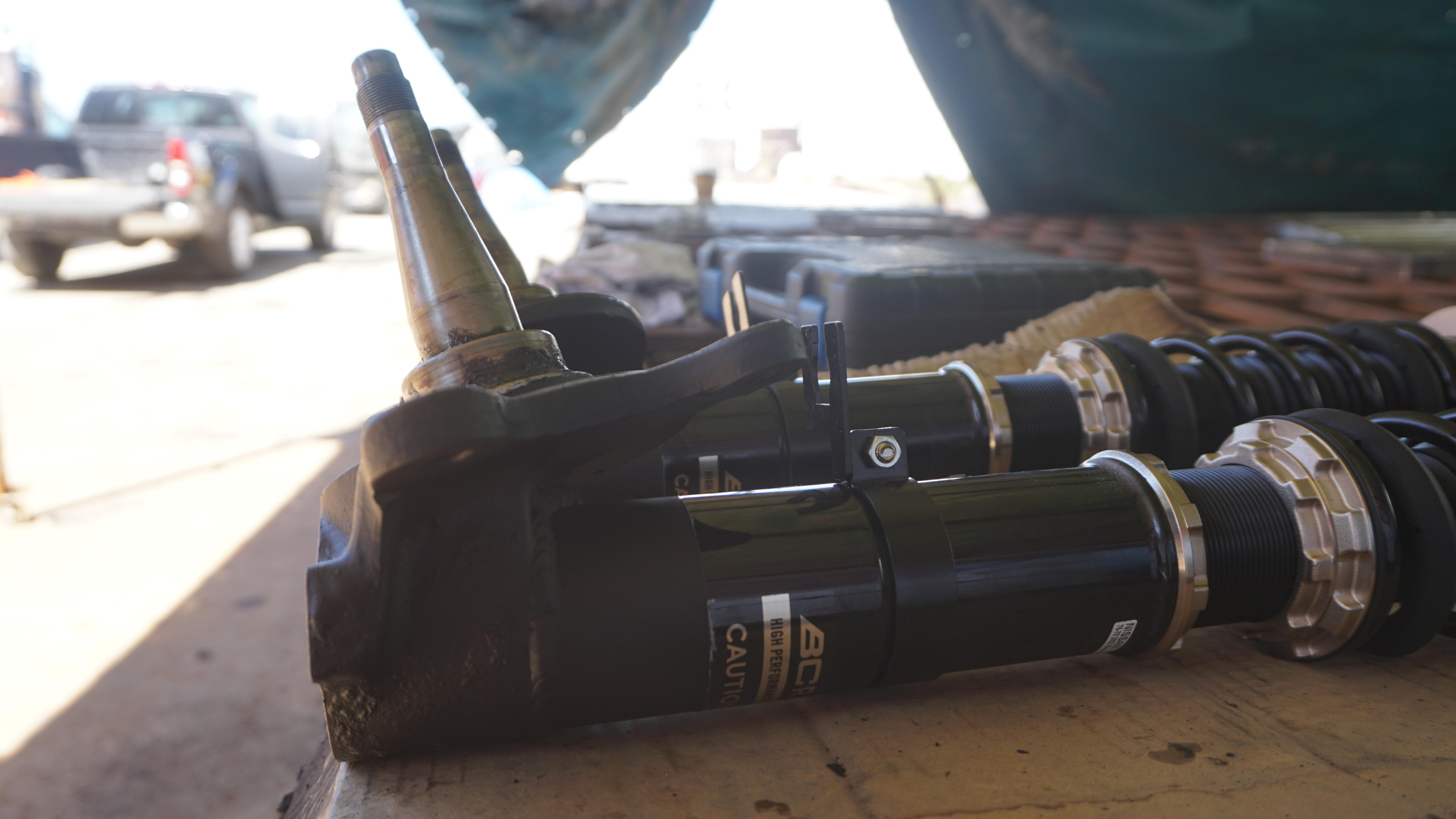

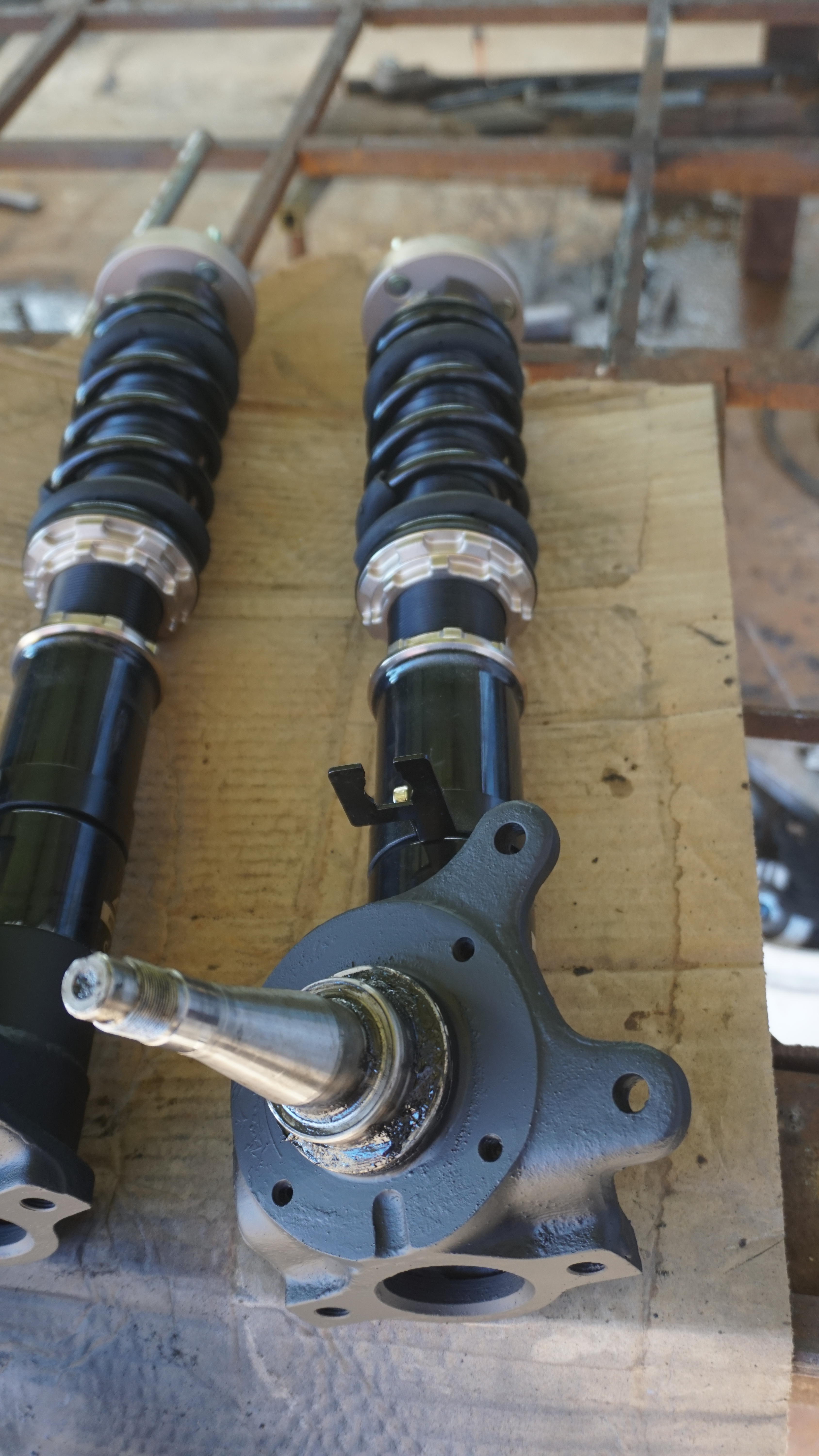

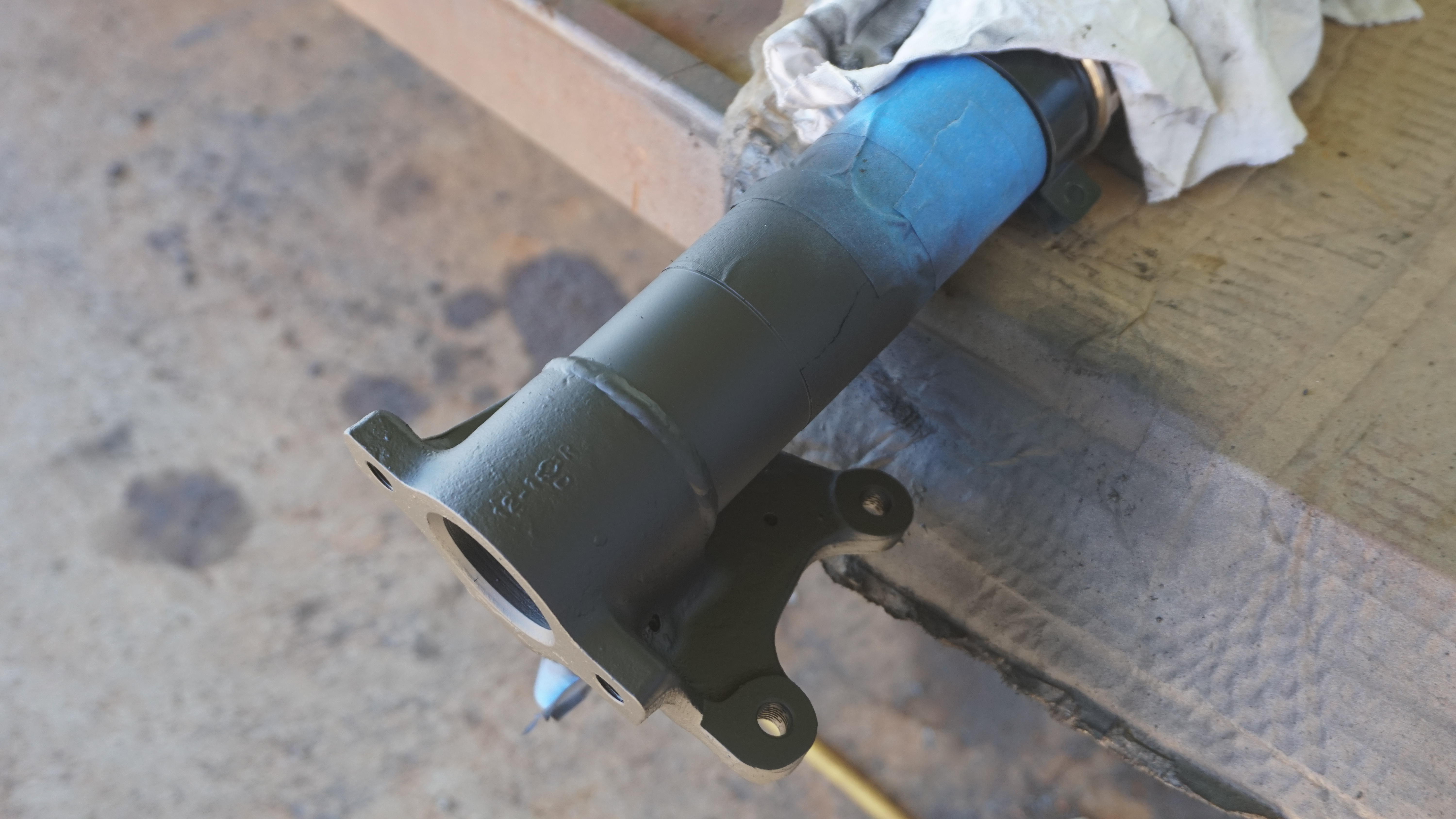

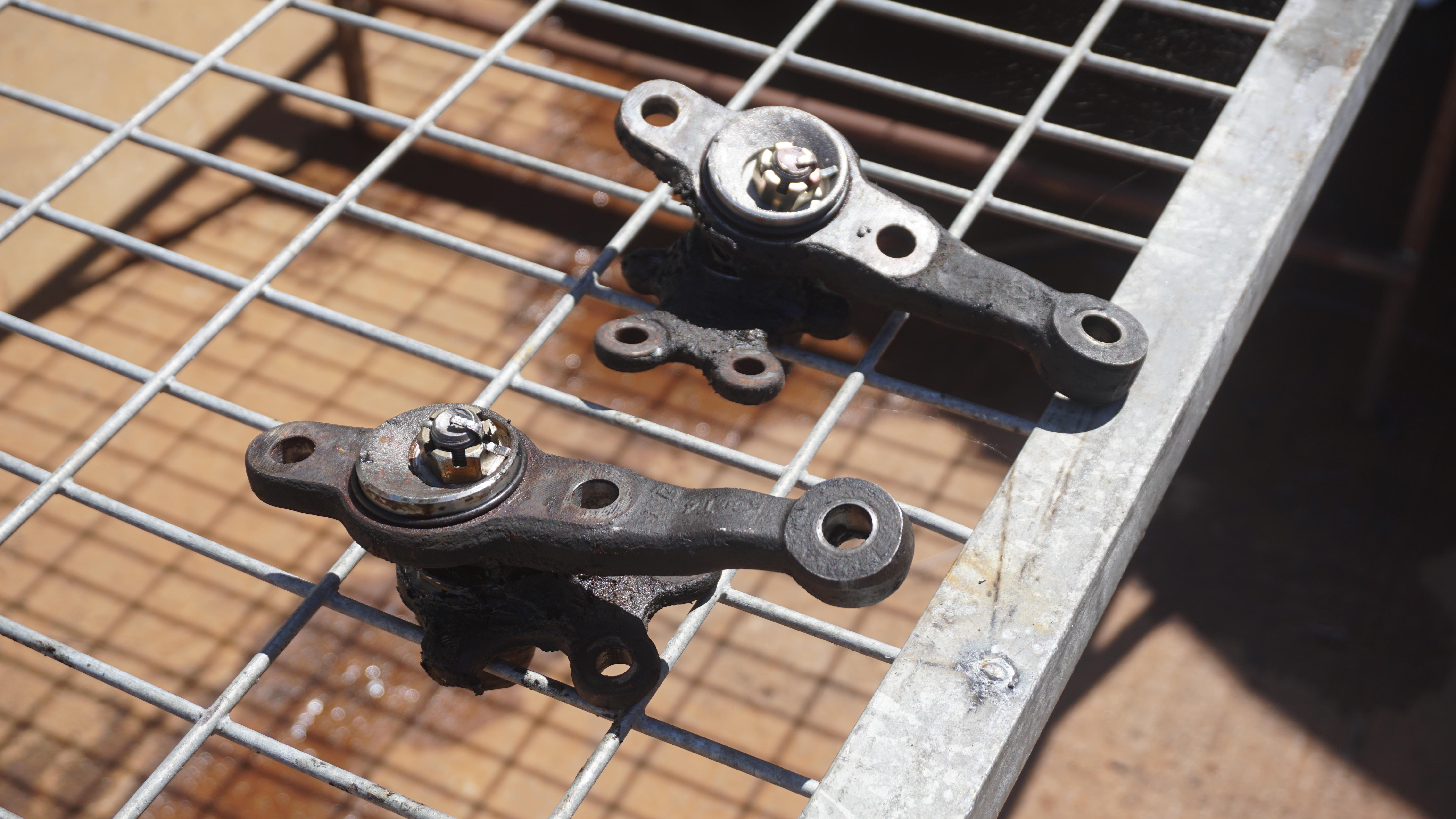

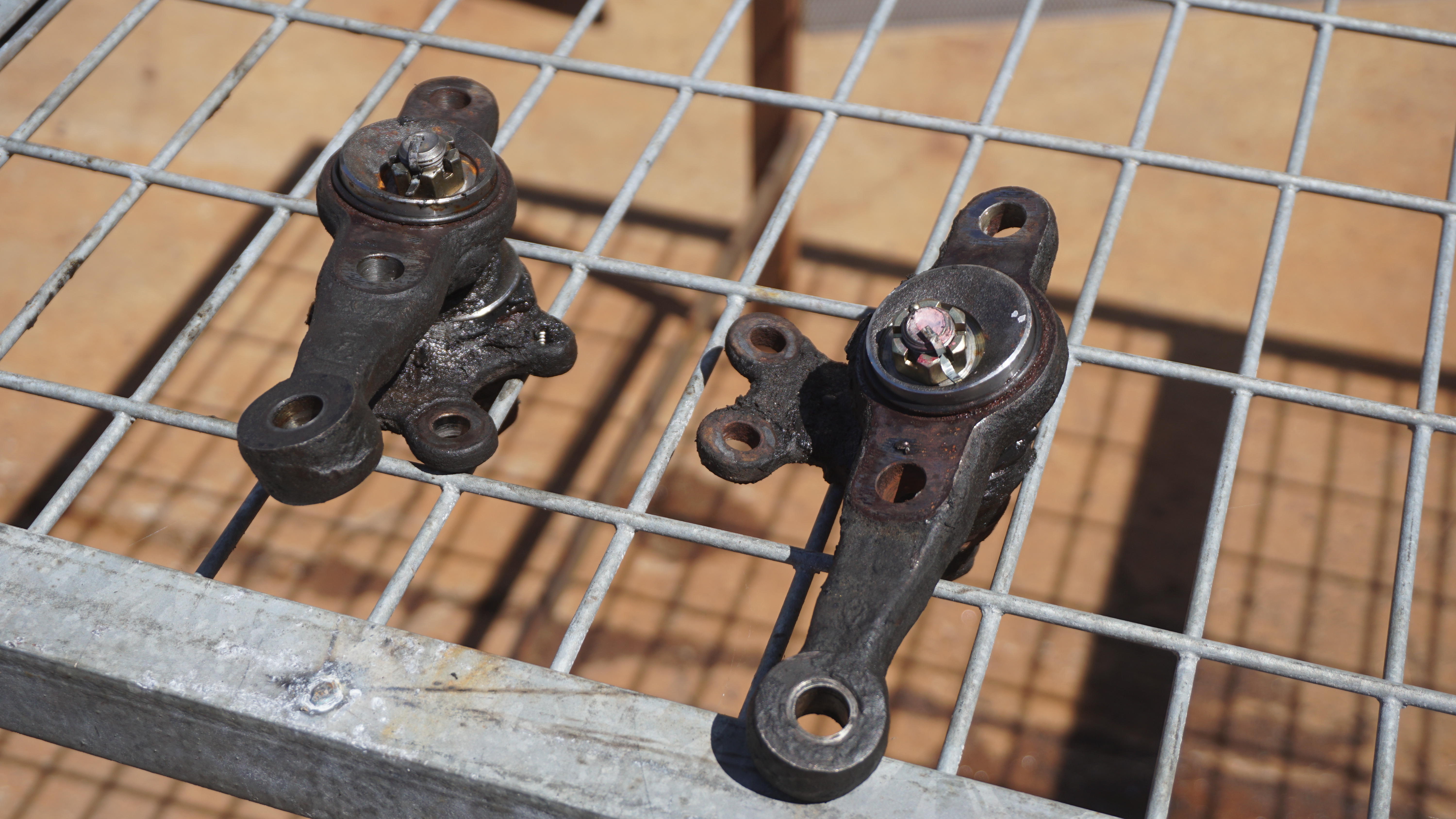

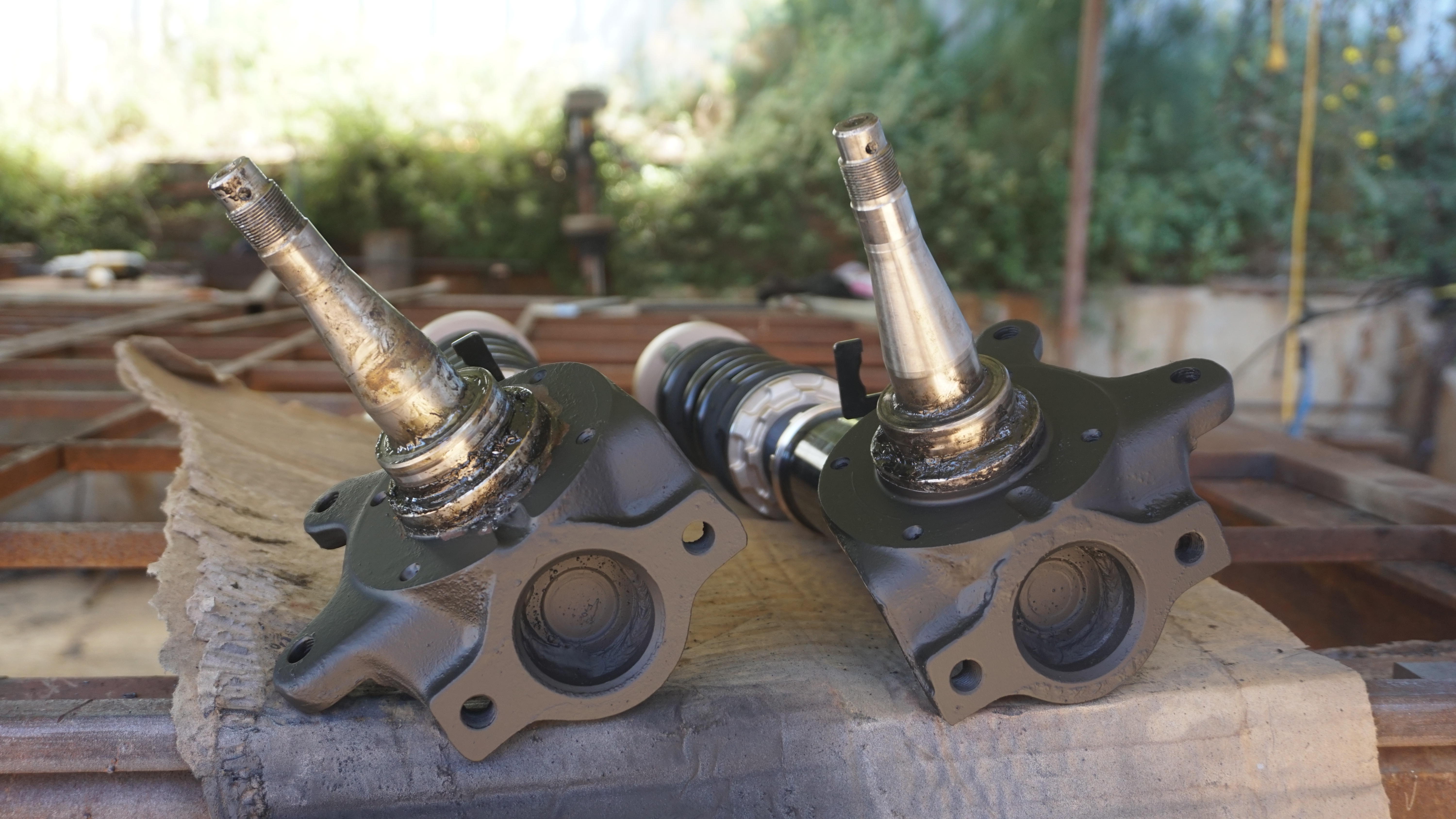

August 5, 20195 yr Author comment_581194 Not entirely sure what to do with the ball joints and steering knuckle. They look in ok shape, so considering just giving them a quick clean up before putting everything back together. Any thoughts? They're not expensive so is it worth replacing since everything's apart anyway? Link to comment https://www.classiczcars.com/forums/topic/60500-california-1978-datsun-280z-restomod/?&page=10#findComment-581194 Share on other sites More sharing options...
August 5, 20195 yr comment_581199 If they're tight and look ok with good boots, I might run them for a while. They will get replaced eventually if you put enough miles on it Link to comment https://www.classiczcars.com/forums/topic/60500-california-1978-datsun-280z-restomod/?&page=10#findComment-581199 Share on other sites More sharing options...
August 5, 20195 yr comment_581202 On 8/5/2019 at 12:15 AM, Kevin McSweeney said: They're not expensive so is it worth replacing since everything's apart anyway? You are in there now and they don't cost too much. Link to comment https://www.classiczcars.com/forums/topic/60500-california-1978-datsun-280z-restomod/?&page=10#findComment-581202 Share on other sites More sharing options...

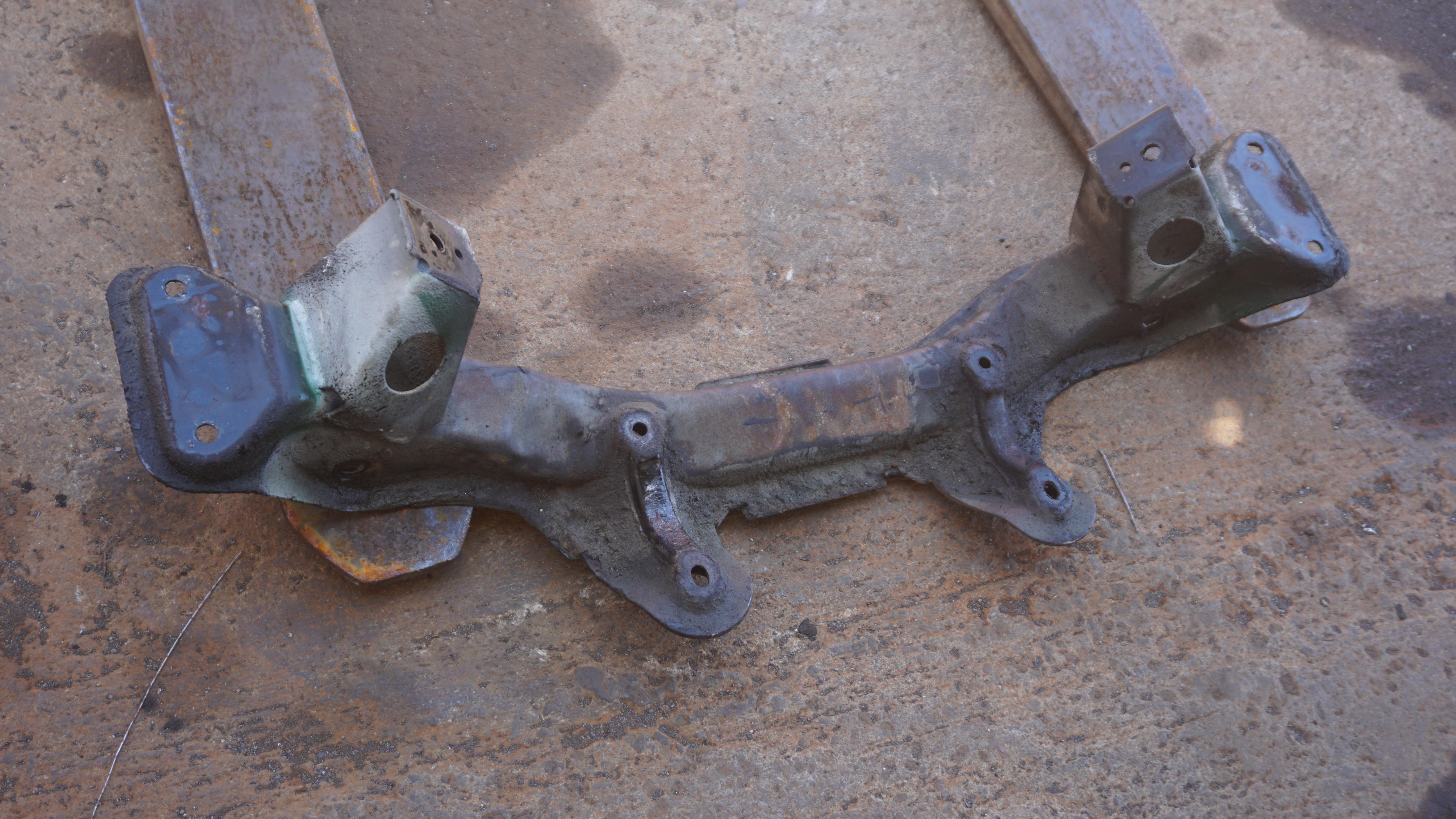

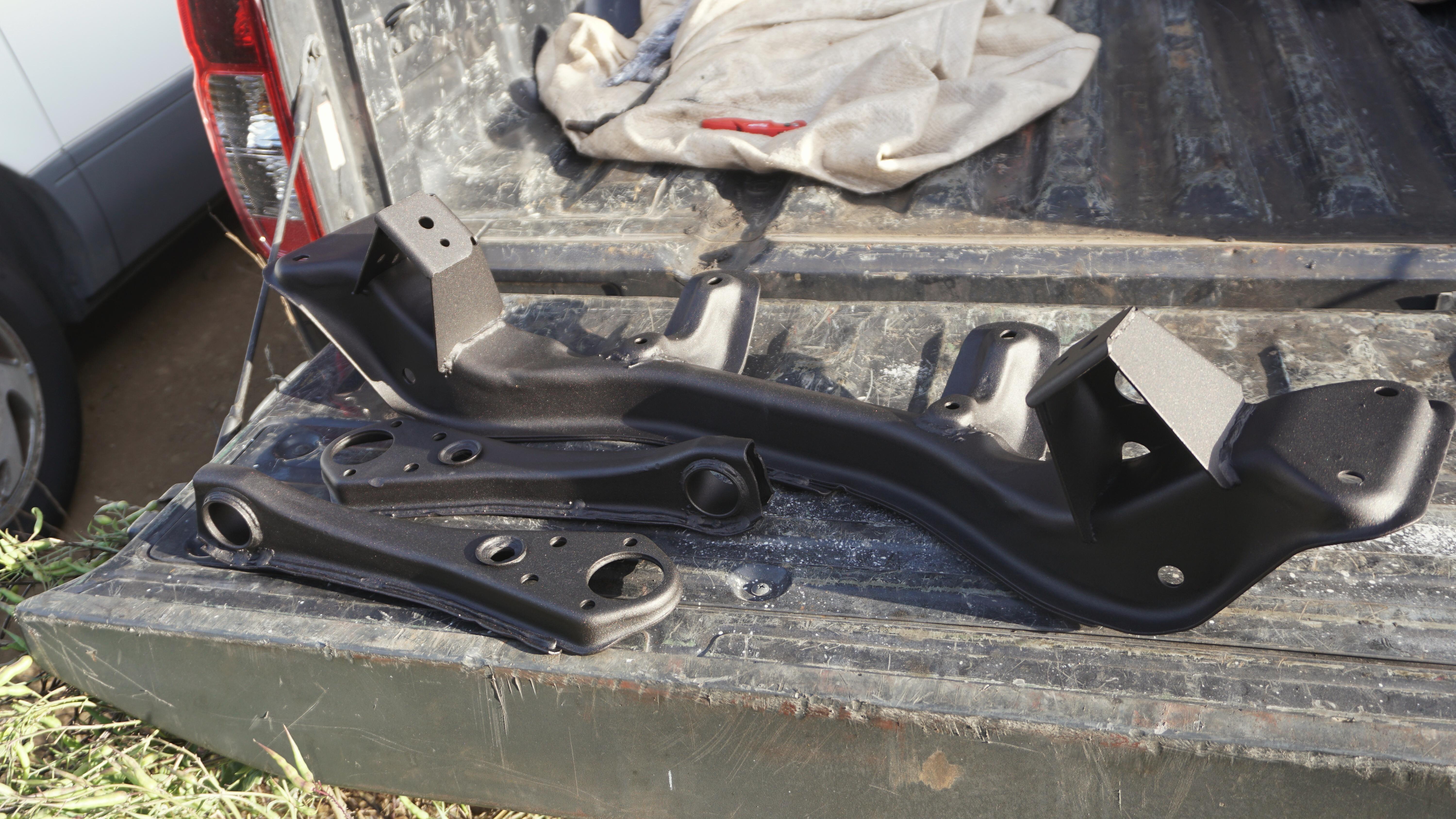

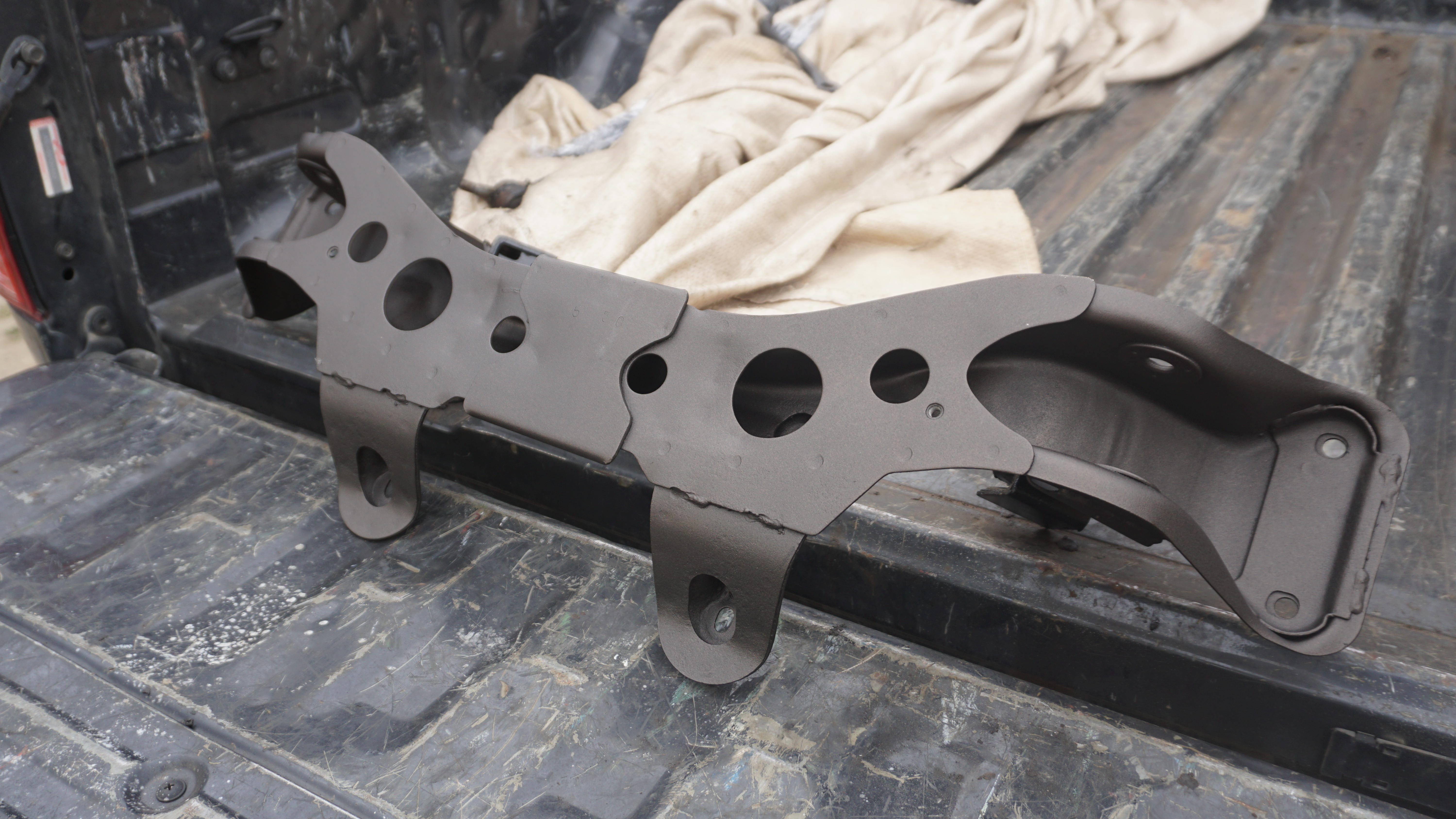

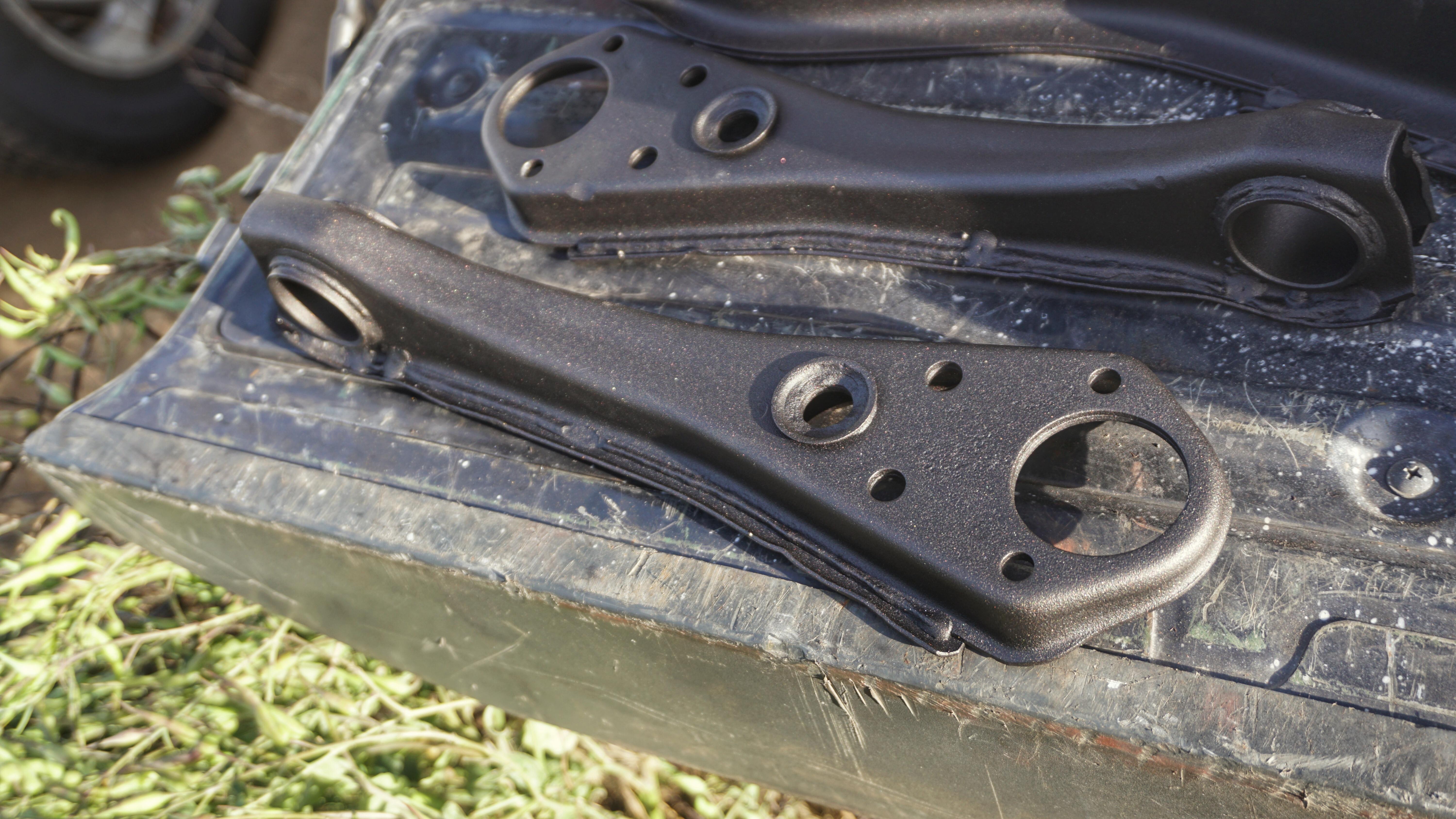

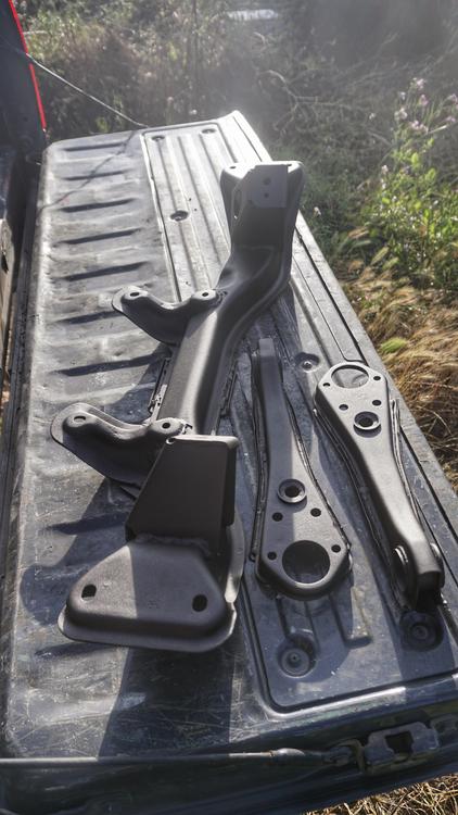

August 9, 20195 yr Author comment_581539 Cross member, control arms, TC rods, sway bar and some other parts freshly sandblasted and powder coated. Ready for new bushings tomorrow and hopefully get the front end reinstalled over the weekend. Link to comment https://www.classiczcars.com/forums/topic/60500-california-1978-datsun-280z-restomod/?&page=10#findComment-581539 Share on other sites More sharing options...
August 9, 20195 yr comment_581560 On 8/9/2019 at 2:02 AM, Kevin McSweeney said: Ready for new bushings tomorrow and hopefully get the front end reinstalled over the weekend. It looks like the powder coating got on the inside surface where the bushing goes, if you are using a hydraulic press to set the bushing then it probably won't be a problem, if you are doing it manually with a vice then you might want to scrape the coating off. It is a very tight fit. Link to comment https://www.classiczcars.com/forums/topic/60500-california-1978-datsun-280z-restomod/?&page=10#findComment-581560 Share on other sites More sharing options...
August 9, 20195 yr comment_581567 Looks great. But whatever process you're using to install new bushings, I think you should get the coating out of the bushing holes first. Even if you're using a hydraulic press. Link to comment https://www.classiczcars.com/forums/topic/60500-california-1978-datsun-280z-restomod/?&page=10#findComment-581567 Share on other sites More sharing options...

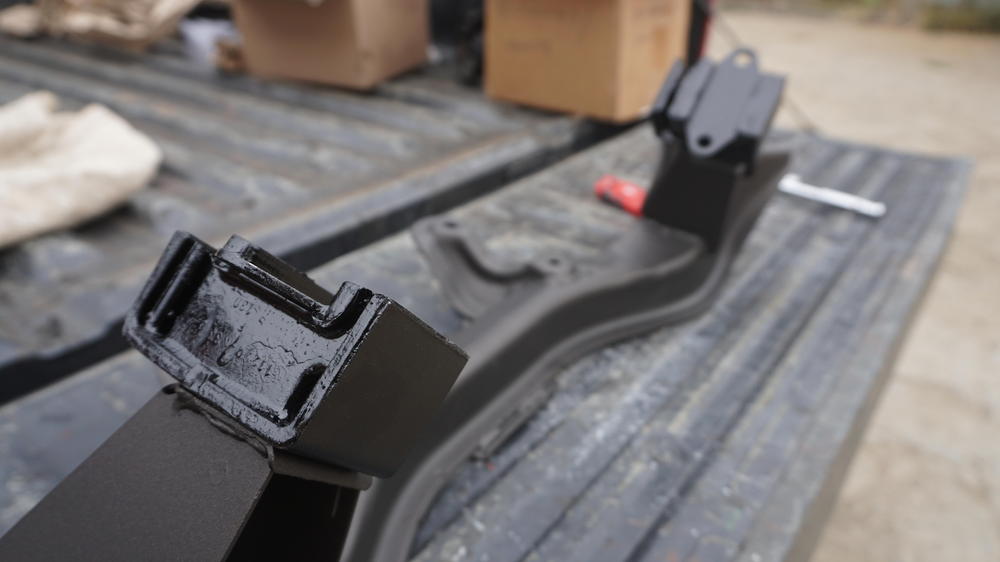

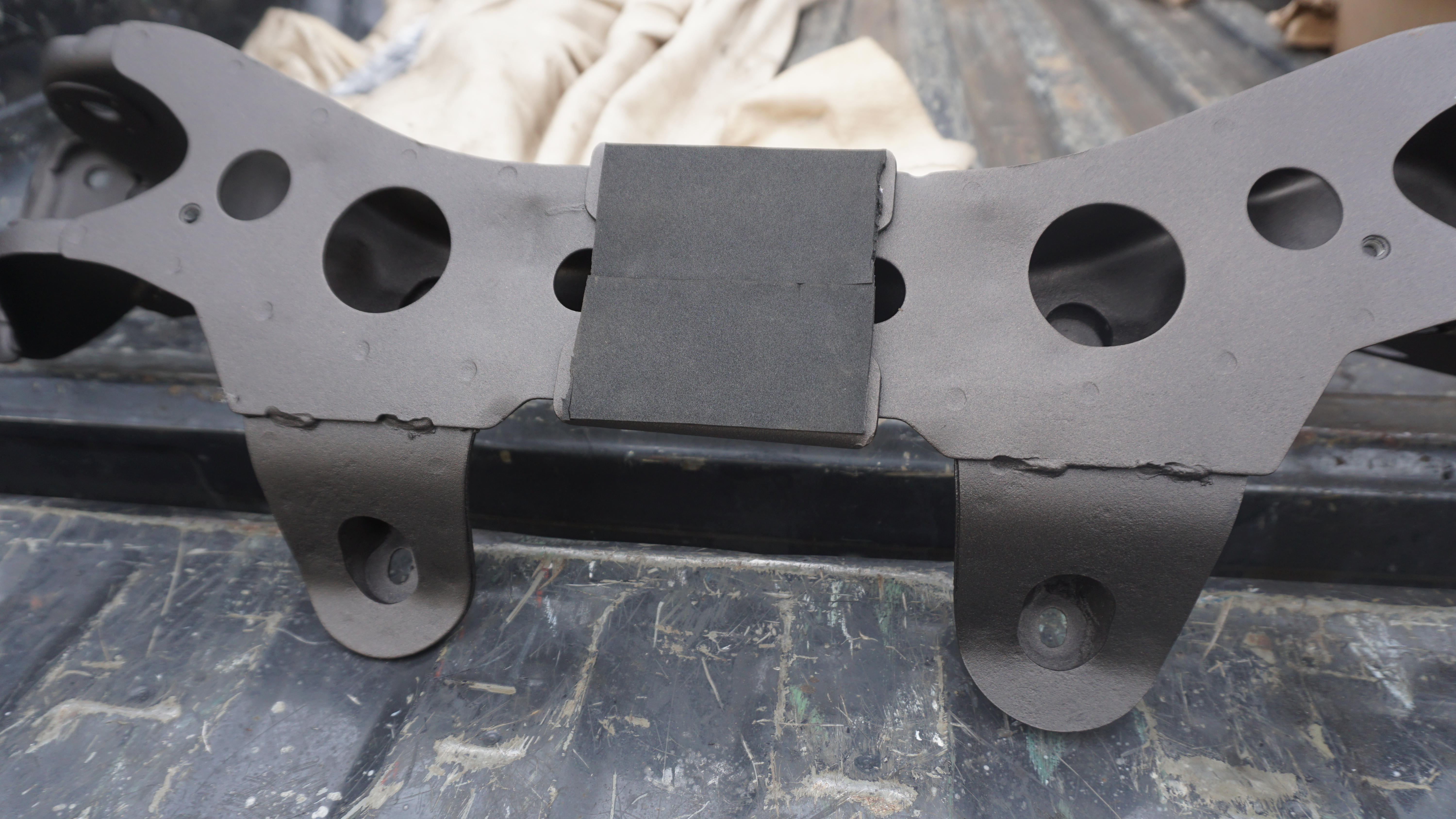

August 9, 20195 yr Author comment_581572 On 8/9/2019 at 1:43 PM, Captain Obvious said: Looks great. But whatever process you're using to install new bushings, I think you should get the coating out of the bushing holes first. Even if you're using a hydraulic press. I've already taken the coating out of this area. Bushings are being pressed right now. Also got my new engine mount insulators bolted up, and for some reason I felt compelled to use some more of the foam I used on the fuel tank straps on the jacking point of the cross member. I guess in my head it's going to stay in this condition ? Edited August 9, 20195 yr by Kevin McSweeney Link to comment https://www.classiczcars.com/forums/topic/60500-california-1978-datsun-280z-restomod/?&page=10#findComment-581572 Share on other sites More sharing options...
August 10, 20195 yr comment_581608 On 8/9/2019 at 3:21 PM, Kevin McSweeney said: I felt compelled to use some more of the foam on the jacking point of the cross member. Haha! I got no problem with that! As good as it looks, try to keep it that way! Piece of wood between the jack and the foam pad and it'll last for a little while. Edited August 10, 20195 yr by Captain Obvious Link to comment https://www.classiczcars.com/forums/topic/60500-california-1978-datsun-280z-restomod/?&page=10#findComment-581608 Share on other sites More sharing options...

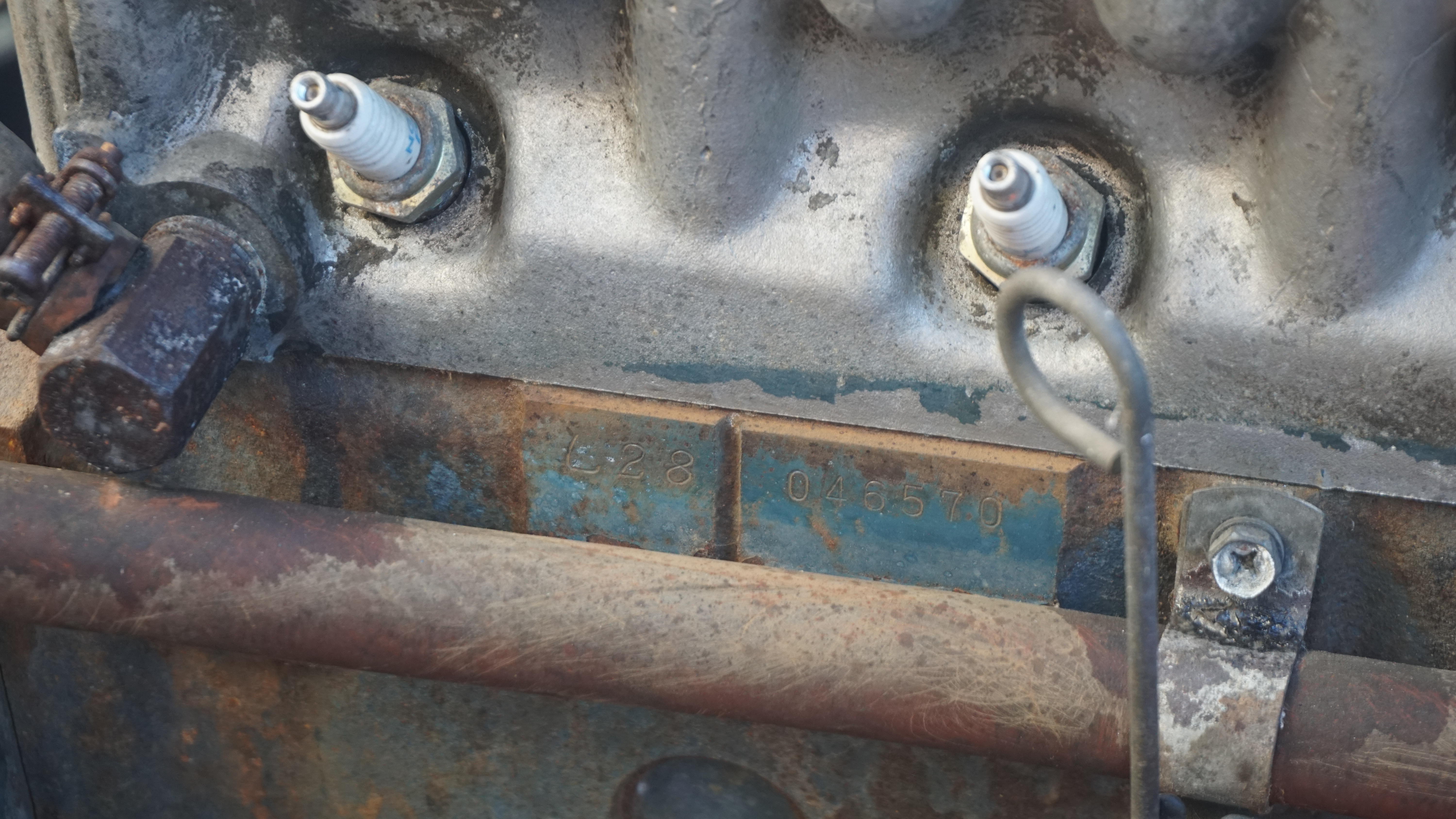

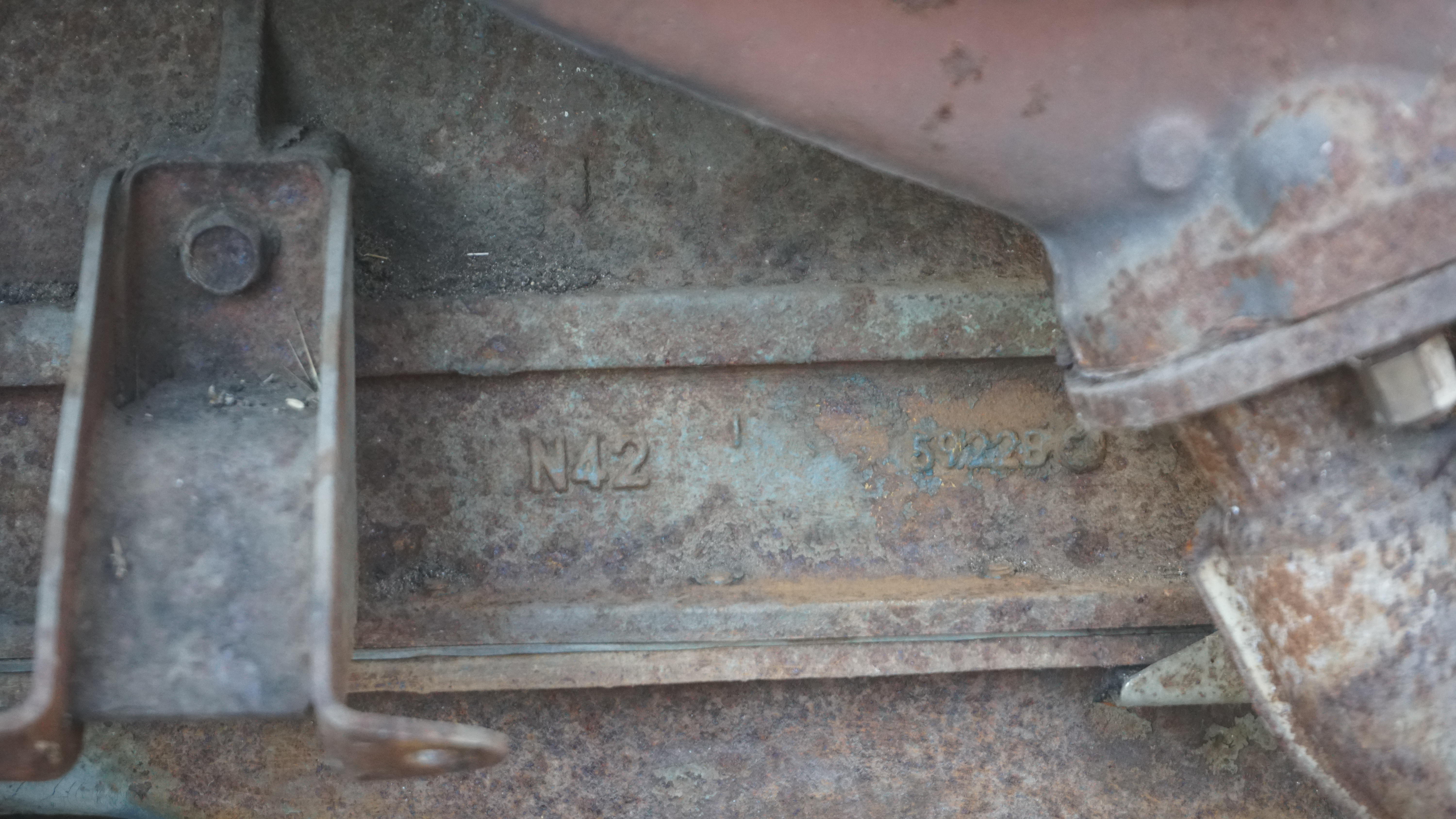

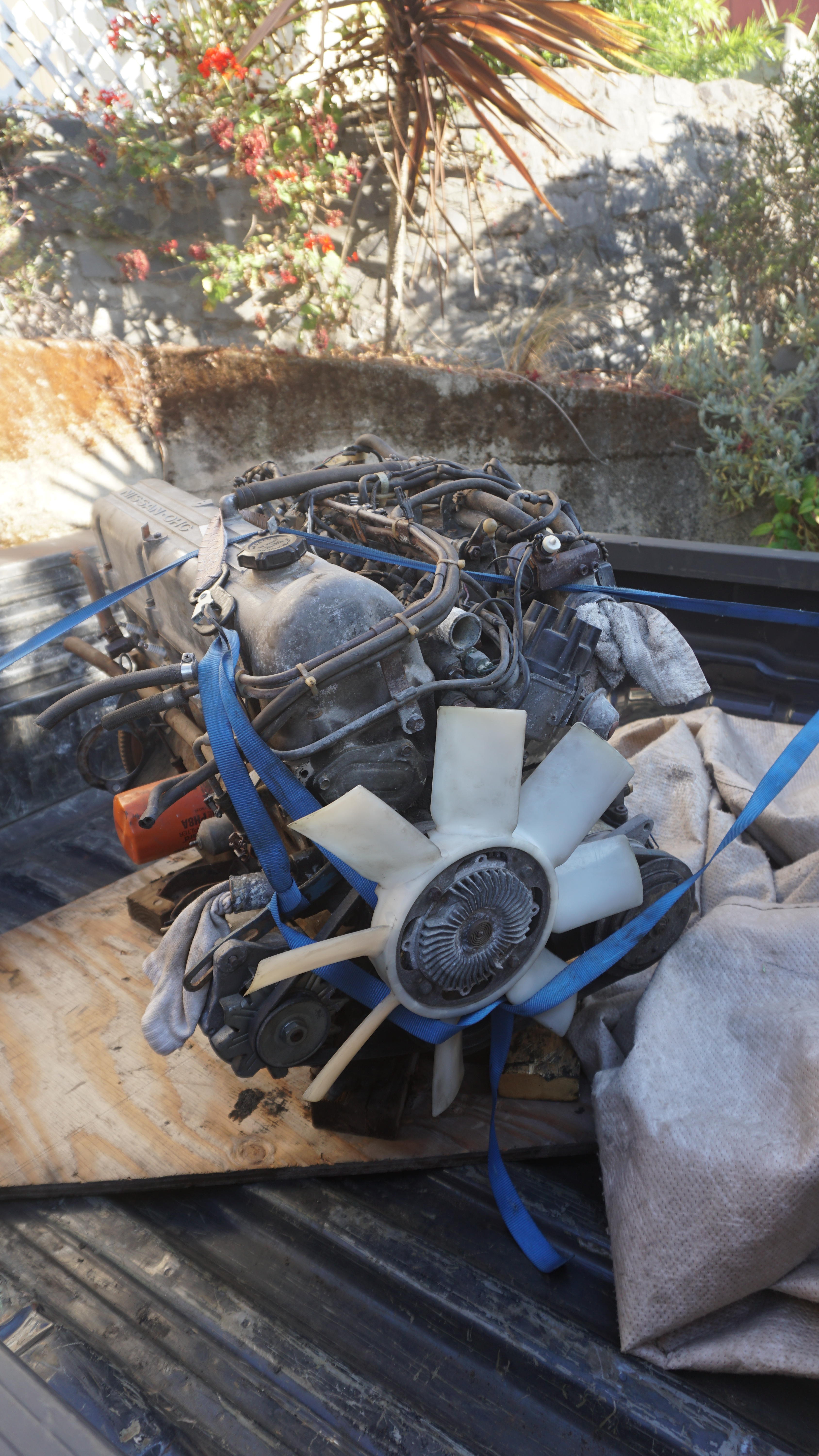

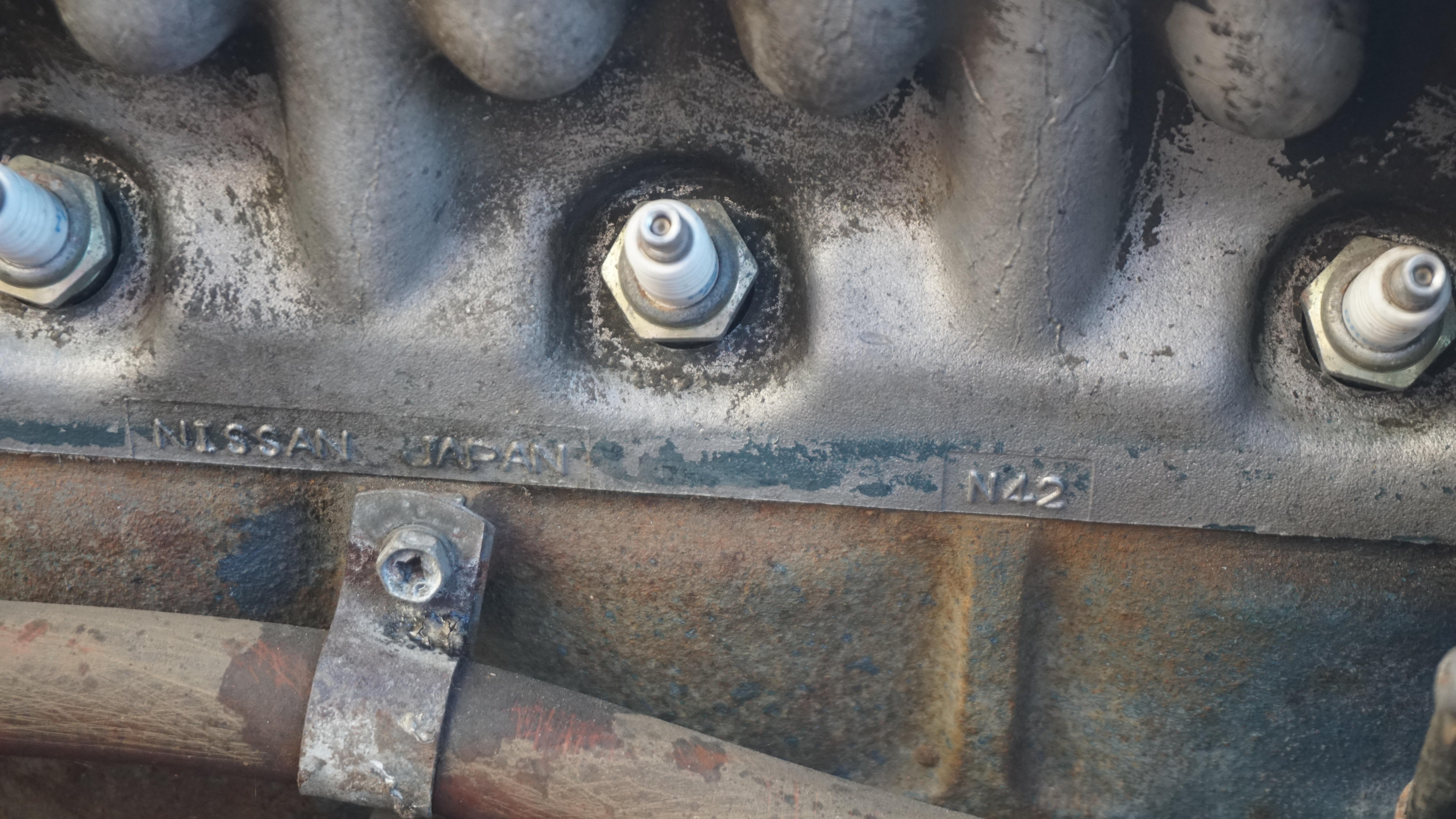

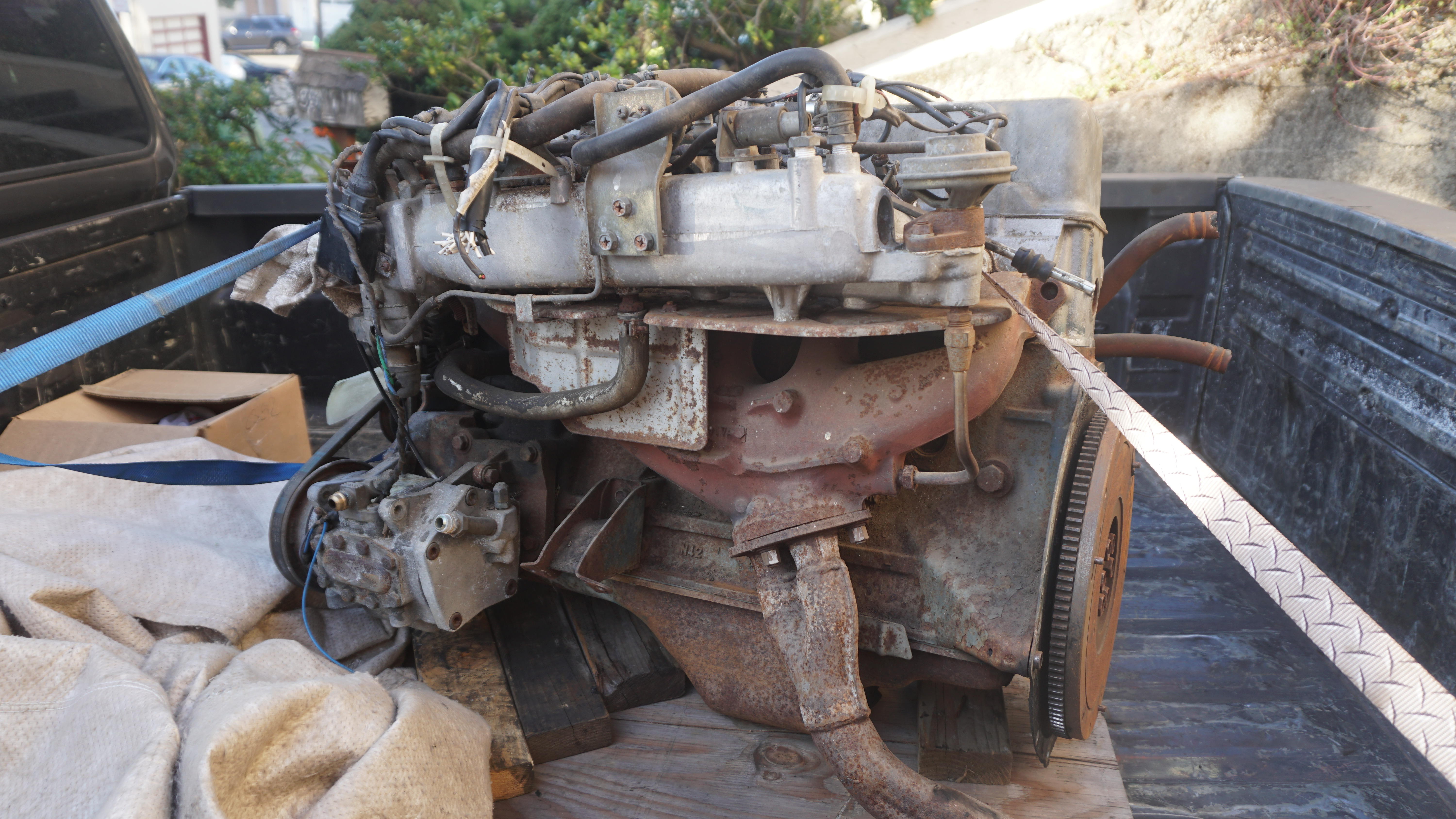

August 12, 20195 yr Author comment_581710 Took a Sunday drive down PCH to pick up a second L28 - N42/N42 today. Plan is to build this into a 200hp+ NA motor in parallel with the build and in 12-18 months to upgrade to Megasquirt and drop this motor in. Most of the accessories (alternator, AC compressor, clutch fan, valve cover, flywheel, fuel rail, exhaust manifold, etc.) will be coming up for sale so if anybody needs anything let me know. Edited August 12, 20195 yr by Kevin McSweeney Link to comment https://www.classiczcars.com/forums/topic/60500-california-1978-datsun-280z-restomod/?&page=10#findComment-581710 Share on other sites More sharing options...
August 12, 20195 yr comment_581749 Is that a Craigslist find? Looks like it was already out and sitting. Rusty flywheel. Looks complete. Those EGR pipes and parts can be valuable. They tend to get mangled on removal. Link to comment https://www.classiczcars.com/forums/topic/60500-california-1978-datsun-280z-restomod/?&page=10#findComment-581749 Share on other sites More sharing options...
