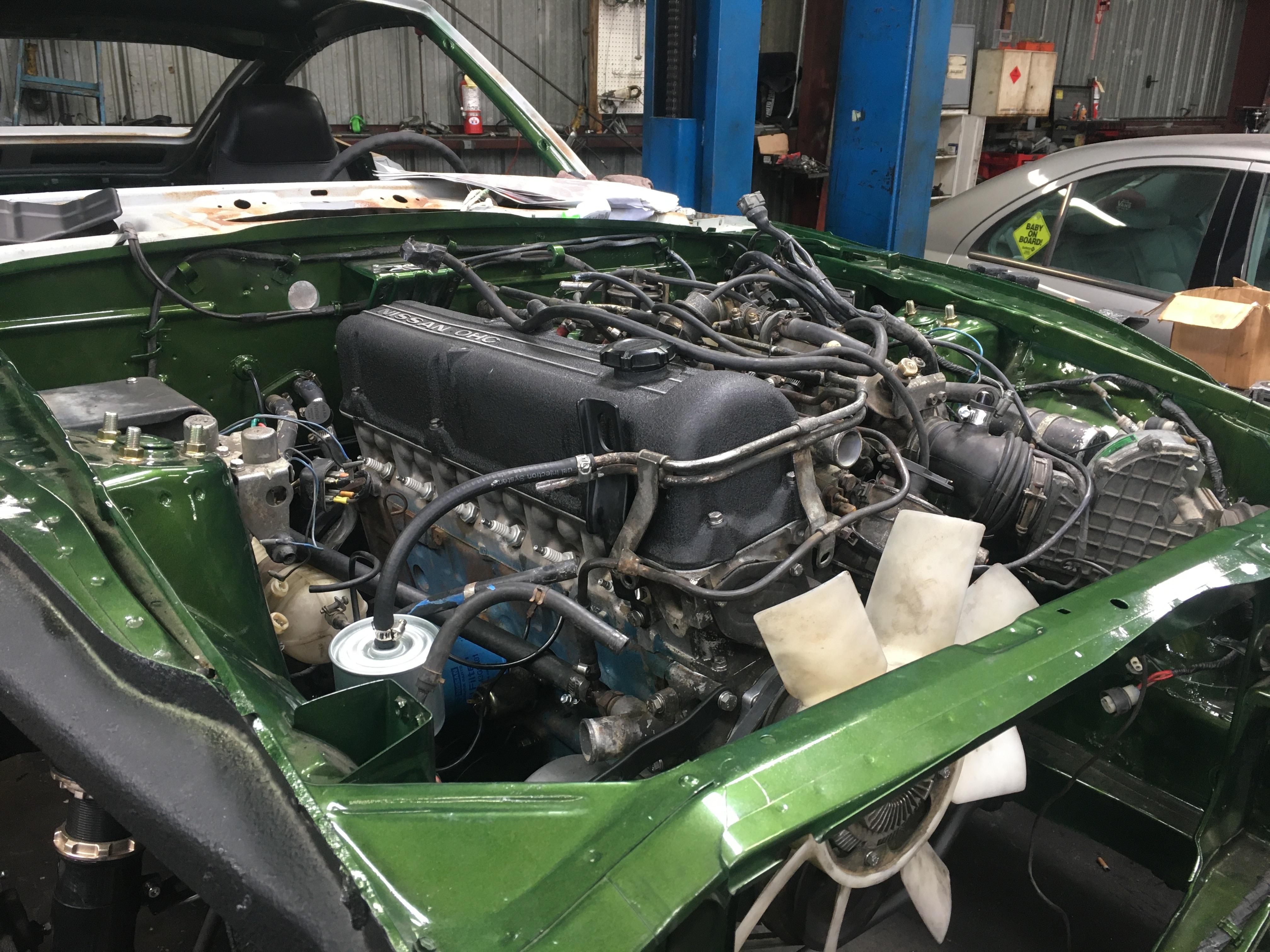

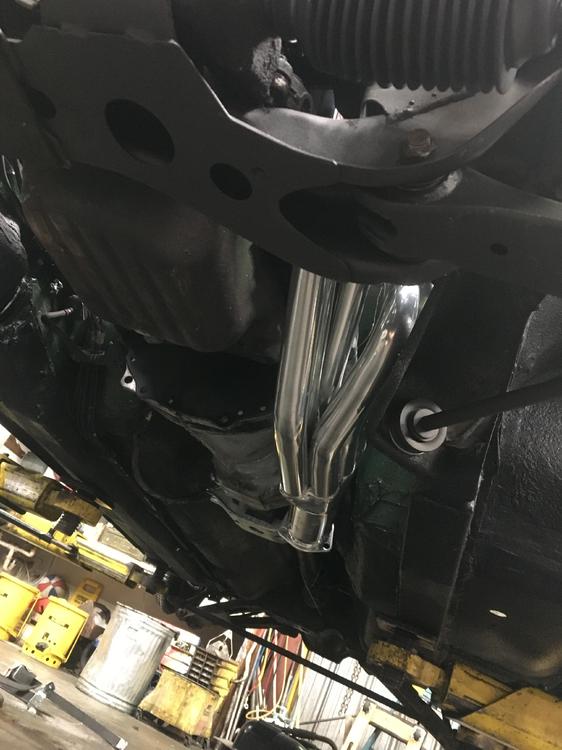

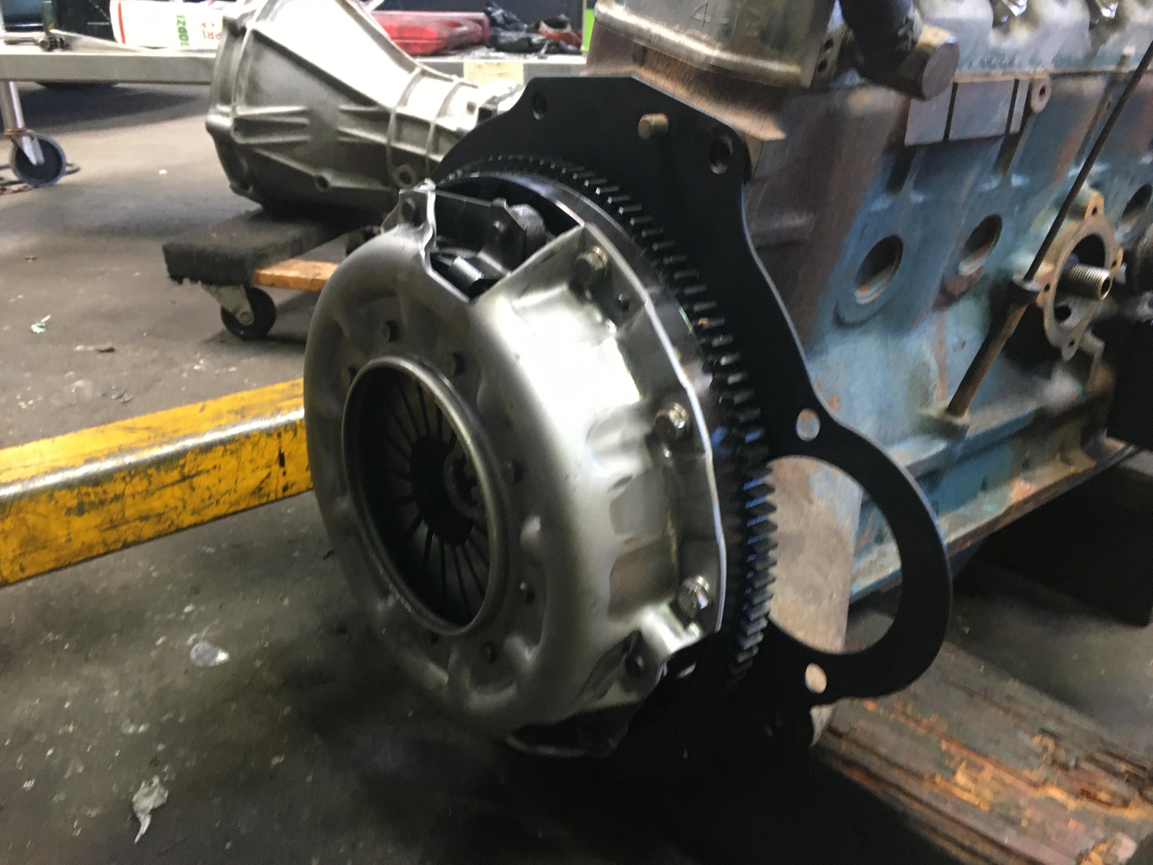

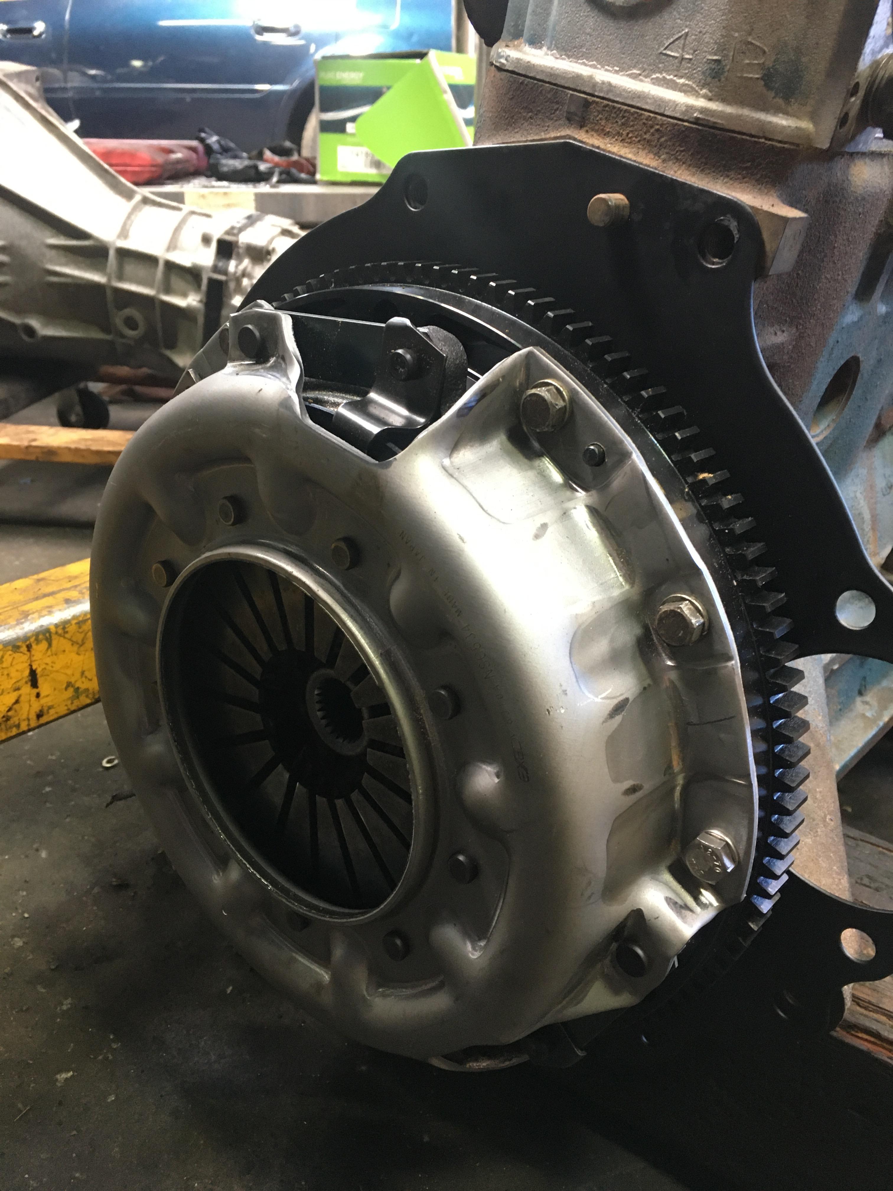

March 7, 20205 yr Author comment_593822 It's been a long time since I updated this, but I have been working on it between actual paid work, moving house, travelling, buying another Z (Z32 Twin Turbo) etc. Anyway, drivetrain is back in! Yes, I wish it was a more complete rebuild - but as I said in a previous post - I do want to actually get this on the road this year, and I'm building a second motor on the side. For now, we have a new clutch, flywheel, driveshaft, cleaned up transmission. Motor has new front and rear main seals, timing set, water pump, oil pump, valve cover gasket, alternator and belt, oil and fuel filters, etc.. Also got the ceramic coated 6-1 headers installed. Waiting on my MSA mandrel bent system and Zstory JDM muffler. I do have a Pallnet fuel rail, but decided to install the stock one for now until I get things up and running. Wiring still a bit of a mess, but getting closer. Link to comment https://www.classiczcars.com/forums/topic/60500-california-1978-datsun-280z-restomod/?&page=12#findComment-593822 Share on other sites More sharing options...

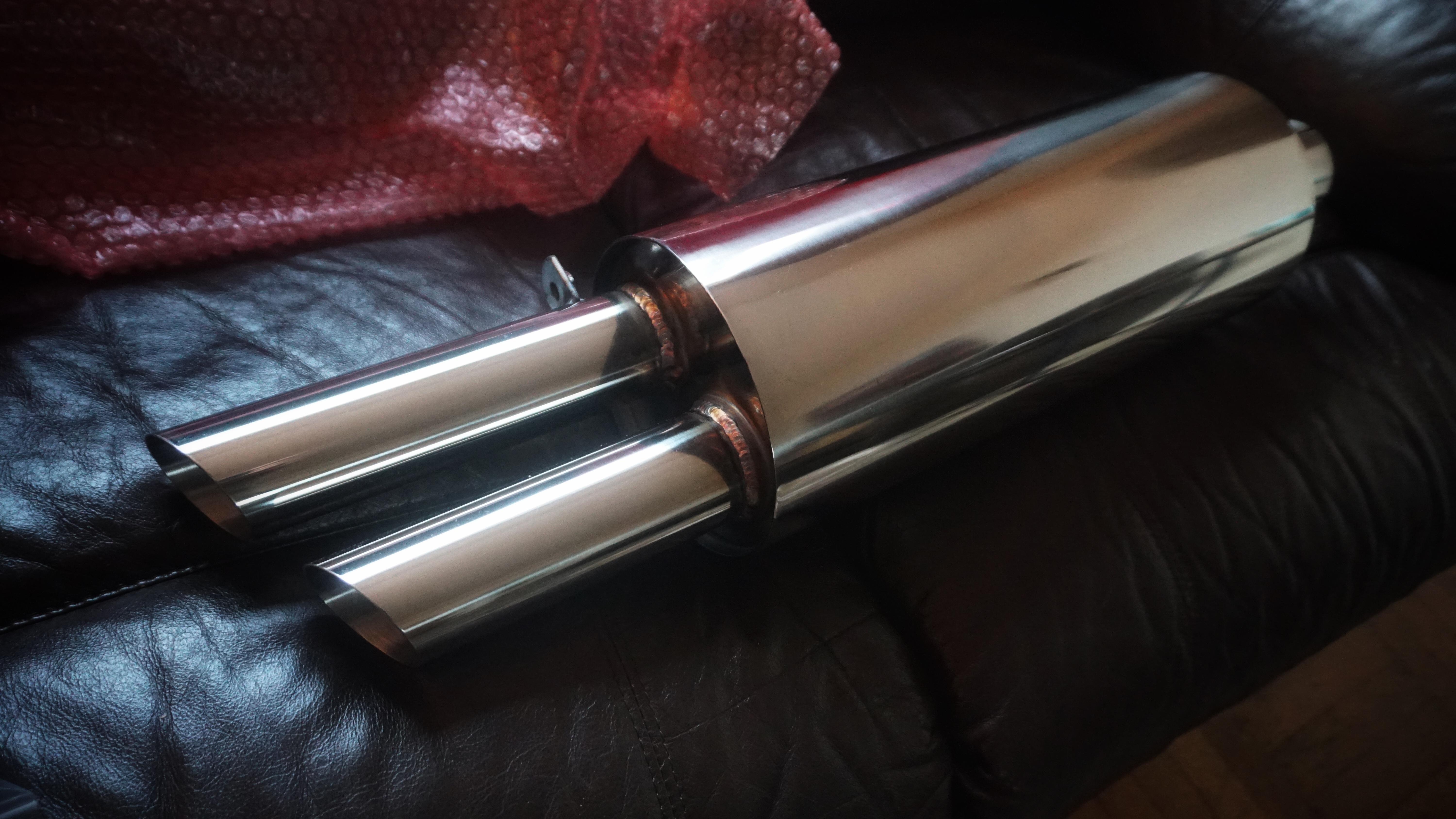

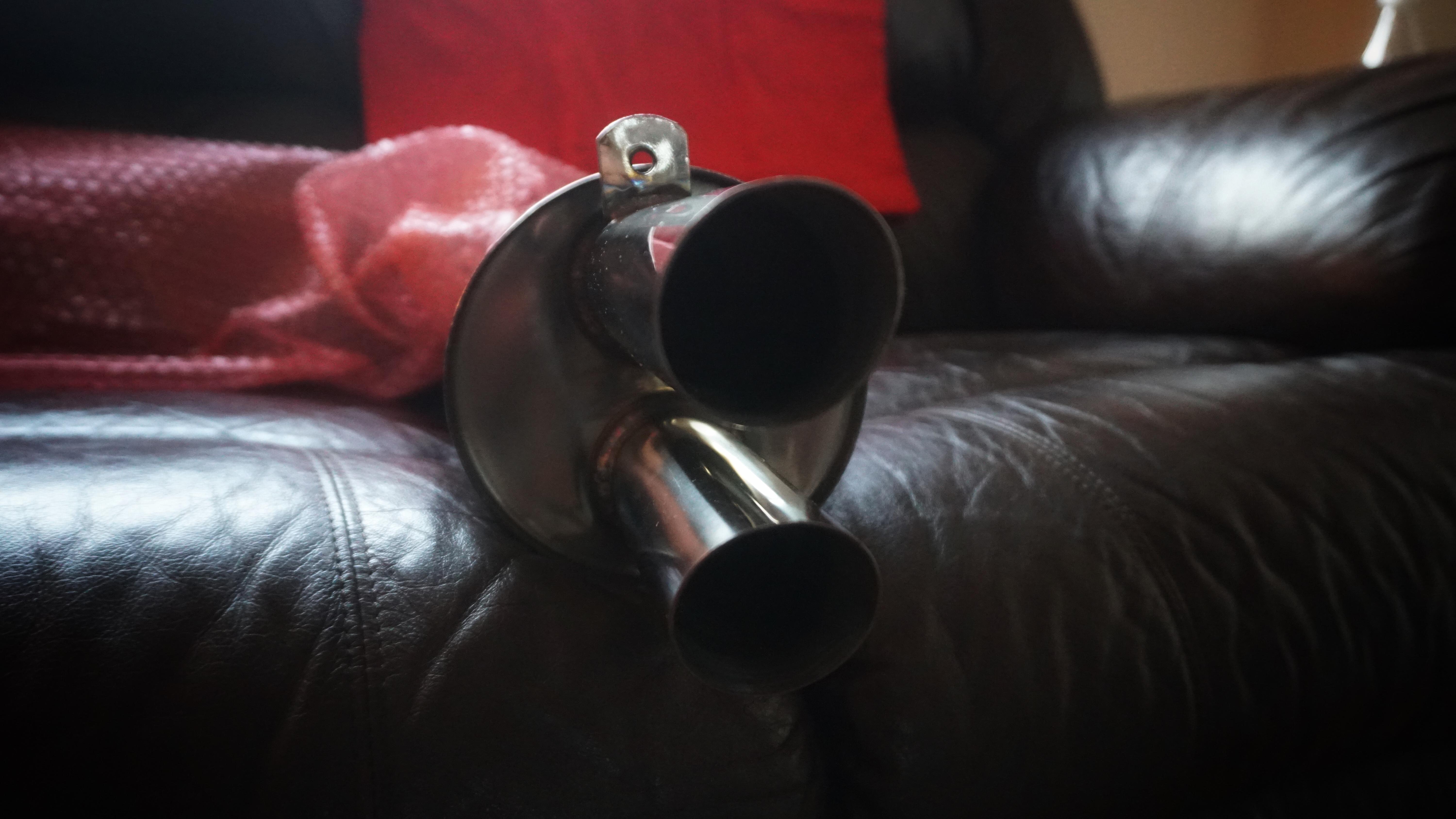

March 25, 20205 yr Author comment_595322 Just received my JDM muffler from Sean at ZStory. Very nice work and great service! Link to comment https://www.classiczcars.com/forums/topic/60500-california-1978-datsun-280z-restomod/?&page=12#findComment-595322 Share on other sites More sharing options...

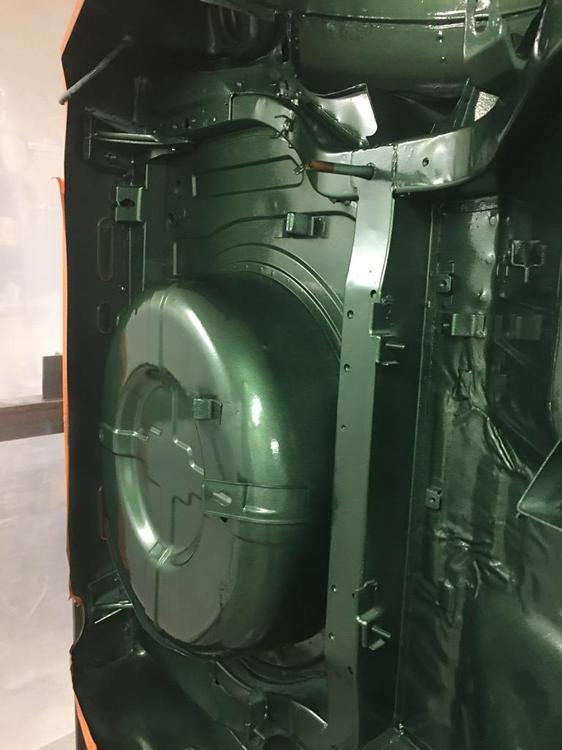

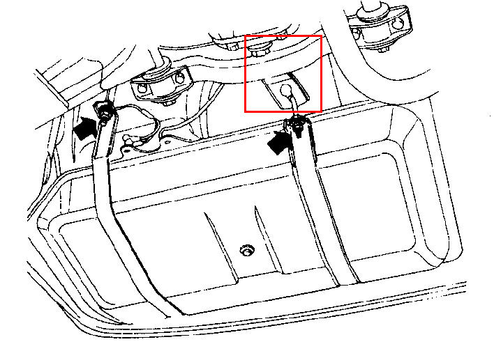

March 31, 20204 yr Author comment_595952 I'm in the process of reinstalling the fuel system this week, and came across a missing part. See attached picture from the FSM. I can't find any reference to this 'bracket' that the fuel tank strap bolt actually connects to. Specifically on the passenger side. Looks like it bolts thru on the front side. Anybody have any more information on this part? Link to comment https://www.classiczcars.com/forums/topic/60500-california-1978-datsun-280z-restomod/?&page=12#findComment-595952 Share on other sites More sharing options...
March 31, 20204 yr comment_595957 43 and 44? http://www.carpartsmanual.com/datsun/Z-1969-1978/engine-280z/fuel-tank/from-jul-76 Link to comment https://www.classiczcars.com/forums/topic/60500-california-1978-datsun-280z-restomod/?&page=12#findComment-595957 Share on other sites More sharing options...
March 31, 20204 yr Author comment_595960 Just now, Zed Head said: 43 and 44? http://www.carpartsmanual.com/datsun/Z-1969-1978/engine-280z/fuel-tank/from-jul-76 43 and 44 are the fuel tank J-Bolts, correct? I have those. What I am asking about is what they actually bolt into on the side opposite the tank strap. Link to comment https://www.classiczcars.com/forums/topic/60500-california-1978-datsun-280z-restomod/?&page=12#findComment-595960 Share on other sites More sharing options...
March 31, 20204 yr comment_595961 One strap mount is dead centre in front of the spare wheel well. The other is in the frame itself across from the rearward mount. Sent from my iPhone using Tapatalk Link to comment https://www.classiczcars.com/forums/topic/60500-california-1978-datsun-280z-restomod/?&page=12#findComment-595961 Share on other sites More sharing options...

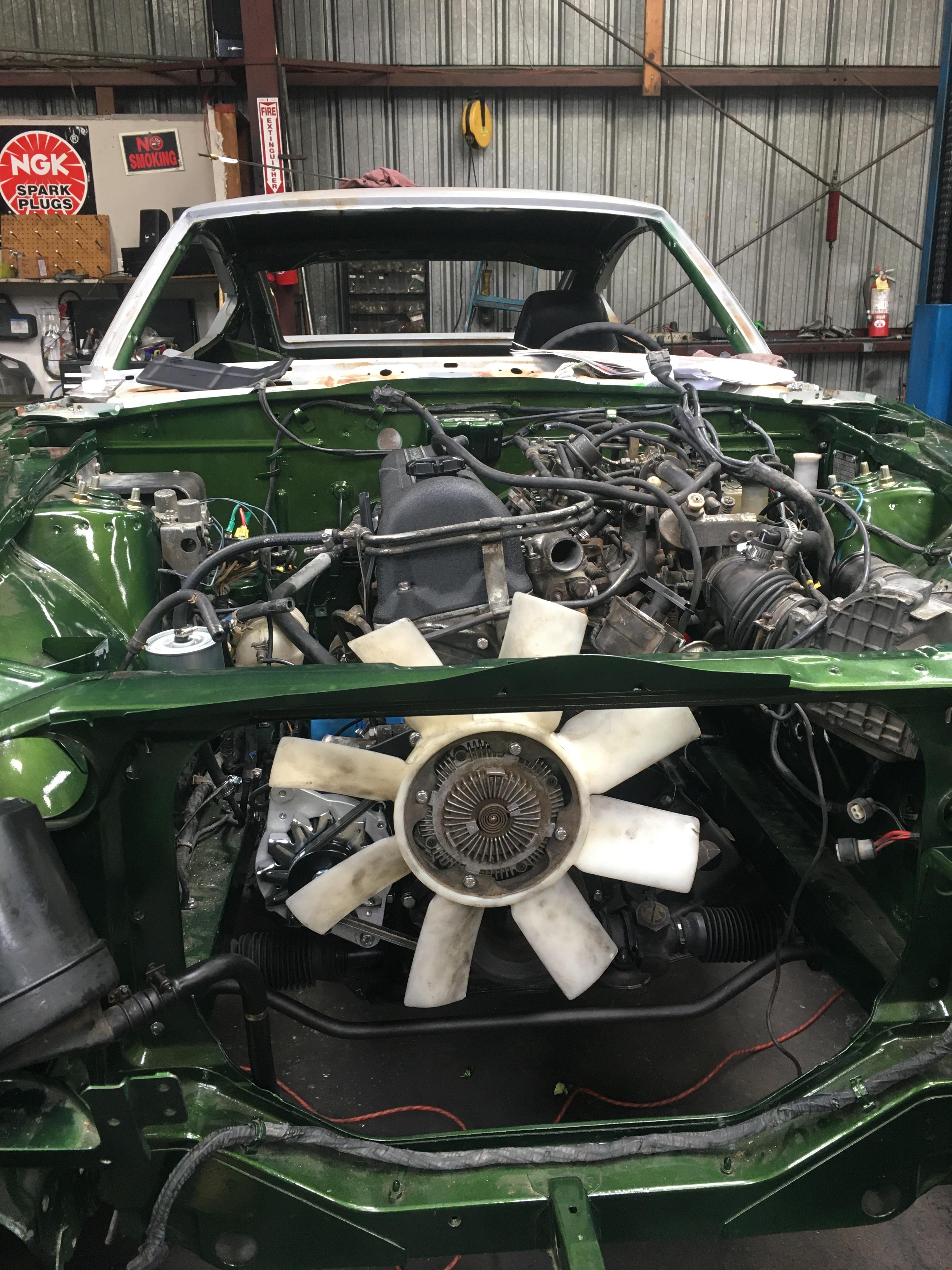

June 5, 20204 yr Author comment_600813 Some progress! Drivetrain buttoned up and now runs, drives and stops! Still a lot of tidying up to do on engine bay and as you can see from the photographs, fuel system isn't complete as there is some metal/bodywork to do around the filler area, and I still need to wire the fuel pump and find a new ignition relay. Anyway, moved the car under its own power yesterday for the first time in almost 2 years and she sounds good! She's now in the bodyshop and will be there for the next approximately 6 weeks for body and exterior paint. After that, going to a shop in Sacramento for a few button up items that I don't feel confident to tackle myself, with the hope of being on the road by end of the Summer! Link to comment https://www.classiczcars.com/forums/topic/60500-california-1978-datsun-280z-restomod/?&page=12#findComment-600813 Share on other sites More sharing options...

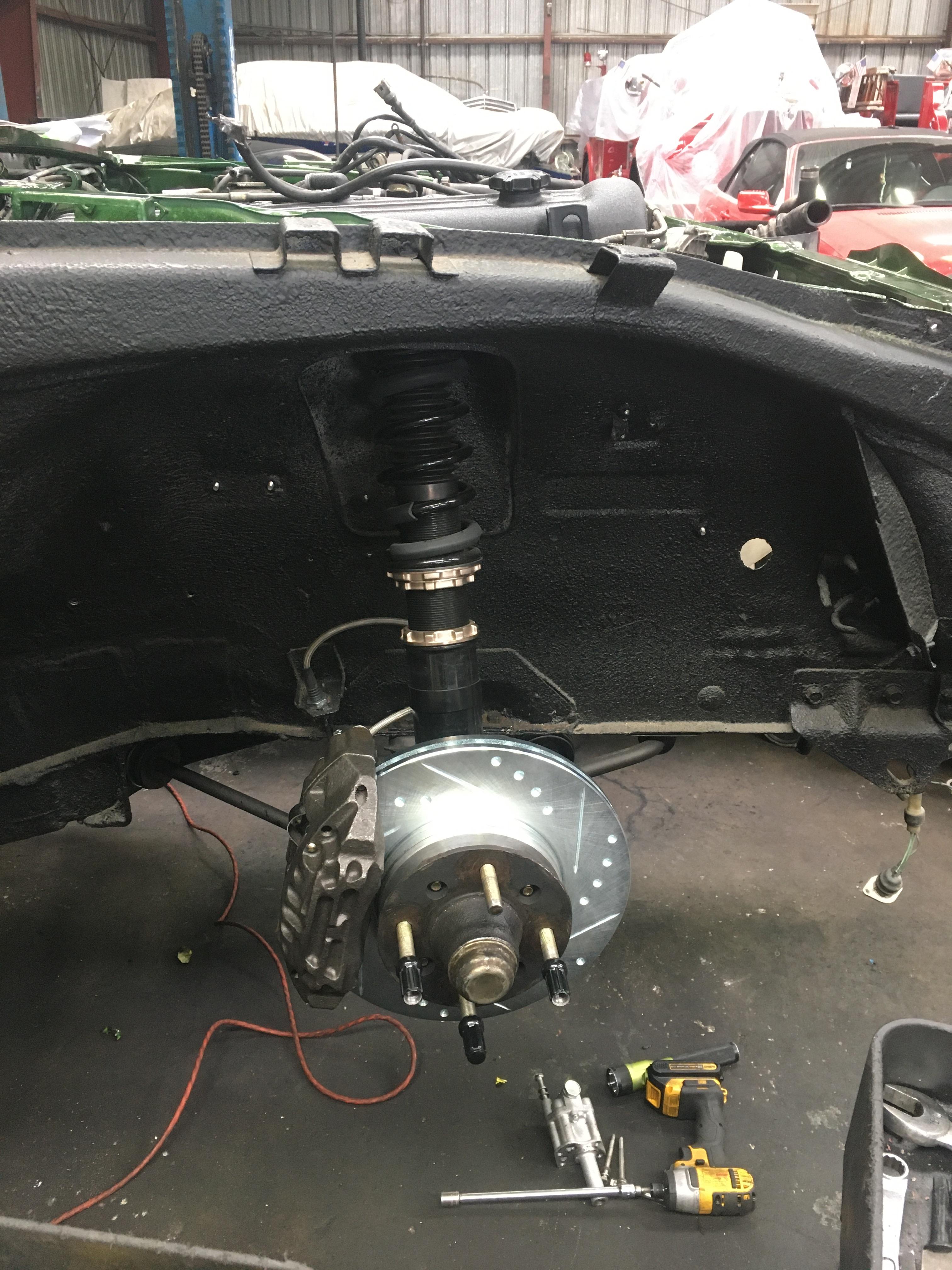

June 5, 20204 yr Author comment_600821 51 minutes ago, AZDatsun said: I think your drivers side front tires tread pattern is facing the wrong direction. Sent from my iPhone using Tapatalk Quite right, we swapped wheels around several times in the last few days without thinking about which side was correct! Actually, that does bring up a problem I'm having: I can't find lug nuts that work correctly with the studs I have. The wheels are 15x8 so I bought these extended wheel studs: https://zcardepot.com/collections/wheel-related/products/wheel-lug-studs-2-extended-racing-240z-260z-280z?_pos=6&_sid=2fd27b2a4&_ss=r The rears are fine, but the nuts don't fit correctly on the front. Does anybody have a good set they would recommend? Link to comment https://www.classiczcars.com/forums/topic/60500-california-1978-datsun-280z-restomod/?&page=12#findComment-600821 Share on other sites More sharing options...
