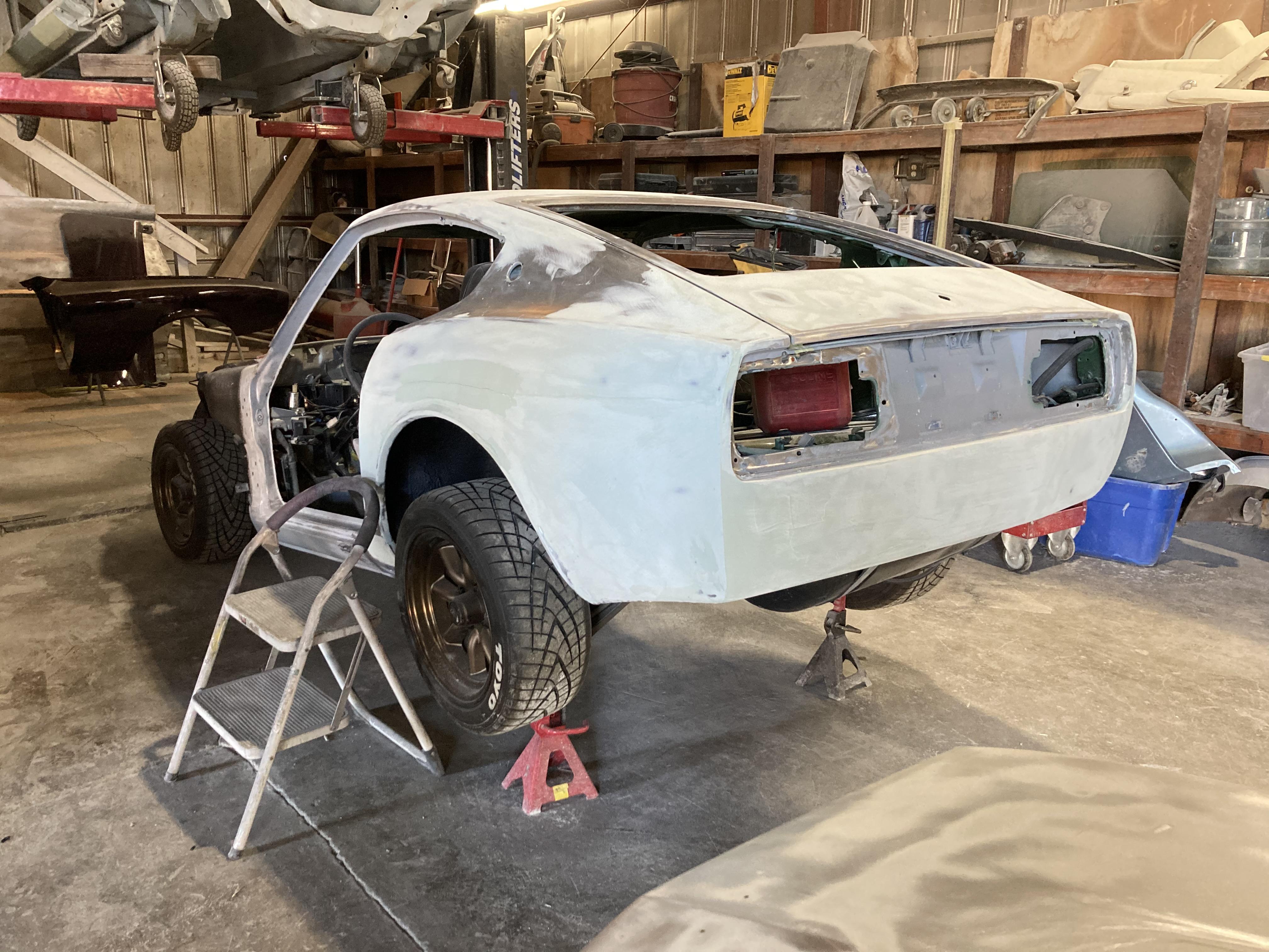

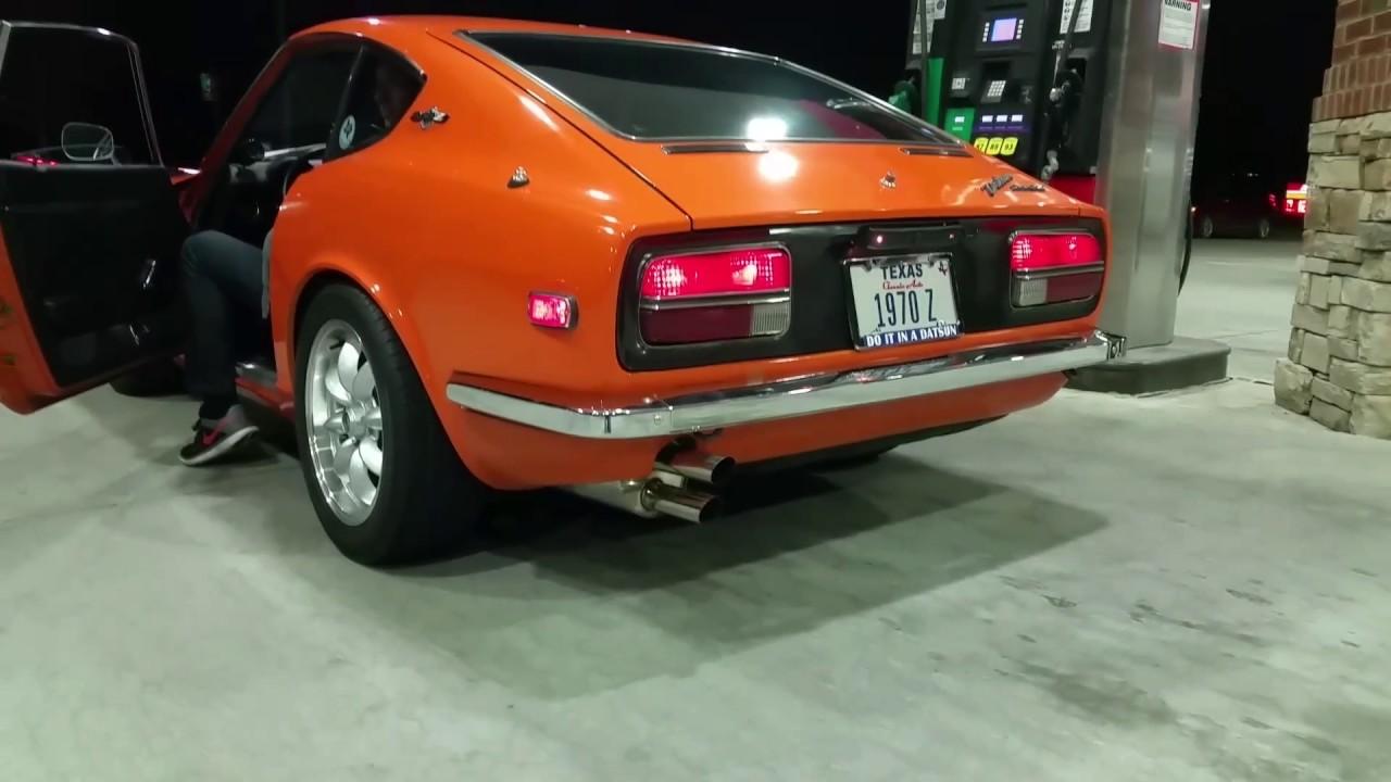

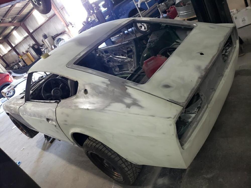

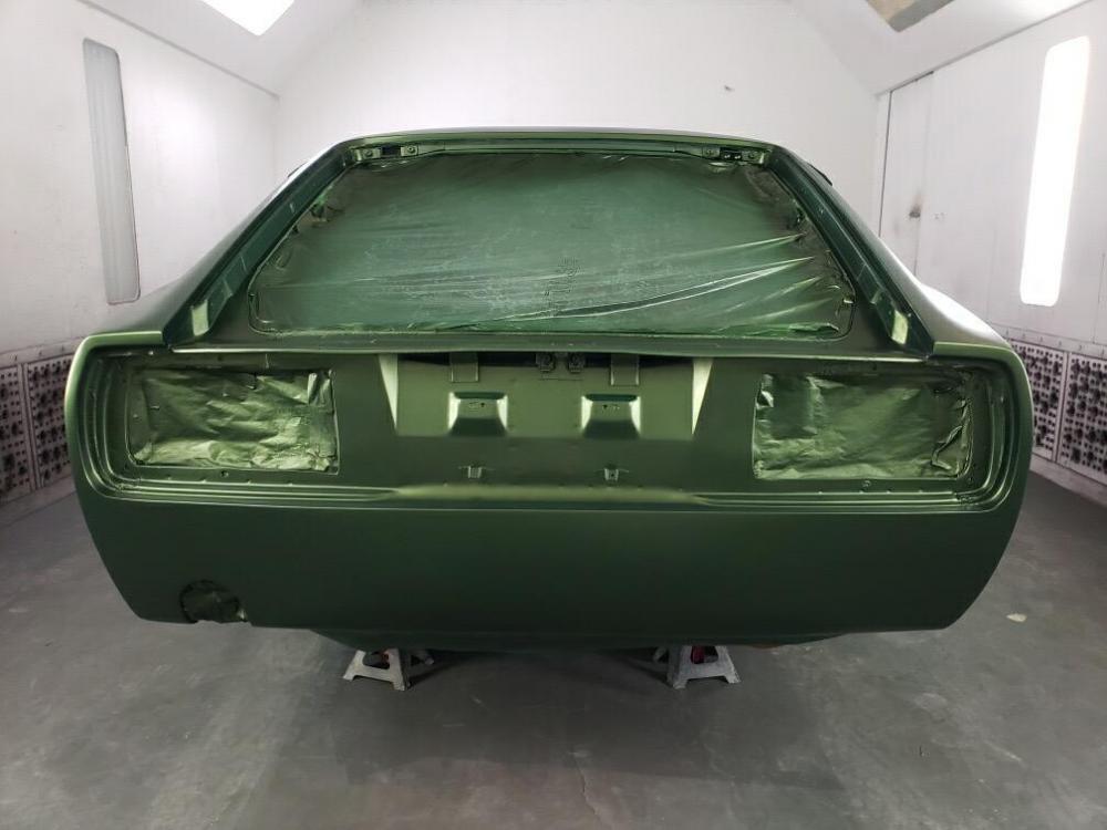

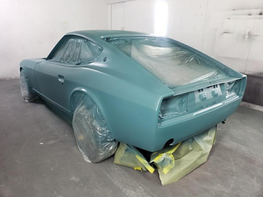

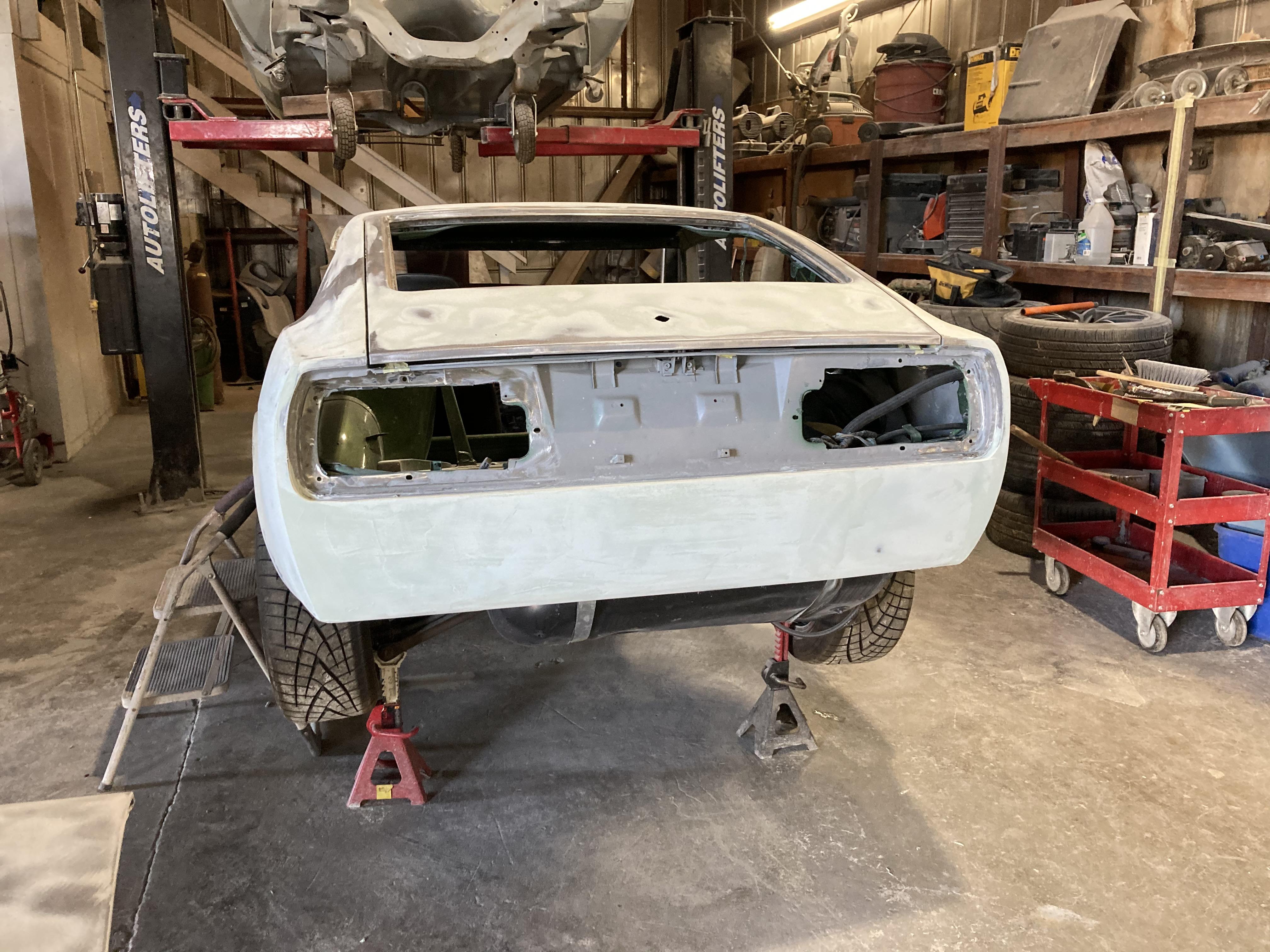

Guys, can anybody give me measurements for the 'cutout' for the exhaust on a 240z (see photo of orange car - I will be running the same exhaust).

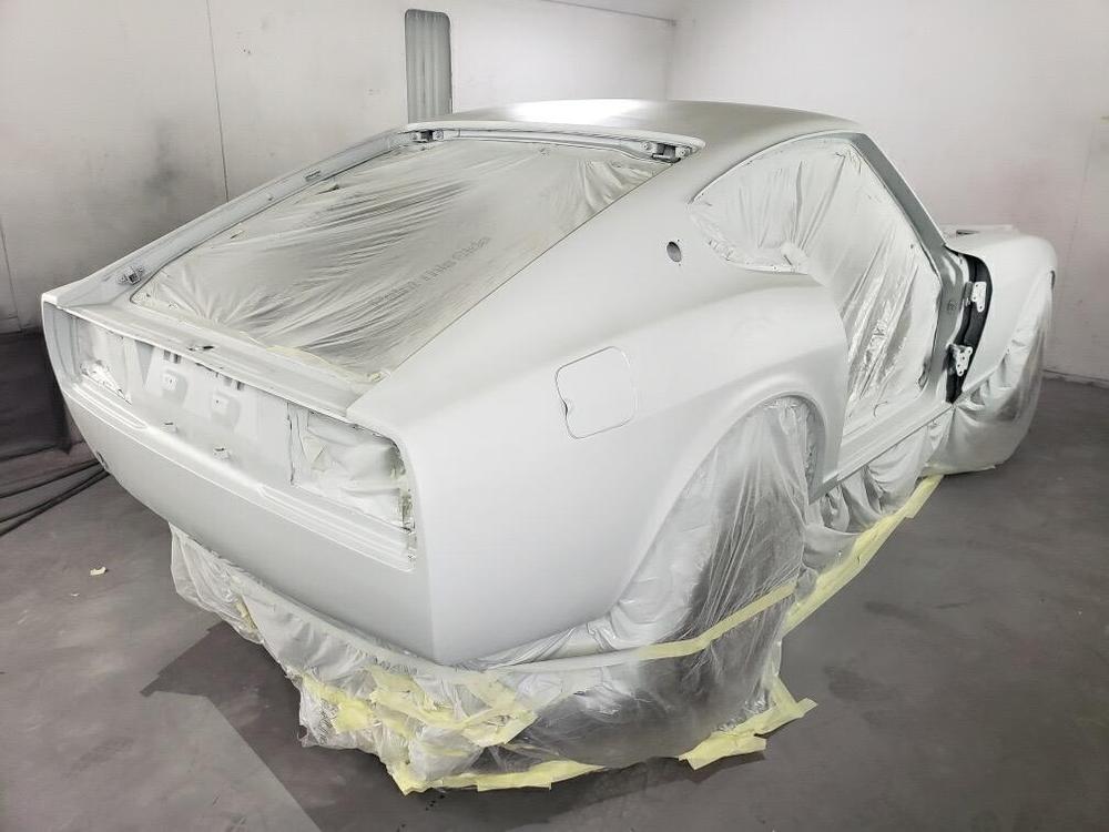

My Z is in bodywork - also see photographs - and has been shaved in the rear, so I need to make a new opening for the exhaust and want it to look at stock as possible. Any help appreciated.
I got 20” from center. The 240 has a muffler hanger bracket directly above the outlet pipe of the muffler. I offset forward in the car to tighten up the exhaust pipes he makes.
are putting on a resonator it made mine a little more pleasant. But still nasty on WOT between 4K and 7k.
