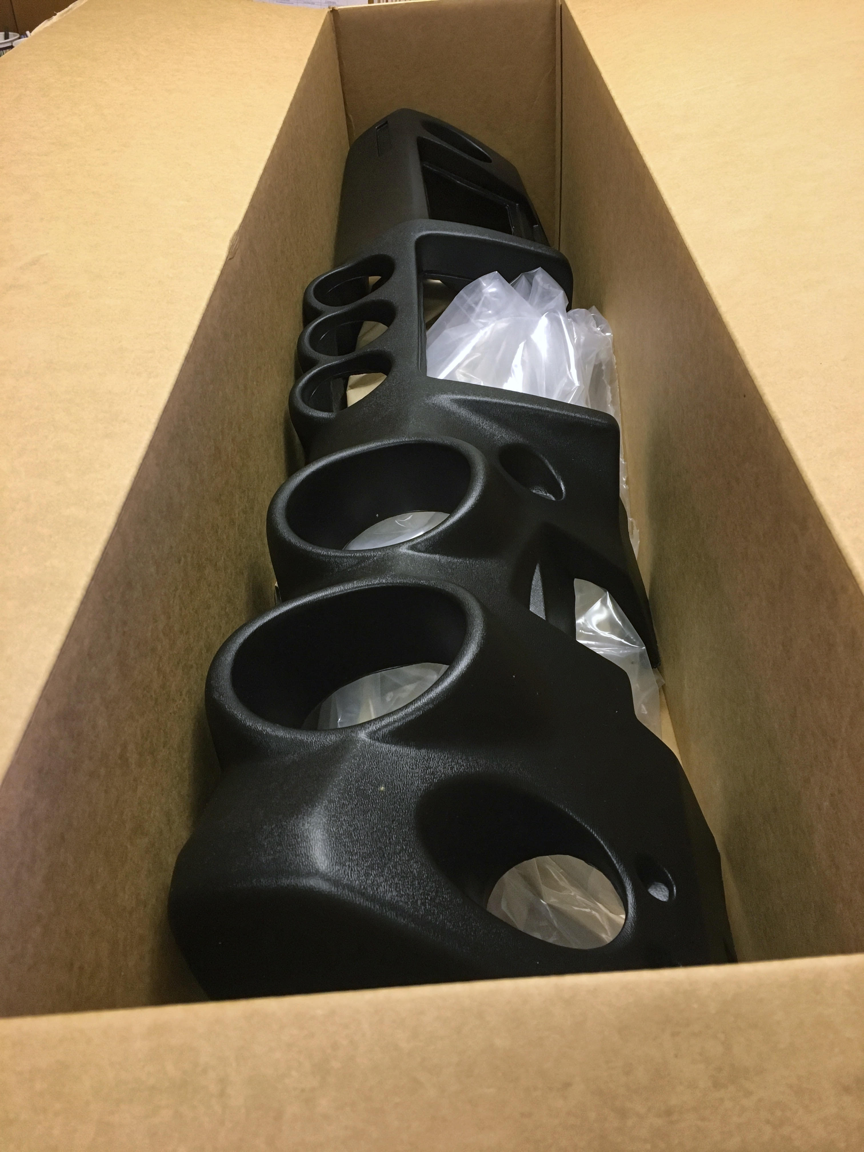

July 26, 20195 yr Author comment_580506 Agreed, I think I'll pick up that motor next weekend and work on it in parallel with the rest of the build.  In other news, I managed to get myself another steal this morning.. ? Link to comment https://www.classiczcars.com/forums/topic/60500-california-1978-datsun-280z-restomod/?&page=8#findComment-580506 Share on other sites More sharing options...
July 27, 20195 yr comment_580523 Just make sure your tach and speedo are up to par maintenance wise. Bulbs, etc. are good. Because once you install that dash cap you will NOT be able to remove the tach and speedo. I have tried several times to remove mine with no luck! And the cap won't fit without some finagling. Mine required heat to make it fit "better", not perfect by any means. To this day I wished I had just covered all the cracks with a dash mat instead of a cap. Was lazy and had an upholstery shop, that a friend recommended, do it and they put freakin' silicone all over the dash which is incorrect. But I didn't find this out until I made an attempt to remove it at a later date! Biggest mistake I've made with this Z besides the cowl induction hood, which is going away soon.  Link to comment https://www.classiczcars.com/forums/topic/60500-california-1978-datsun-280z-restomod/?&page=8#findComment-580523 Share on other sites More sharing options...
July 27, 20195 yr Author comment_580530 1 hour ago, rcb280z said: Just make sure your tach and speedo are up to par maintenance wise. Bulbs, etc. are good. Because once you install that dash cap you will NOT be able to remove the tach and speedo. I have tried several times to remove mine with no luck! And the cap won't fit without some finagling. Mine required heat to make it fit "better", not perfect by any means. To this day I wished I had just covered all the cracks with a dash mat instead of a cap. Was lazy and had an upholstery shop, that a friend recommended, do it and they put freakin' silicone all over the dash which is incorrect. But I didn't find this out until I made an attempt to remove it at a later date! Biggest mistake I've made with this Z besides the cowl induction hood, which is going away soon.  So that is actually a full new dash - as opposed to a dash cap - courtesy of Vintage Dashes in Albany. That being said, I will definitely be giving the gauges a once over and replacing/upgrading all of the bulbs before it gets installed. I'm really thinking of fitting the dash to the frame, and then farming out the installation. I definitely like the feeling of doing as much of the work as possible myself, but there are certain areas that I just know are better handled by the professionals ? Link to comment https://www.classiczcars.com/forums/topic/60500-california-1978-datsun-280z-restomod/?&page=8#findComment-580530 Share on other sites More sharing options...
