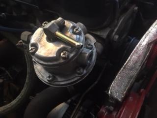

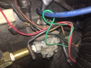

August 4, 20186 yr Author comment_554550 I found a 1/4 to -6 AN for the mechanical fuel pump (see photo IMG_1017)at https://www.pegasusautoracing.com/productselection.asp?Product=3230 I'm surprised that the pump outlet is only 1/4-inch. The fuel regulator (shown in photo IMG_1016) already has an NPT pipe stuck in its outlet so should I assume it is truly an NPT in and out or that someone made it fit? What is a dead-head FP regulator? Yes, it's between the pump and the carbs. Link to comment https://www.classiczcars.com/forums/topic/60506-an-6-braided-fuel-line-ends/?&page=2#findComment-554550 Share on other sites More sharing options...
August 4, 20186 yr comment_554555 The threaded holes are 1/8 BSPT (ID) and the pipe is 1/4 OD. Does seem rather paltry. But let this be a lesson to you-all who think you need 3/8 feed and supply to feed lines with monster noisy 200 gal/hr pump to feed our massive 2.4l 150 HP engines. NOT. -4 fuel lines in the engine bay are just fine. -6 is massive overkill, but they look so darn purdy! Link to comment https://www.classiczcars.com/forums/topic/60506-an-6-braided-fuel-line-ends/?&page=2#findComment-554555 Share on other sites More sharing options...

August 5, 20186 yr comment_554593 Deadhead regulator means no return line. Good to know there are some AN/BSP adapters available. Link to comment https://www.classiczcars.com/forums/topic/60506-an-6-braided-fuel-line-ends/?&page=2#findComment-554593 Share on other sites More sharing options...
