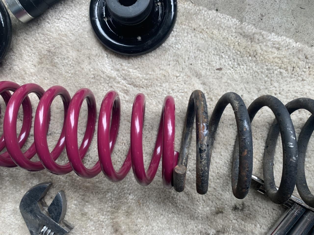

I’ll just jump on this thread . Ordered new Votglands and KYBs for a 71 . Spring diameter is smaller by a good 1/4” - so they don’t want to seat a full coil in the perch - especially the top hat .

That black spring looks really big wire diameter. Is that supposed to be stock?
They look heavier than the Vogtlands. To me anyway.
1 hour ago, gundee said:
I got mine from jdmwerks too. They fit well on my 72.
That’s a stock spring .
