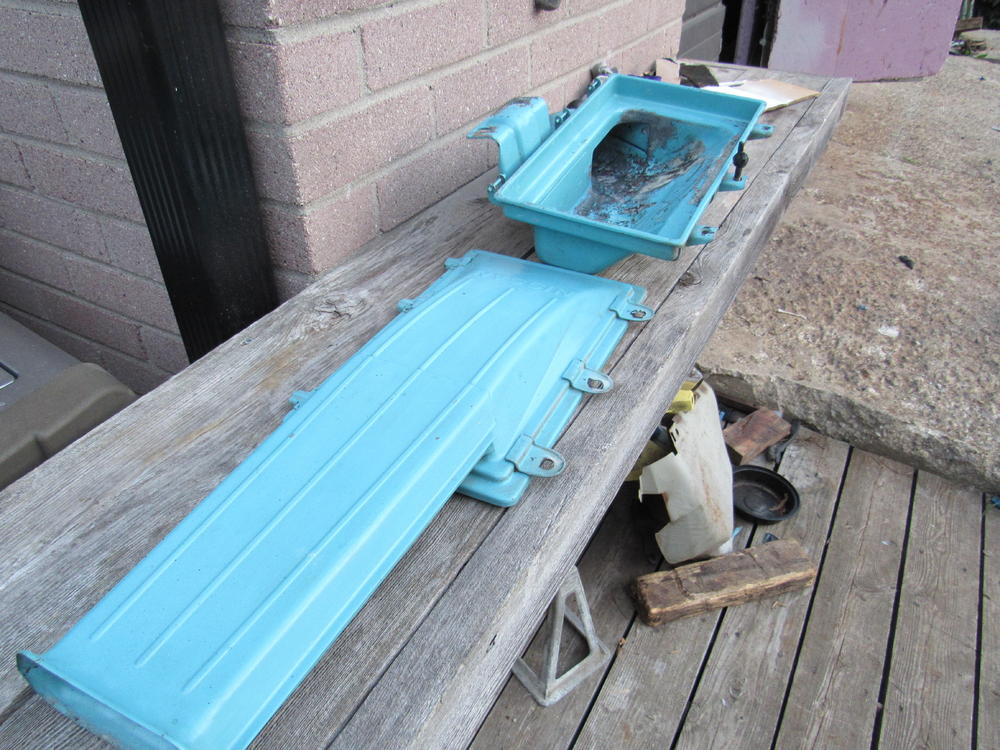

Posted August 4, 20186 yr comment_554521 Does anyone have the paint code for the turquoise that is used on the 280z air box or know of a pre made rattle can paint that is a close match? The paint condition of the top half of the air box is almost good enough not to bother but the lower half really needs a new coat. Thanks Link to comment https://www.classiczcars.com/forums/topic/60513-turquoise-paint-code/ Share on other sites More sharing options...

August 4, 20186 yr comment_554540 Pontiac Blue from Duplicolor on an L20. From a couple of old post on here, neither are mine. I also painted a 74 ½ Air Cleaner using DE 1610 Pontiac Blue (I used either a white or gray primer first) also used the same color for the vapor canister clamp. (picture posted) Edited August 4, 20186 yr by siteunseen Link to comment https://www.classiczcars.com/forums/topic/60513-turquoise-paint-code/#findComment-554540 Share on other sites More sharing options...
August 4, 20186 yr comment_554545 I think I might go with that Pontiac Blue now that I’ve seen it. Link to comment https://www.classiczcars.com/forums/topic/60513-turquoise-paint-code/#findComment-554545 Share on other sites More sharing options...
