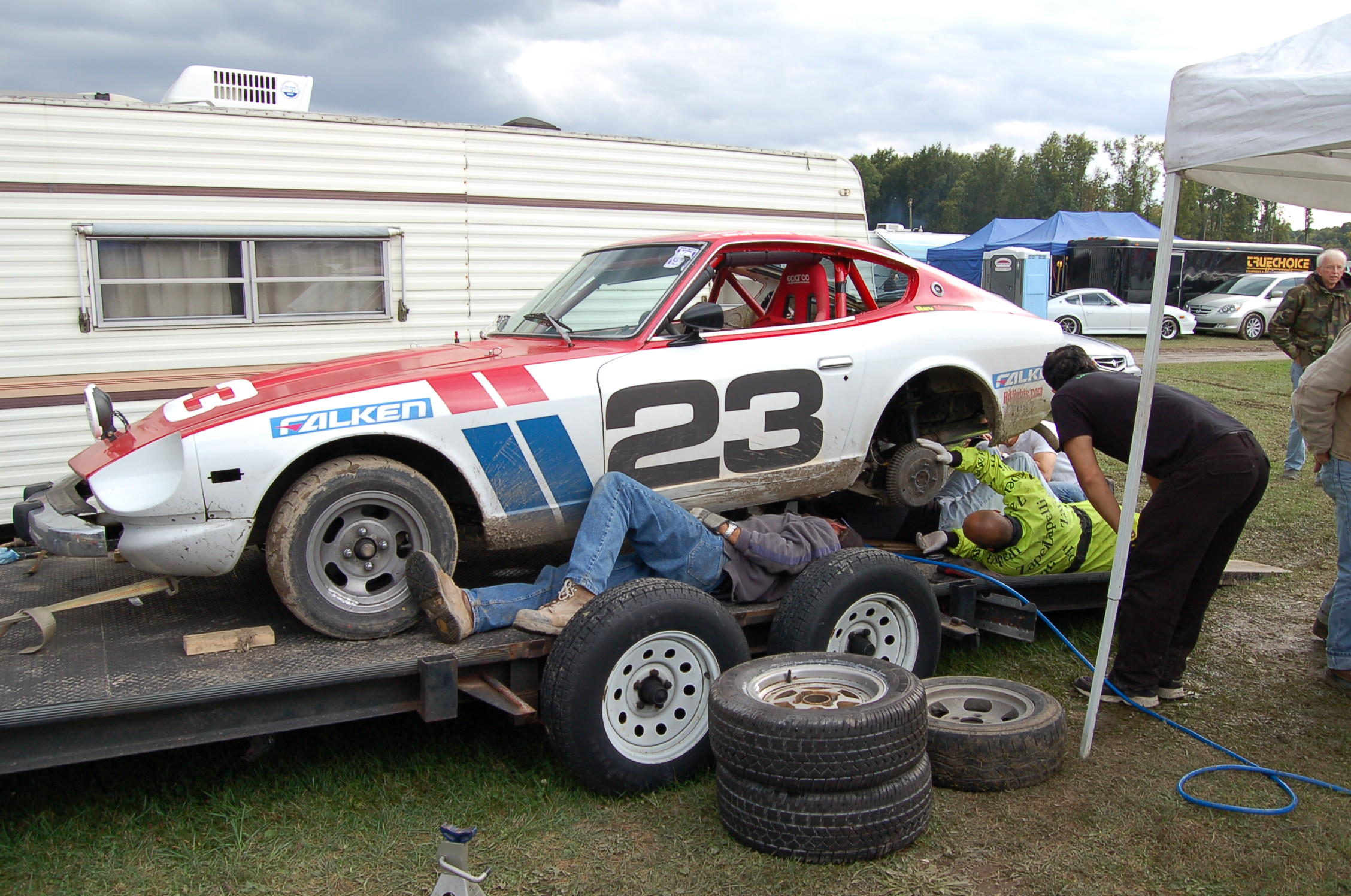

August 6, 20186 yr comment_554725 On 8/4/2018 at 10:36 PM, wheee! said: Swapping an R200 in has a list of other mods that need to be done to support it. The R180 is a good diff for a stock powered 240... I broke an R180 during a 24 hour endurance race. I converted it to an R200 and finished the race. I even fabricated the R180 mustache bar to make it fit. ☺️ Link to comment https://www.classiczcars.com/forums/topic/60521-still-cant-figure-if-i-have-a-r180-or-r200-differential-on-my-72-240z/#findComment-554725 Share on other sites More sharing options...
August 6, 20186 yr comment_554727 I broke an R180 during a 24 hour endurance race. I converted it to an R200 and finished the race. I even fabricated the R180 mustache bar to make it fit. [emoji5] Was it a stock engine? But awesome for you to fab up a R200 moustache bar etc! Link to comment https://www.classiczcars.com/forums/topic/60521-still-cant-figure-if-i-have-a-r180-or-r200-differential-on-my-72-240z/#findComment-554727 Share on other sites More sharing options...
August 6, 20186 yr comment_554728 There was a very good reason the R180 failed. Bought the car after it had been in a barn for 20 years and in 12 weeks, turned it into a caged race car. We had about 100 items on the to-do list and the only item that never got crossed off was changing the diff fluid. My teammates couldn't get the plugs out of the diff. Once we ran out of time, a decision was made to not change the diff fluid. There was no signs of leakage via dirt or stains. 4 hours into the race, the diff broke. Upon teardown, we found no more than a few ounces of oil. I was shocked it made it 4 hours! I had to drive an hour to get a R200 diff and then engineer the mustache bar to fit and make the mods. It was a long repair, but it got back on the track and ran the final 4 hours to take the checkered flag. The mustache bar worked so well, that I left it in for another 14 hour race even though I had a R200 bar ready to swap in. I didn't press my luck any further and the fabbed mount is now wall art. Link to comment https://www.classiczcars.com/forums/topic/60521-still-cant-figure-if-i-have-a-r180-or-r200-differential-on-my-72-240z/#findComment-554728 Share on other sites More sharing options...
