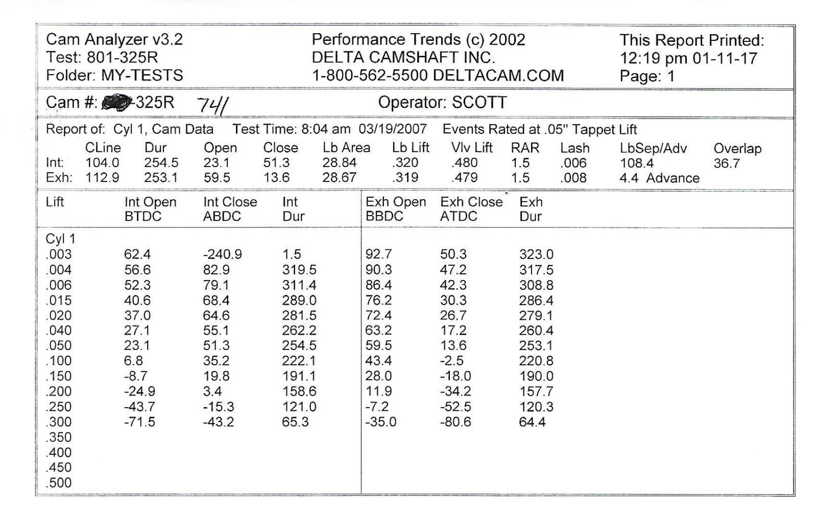

August 7, 20186 yr Author comment_554780 8 minutes ago, madkaw said: Flat tops have any reliefs? So cam is 480 lift and what duration? I would have gone higher on the CR with what you have. Becareful how deep you go on that port match. I haven’t dug into a 79 , but I know my MN47 would not open that big Thanks for the response, The cam spec attached shows the duration (254 @0.05"). The flat tops don't have any reliefs, I will be going through the clay procedure check. What clearances does everyone recommend? The CR from my calculations will be 10.27:1 - I want to run on 91 octane comfortably. What CR do you recommend? The P79 heads to my understanding have the same combustion chamber and intake ports as the famous P90. The difference is in the exhaust - P79 has the steel liners. Edited August 7, 20186 yr by jy.s30z Link to comment https://www.classiczcars.com/forums/topic/60540-l28-build-suggestionsadvice-please/#findComment-554780 Share on other sites More sharing options...
August 7, 20186 yr comment_554782 My thoughts would be if I spent the money for forged pistons I would take full advantage of their durability with respect to rpms and CR. I would go with as big of a cam as possible and run 11:1+ , but 91 octane you are probably in a safe region. With MS3- which is what I run- with full control of spark you can push the envelope with timing and dial it in more safely than a dizzy, but you probably already know that . As far as porting, my MN47 Is also very similar to to the 79&90 heads, but unsure of the port structure. I could only go 35mm before getting the walls to thin. This is 35mm way down in the hole . So just matching ports of intake and head you might not see any issues Link to comment https://www.classiczcars.com/forums/topic/60540-l28-build-suggestionsadvice-please/#findComment-554782 Share on other sites More sharing options...

August 7, 20186 yr Author comment_554793 16 minutes ago, madkaw said: My thoughts would be if I spent the money for forged pistons I would take full advantage of their durability with respect to rpms and CR. I would go with as big of a cam as possible and run 11:1+ , but 91 octane you are probably in a safe region. I have another stock cam that I can send for a different grind. Originally I was going with no porting, now I am worried that my lift is too low and I'll be leaving some on the table. 18 minutes ago, siteunseen said: Sounds like you've done your research! I like it. Can't wait to read your progress. Thanks! I've done so much research on this build, especially on the intake design. I will post pictures soon. 14 minutes ago, madkaw said: What have you done with valve seat and bowl areas? I did a 3-angle valve job unfortunately before I decided to do the porting. Other than that, nothing has been done 'yet'. 3 minutes ago, jonathanrussell said: you have built the engine above many times. Doesn't it require switching to the longer valves from N42/N47? Didn't see that mentioned in the list above. I am using the longer N47 valves. See 5th bullet in the list above. Link to comment https://www.classiczcars.com/forums/topic/60540-l28-build-suggestionsadvice-please/#findComment-554793 Share on other sites More sharing options...

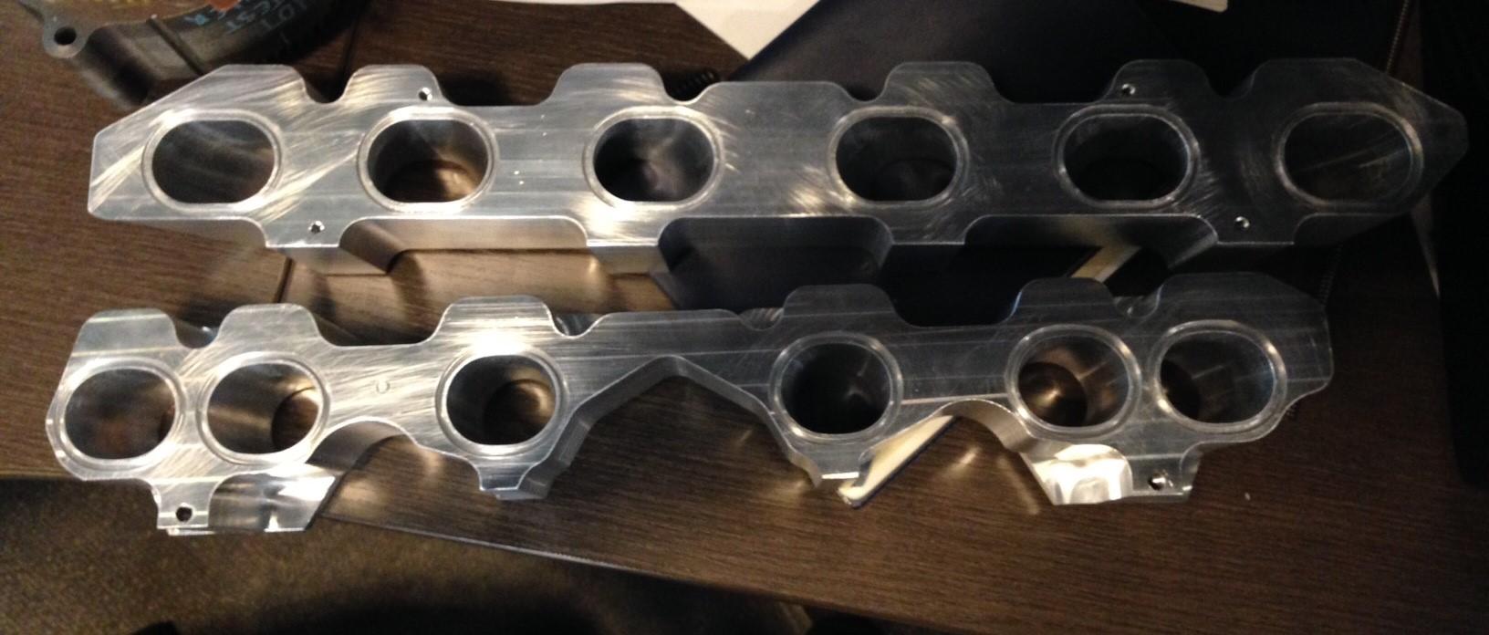

August 7, 20186 yr Author comment_554795 This picture is of the 'unfinished' intake. Still needed mounting holes & injector holes put in. Link to comment https://www.classiczcars.com/forums/topic/60540-l28-build-suggestionsadvice-please/#findComment-554795 Share on other sites More sharing options...
