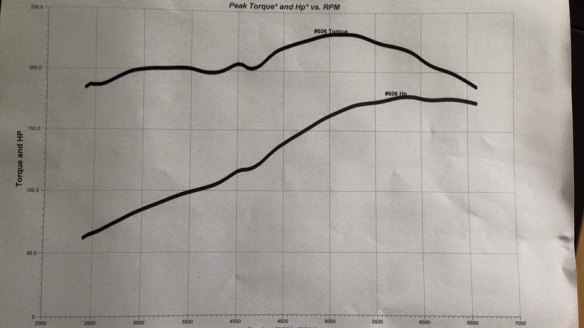

What I meant was that I thought my engine would be much slower because the 260 E88 head I have, based on what I’ve been reading about that head.

I think if you look at the 42 and and the late e-88 you’ll see there’s not much difference in combustion chamber . The N42 has bigger valves . So there shouldn’t be any real advantage with the 42 if valve sizes are the same .
Did your engine make power on the dyno all the way to 7k rpms?
