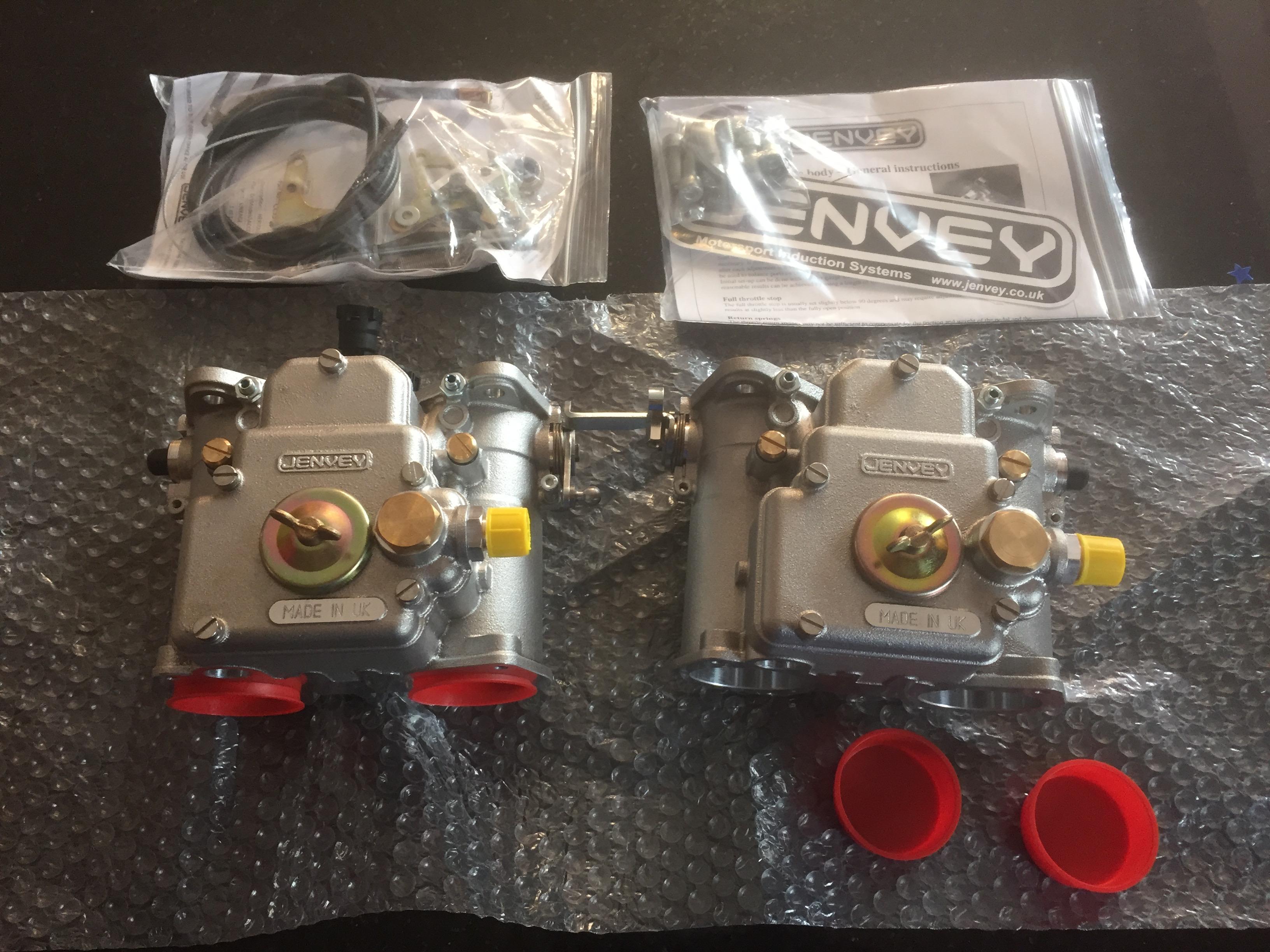

Well I decided to jump into the EFI game with both feet.
Here is what changed this "old school" boy's mind.

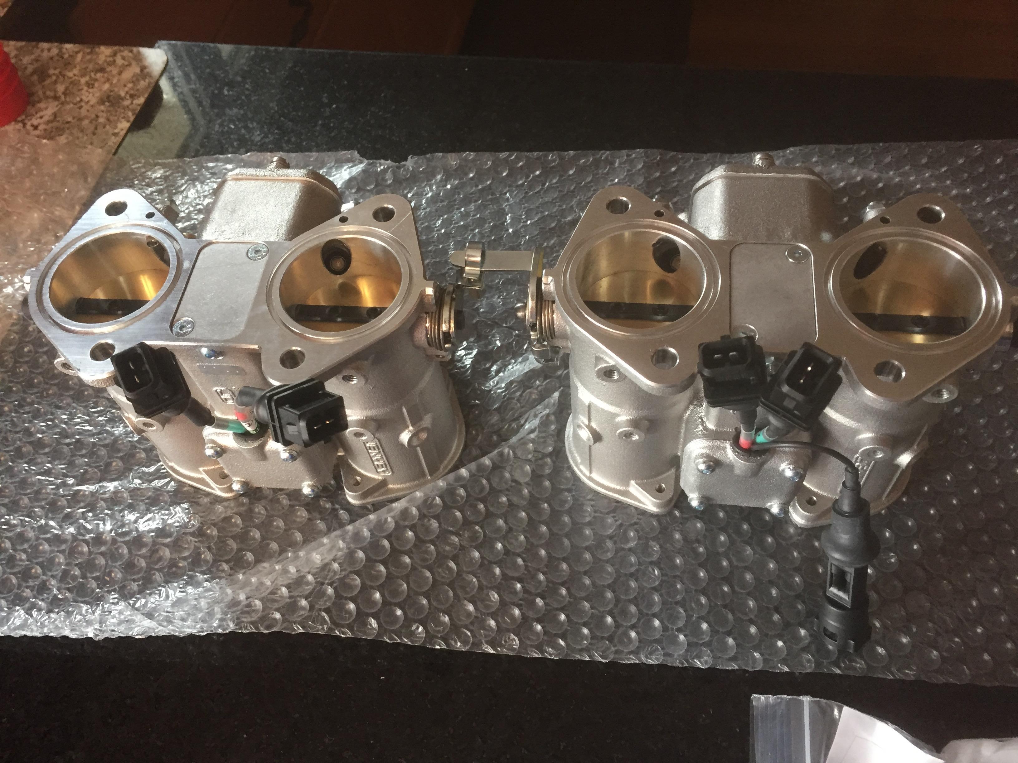

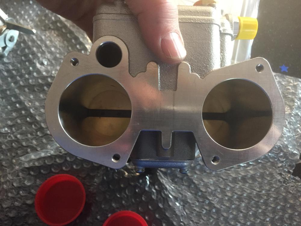

Weber look-a-like throttle bodies with built in injectors and TPS.  Jenvey Heritage Throttle bodies is what they go by.
I get the old look I can't seem to do without, with all the modern advantages of EFI.
You may notice that there are only two, and this is a Z forum, but as most of you know there is 510 lady in my life that I'm currently enfatuated with. I can always buy another one if I ever come to my senses.
 These are 45mm with 350cc/hr injectors. Should do.

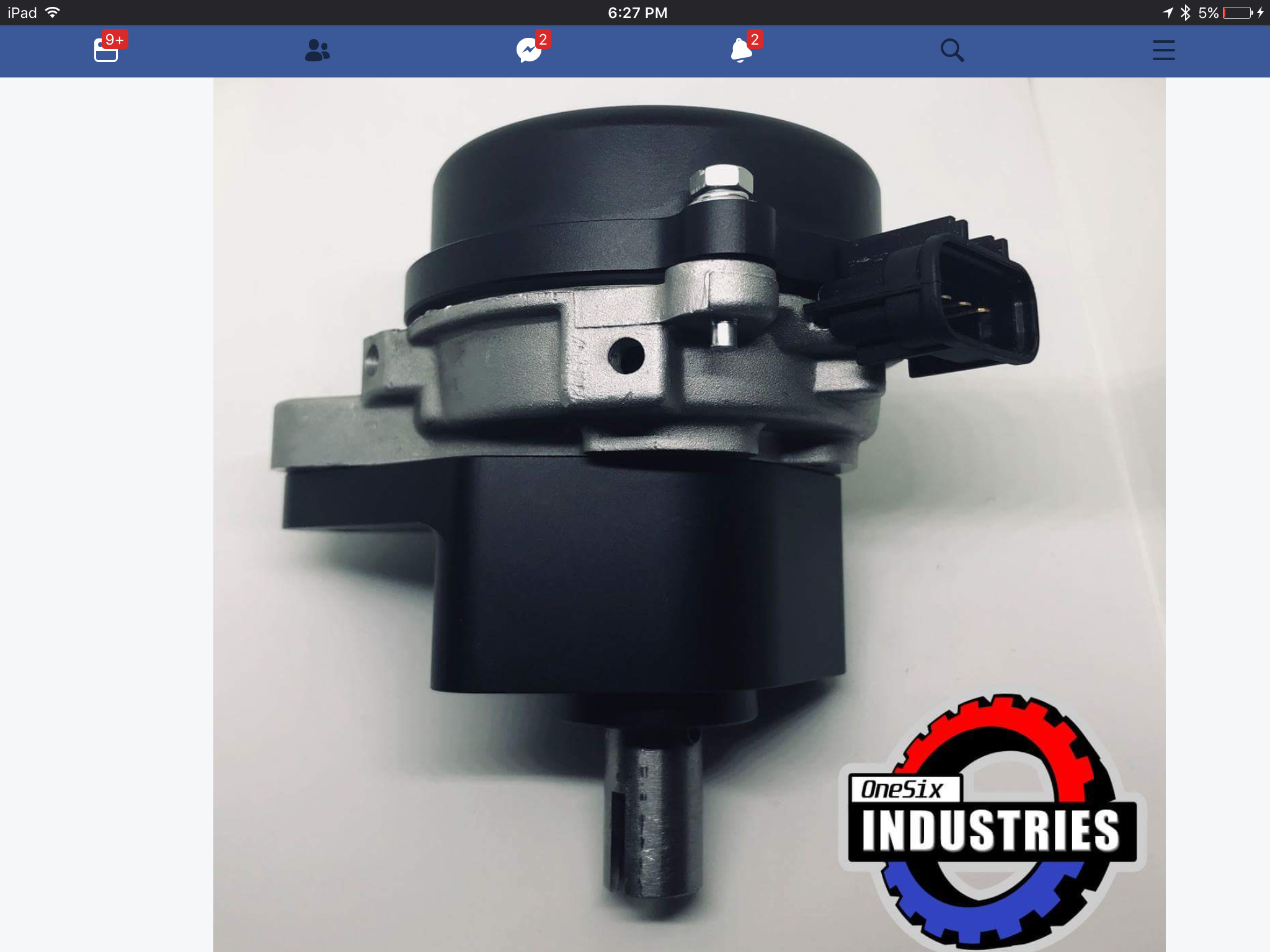

On the other side of the motor I plan to tuck a set of LS Coil-on-plug coils and time it all with a OneSix Industries new distributor replacement 'Crank Angle Sensor ' that has a pair of trigger wheels for full sequential injection. No holes barred, this thing is going modern. I may have to glue a dizzy cap on it to keep the old look going. Bad enough to do COP on the plug side.
https://www.onesixindustries.com/products
One might this a bit pricey, but once again the Canadian - Aussie connection wins as it is $400 AUD, which is actually just under par with CAD, so I win!
