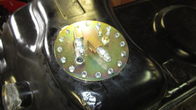

I have a 1976 280Z. Fuel sending unit and fuel lines are on the front side of the tank. ( 77 and 78 are on top )  I'm wondering if there is enough room on Top of the Fuel Tank to install a Tank Inc  Universal kit?
Anyone done this conversion on a 75 or 76 280Z tank?
Sending unit is still in the same place right? I think there would enough room.
If you were worried about room for the lines clearing the body -between the tank and body- you could adjust where the tank sits . You could lower the tank by not tightening the J hooks all the way
I have this intank unit in my 76 tank that is shoe horned into my 73 Z. It does fit in and snuggle next to the stock level sender without it rubbing on the intank pump hardware. If you put it in the right place. I got lucky. Let me see if I can find the pictures.
I did have to cut a small hole in the hatch floor to clear the fittings on top if the tank. Maybe in a real 76 there would be room, but I doubt it.
Okay here is a picture of where it goes.
