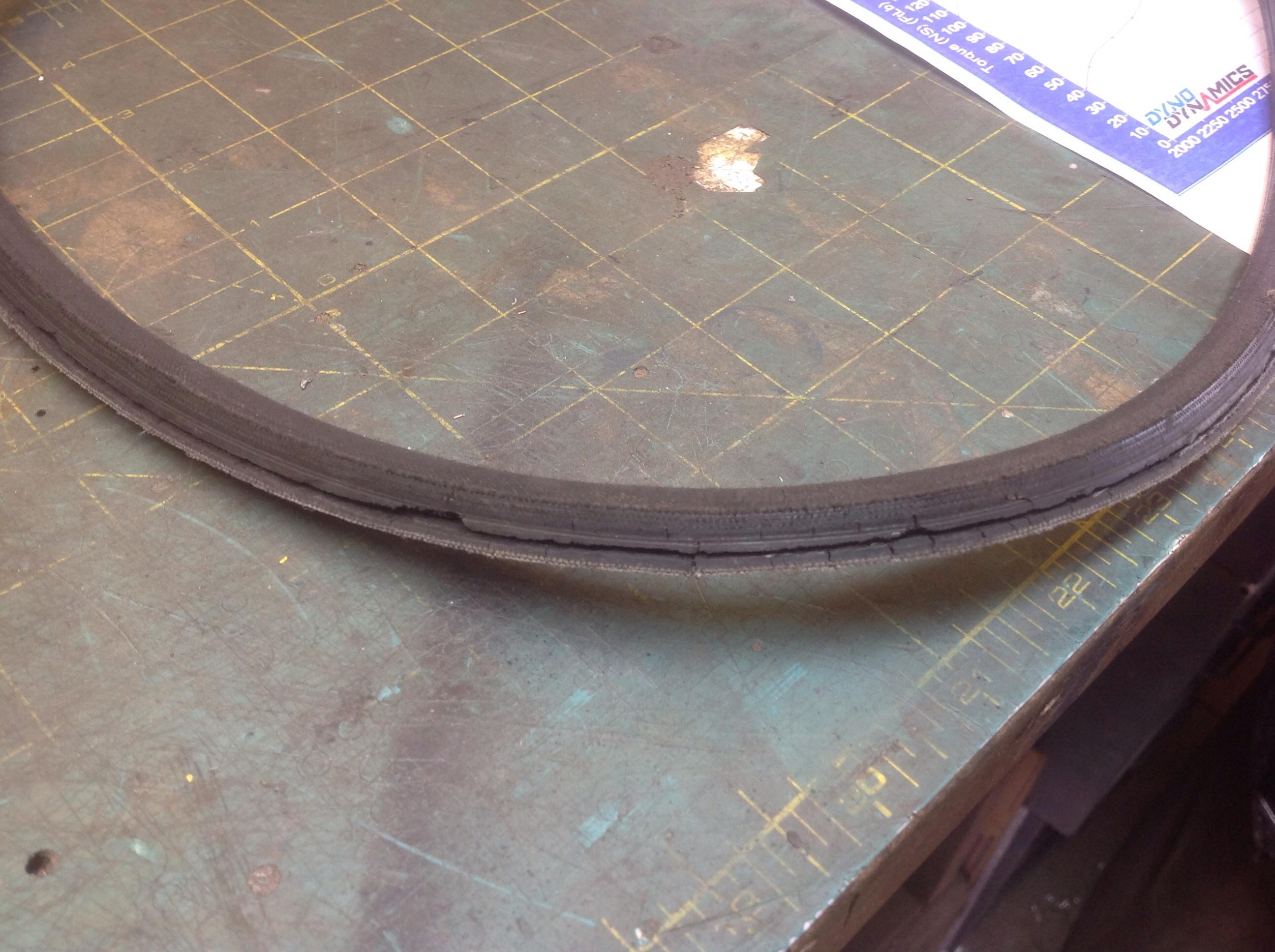

And the only thing we broke was the fan belt. It turned itself  inside and kinda on its side, and spewed out cord from it's middle parts.  You cannot bend it back into shape. Didn't actually break, more of cook and curl....
