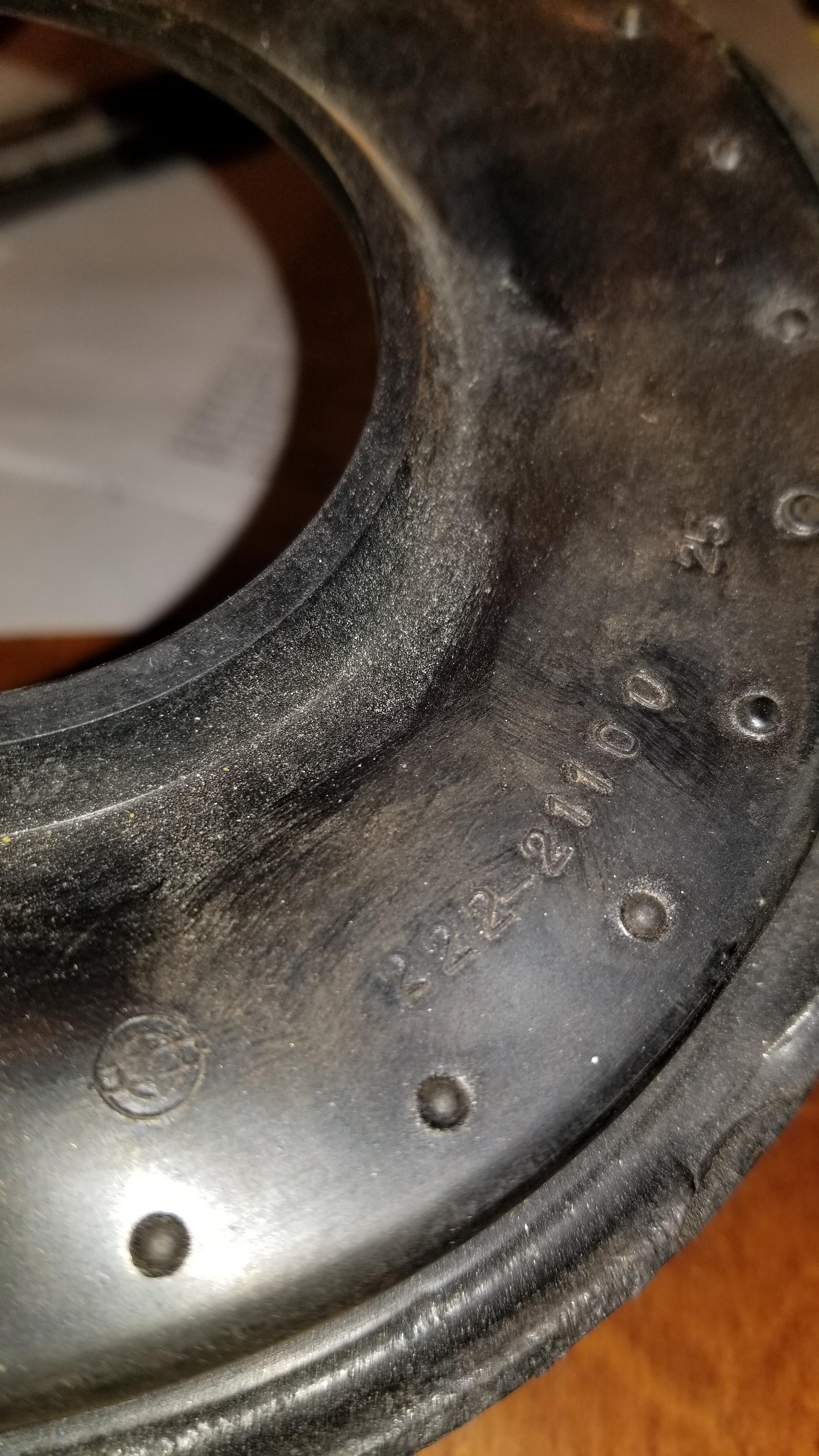

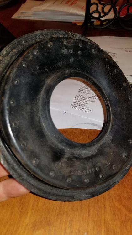

August 19, 20186 yr Author comment_555667 Here is the 7" diaphragm Hoover what can you find???? @240260280 Link to comment https://www.classiczcars.com/forums/topic/60601-7-brake-booster-repair-and-restoration/?&page=2#findComment-555667 Share on other sites More sharing options...

August 19, 20186 yr comment_555694 LOL, I was looking for diaphragms a few months ago. This is what I came up with as potential donors. Not sure if they fit like the original Hitachi diaphragms like you posted above. You will be taking a chance if you try.  7" https://www.ebay.com/itm/Mustang-65-66-Bendix-Brake-Booster-Major-Repair-Kit/171755696030?hash=item27fd6fef9e%3Ag%3Aj~4AAOSw~AVYnPaD&_sacat=0&_nkw=+brake+booster+repair+kit&_from=R40&rt=nc&LH_TitleDesc=0|0 https://www.summitracing.com/int/parts/clp-5559bb2-7/applications?page=2  https://www.ebay.com/itm/Triumph-TR6-TR-250-Brake-Booster-Repair-Kit/173192368659?hash=item285311d213:g:4SYAAOSwlrBamuUi  9" https://www.ebay.com/itm/Cadillac-1962-63-Bendix-Design-Major-Brake-Booster-Repair-Kit/172336276921?hash=item28200ae5b9%3Ag%3A~W0AAOSw6DtYTrOi&_sacat=0&_nkw=+brake+booster+repair+kit&_from=R40&rt=nc&LH_TitleDesc=0|0 http://www.cadillacpartsltd.com/19cacabepobr.html Link to comment https://www.classiczcars.com/forums/topic/60601-7-brake-booster-repair-and-restoration/?&page=2#findComment-555694 Share on other sites More sharing options...
August 19, 20186 yr comment_555707 Maybe @katscould do some checking for a source in Japan? Link to comment https://www.classiczcars.com/forums/topic/60601-7-brake-booster-repair-and-restoration/?&page=2#findComment-555707 Share on other sites More sharing options...
August 19, 20186 yr Author comment_555708 2 hours ago, 240260280 said: LOL, I was looking for diaphragms a few months ago. This is what I came up with as potential donors. Not sure if they fit like the original Hitachi diaphragms like you posted above. You will be taking a chance if you try. Â 7" https://www.ebay.com/itm/Mustang-65-66-Bendix-Brake-Booster-Major-Repair-Kit/171755696030?hash=item27fd6fef9e%3Ag%3Aj~4AAOSw~AVYnPaD&_sacat=0&_nkw=+brake+booster+repair+kit&_from=R40&rt=nc&LH_TitleDesc=0|0 Â DUDE!!! That Mustang diaphragm looks really promising. The same dots around the perimeter and everything. That would be a home run if it fit! Mustang parts aren't going anywhere. I'll order one. I am ok with the risk... Link to comment https://www.classiczcars.com/forums/topic/60601-7-brake-booster-repair-and-restoration/?&page=2#findComment-555708 Share on other sites More sharing options...
