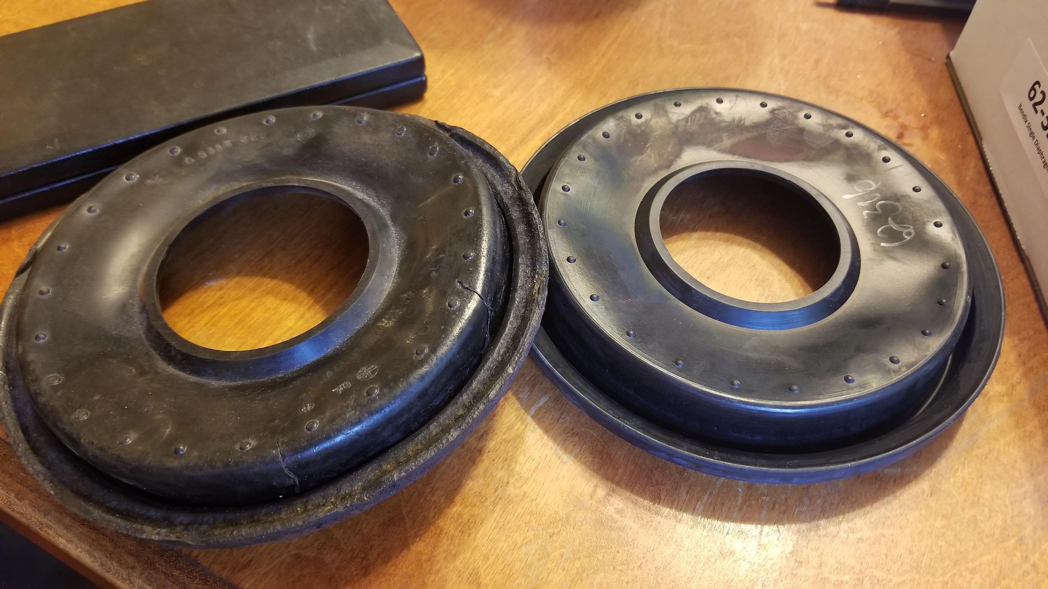

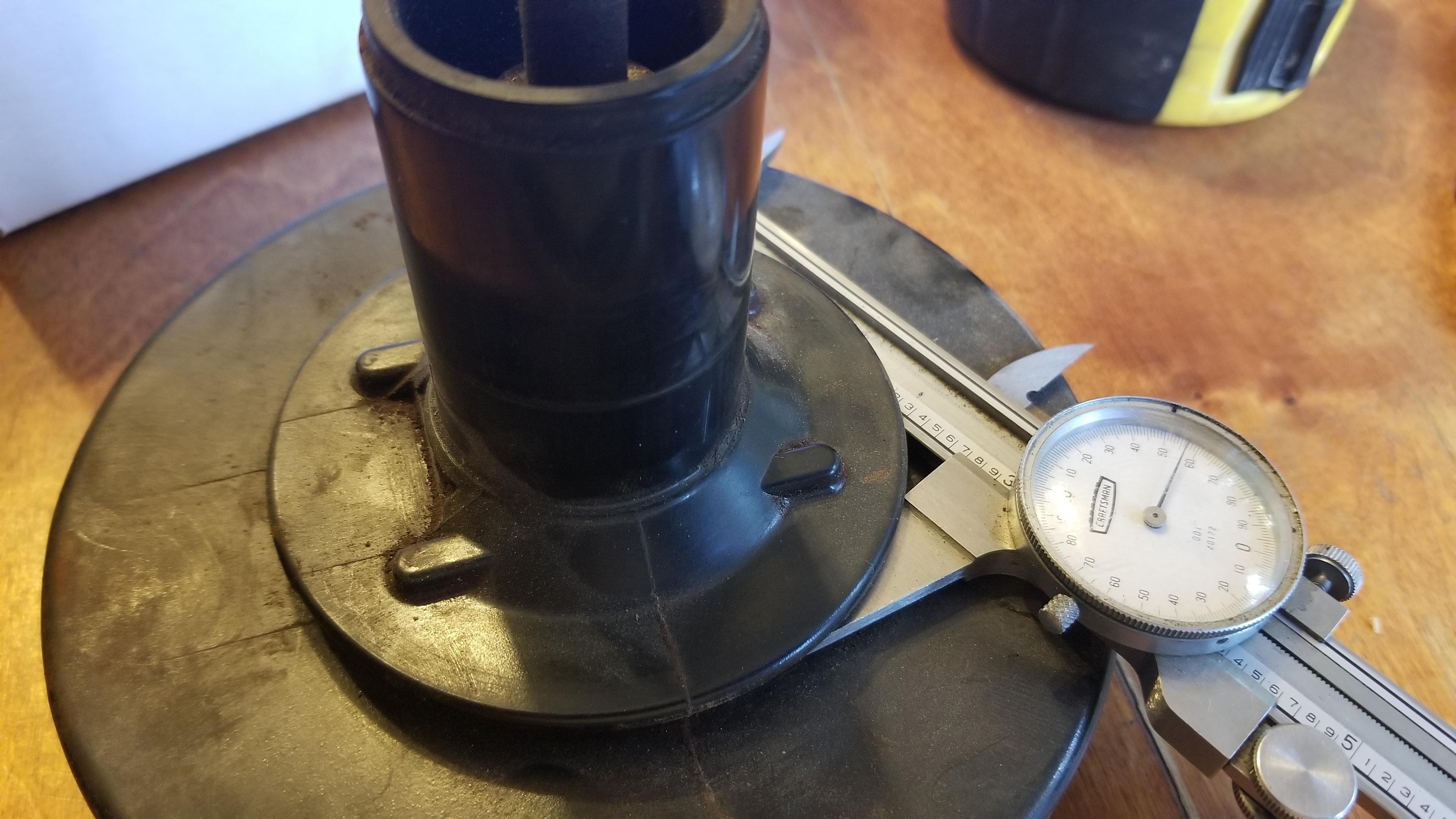

August 22, 20186 yr Author comment_555949 Ok! Go Hoover!!!! @240260280 I'll settle up with you in Atlanta So I got the Mustang brake booster kit in from Harmon Classic Brakes today I think that diaphragm is going to work great! I haven't looked through the rest of the kit yet Old diaphragm New diaphragm OD 6-13/16" 6 3/4" ID 2.59" 2.42" Hub OD 2.65" at diaphragm I suspect the ID on the old disc is stretched from having been on the hub for so long They basically look identical except for the tears in the old one and the deformation from having been previously installed Link to comment https://www.classiczcars.com/forums/topic/60601-7-brake-booster-repair-and-restoration/?&page=4#findComment-555949 Share on other sites More sharing options...
