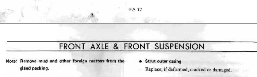

Nope, I doubt it. If you find the strut is damage, you would be better of to replace it. I think it would be hard to straighten with out damaging the ID of the strut tube. That would make strut removal or installation impossible.
