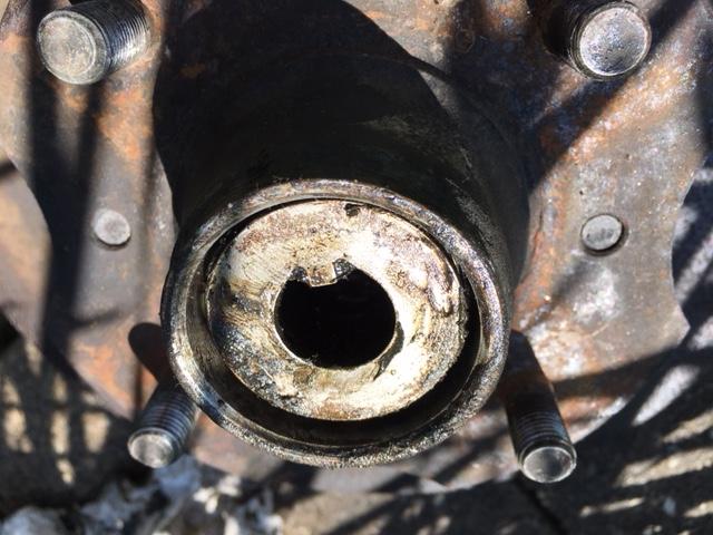

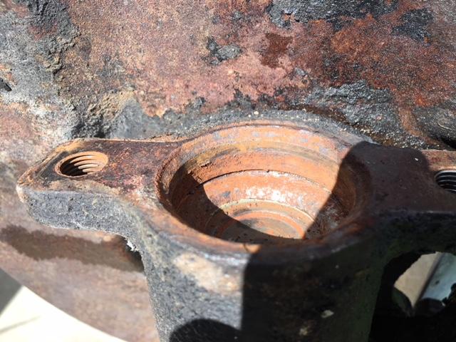

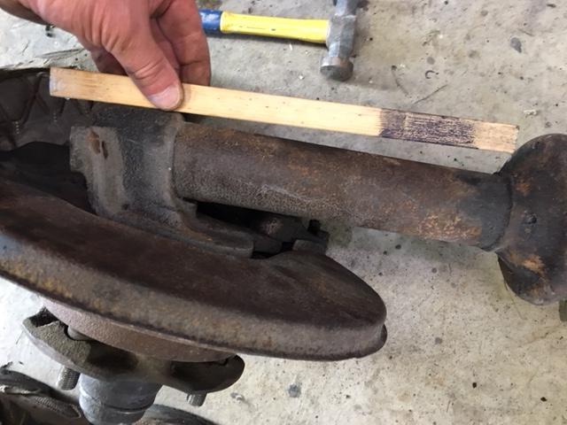

Additional pictures of the wheels bearings and the strut tube weld.  Ant thoughts?  The spring perches seem fine, the strut bearing is intact and functional with no noticeable play and the isolator doesn't doesn't have any strange wear.  So the the things that stand out to me are; ball joints are junk, the connecting rod has a slight twist which I don't know if that's normal, the ball joint doesn't seem to mount in the center of the connecting rod which I don't know if that's normal but doesn't seem so based on FSM pictures, and the wheel bearing seem to be seated deep but I'm not taking it apart until I get feedback, and lastly the strut tube doesn't stay on the same plane as the spindle housing.
The outside of the casting is rough and might not be parallel with the bored hole.  Were it mine I'd put the wheel back on, then stand on the wheel, flat on the gorund, and work the end of the strut around by hand.  See if it's loose like you thought and see if you can see where it's moving.
I really want to understand the problem and get the right answer, not throwing parts at this, but the difference in angle shown on the strut tube housing look like it would make things the same as the other side if straightened.  Is there any way to straighten it and possibly weld in a gusset for added strength?
Here's a test:  Set the strut assembly on a flat surface - or a surface that you can verify it's "tilt" with a level.  I'm talking about the surface showing in your last picture - The surface that bolts to the steering arm (and thus the ball joint).  The bottom of the hub.
We've found that the strut tube is at a 90 degree angle to this surface.  Put a level on the top of the strut tube and see if it's actually in the same plane as the bottom surface.  If the base is level (on a level surface) the top of the tube will be also - and all sides of the tube will be at a 90 degree angle to that surface.  (That's how we determine position (lean) of a weld-on adapter tube when installing fully adjustable coilovers)
If the strut tube is bent - and I believe it is, I would never try to repair that or suggest that to another.  Personally, I stand by my initial suggestion that you  replace the strut assembly.
