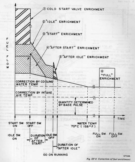

August 27, 20186 yr comment_556276 Nice work so far. Taking the bull by the horns and not wanting to be simply referred back to the FSM. Here's a chart I whipped up a while back to evaluate the resistance measurements from the air and water temp sensors: *This chart was created using the Stienhart-Hart Equation with coefficients derived from data points in the manual. Link to comment https://www.classiczcars.com/forums/topic/60656-78-280z-severe-driving-problems/#findComment-556276 Share on other sites More sharing options...
