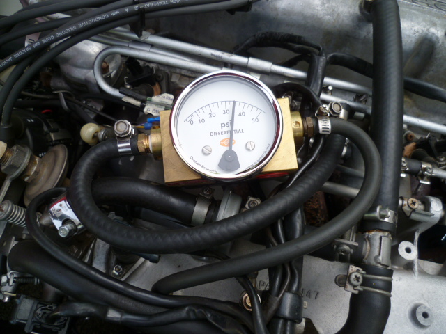

I bought a differential pressure gauge. Hook one side to the fuel rail. Hook the other side to the intake manifold.
My fuel pressure "seemed" like it was all over the place, but when measured differentially (as you really should), it was rock steady at 36psi even when you goosed the throttle. It's really deceptive when just measuring one side.
So why doesn't everyone do that? Because they're expensive and delicate. I got lucky and found one on ebay for cheap. I'll post a pic when I get a chance.
Interesting. My setup will have a pressure gauge on the entrance to the fuel rail, and another at the FPR return. That should give me the same setup basically. Pressure before and after the rail.
Here's the theory for the differential pressure gauge I have. It's essentially just a piston (which also happens to be a magnet) sliding back and forth in a tube. That magnetic piston is coupled to the gauge needle so there is no process fluids (whatever you are measuring) in the meter movement area.
Operates like this:
And this is hooked up to the car. Too big to leave in there all the time, but it's fantastic for diagnostic purposes. One side pushes while the other side pulls. The pressure reading would go down if you disconnect the vacuum side because that side isn't pulling:

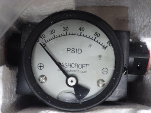

Very interesting. There are some Ashcroft differential pressure gauges on eBay currently for a decent price. 0-60 PSI with a max pressure of 3,000PSI and 1/4"NPT(F). Something like this should work in this application correct? If so then it would be worth a purchase to have in the toolbox.

Fortunately Ashcroft has very good documentation on their website. The item currently on eBay is:
Model: 25-1130FL-25S-XV2-60#
25: Size (2.5")
1130: Series
F: Body Material (Aluminum) (The stainless bodies have a higher max pressure rating of 6,000-PSI)
L: Case Fill (Glycerin Fill)
25: Process Connection Size (1/4" NPT Female)
S: Process Connection Location (In line)
XV2: Options (1-SPST switch with terminal strip)
60#: Range (60 PSI)
More importantly, the o-rings are Buna-N so gasoline should not be a problem. For the cost it is worth a shot.
Well for twenty-five bucks, it's certainly worth a shot. If it works as well as mine, it'll answer any questions about the real pressure that the injectors actually see. I took a quick look at Ashcroft's website and I couldn't find a diagram that explained the basic theory of operation for the internals. I did see some mention of magnet(s), so I assume it's the same magnetically coupled meter movement concept as the one I have, but I couldn't 100% determine.

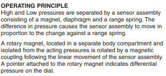

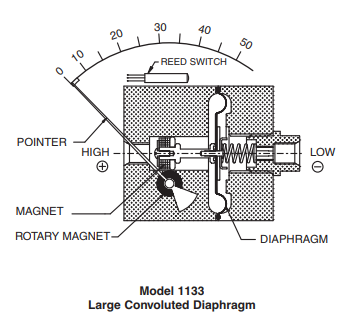

Here is a snapshot of the mechanics of the gauge:
Gauge Mechanics
Gauge Datasheet
