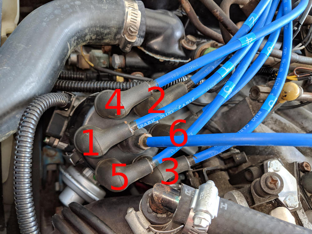

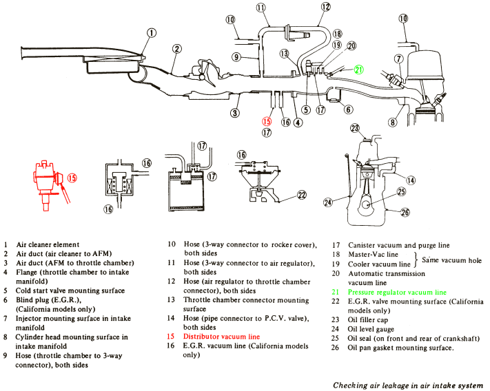

September 1, 20186 yr comment_556584 I'm glad captain obvious picked up on vacuum signal to distributor. That should be ported vacuum, not manifold. If anything, disconnect the vacuum line from the distributor, plug it off and set base timing that way. Make sure your rpms are around 800 when setting it. I honestly don't see 34psi at idle causing your sputtering problem. 153624 counterclockwise is correct, the 1 should be towards the radiator. You can run a fuel pressure drop test on the injectors, it's a crude test that doesn't show you spray patterns but can show you if an injector isn't moving fuel. Have your pressure gauge connected and with key on engine off run the pump for a few seconds, either clamp off the return or deadhead (cap off) the return side of the rail. If your fuel pressure doesn't quickly bleed down after turning the key off, you can probably get away without capping the return. Record where the pressure is at, then using a 9 volt battery, very quickly jump an injector (literally just tap the wire to the terminal) and monitor pressure loss. Do this with all 6 injectors and compare their results. You'll have to prime the fuel pump after testing each injector, and make sure not to activate them too many times before starting the engine (keep from flooding it). I use 12v when doing this but 9v is safer, as you can easily fry the injector by leaving it engaged too long. Lots of other things can be done but these will help. If you have an infrared temp gun you can hit each exhaust runner with it, a "cold" cylinder may be your problem child. Definitely easier with headers than log manifold, (and a setup that doesn't have an intake directly above it) but doable. This is just a suggestion if you have one handy, don't run out to go buy one just for this. Link to comment https://www.classiczcars.com/forums/topic/60656-78-280z-severe-driving-problems/?&page=4#findComment-556584 Share on other sites More sharing options...

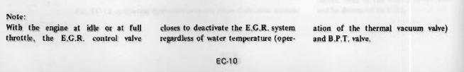

September 1, 20186 yr comment_556603 One area that has caught some people is the EGR system. Since your engine sounds good at idle you might try disabling it to see if anything changes. I think it actuates by ported vacuum so blocking that hose might have an effect. And like jr says above, make sure that the AFM vane is moving freely. When I was watching your video I thought I saw it hang, its movement trailing the engine sound, but I couldn't be positive when i rewatched it. A slight delay in vane reaction will lean things out and cause intake popping. And as CO suggested, if the AFM has been messed with maybe the atlanticz calibration procedure is the way to go. I'd get a magnifying glass and see if I could find the original glue blob traces myself. Or crank that potentiometer up and try to drive it. Something will show up. You're doing all of the right things. Link to comment https://www.classiczcars.com/forums/topic/60656-78-280z-severe-driving-problems/?&page=4#findComment-556603 Share on other sites More sharing options...
September 1, 20186 yr Author comment_556624 Alright here is an update.. We might be on to something but as promised let me check off the to-do list first. Verify vacuum line routing (Distributor) If incorrect, verify timing again (10°BTDC @ 800RPM) It was incorrect, vacuum source was after throttle body. I put it below the throttle body per the FSM. Timing/Idle speed adjusted back to 10°BTDC @ 800RPM. FPR exercise with hand vacuum pump I left this tool at home so I was unable to perform this exercise! ? It stays on the list... Verify firing order (caps and plugs with pictures) 1-5-3-6-2-4 CCW As promised, pictures. Also a video of each lead with a new plug in showing spark. Verify AFM pins not popping out when plugged in Pins are solid in the connector when installed. I still have the AFM cover off right now so those terminals are easy to access with a multimeter and measure to the ECU connector. Review injectors firing (I have video below) unplug one at a time #2 and #3 did not have an impact on idle speed when removed. I swapped connectors from Injector #1 and #2 after this, and when I perform the test again with the swapped connectors, #2 still has no impact on idle but injector #1 (with #2 connector) will drop about 90rpms like it did with the original connector. screw driver to ear All injectors are clicking. #2 and #3 are clicking the same as other. Granted I am using a tall screw driver to my ear, when the connector from #2 or #3 is removed, the amplitude of the clicking goes down a lot. When the connector is installed, it has the same amplitude as the other injectors. Record video of RPM/FP/Vacuum See video below. So after this, I am really perplexed with #2 and #3 injector having minimal impact on idle speed.In the video you can definitely see about a 100rpm drop on all other cylinders. I have not been able to reduce idle speed yet but I forgot my vacuum pump to test the FPR. 6 hours ago, Zed Head said: One area that has caught some people is the EGR system. Since your engine sounds good at idle you might try disabling it to see if anything changes. I think it actuates by ported vacuum so blocking that hose might have an effect. And like jr says above, make sure that the AFM vane is moving freely. When I was watching your video I thought I saw it hang, its movement trailing the engine sound, but I couldn't be positive when i rewatched it. A slight delay in vane reaction will lean things out and cause intake popping. And as CO suggested, if the AFM has been messed with maybe the atlanticz calibration procedure is the way to go. I'd get a magnifying glass and see if I could find the original glue blob traces myself. Or crank that potentiometer up and try to drive it. Something will show up. You're doing all of the right things. The EGR system has been removed and blocked off on the intake plenum. The AFM does move freely, I have never been able to get it to bind or feel any resistance in its movement. Spark Test Pulling injector connector test. (Apologizes for the shaky video at times, it is not easy handling all of these items at the same time.) Reemphasizing the impact #6 injector connector has on idle speed. FP/RPM/Vacuum Video: Edited September 1, 20186 yr by kinser86 Forgot to add last video link. Link to comment https://www.classiczcars.com/forums/topic/60656-78-280z-severe-driving-problems/?&page=4#findComment-556624 Share on other sites More sharing options...
September 1, 20186 yr comment_556625 49 minutes ago, kinser86 said: It was incorrect, vacuum source was after throttle body. I put it below the throttle body per the FSM. Timing/Idle speed adjusted back to 10°BTDC @ 800RPM. So after this, I am really perplexed with #2 and #3 injector having minimal impact on idle speed.In the video you can definitely see about a 100rpm drop on all other cylinders. I have not been able to reduce idle speed yet but I forgot my vacuum pump to test the FPR. The vacuum hose mistake would have led to the timing being retarded by the total amount of vacuum advance possible. Probably about 14 degrees. So when you opened the throttle timing would have dropped to about -4. Of course as RPM increased centrifugal advance would bring it back up. Retarded timing will reduce power by quite a bit. The car might be drivable now, but still "poppy". You can check if the advance hose is correct by removing it when measuring timing at idle. Nothing should happen. Then with the hose connected timing should advance as soon as you crack the throttle. Weak cylinders won't show a big effect if you cut fuel by disabling the injectors. Low compression or burned valves for example. If you're sure the injectors are working that would be a good place to focus, assuming that you know you have spark. Here's another thought from other people's past problems. After these engines sit for a while the valves and guides get sticky and sometimes they spit a lash pad. Then the vlave doens't open any more. It usually happens at high RPM after people give the engine a little road tuneup. The way you were revving the engine in the first video it wouldn't be a surprise if that happened. These engines are so smooth that sometimes it's hard to tell when a cylinder is not firing. You might rerun your pressure check or recheck the valve lash. Could also be that you didn't get a lock nut tight and lash has changed. Link to comment https://www.classiczcars.com/forums/topic/60656-78-280z-severe-driving-problems/?&page=4#findComment-556625 Share on other sites More sharing options...
