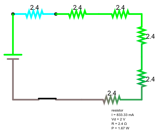

September 4, 20186 yr comment_556799 I forgot that you had the rail out when I suggested just starting the engine. In my test, I wired the injectors in series so total circuit resistance was 6 x 2.5 ohms...15 ohms. I was more concerned that they might not open. But the key is that it's not voltage that is the concern, it's current. Overheating. If you connect 12 volts to a dry injector I think that it might heat up enough to do some damage, over time. Maybe. But in your case with the dropping resistors in place, and fuel passing through, there shouldn't be any problem. The injectors see 12 volts as soon as you turn on the key. They're opened by grounding that voltage at the ECU. Link to comment https://www.classiczcars.com/forums/topic/60656-78-280z-severe-driving-problems/?&page=6#findComment-556799 Share on other sites More sharing options...

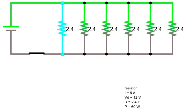

September 5, 20186 yr Author comment_556938 On 9/3/2018 at 9:12 PM, Zed Head said: In my test, I wired the injectors in series so total circuit resistance was 6 x 2.5 ohms...15 ohms. For clarification purposes, when you say you wired the injectors in series, you literally meant in series? If yes, then this yields 833mA at each injector. Wired in parallel yields 5A at each injector. ? I don't want to let the smoke out, then they won't work anymore..... ? Link to comment https://www.classiczcars.com/forums/topic/60656-78-280z-severe-driving-problems/?&page=6#findComment-556938 Share on other sites More sharing options...
September 6, 20186 yr comment_556945 Yes, low amps = low heat. If yours are still on the factory harness don't forget about the dropping resistors. They're 6 ohm, so 8.4 ohms per injector, in use on the car. 1.4 A. Or, considering alternator voltage...14/8.4 = 1.7 A. Link to comment https://www.classiczcars.com/forums/topic/60656-78-280z-severe-driving-problems/?&page=6#findComment-556945 Share on other sites More sharing options...
September 6, 20186 yr Author comment_556949 41 minutes ago, Zed Head said: Yes, low amps = low heat. If yours are still on the factory harness don't forget about the dropping resistors. They're 6 ohm, so 8.4 ohms per injector, in use on the car. 1.4 A. Or, considering alternator voltage...14/8.4 = 1.7 A. Thanks for the clarification?. I have an extra set of injector connectors I will put together in series for the volumetric test out of the vehicle. The parallel circuit was an example outside of the car (excluding the dropping resistor) but you are correct, about 1.7A in the vehicle with the dropping resistor. Link to comment https://www.classiczcars.com/forums/topic/60656-78-280z-severe-driving-problems/?&page=6#findComment-556949 Share on other sites More sharing options...
