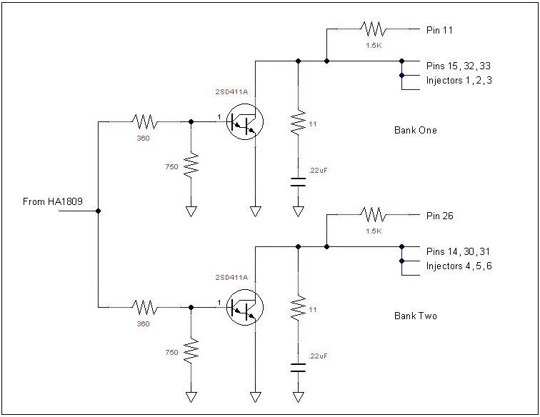

I can check the other bank, but I am pretty sure they are working, I can get it to idle fine (no missing) IF I manually deflect the AFM vane about 20 degrees. Once I open the throttle up, it runs normally (no manual deflection of the AFM required), so the problem seems to be isolated to low throttle or idle. I know the TPS is working since the other ECU works fine in the test stand. I maybe wrong on "runs normally at high throttle though, I did not run it very long that way, and as soon as I let off the throttle it backfired and blew the AFM completely off the throttle body.

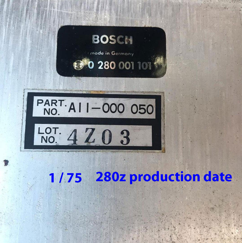

Very interesting topic. I have a 1/75 280z  with CPU PN  A11-000 050 which doesn't show up on the Federal or CA models chart. My car was a CA car from the beginning and has a  M/T.
I have two additional CPU's  I grabbed several years ago when gong through wrecking yards. I don't remember what years they came out of, but here's the curious thing. Both of the CPU's work perfectly in my car. That is the car starts and runs just as good as the OEM BOSCH CPU . Just thought I would add to mix.
Ron

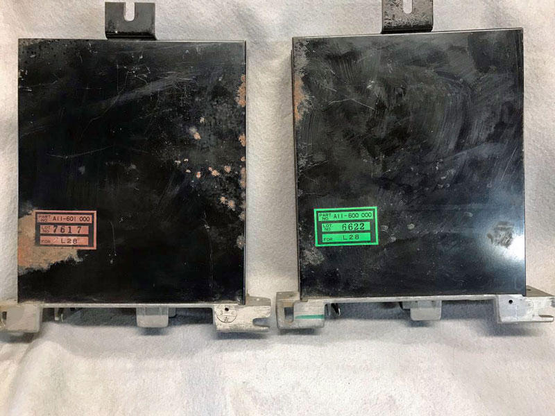

Didn't mean to dig up an old thread but I want to share this with anyone who is curious if their ecu will work. I just picked up a A11-000-000 ecu which according to the sheet is a 1975 automatic California ecu. I placed it into a 1977 manual California ecu car with model A11-601-000. Car started fine and had no problems. Even though the ecu is 1975 and an automatic, it started and revved to 3k no problem. Haven't driven it yet but I can make an update if needed
  • Thanks 1
Also i just noticed that my ecu that ive had with the car ever since is an auto ecu. It's definitely not a swapped manual Z judging by the serial number not having an A meaning auto. Probably a replacement ecu back in the day
