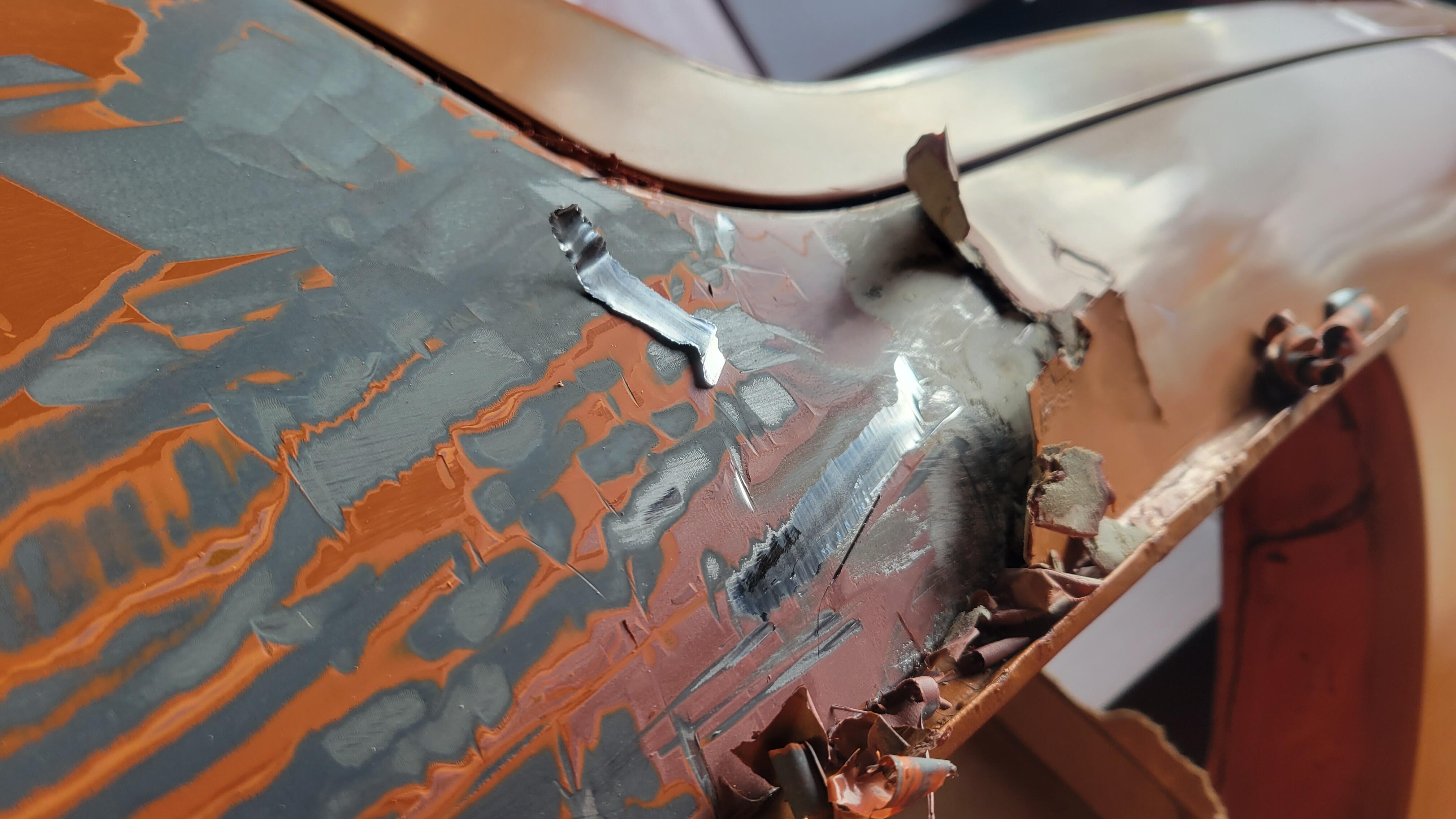

March 6, 20223 yr Author comment_636878 Continuing with the paint removal today. For others who try this method don't cheap out on the razor blades. I started out using Richard brand made in the USA blades, which work very well and stay sharp for quite a while. Then I used some cheap ones I ordered on amazon, Titan brand made in China. First off they were loose in the holder and and they lost the sharp edge quite fast. I'm back to using the Richard blades. Today I've been working on the RH quarter panel. I had the quarters replaced in the early 1980's and even then my local Datsun dealer was not able to get a 70/71 panel, so I had to have my body man weld in a patch to close the vent hole. I found evidence of the repair while doing the paint removal this morning. During the paint removal I found body filler in that area that was up to .10" (2.5mm) thick, but with heat and razor blading the paint and filler came off in one go. Here is another video showing removal of paint and filler (glazing putty?) on the LH quarter. Edited March 6, 20223 yr by CanTechZ Link to comment https://www.classiczcars.com/forums/topic/60693-1970-hls30-06521-re-restoration/?&page=13#findComment-636878 Share on other sites More sharing options...
March 6, 20223 yr comment_636886 Good commentary on the razor blades. Having the brand of a good product always helps. The heat gun/razor blade paint removal process beats the hell out of chemical stripper. Along that line, back in '97 my brother the "expert" body man was helping me with my restoration (that went dormant until last year). So last year when I was cutting out a bunch of crappy work I had done back then I found 1/4" of filler in the rear lower quarters. Darn I said, how did that get there? Can you imagine, a 1/4"? Guess who's not helping this time around? 😁 Link to comment https://www.classiczcars.com/forums/topic/60693-1970-hls30-06521-re-restoration/?&page=13#findComment-636886 Share on other sites More sharing options...
March 7, 20223 yr comment_636893 17 hours ago, CanTechZ said: I started out using Richard brand made in the USA blades, which work very well and stay sharp for quite a while. Then I used some cheap ones I ordered on amazon, Titan brand made in China. First off they were loose in the holder and and they lost the sharp edge quite fast. I'm back to using the Richard blades. We all tryed the cheaper ones and ... then we knew why they were so cheap! 😄 The saying is not for nothing (overhere at least:) Good tools is half the work! Link to comment https://www.classiczcars.com/forums/topic/60693-1970-hls30-06521-re-restoration/?&page=13#findComment-636893 Share on other sites More sharing options...
March 7, 20223 yr Author comment_636904 15 hours ago, ETI4K said: Good commentary on the razor blades. Having the brand of a good product always helps. The heat gun/razor blade paint removal process beats the hell out of chemical stripper. Along that line, back in '97 my brother the "expert" body man was helping me with my restoration (that went dormant until last year). So last year when I was cutting out a bunch of crappy work I had done back then I found 1/4" of filler in the rear lower quarters. Darn I said, how did that get there? Can you imagine, a 1/4"? Guess who's not helping this time around? 😁 I should expand on the low quality of the Titan import blades from Amazon. It's not only that they don't last as long, but how they wear as well. They don't seem to wear evenly and loose sharpness on part of the edge, this makes it difficult to make even straight cuts. The blade wants to turn and tends to gouge, especially on concave curved surfaces. If anyone tries this method also make sure to use only enough heat to slightly soften the paint, especially on flat areas like the hood. I found that on flat areas if I couldn't hold my hand on the heated surface for at least 3 to 5 seconds, it was too hot. Good to move around quite bit. It's surprising how little heat it takes to warp the metal. Link to comment https://www.classiczcars.com/forums/topic/60693-1970-hls30-06521-re-restoration/?&page=13#findComment-636904 Share on other sites More sharing options...
