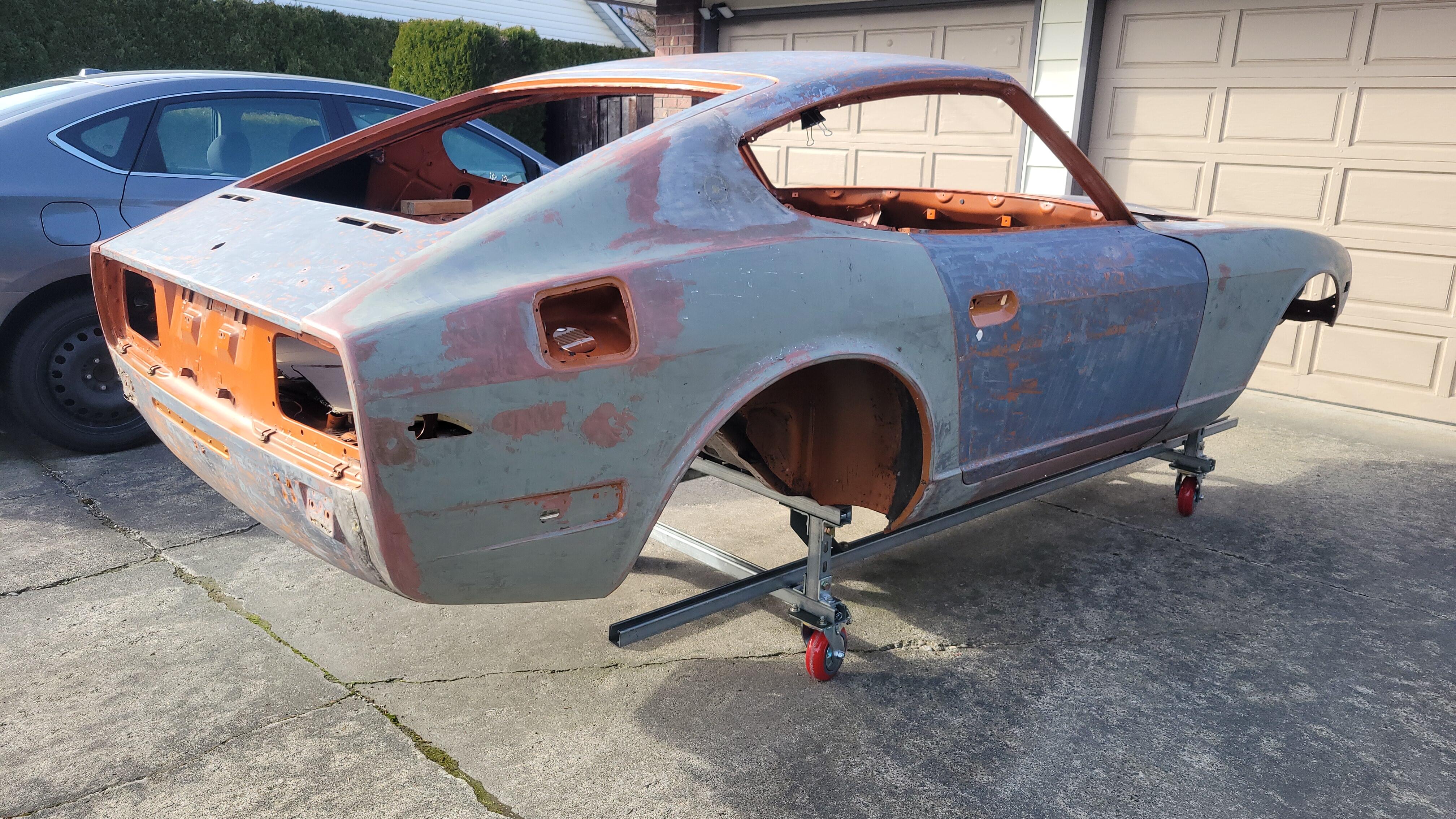

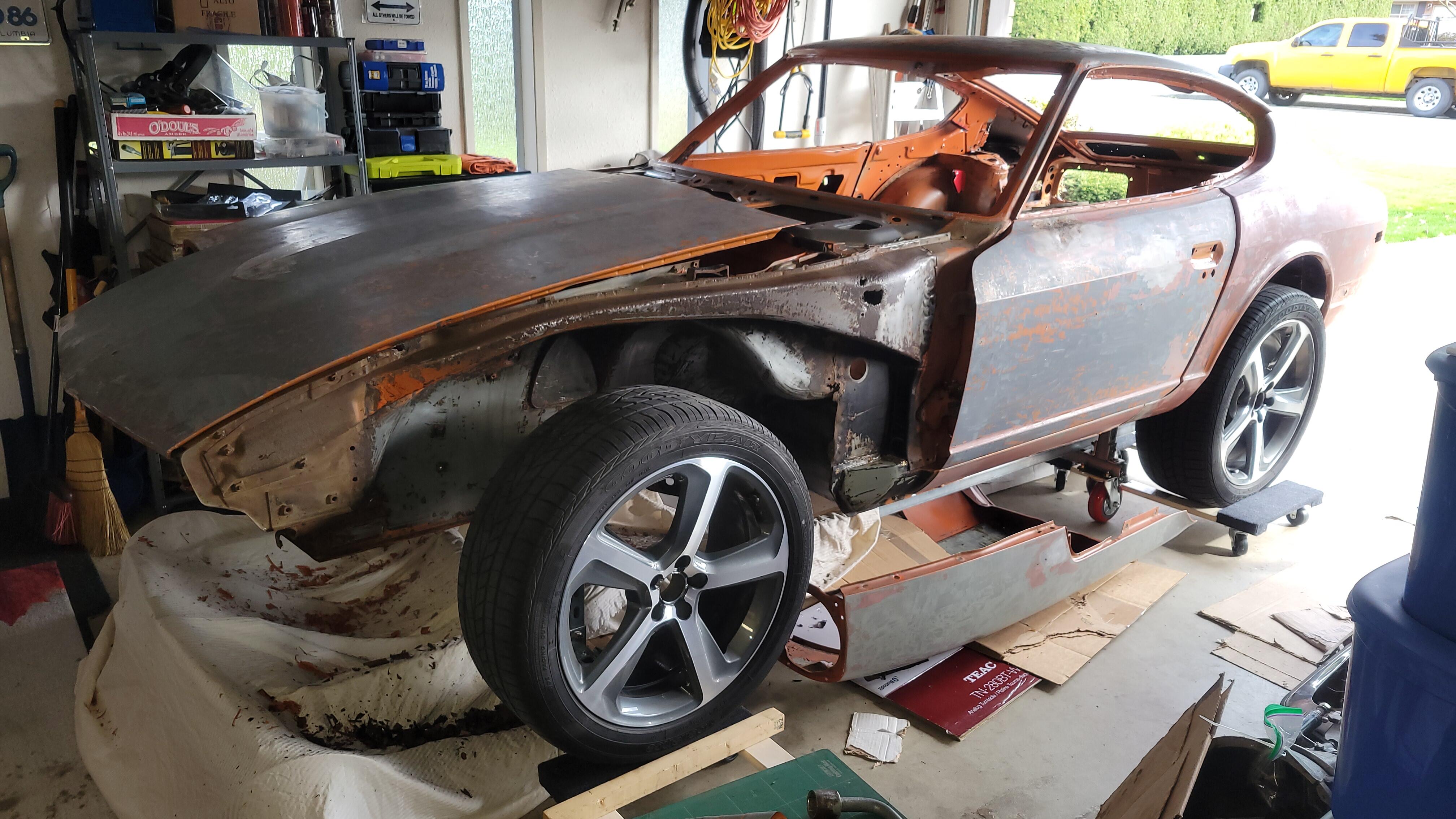

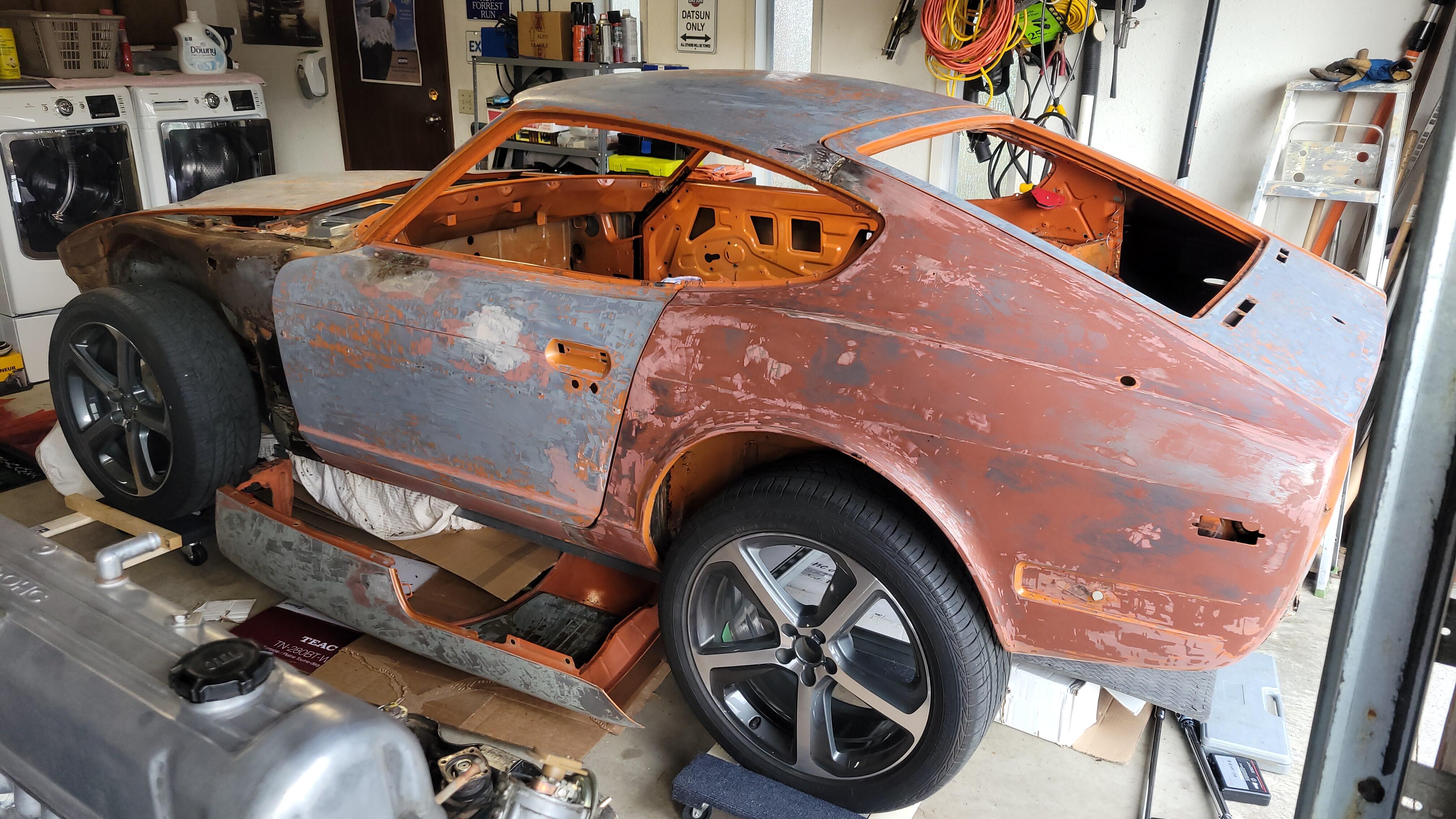

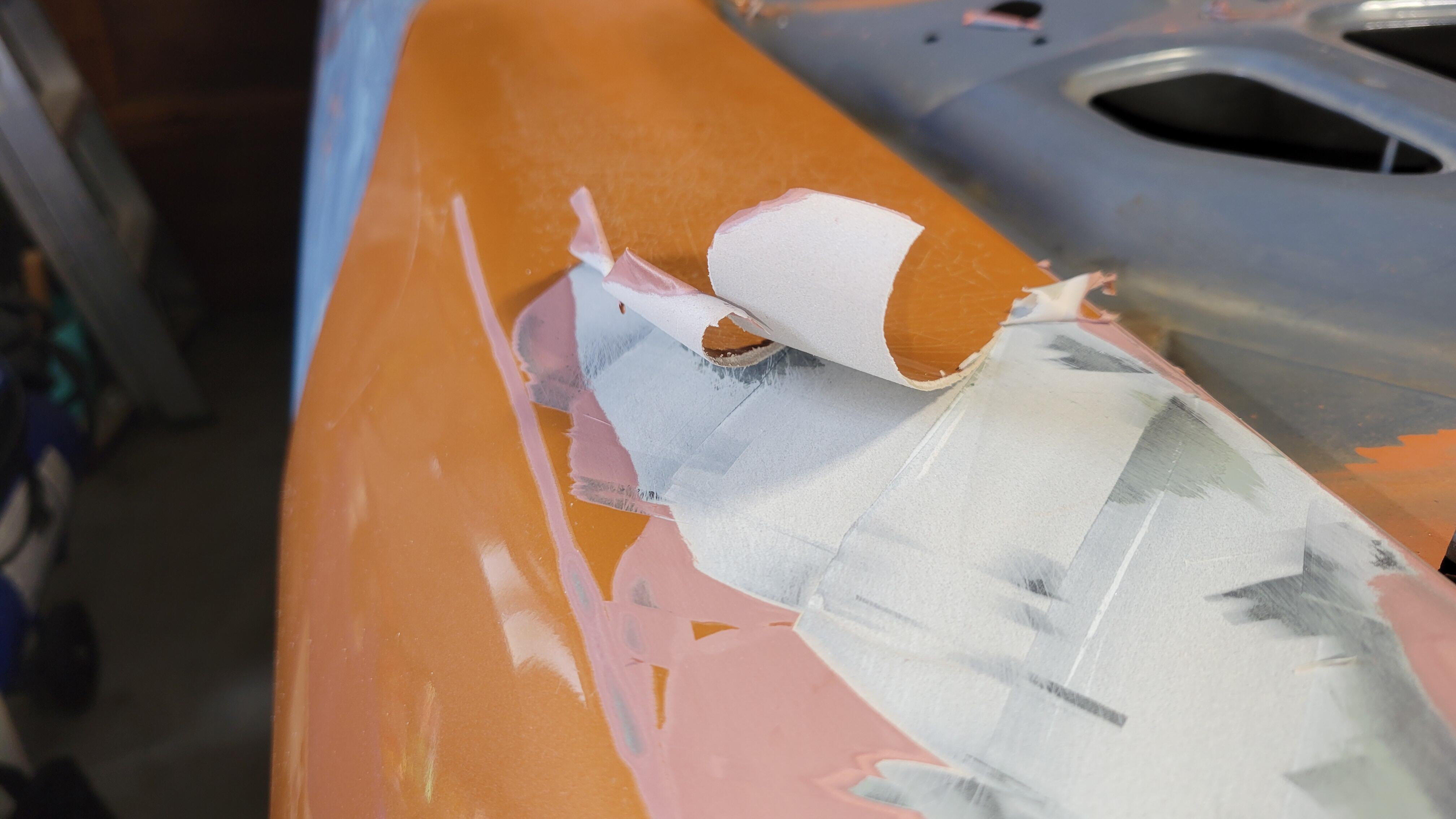

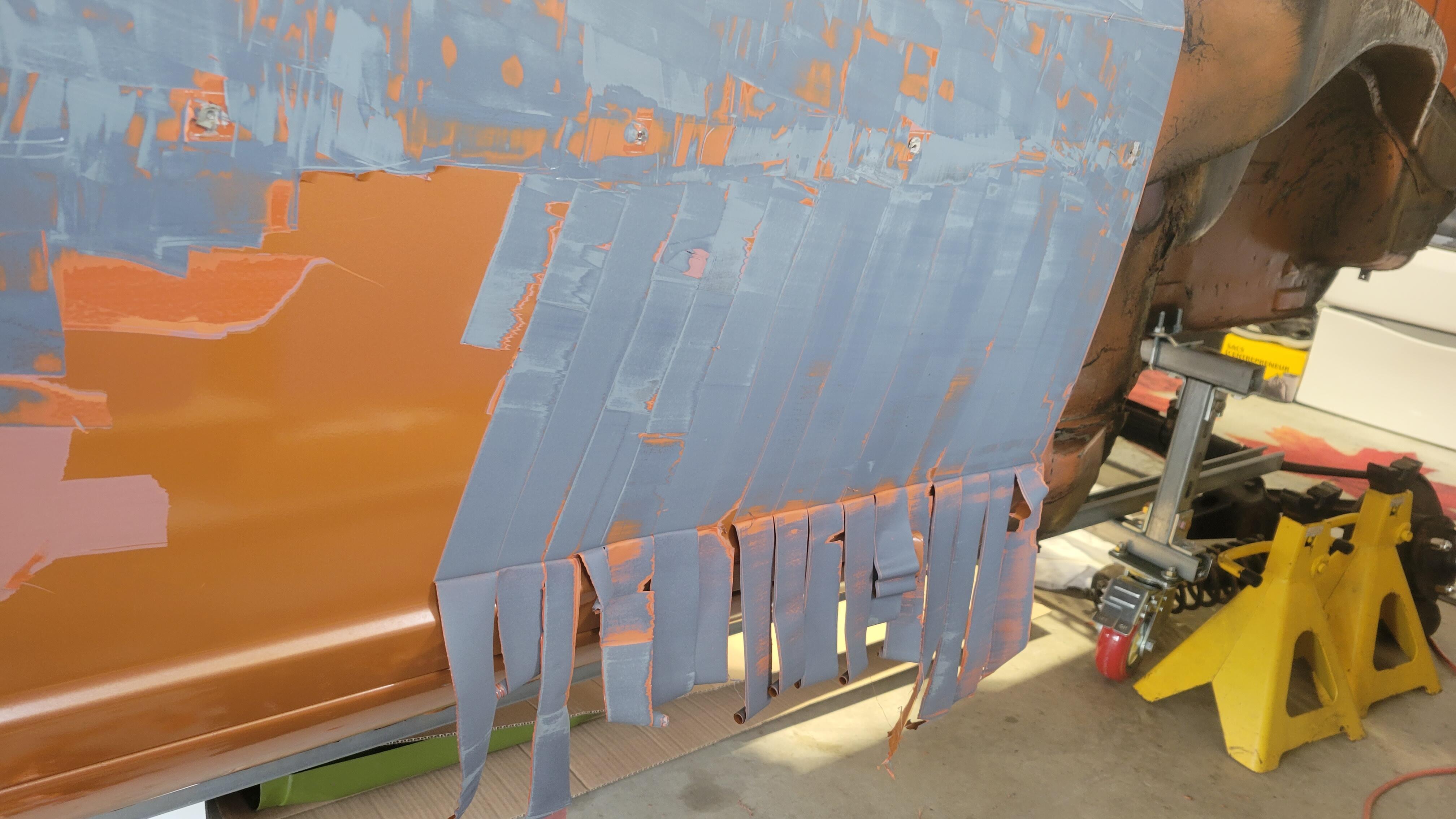

March 29, 20223 yr Author Popular Post comment_638665 Here's an update on the paint removal process, using heat and razor blades. The exterior is basically done. I will leave last traces of primer for my body guy to deal with. It's only about 0.5 mil thick, plus or minus. Link to comment https://www.classiczcars.com/forums/topic/60693-1970-hls30-06521-re-restoration/?&page=14#findComment-638665 Share on other sites More sharing options...

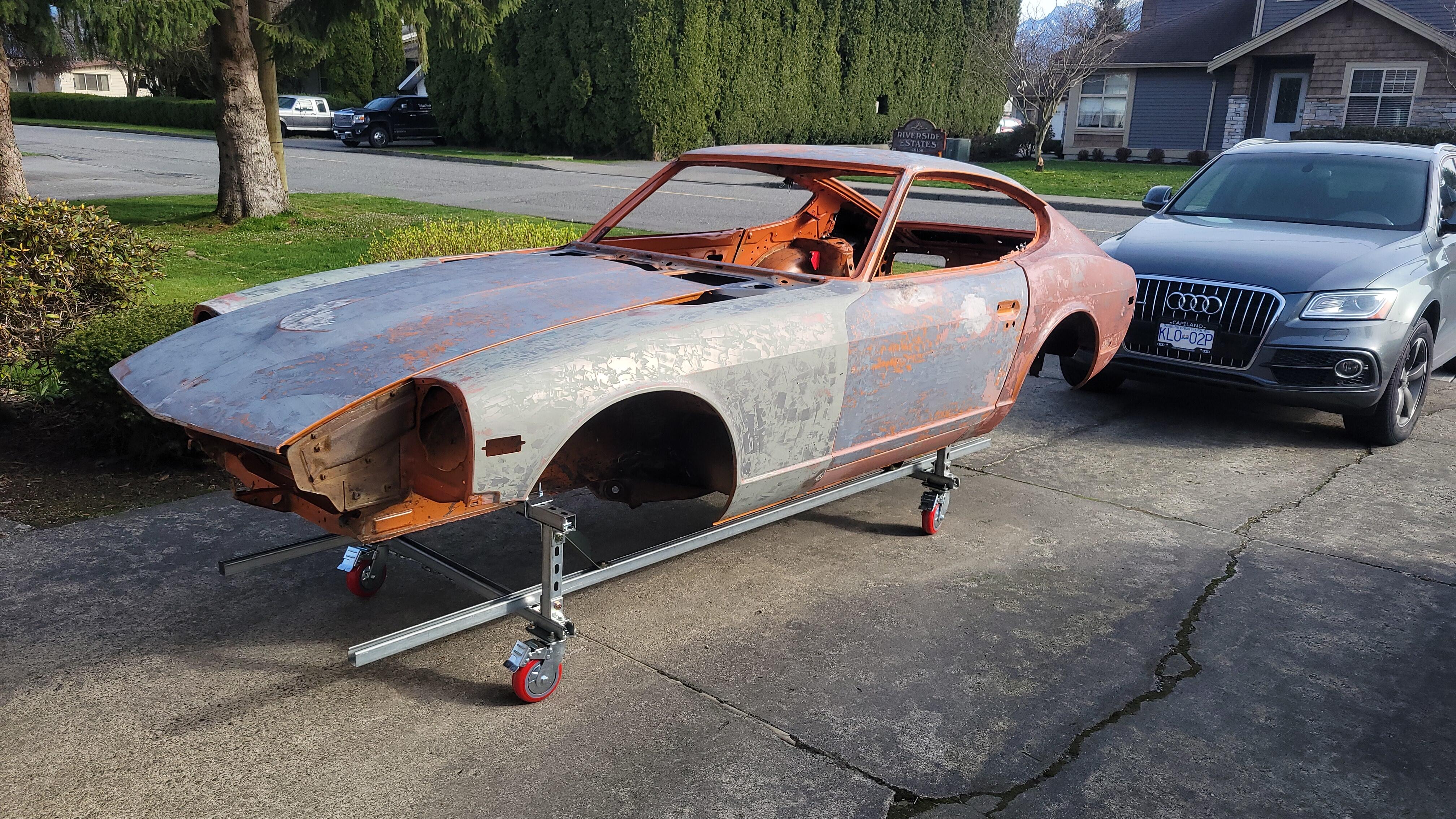

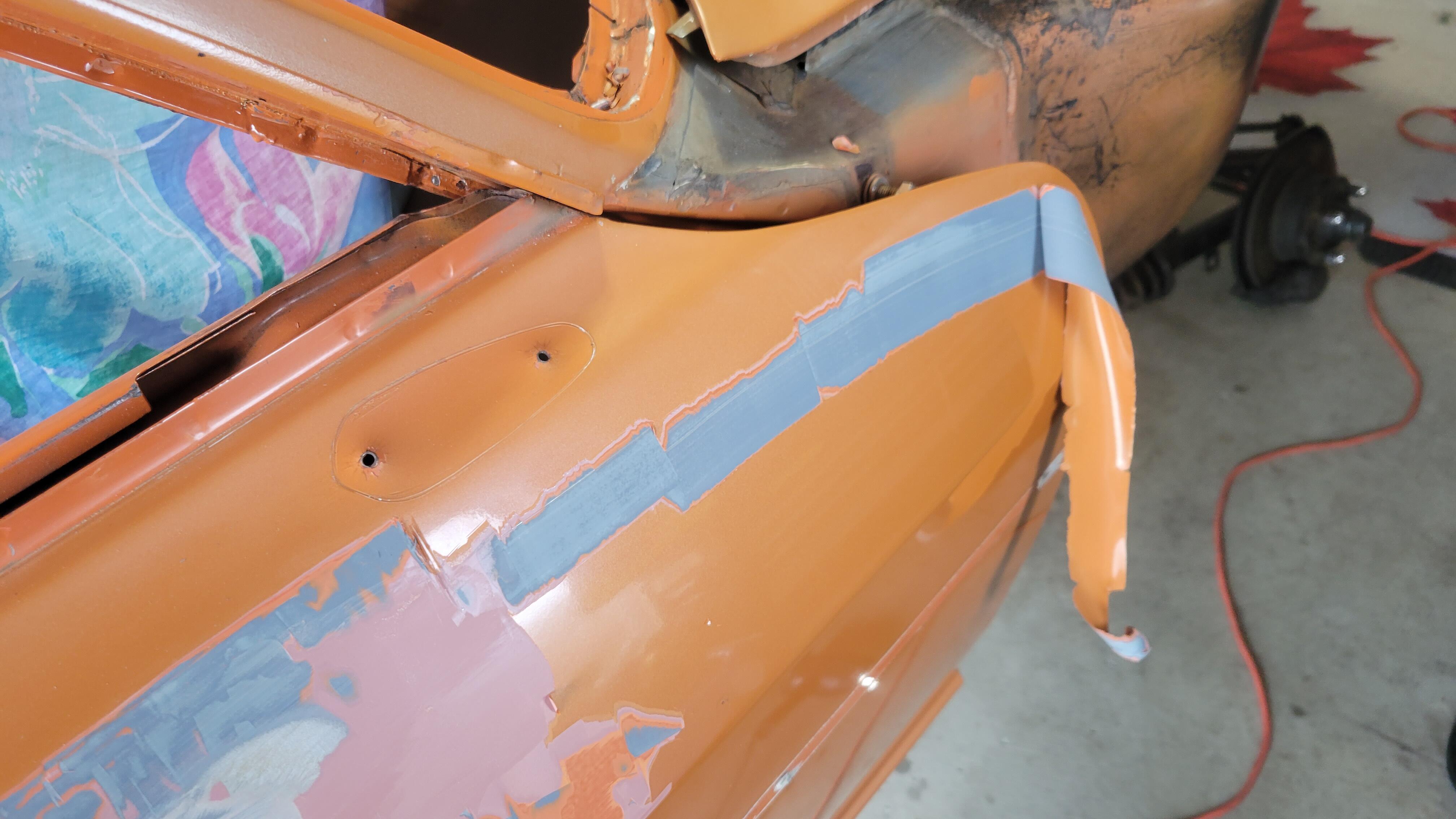

March 30, 20223 yr comment_638728 Any idea why filler was used on the top surface of your passenger-side front fender? Seems like an odd place for the surface to be low. Link to comment https://www.classiczcars.com/forums/topic/60693-1970-hls30-06521-re-restoration/?&page=14#findComment-638728 Share on other sites More sharing options...
March 30, 20223 yr Author comment_638729 1 hour ago, Namerow said: Any idea why filler was used on the top surface of your passenger-side front fender? Seems like an odd place for the surface to be low. I was also to surprised to find that and I have no idea as to why. It was done over 40 years ago. Found similar in a couple of other spots on the body, but it did seem strange on a new replacement OE fender. Link to comment https://www.classiczcars.com/forums/topic/60693-1970-hls30-06521-re-restoration/?&page=14#findComment-638729 Share on other sites More sharing options...

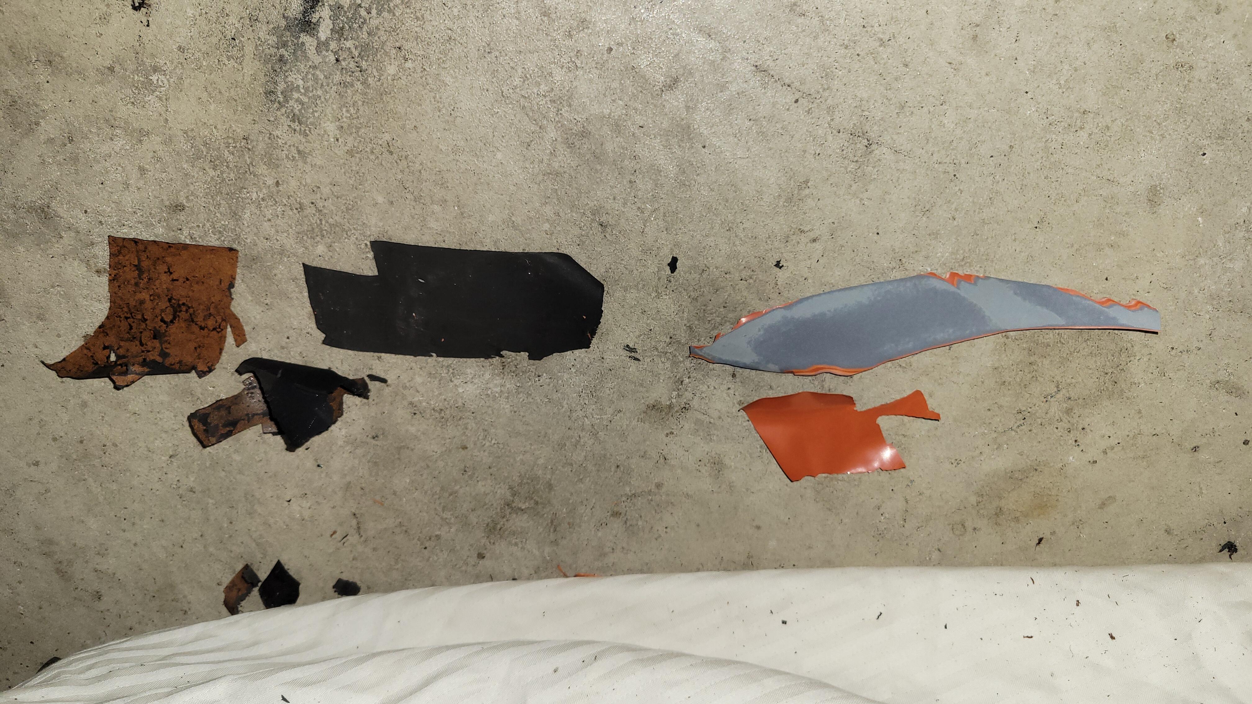

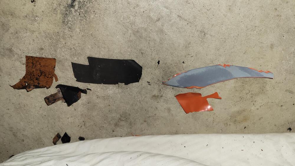

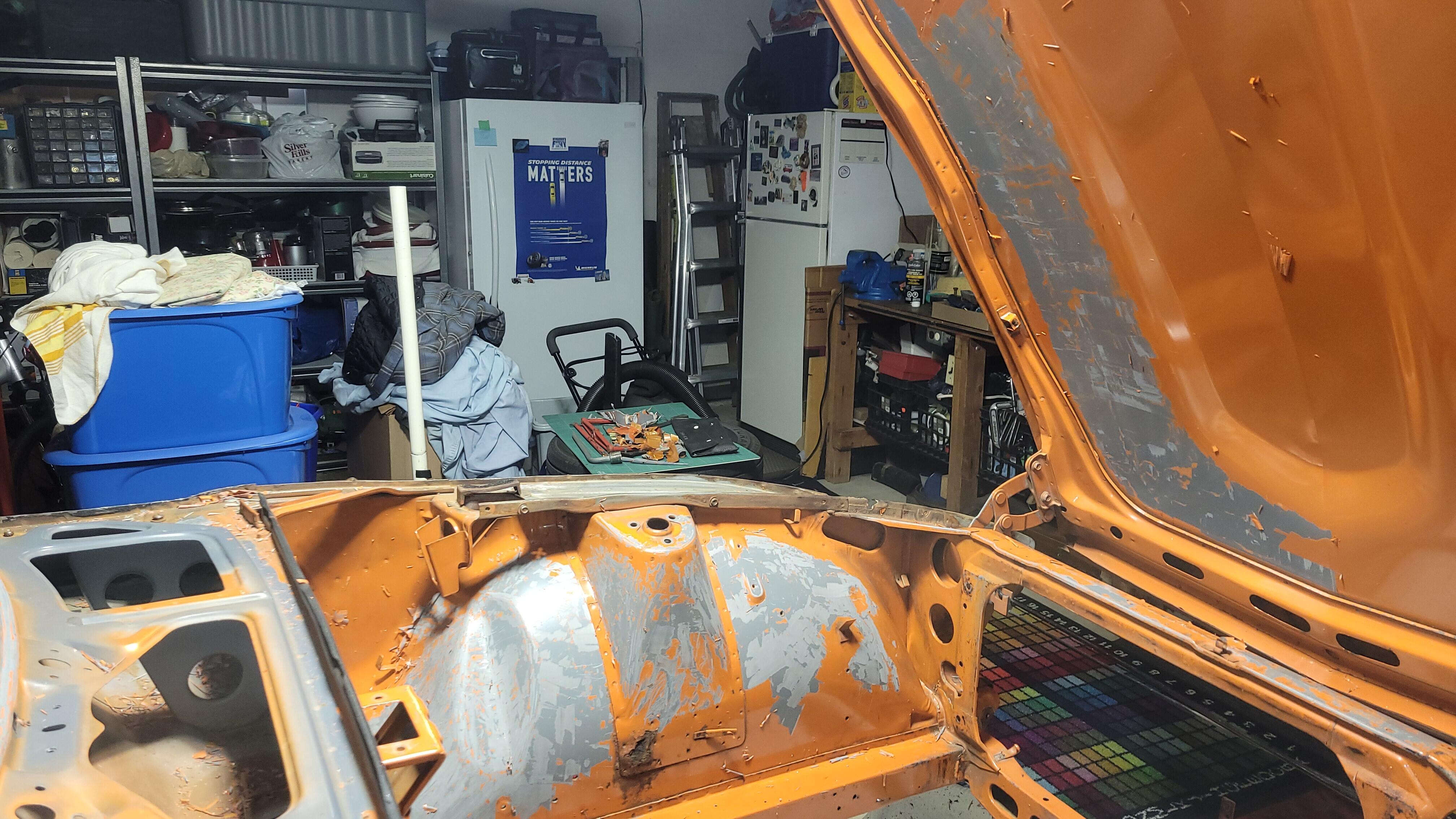

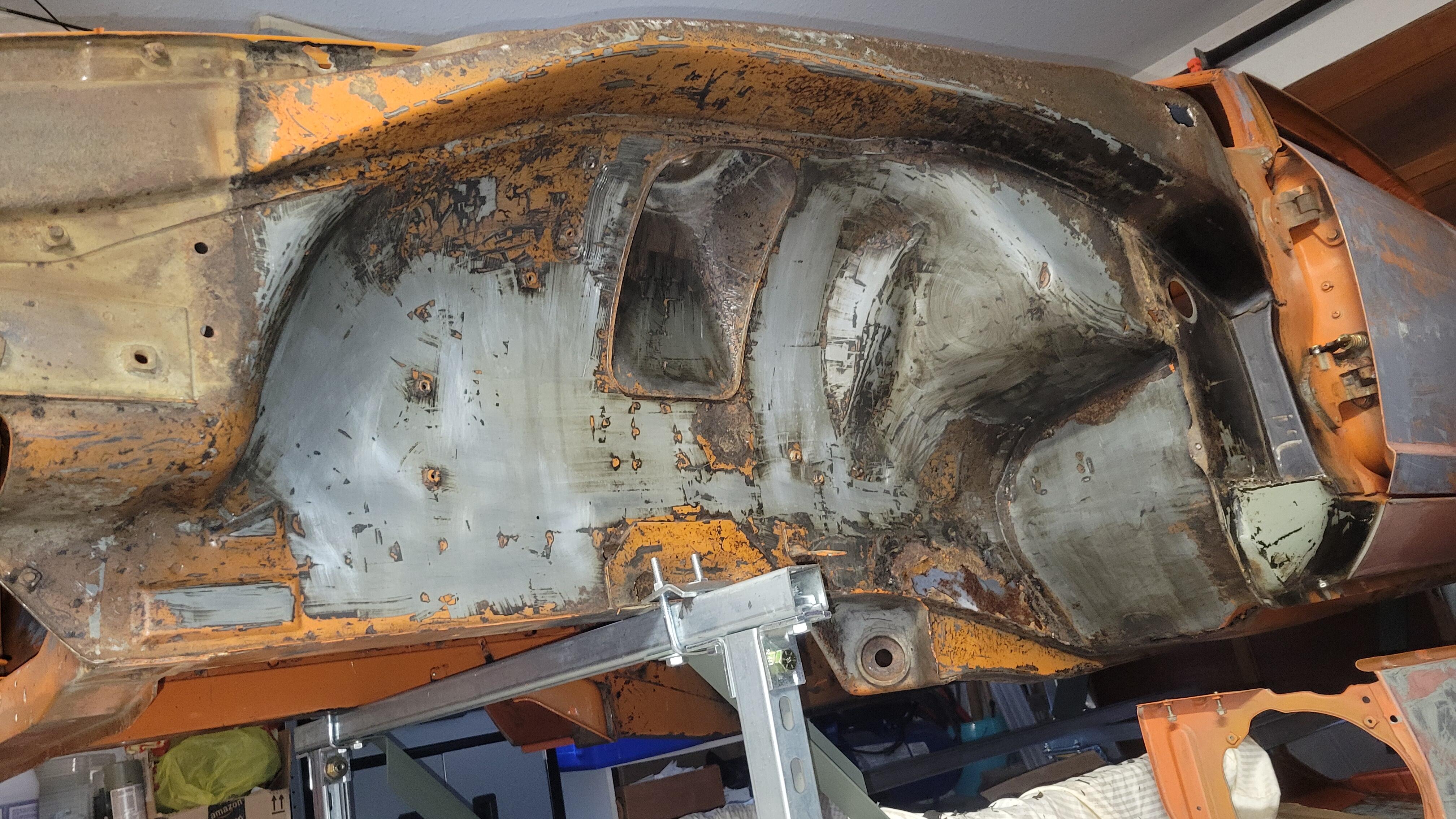

April 2, 20222 yr Author comment_638872 Started doing some paint removal in the inner fender area and under the hood. Interesting that the factory primer on the inner fenders is dark charcoal grey, almost black and not medium grey like the outer and under hood surfaces. Link to comment https://www.classiczcars.com/forums/topic/60693-1970-hls30-06521-re-restoration/?&page=14#findComment-638872 Share on other sites More sharing options...
April 2, 20222 yr comment_638877 3 hours ago, CanTechZ said: Started doing some paint removal in the inner fender area and under the hood Are you continuing to use your heat-and-razor approach for these areas? The contours look a little challenging for a flat blade. Link to comment https://www.classiczcars.com/forums/topic/60693-1970-hls30-06521-re-restoration/?&page=14#findComment-638877 Share on other sites More sharing options...
April 2, 20222 yr Author comment_638882 2 hours ago, Namerow said: Are you continuing to use your heat-and-razor approach for these areas? The contours look a little challenging for a flat blade. Yes, with care. I will leave some areas where the concave curves are to tight. Link to comment https://www.classiczcars.com/forums/topic/60693-1970-hls30-06521-re-restoration/?&page=14#findComment-638882 Share on other sites More sharing options...
