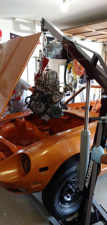

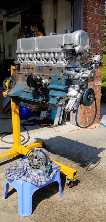

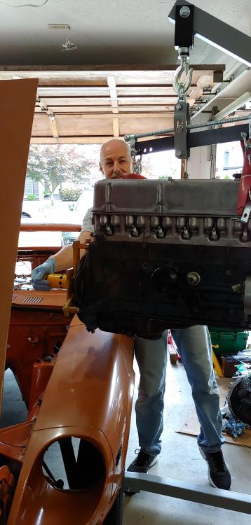

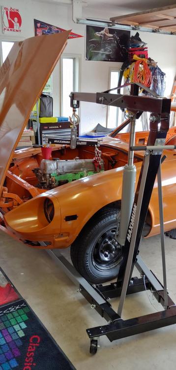

Successful event yesterday pulling the engine, without removing the hood. It only took about 15 minutes to lift it out and mount on my engine stand. Thanks to my friend, Dave. I did spend a good part of the day before doing the rigging and taking measurements to make sure I wouldn't need to remove the hood. Getting very close to sending the shell to my body guy Jody.

That's impressive work.  Nice attention to planning and details.  Not a great deal of ceiling clearance in your garage workspace, either.
I don't think I've ever heard anyone talk about pulling a Z engine without removing to hood.  I don't think I've seen anyone bring the hoist in from the side, either.

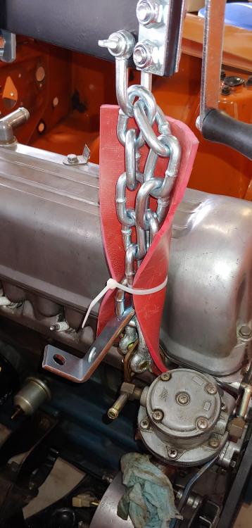

Going back to the engine removal for a moment, I noticed two things you did that I'd like the hear more about:
  • At the front hoist point, you bypassed the lift bracket installed on the hoist chain and used, instead, a clevis and a bolt.  Was the clevis a part of the hoist kit, or did you source it separately?
  • At the rear hoist point, you appear to have removed the header stud and used a bolt instead. Please explain.
The clevis was purchased separately, as I used a factory lifting bracket the clevis worked better than the L bracket on the leveler. Funny thing, I checked first I checked Canadian Tire and they only had Chinese non rated clevis's, the one I selected is from a local industrial supply store, it is a 3/8" VGD "gold pin" anchor shackle with a 1 ton WLL and it was cheaper than the CDN Tire import.
At the rear I actually used the rear intake mounting hole that uses an M8 capscrew. I used a shorter screw plus, a 14mm OD x 8.5mm ID sleeve in the hole of the lifting bracket on the leveler.
