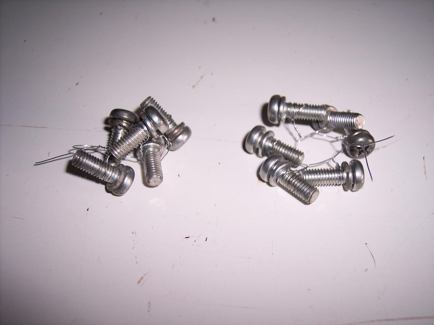

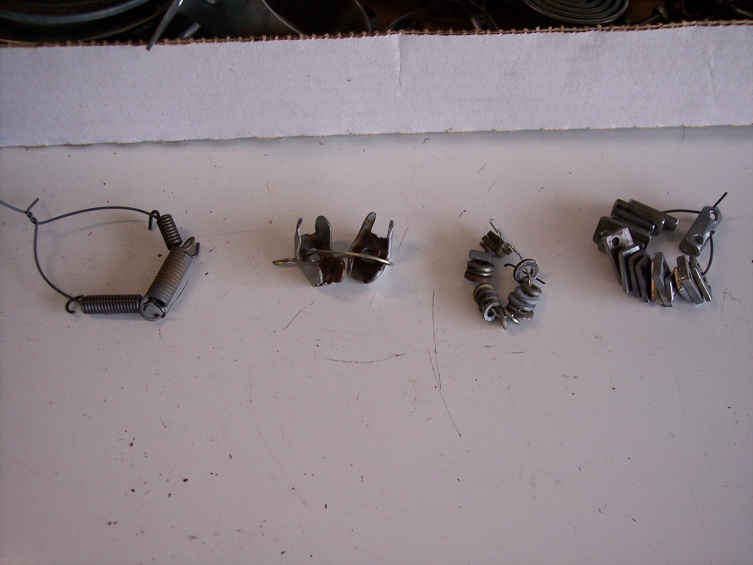

I understand your concern over remembering where everything goes after plating - we all go thru that.  Here's a suggested approach:
- During disassembly, carefully bag and tag everything immediately as it comes off the car.  DO NOT consolidate stuff, make it specific.  Use a paper tag inside the zip bag with the parts to identify what it is / where it came from - a felt tip marker on the bag can easily rub off.
- Thoroughly clean everything in a bag, remove all rust, dirt, paint, ...etc.  The better you clean things, the better your plating results (remember the old axiom: garbage in. garbage out).  A wire brush wheel on a bench grinder is great!  Take stuff apart wherever possible: bolts, nuts, washers, springs, ...etc.  If the factory plated things before assembly, so should you.
- When a bag of parts is clean, photo the parts with the paper tag visible.  Put it all back in the bag until all is done.
- Small parts like washers, nuts, tiny springs can and will get lost in plating if left loose.   Use some thin, soft wire to make closed loops for like things: nuts, washers, springs.  For tiny screws, tightly wrap thin wire a couple of times around the threads then give it a twist to lock it in place (see pics).
- When everything is cleaned, the moment of truth arrives: time to dump everything into a big zip bag to take to plating.  Save your small bags and tags for use later when it all comes back.  If you've properly documented everything, you should be able to return all parts to their original bag with tag.
Good luck.
https://www.classiczcars.com/forums/topic/60702-platting/#findComment-556857
