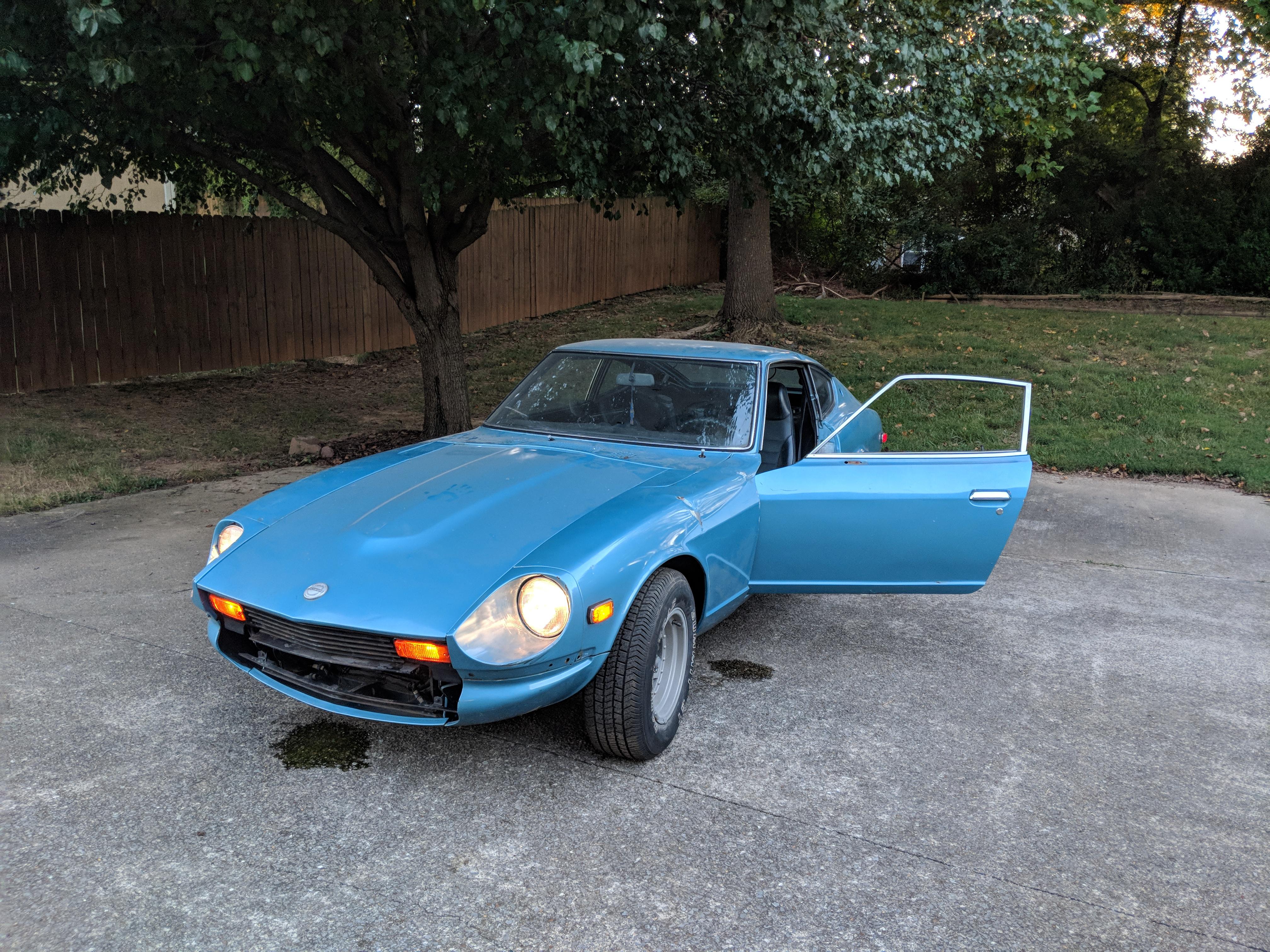

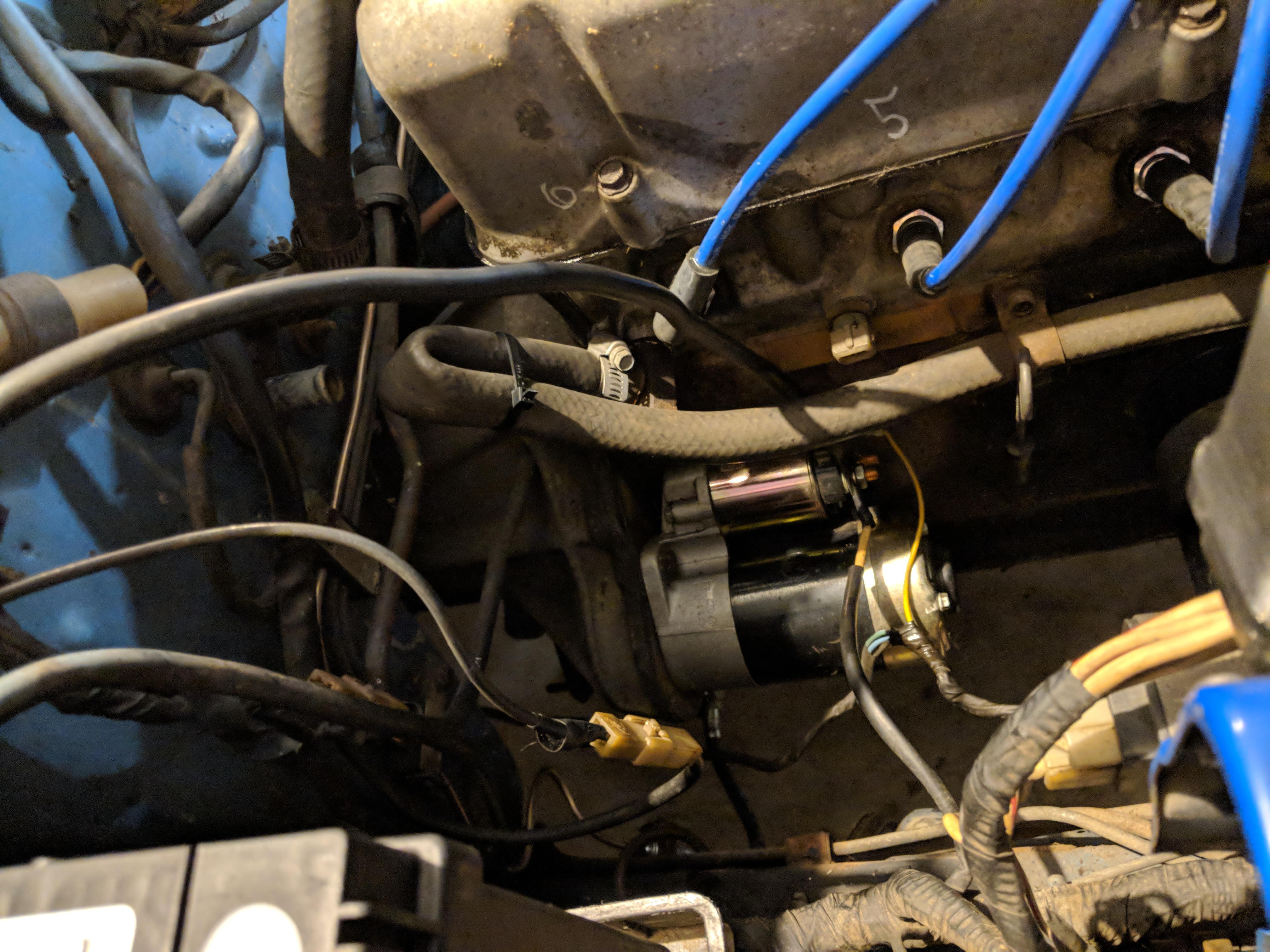

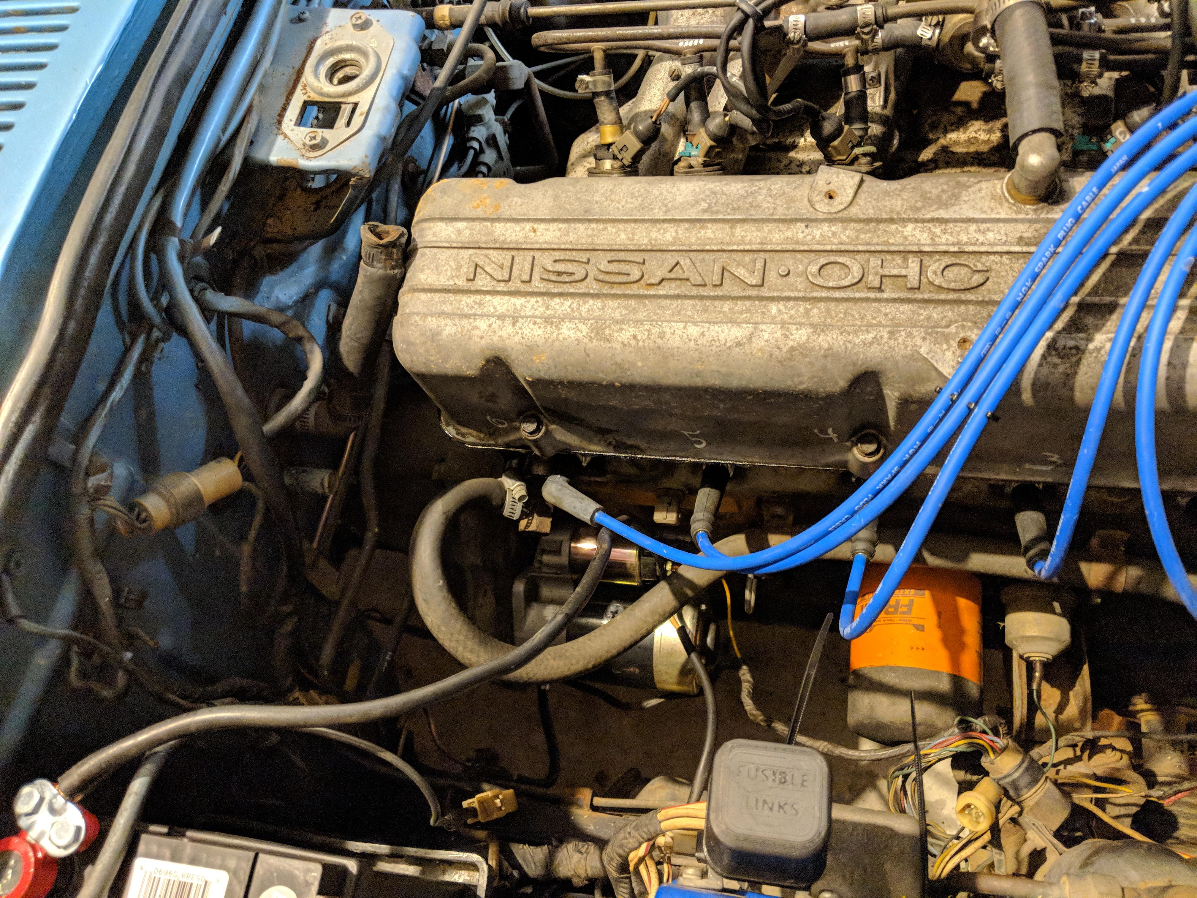

Posted September 4, 20186 yr comment_556800 Well I finally got my Z to (almost) ambulatory status. Unfortunately after about 5 minutes of idling and a very brief trip down the driveway and back, coolant started streaming out of the vent tube originating by the radiator cap. And continued for a couple minutes after shutting it off. Kind of a sad end to it's first self-propelled journey, but was curious if anyone had any ideas on why it would be dumping coolant. I don't think I had it running long enough to get anywhere near overheating. Is that where it would purge if I had maybe over-filled it? Or is it possible that it did overheat after a couple minutes if idling.. I have also recently replaced the thermostat. And I also took the two coolant lines running through the firewall (I was assuming one was going into the heater core, and one was coming back) and just hooked one output into the other input so the heater core is omitted (picture included; had a leak somewhere above the passenger side floorboard and saving that for later). I also just replaced the radiator cap. Any obvious answers here? I'm worried I screwed up those lines. Or maybe something is funky with the thermostat.. or maybe I'm being paranoid and I just over-filled it. Thoughts? Thanks! Link to comment https://www.classiczcars.com/forums/topic/60703-75-280z-made-it-out-of-the-garage-briefly/ Share on other sites More sharing options...

September 4, 20186 yr comment_556807 14 minutes ago, Neb said: Unfortunately after about 5 minutes of idling and a very brief trip down the driveway and back, coolant started streaming out of the vent tube originating by the radiator cap. Kind of a sad end to it's first self-propelled journey, but was curious if anyone had any ideas on why it would be dumping coolant. I don't think I had it running long enough to get anywhere near overheating. Is that where it would purge if I had maybe over-filled it? just hooked one output into the other input so the heater core is omitted ( I also just replaced the radiator cap. Any obvious answers here? The radiator cap is just a pressure relief valve. If the pressure is exceeded the coolant is purged through that tube. Could be that you got the wrong cap or that you just didn't have it inserted right. Check that cap closely, make sure it's seated so that it can hold pressure. If it's not seated the coolant will just flow out as it expands. The heater cores are best if they are blocked, not connected. By connecting them you're creating a short circuit for the coolant and it doesn't pass through the head. It just circles around in that useless loop. It reduces the overall flow through the engine. Where'd you get that cool looking "FUSIBLE LINKS" cover? Is that what they used in 1975? Link to comment https://www.classiczcars.com/forums/topic/60703-75-280z-made-it-out-of-the-garage-briefly/#findComment-556807 Share on other sites More sharing options...
September 4, 20186 yr Author comment_556814 30 minutes ago, Zed Head said: The radiator cap is just a pressure relief valve. If the pressure is exceeded the coolant is purged through that tube. Could be that you got the wrong cap or that you just didn't have it inserted right. Check that cap closely, make sure it's seated so that it can hold pressure. If it's not seated the coolant will just flow out as it expands. The heater cores are best if they are blocked, not connected. By connecting them you're creating a short circuit for the coolant and it doesn't pass through the head. It just circles around in that useless loop. It reduces the overall flow through the engine. Where'd you get that cool looking "FUSIBLE LINKS" cover? Is that what they used in 1975? Hmmm alrighty. I'll try the old radiator cap and see if it happens again. And I'll block that line; thanks for the input! I hope the 'short circuit' didn't cause it to overheat.. I 3D printed it ? want one? 48 minutes ago, Patcon said: Does the temperature gauge work? What did it read? Yes they can overheat quickly if there is a problem. Overheating these aluminum headed engines is a no-no. This is what I'm worried about. I need to troubleshoot the temp guage; it either isnt working or it didn't get hot enough to register. I think tomorrow I'll take it out and put it in some hot water while still electrically connected and see what I get. It's a new sensor so I was hoping it would work ? but I'm yet to actually see it register anything Link to comment https://www.classiczcars.com/forums/topic/60703-75-280z-made-it-out-of-the-garage-briefly/#findComment-556814 Share on other sites More sharing options...

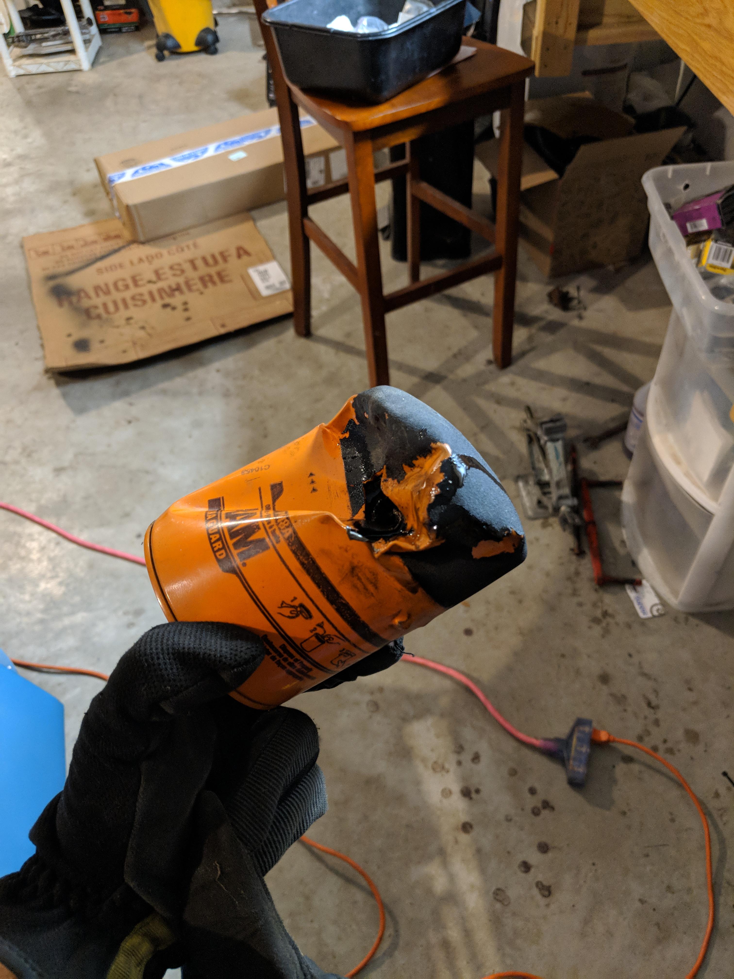

September 5, 20186 yr Author comment_556895 Success! I swapped out the radiator cap and that seems to of resolved the coolant purge issue. Ran it for a good 10-15 minutes last night and didn't have any coolant leaks. Also did a temp fix on that coolant hose to block the bypass for now. Also also took a quick look at the water temp sensor; still nothing on the gauge. Pretty sure its wired up correctly. Sensor is new. More troubleshooting to follow.. Probably would have gotten more done, except I also changed the oil and had some serious difficulty removing the old oil filter. And while I was at it, I got the oil pressure sensor swapped and functioning. Good to see at least that gauge is doing what its supposed to ? Definitely appreciate the replies! Link to comment https://www.classiczcars.com/forums/topic/60703-75-280z-made-it-out-of-the-garage-briefly/#findComment-556895 Share on other sites More sharing options...

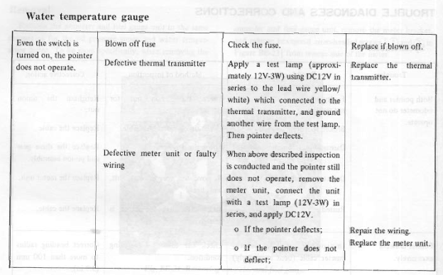

September 5, 20186 yr comment_556911 5 hours ago, Neb said: Success! I swapped out the radiator cap and that seems to of resolved the coolant purge issue. Ran it for a good 10-15 minutes last night and didn't have any coolant leaks. Also did a temp fix on that coolant hose to block the bypass for now. Also also took a quick look at the water temp sensor; still nothing on the gauge. Pretty sure its wired up correctly. Sensor is new. More troubleshooting to follow. I think that you can test the gauge itself by grounding the harness wire at the sender to the block through a small resistance. You can also measure resistance through the sender prong to the block to see if it's good. The sender ground through its threads I think. Sometimes people use Teflon tape and don't get the ground. Found a procedure in the 1972 FSM - Link to comment https://www.classiczcars.com/forums/topic/60703-75-280z-made-it-out-of-the-garage-briefly/#findComment-556911 Share on other sites More sharing options...
