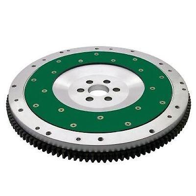

I've seen this talked about in bits and pieces all over the place, but still haven't really got the answer I'm looking for. I have a 75' 280z (on jack stands for the last few years). It's a 4 speed car. I have the 5 speed and the 3.90R200 to put into it, and when I do (soon. i'm trying to rekindle this project), I would like to install a lightweight flywheel and of course new clutch. I don't want to go too light. If I recall, the stock weight is 22-23lbs. What I see all over ebay is the Fidanza packaged up with the Exedy clutch. Seems like a good package but that flywheel only weighs 10.7lbs. This is not going to be a race car, it's a fun street car. At half the weight I'm worried it wont be practical for commuting. Am I over thinking this or should I just go for it? Is there something in-between I should be looking at? I don't really have a machinist (that I trust) local to lighten my stock flywheel. Anyway, I just wanted to know if there are any other (reasonably priced) options out there or if the Fidanza is the just the way to go.

FIdanza 143281 flywheel fits all L6 and has bolt patterns to attach both the 225 and 240mm clutches. 10 lbs ish. Replacable friction surface.
