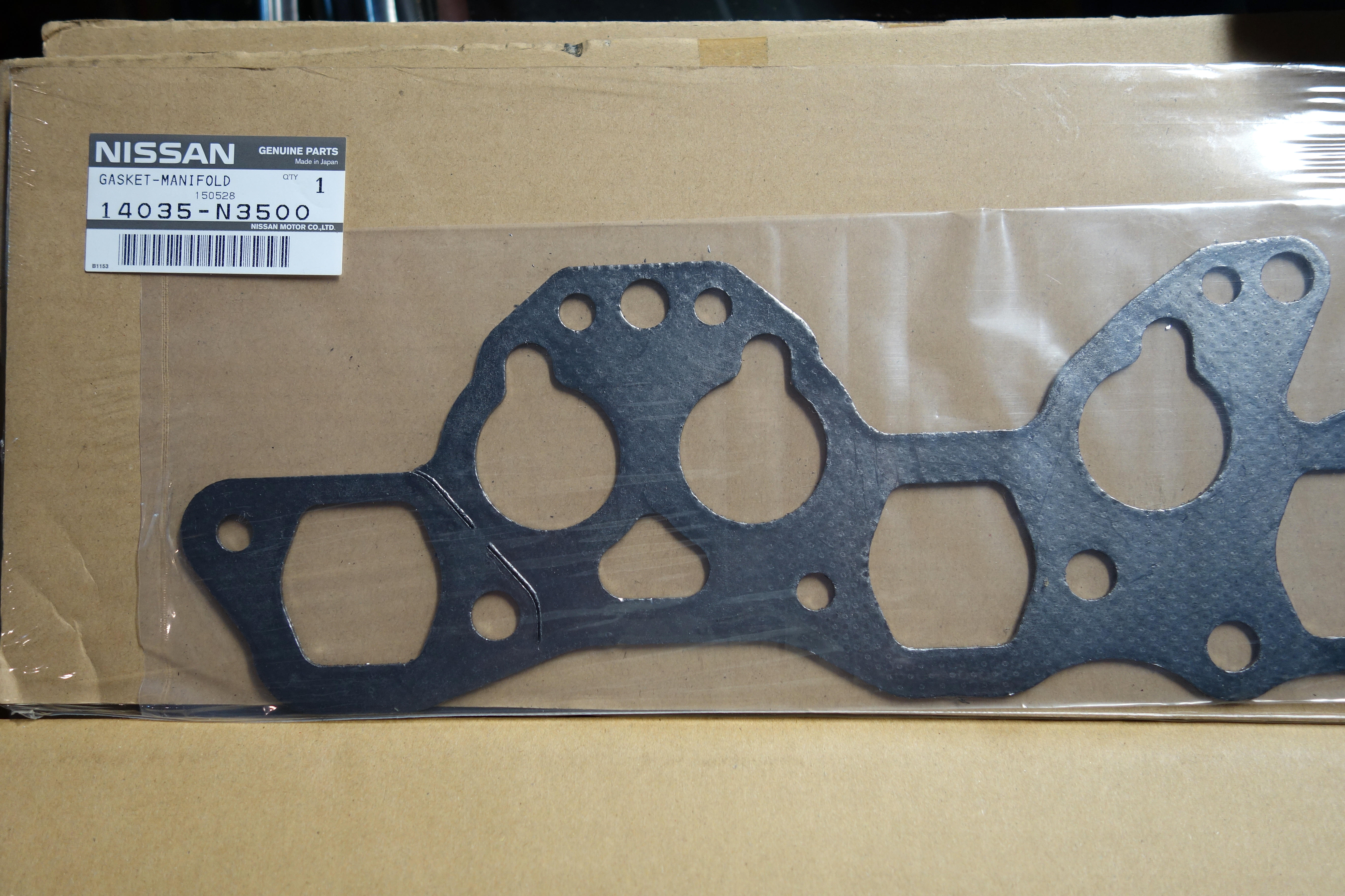

Wait for stupidy....
Nice gwri8! ......hmm....nice gwrli8..... Anyway, that's cool, that gasket looks just like the Mahle. I'm pretty sure Nissan can't be wrong on this, so thanks for including the part number. I think this solves my problem, this is what I was looking for. I will either go with Mahle or Datsun! Either way I think it will work, thanks guys for your help.
Yes. That is the Mahle gasket number. Very impressed with quality. As good or better than the Nissan factory gasket IMHO.  It has a really nice coating that seems to be self sealing. Some sort of synthetic.
Mahle was a lot cheaper than Nissan as well. At least from Canadian Dealers and I get employee discounts still... LOL
The Nissan 14035-N3500 is the latest supersession and basically replaces everything else for an EFI gasket. I got the last 14035-P7100 gasket in Canada a while ago  ( Round exh port N47/P79  gasket ) . That had metal plate on the exhaust side and was really nice.
