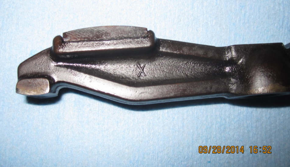

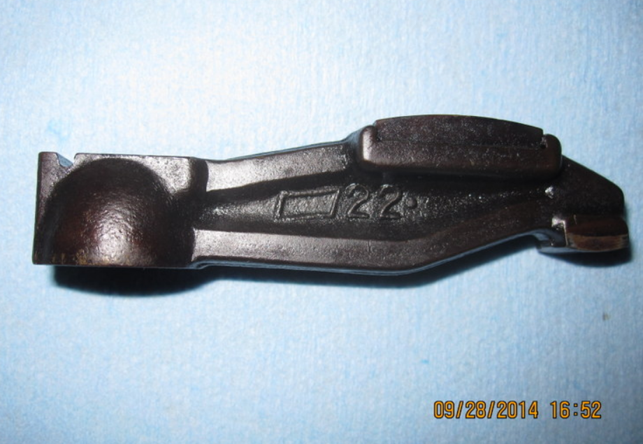

Here's one.
Edited by Zed Head
After going through a couple hundred, there are only two types of markings. The ones with the Trapezoid always have a single letter on the opposite side, and a variety of numbers and dots next to the trapezoid.
The ones that start with S have NOTHING on the other side.
I can't see any structural or size differences between the two types other than the markings.
Given all the stock engines I've harvested them from, I guessing they are ALL Nissan rockers. Not exactly a statistically rigorous study, but a decent sample size.

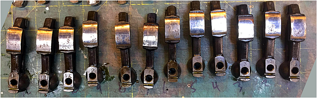

Delta Cam's is a wonderful business.
Ignoring the fact that postal service delivery took 20 days to get there and back, they turned around 132 rocker regrinds in 48 hours (once they got there...)
Every one looks like the 12 randomly selected rockers below.
They look like they have some kind of coating on them, applied everywhere. Hardening process or the result of a polishing or tumbling step to make them look pretty? I suppose I could just ask...
