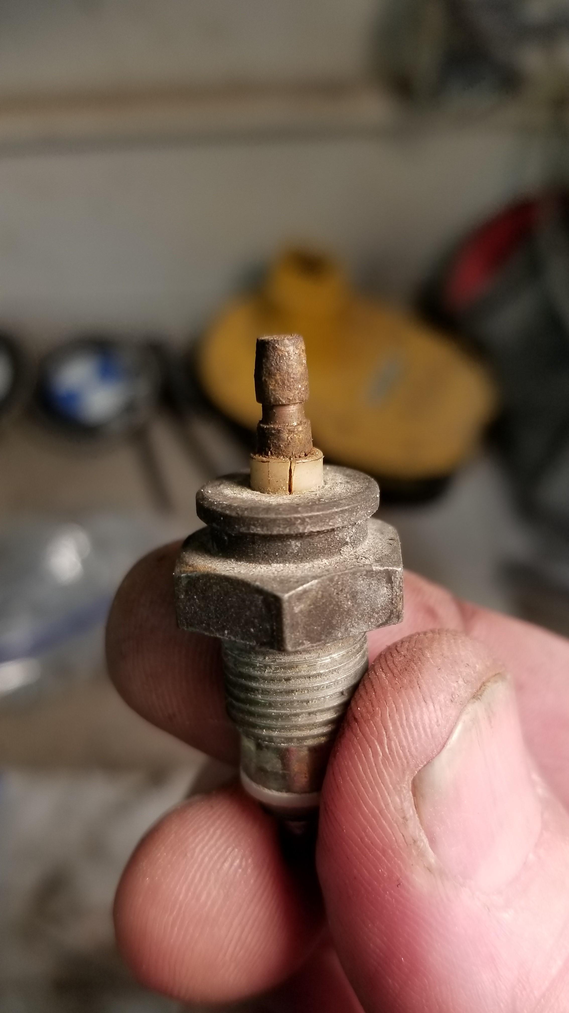

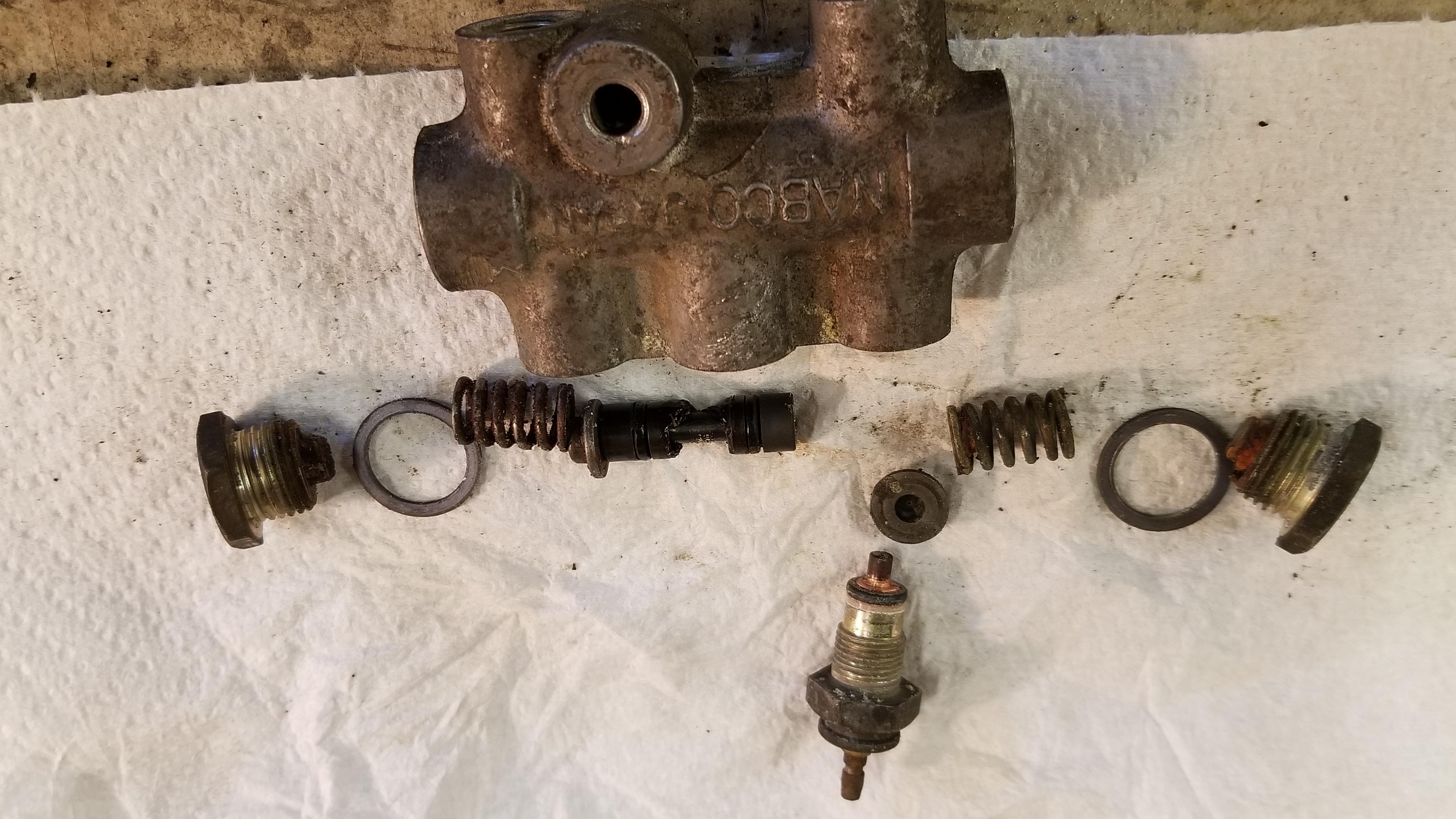

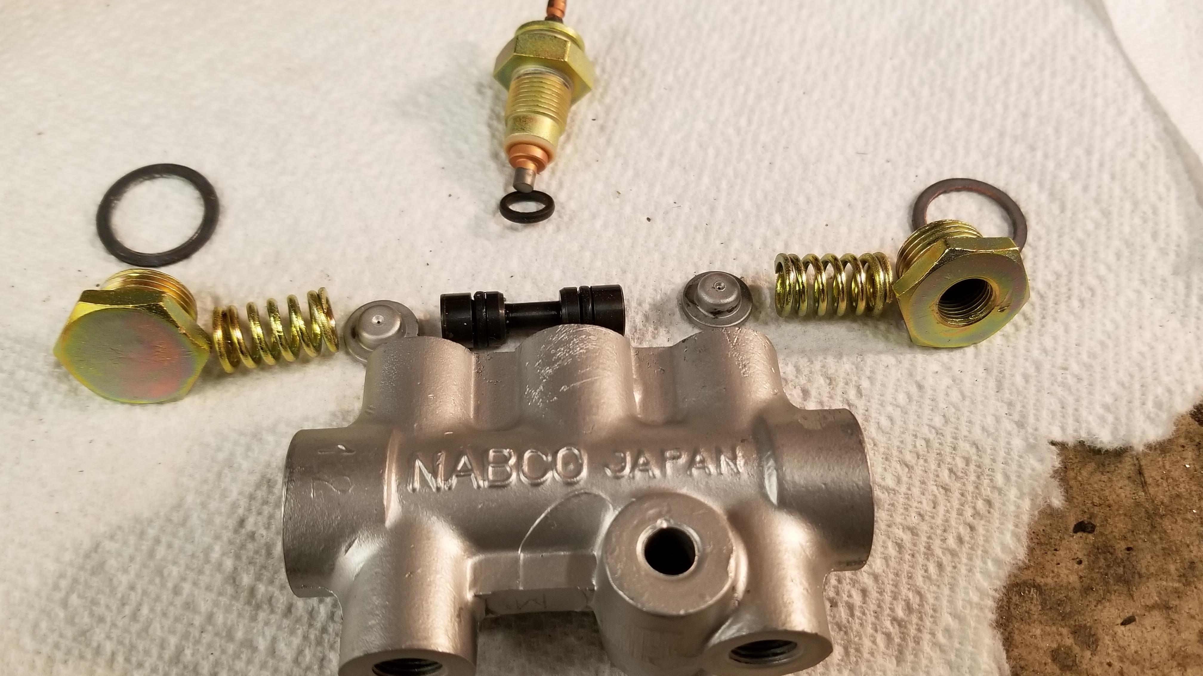

October 21, 20186 yr comment_560027 I apologize for the orientation but it displays properly until I download it This is the switch disassembled. The part at the bottom of this photo has the bullet connector on it. The center copper electrode is isolated from the outside shell with a plastic sleeve Like this You can see the bottom of the sleeve in this picture. If you have continuity from the bullet connector to the hex head on the sensor then there is corrosion bridging over it or there is a crack that has formed in the isolating sleeve. Like cgsheen1 said you will need a new switch if this is the case. This switch is NLA! You would have to find a suitable replacement and it might need cleaning internally. This switch was never supposed to be serviced, so extra caution is required. It is difficult to get it disassembled and reassembled correctly Link to comment https://www.classiczcars.com/forums/topic/60847-e-brake-light-dim-on-speedometer/?&page=3#findComment-560027 Share on other sites More sharing options...

October 22, 20186 yr Author comment_560107 On 10/21/2018 at 4:33 PM, Patcon said: I apologize for the orientation but it displays properly until I download it This is the switch disassembled. The part at the bottom of this photo has the bullet connector on it. The center copper electrode is isolated from the outside shell with a plastic sleeve Like this You can see the bottom of the sleeve in this picture. If you have continuity from the bullet connector to the hex head on the sensor then there is corrosion bridging over it or there is a crack that has formed in the isolating sleeve. Like cgsheen1 said you will need a new switch if this is the case. This switch is NLA! You would have to find a suitable replacement and it might need cleaning internally. This switch was never supposed to be serviced, so extra caution is required. It is difficult to get it disassembled and reassembled correctly Yes i guess its better not to mess with it. I was thinking of removing that hex nut and cleaning the innards but it i need to pull all the proportionate valve out from the car hen its risky business. Link to comment https://www.classiczcars.com/forums/topic/60847-e-brake-light-dim-on-speedometer/?&page=3#findComment-560107 Share on other sites More sharing options...
October 22, 20186 yr comment_560108 4 minutes ago, jalexquijano said: Yes i guess its better not to mess with it. I was thinking of removing that hex nut and cleaning the innards but it i need to pull all the proportionate valve out from the car hen its risky business. To clean the switch it really has to be off the car. That means all the brakes would needed bleeding after that. You would also have to protect the paint on the frame rails. The brake fluid will remove it fairly quickly. You really can't clean it by just removing the sensor post. Link to comment https://www.classiczcars.com/forums/topic/60847-e-brake-light-dim-on-speedometer/?&page=3#findComment-560108 Share on other sites More sharing options...
