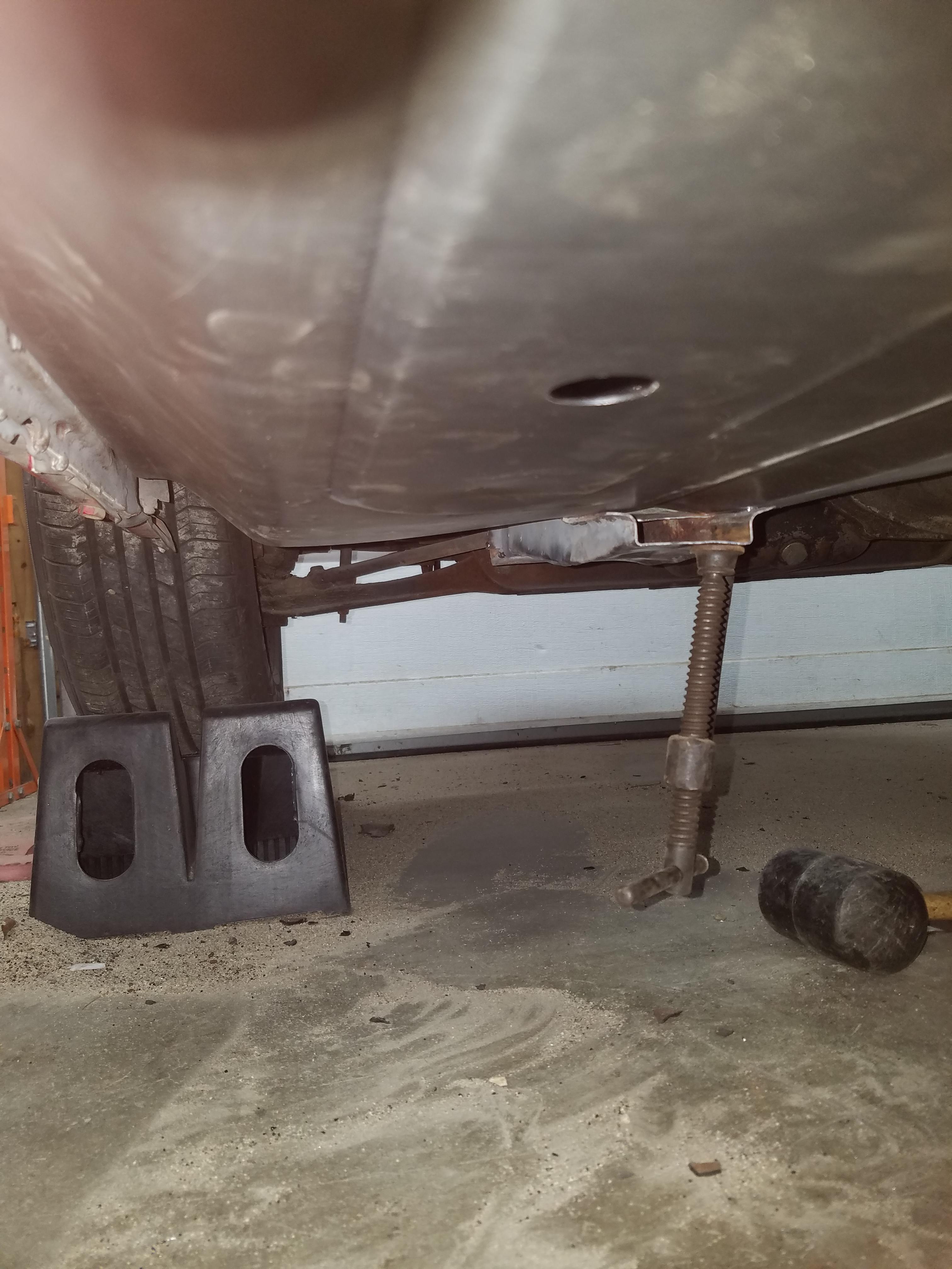

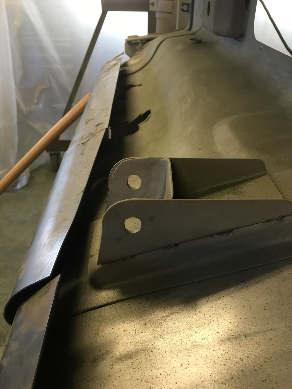

I've started my floor pan project and I have three questions about fit.  I have the Zedd Findings pans.
1.  It is doesn't fit around the tunnel where the transmission mount bracket is.  I beat it a bit with a hammer but I'm thinking I may need to cut a slot there.  Is this normal?

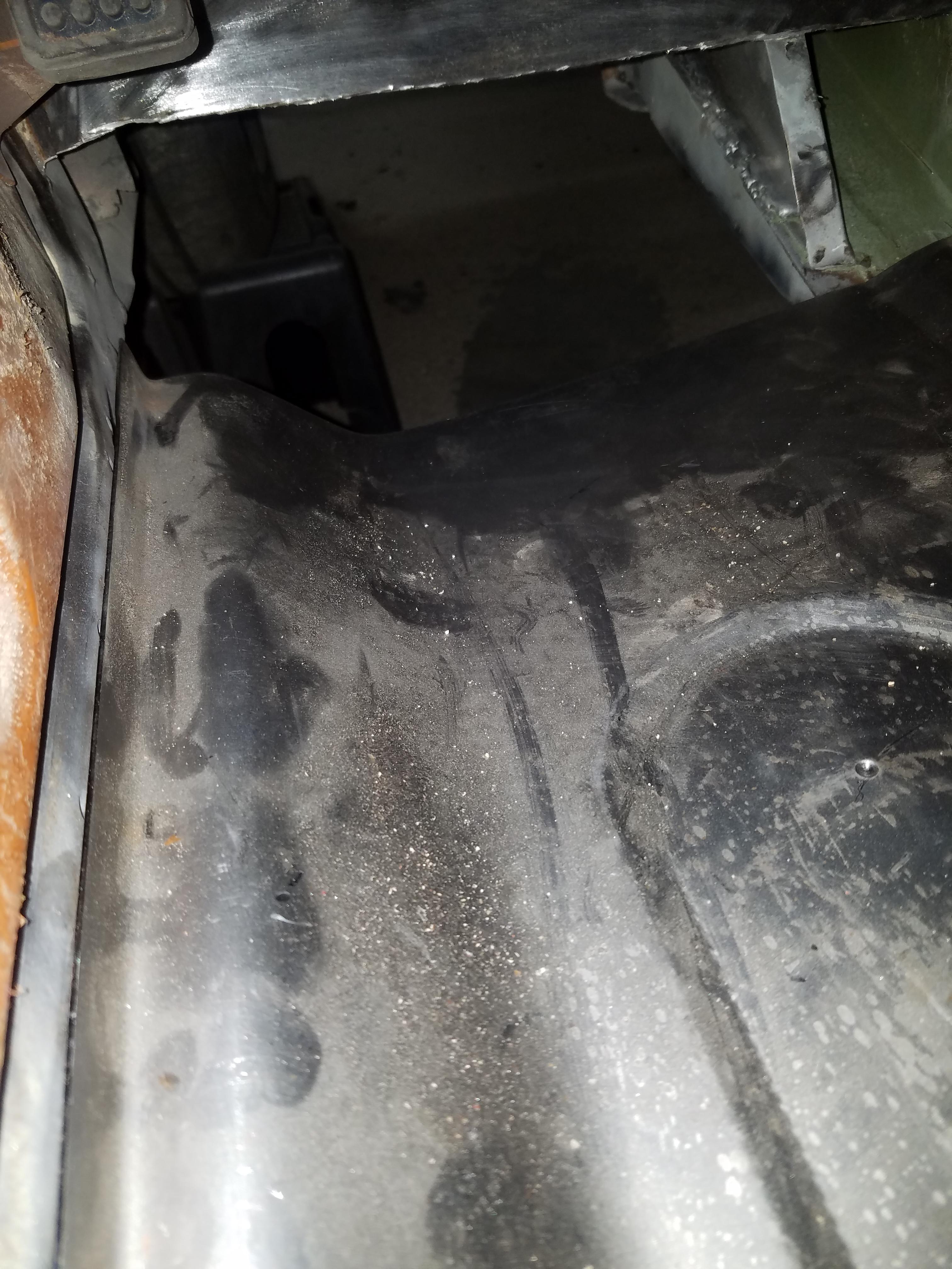

2.  It seems like the pan is not centered quite right.  If I have the outer lip (opposite tunnel) in the correct location the support rail "bump" in the pans is not centered with the existing rail.

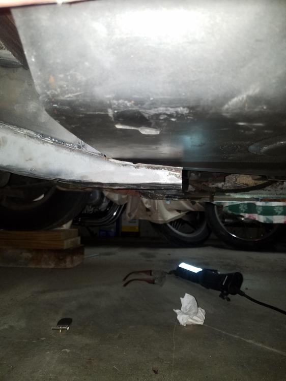

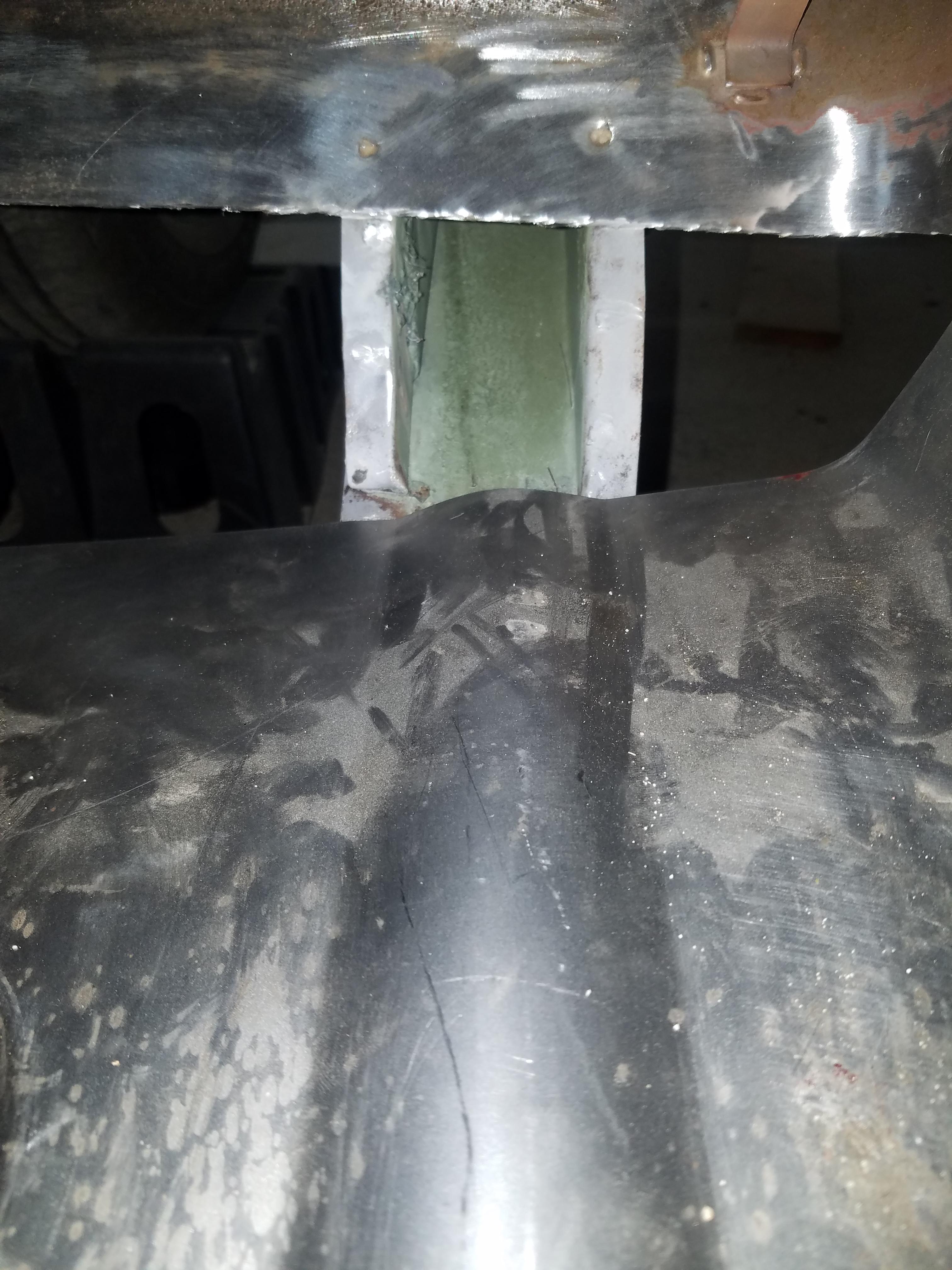

3.  I left about 3" of the old support rail.  It seems like the old pans may have been curved up at the front because only the front lip of the pan contacts the rail and there is big gap at the back.
I uploaded some pictures that show the rail issues.
Pan not centered
Curved floor pans?
Any thoughts would be appreciated!!

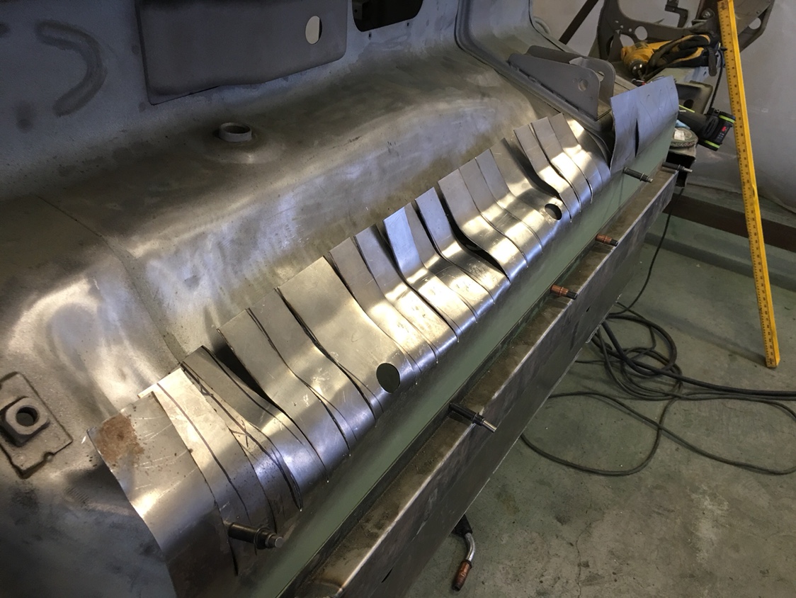

I just did a 280 passenger pan and I agree It was a general shape of the original floor but lots of cutting trimming bending involved especially toward the firewall area
Looks like you have everything nicely prepped, after you get the pan roughly shaped and placed you can start with the rocker side of the pan and run a couple of zip screws or clecos to hold it, then 1 on the back lip. At the front where you left 3" of the existing support rail you want to force the new pan down into that curve and secure that with a couple of zip screws until you start welding. The position of the pan may change so don't tack weld anything, any holes from the screws can be welded up at the last step.
Now comes the fun part, matching the new pan up to the trans tunnel, there a couple of ways to do it but I like to start in the center close to where the front of the seat would be and secure that with a zip screw then cut relief lines in the pan as you need them to get the pan to lay against the tunnel.  Much twisting and bending of the pan and some stretching of the tunnel will get you there.
If you are lapping the weld joint try and get the lap down to a 1/4" to 1/2", if butt welding leave your lap nice and wide so you can slice down the center of it, try and find the thinnest cutoff wheel you can for that cut, trying to butt weld over a large gap is so frustrating.

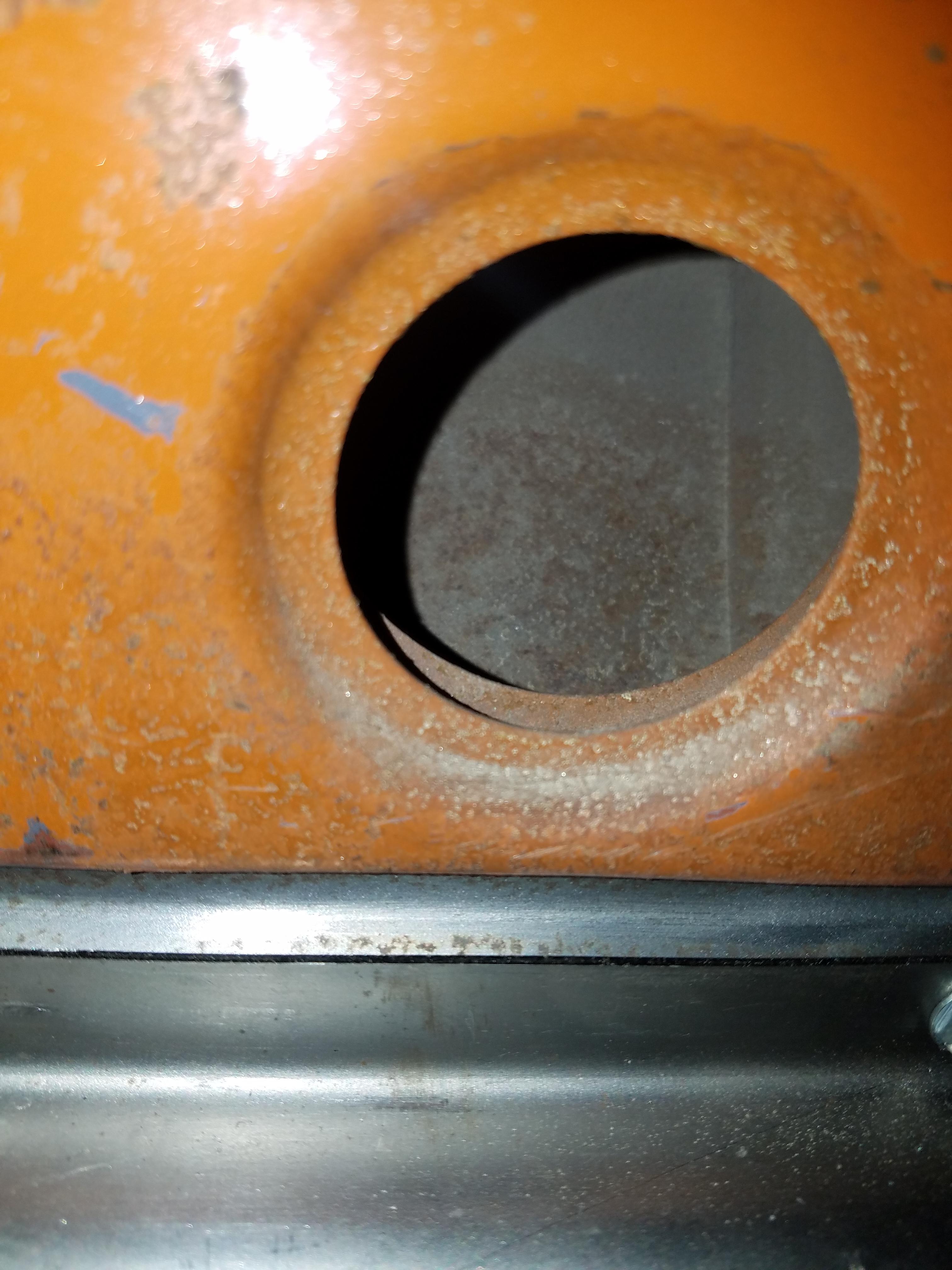

Thanks for all the tips.  The one thing that stalled me the most today was the fact that it seems like the pan was made to "low".  If I line the top of the pan's rocker flange with the top of the original weld surface then the bottom of the pan is about 3/8 of an inch below where the rail is and then the pan has to bend up to reach the rail. I'm compensating by cheating the flange up about 1/4".  It bugs me because it doesn't seem correct.
Flange part way up "C" channel on rocker
Bottom of rocker side of the pan is part way up the original weld surface but yet the pan has to bend up to get to the rail.  Is this normal?
The pan incorporates an amount of extra material around the edges for you to blend in the panel. You will need to find the best overall fit for the pan, then fabricate whatever you need to make it work.
I made corners and sections as needed.
