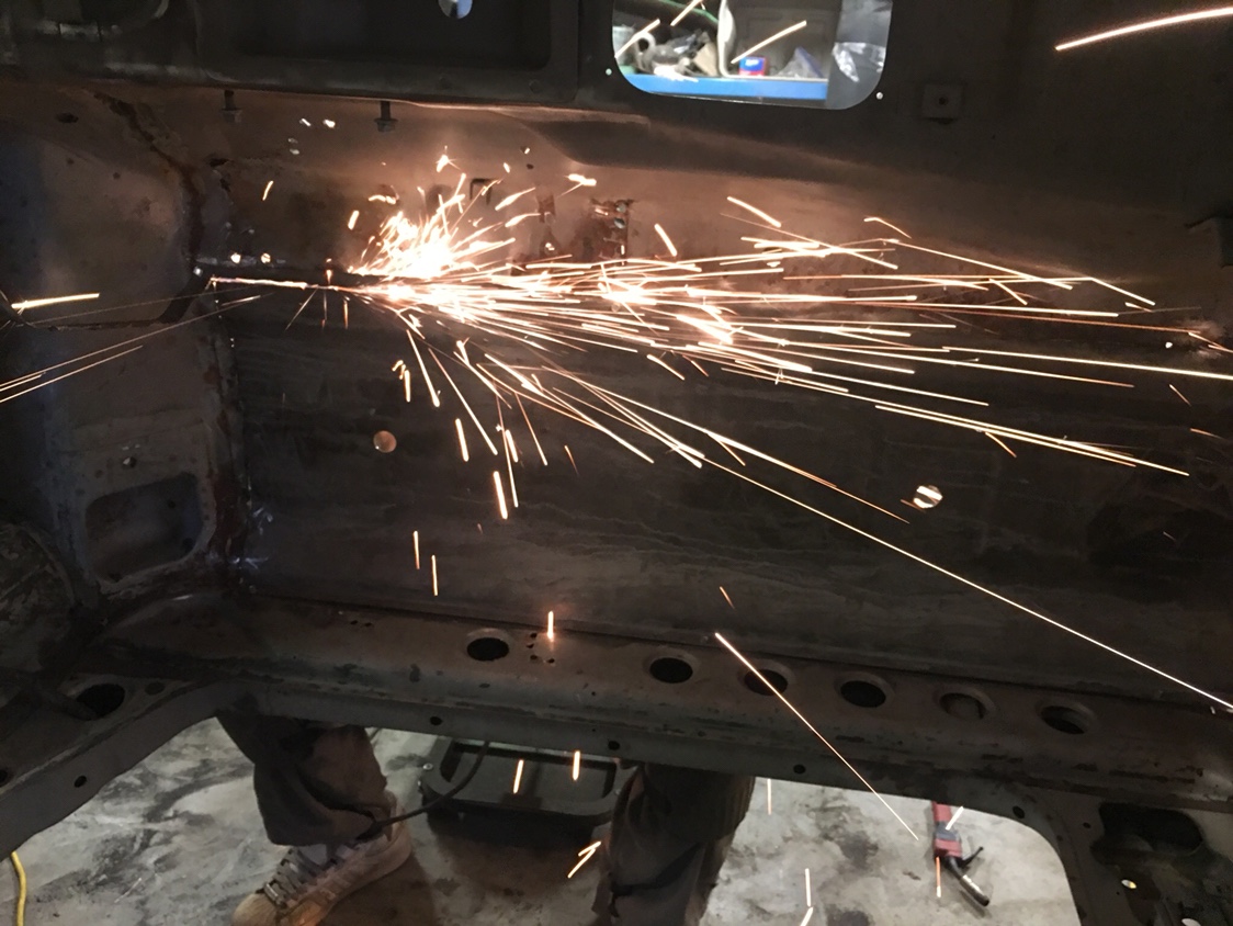

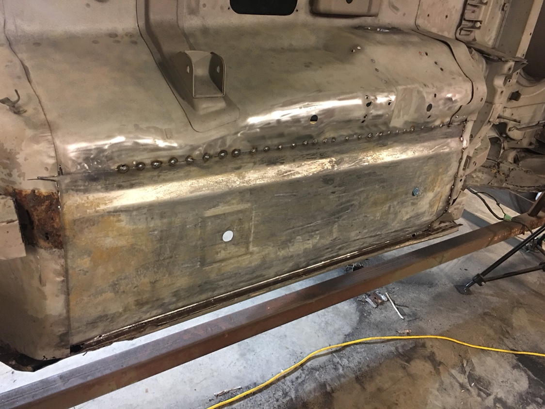

December 17, 20186 yr comment_563902 This is why butt welding gets tricky. Unless things are lined up perfect you can find yourself patching in gaps . I would recommend Cleco’s - you’ll wonder how you did without them. I learned my lesson with these panels - only cut off what’s bad on the original panels. Removing all of the old panel all the way to the inner rocker panel is usually not necessary , usually not much rust all the way up there anyway. I didn’t hardly catch this issue when I did mine. It made the floor slightly off level Link to comment https://www.classiczcars.com/forums/topic/60899-240z-floor-pan-replacement-question/?&page=2#findComment-563902 Share on other sites More sharing options...

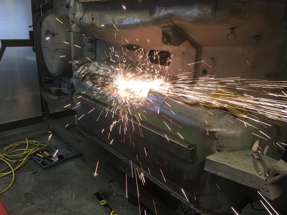

December 17, 20186 yr comment_563935 Cleco’s are a great way to get things lined up before cutting thru for the butt weld. The zip disc leaves a nice 1/16” gap to weld into. On the passenger side I only used 3/4 of the floor pan and kept the tunnel curve section as it was good. Link to comment https://www.classiczcars.com/forums/topic/60899-240z-floor-pan-replacement-question/?&page=2#findComment-563935 Share on other sites More sharing options...

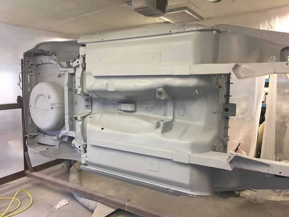

December 18, 20186 yr Author comment_563953 Is the general thought to get the pans in then fab and install the firewall patch panels or the other way around? Link to comment https://www.classiczcars.com/forums/topic/60899-240z-floor-pan-replacement-question/?&page=2#findComment-563953 Share on other sites More sharing options...
December 18, 20186 yr comment_563968 Pans first, firewall patch second, that allows you to match it perfectly and make it original. Link to comment https://www.classiczcars.com/forums/topic/60899-240z-floor-pan-replacement-question/?&page=2#findComment-563968 Share on other sites More sharing options...
December 18, 20186 yr comment_563971 When you’re done it looks like new! Link to comment https://www.classiczcars.com/forums/topic/60899-240z-floor-pan-replacement-question/?&page=2#findComment-563971 Share on other sites More sharing options...

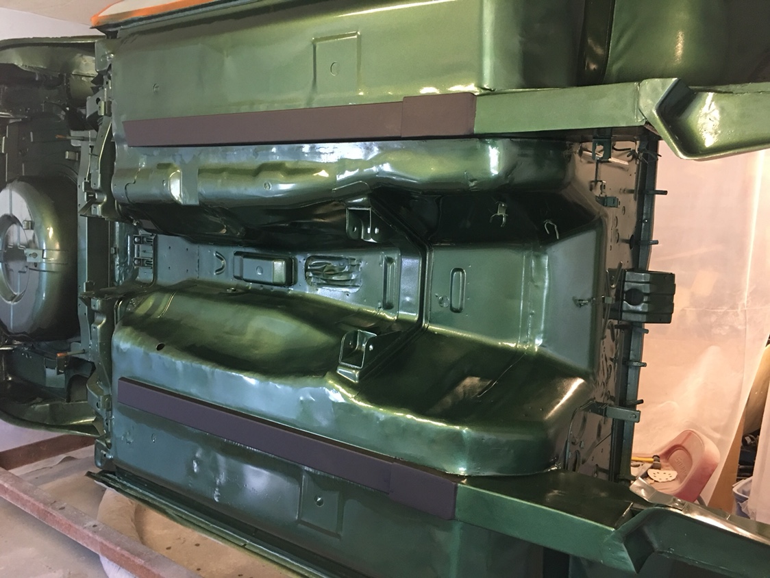

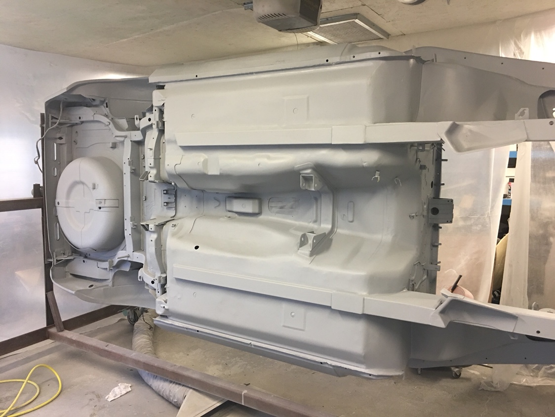

December 18, 20186 yr comment_564029 6 hours ago, Zaspen said: I hope mine looks that good! He illustrated the technique well. Copy what he did. Take you time. Get some dollies and hammers, cheap ones will work. With a good welder you'll be fine. ? Link to comment https://www.classiczcars.com/forums/topic/60899-240z-floor-pan-replacement-question/?&page=2#findComment-564029 Share on other sites More sharing options...

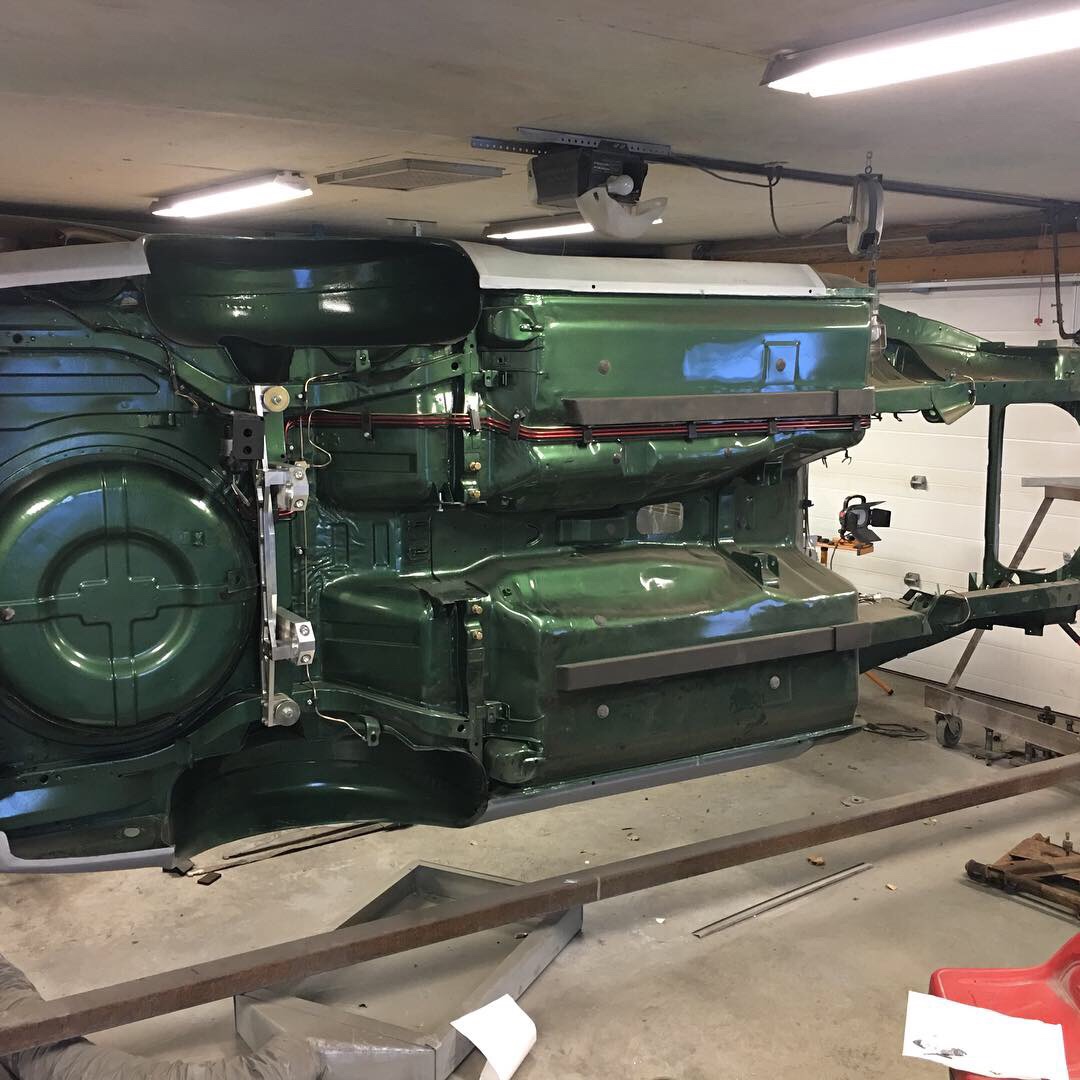

December 19, 20186 yr comment_564046 8 hours ago, Zaspen said: I hope mine looks that good! Wait to you see that same photo with all the gas lines installed, very sharp. Mark, that's your cue? Link to comment https://www.classiczcars.com/forums/topic/60899-240z-floor-pan-replacement-question/?&page=2#findComment-564046 Share on other sites More sharing options...
December 19, 20186 yr comment_564049 As requested... Link to comment https://www.classiczcars.com/forums/topic/60899-240z-floor-pan-replacement-question/?&page=2#findComment-564049 Share on other sites More sharing options...
December 19, 20186 yr comment_564052 Bottom porn. Link to comment https://www.classiczcars.com/forums/topic/60899-240z-floor-pan-replacement-question/?&page=2#findComment-564052 Share on other sites More sharing options...
