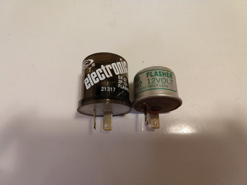

But we finished a few small things here and there while the weather was nice. Replaced the broken pin in the connector and swapped in electronic flasher relays, so it now has properly working turn signals - no more super fast flashing. Hazards aren't working, so my guess is the switch needs some cleaning or replacement. The driver's side headlight also (finally) died while testing various lighting functions. I noticed the wiring to it was pretty bad and it's not a surprise since someone swapped in H4 housings at some point. So that will also need attention later.
New vs Old: You could really tell the difference between the hefty electronic relay and the feather-light thermal relay.

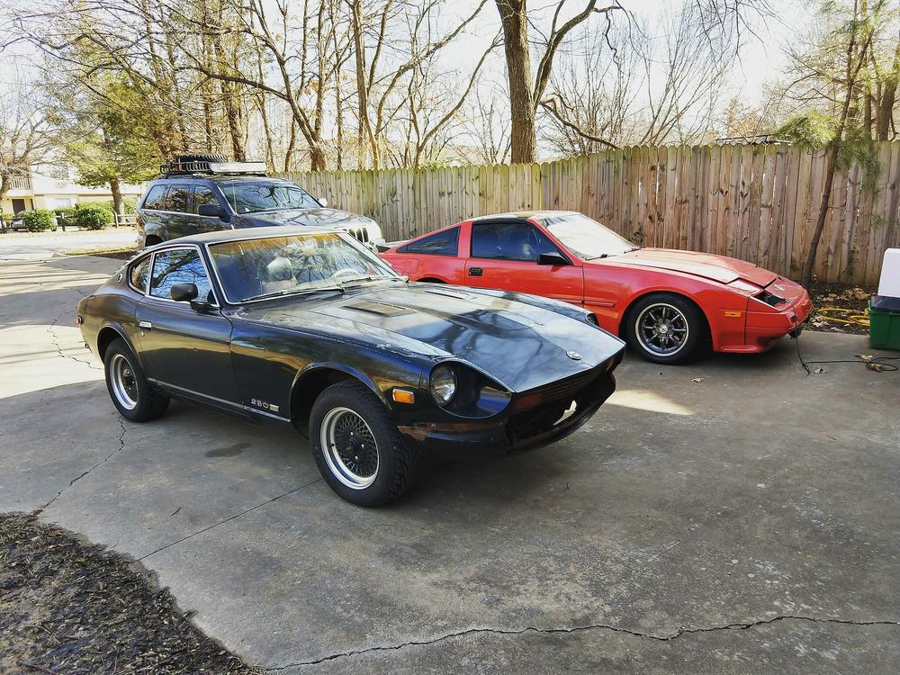

No progress on the S30. But we finally got a warmer, dry, and sunny(!) weekend to get some work done on one of the daily cars. So the Z cars got a bit of sun.
I'm sure you can tell which one didn't want to start. Lol. I guess it has been a few months since it was last started. I also have a hunch that someone left the hood popped after showing off the engine bay a few weeks ago. <_<LOL

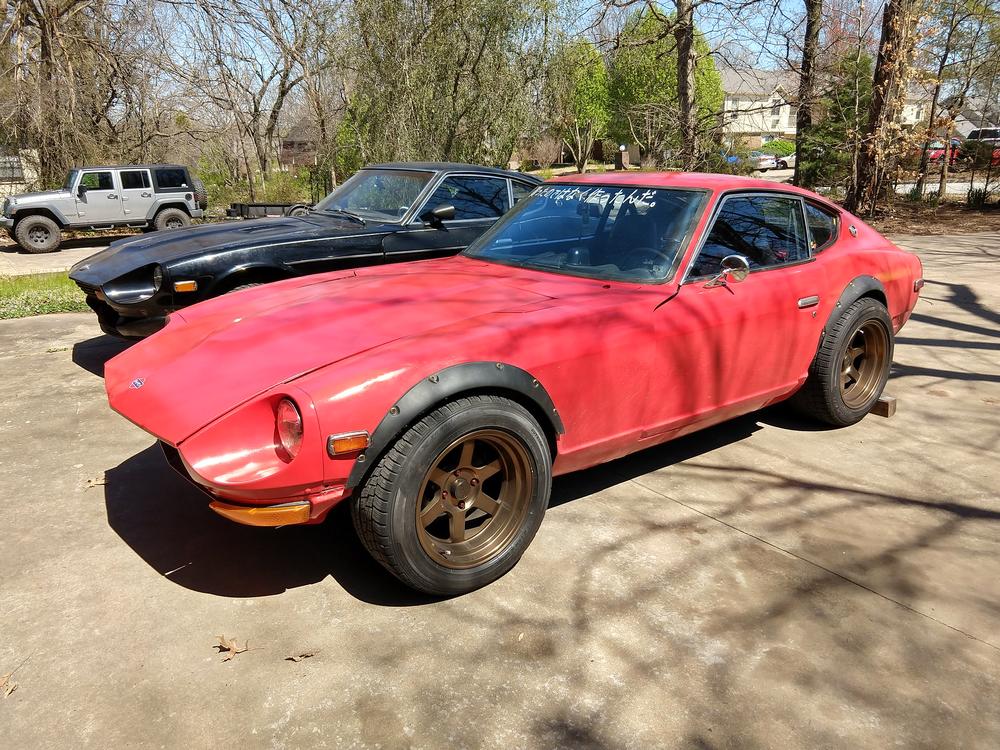

No mechanical updates. Life and work have been busy with other projects unfortunately. We're currently replacing the top boards on our deck: exciting... LOL
I recently got involved in the growing local z car club so we hosted the year's first "tech day" at our place. Got to see a few other S30s up close and get some ideas for our own.
