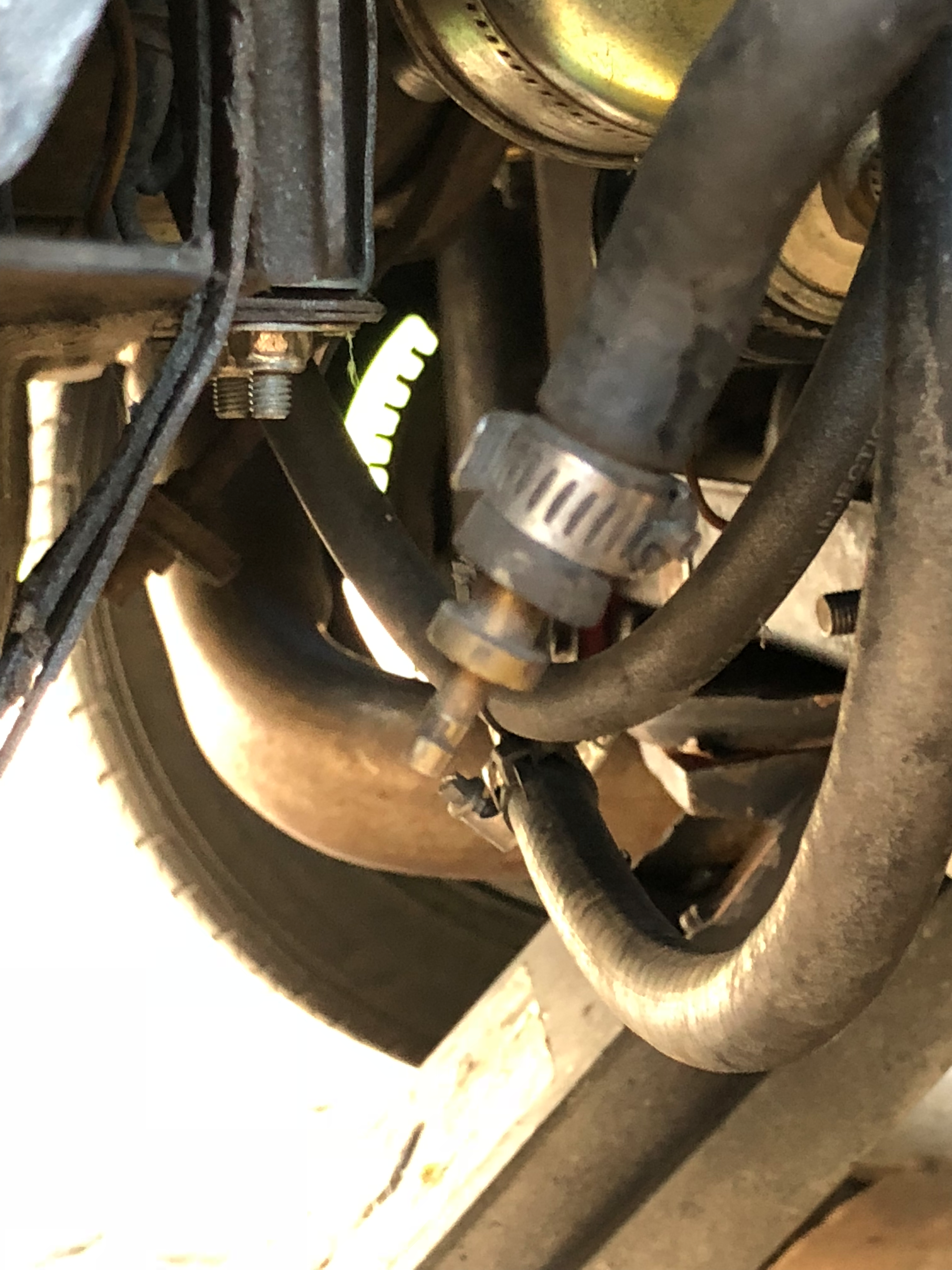

while i was down there i noticed this unattached line that connects to the top of the reservoir...any clues as to where this should connect to or is it supposed to be free falling?
IMG_7630.HEIC
been looking for the other side but cant find anything that would attach based on the length of the line....it smells like gas and I traced it back to the reservoir.   It from the the top left of the reservoir if you were looking at it from inside the car.  Let me check again but there was nothing else .
