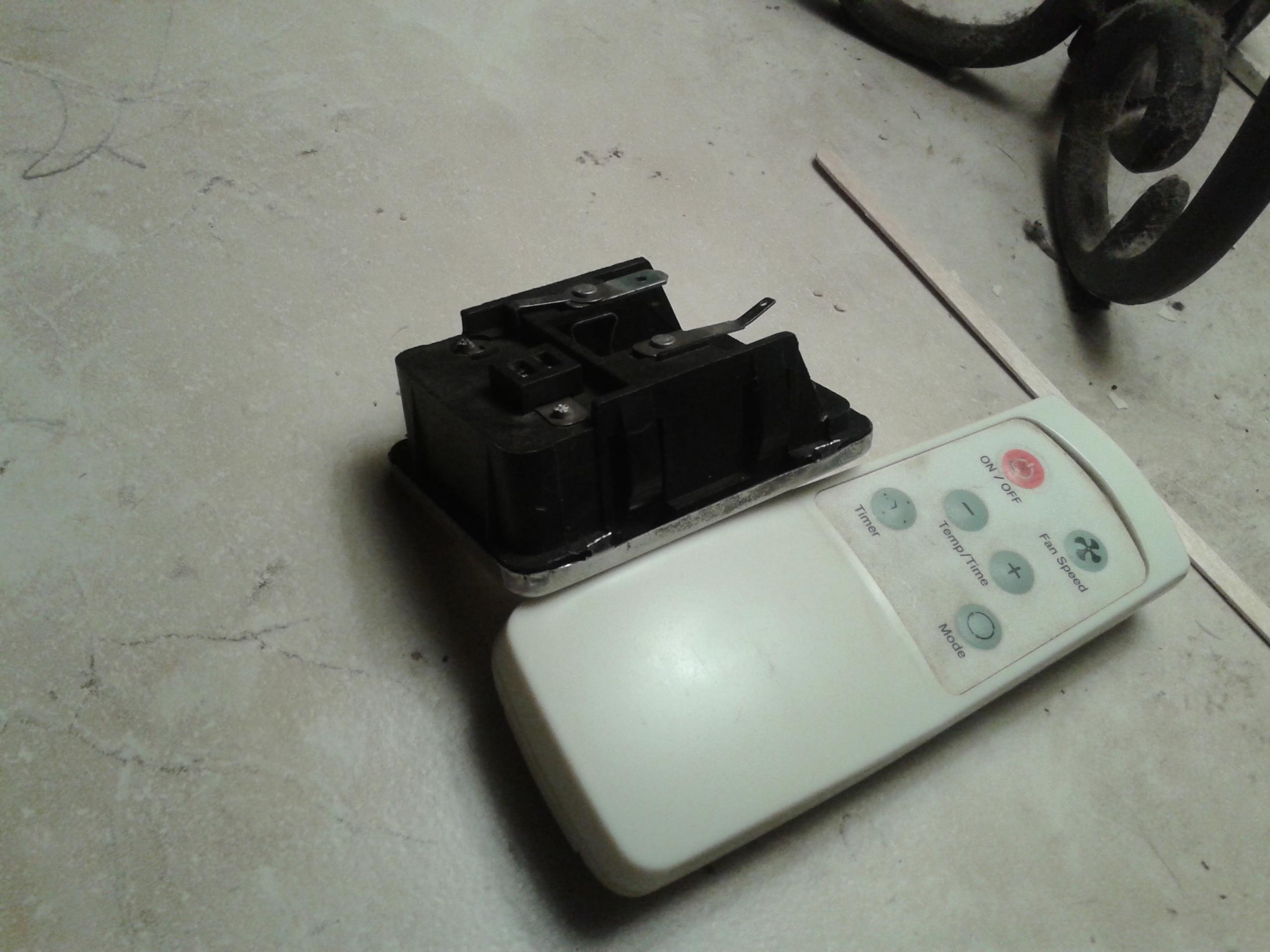

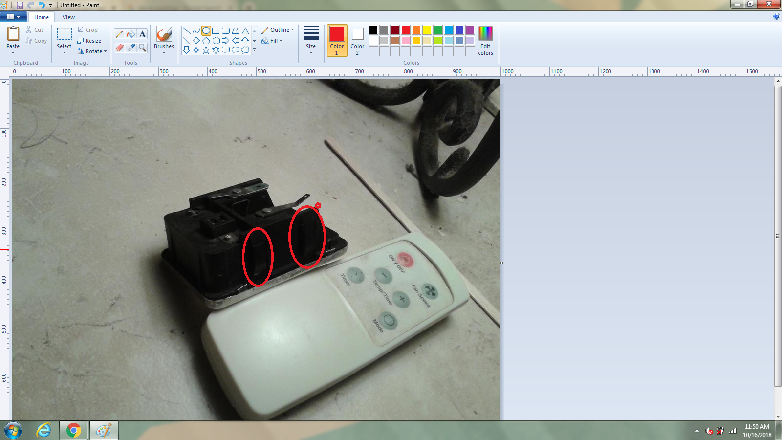

October 16, 20186 yr comment_559700 It's a little nerve racking but it's the only way I found too. There's four tabs two each side. I think I used small screwdrivers and got one side down at time. Edited October 16, 20186 yr by siteunseen Link to comment https://www.classiczcars.com/forums/topic/60939-how-to-change-interior-overhead-light-bulb/#findComment-559700 Share on other sites More sharing options...
