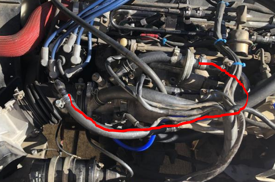

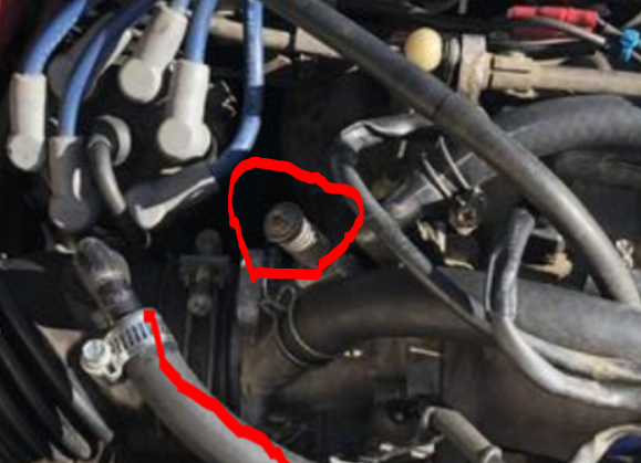

November 11, 20186 yr Author comment_561406 The alternator is actually brand new. I wonder if the belt could be slipping? It does squeak. Only when cold though. Im just looking for problems to all connect here because she runs like a champ once warm. Heres an engine bay photo then a close up of throttle body section. My AAR is missing the screws but that shouldn’t affect it. Previous owner lost a lottt of screws ? Edited November 11, 20186 yr by Pochie45566 Link to comment https://www.classiczcars.com/forums/topic/60983-rough-idle-when-cold-running-rich/?&page=2#findComment-561406 Share on other sites More sharing options...
November 11, 20186 yr comment_561407 does the AFM have the rubber plug still in it. the plug that covers the idle bypass air? Link to comment https://www.classiczcars.com/forums/topic/60983-rough-idle-when-cold-running-rich/?&page=2#findComment-561407 Share on other sites More sharing options...
November 11, 20186 yr comment_561408 Hard to tell. I marked up a picture of where the hose should be, below. You could disconnect it and block the hose ends. Or just clamp it with some vise grips. If it does the the same thing then it's not having an effect. You voltmeter is probably jumping around because the idle is so low. The alternator needs a certain RPM level to create more voltage than the battery. You're seeing it go from battery to alternator as the idle goes up and down. What happens to idle speed if you loosen the filler cap, and remove it? The engine should die. If it doesn't then somebody has been tuning around a big vacuum leak. Not uncommon. Link to comment https://www.classiczcars.com/forums/topic/60983-rough-idle-when-cold-running-rich/?&page=2#findComment-561408 Share on other sites More sharing options...

November 11, 20186 yr comment_561411 13 minutes ago, Pochie45566 said: When removed the engine gets close to dying but doesn’t. It bogs down pretty good though. Mine dies immediately. You might have a leak, and somebody has adjusted the AFM to work around it. Here's another simple quick test - with the engine warmed up turn the idle speed adjustment screw all the way in. The engine should die. If it doesn't there's a vacuum leak somewhere. Here's the screw. Turn it clockwise until it's closed. Link to comment https://www.classiczcars.com/forums/topic/60983-rough-idle-when-cold-running-rich/?&page=2#findComment-561411 Share on other sites More sharing options...
November 11, 20186 yr Author comment_561413 Ok well, it doesn’t die when I take the oil cap off or turn the idle screw in. i do have a small exhaust leak at the manifold. I notice a broken stud up there also. I’ll investigate for vacuum leaks up there. Also have an oil leak at the oil pan. could be sucking in air. Edited November 11, 20186 yr by Pochie45566 Link to comment https://www.classiczcars.com/forums/topic/60983-rough-idle-when-cold-running-rich/?&page=2#findComment-561413 Share on other sites More sharing options...
