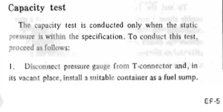

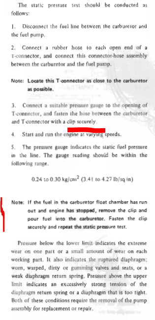

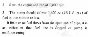

Zed Head - thanks for taking the time to post the test procedure.  Like you I thought that the fuel pump has some relief mechanism that would be triggered by sufficient back pressure and cause the pump to stop sucking gas from the tank.  I have been told that there is no distinct pressure relief. As I understand it when back pressure is higher than the 3-4 lbs the mechanical pump simply can't overcome the back pressure, but the pump continues to try to suck fuel into the rail; it just will not succeed until the back pressure is lower than the output of the pump.  The end of the return line continuously weeps fuel and if the pressure in the fuel rail decreases below 3-4 lbs then the mechanical pump can push more into the rail.
