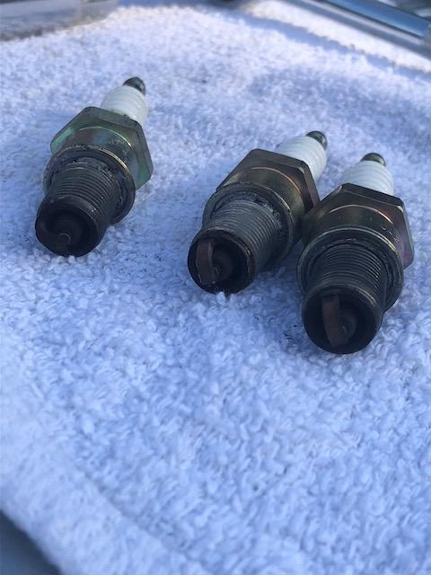

 Those plugs should be near white to a light tan if it was running with the choke off. I'm going to assume a few things like; there's a good hot spark at the plugs, compression is good, the ignition timing is OK. Let's start with the easy stuff. When the choke is operated, the cables pull the nozzles down in both carbs. The nozzles are known to occasionally stick in the down (choke) position when the choke knob is pushed forward (off). You can reach under the carbs and feel the nozzles come down with the help of a friend operating the choke knob. When the choke knob is pushed forward, manually push up the nozzles to see if they're sticking in the down position.

I agree. They look rich from possibly the choke cables aren't adjusted right.  Have you changed the length of the cable wires?  Maybe the hold down clamps have loosened resulting in the nozzles not pulling up completely.  I had one with stiff fuel line instead of the pliable hoses that kept mine from completely closing.

Do you have a points distributor? If so check dwell, condition of points cap and rotor. Also timing as above. Using premium gas right? Raising idle will usually make overrun worse. Car can't run right with fouled plugs. What carb needles? You need a synchrometer or flowmeter to do the carb tuneup per FSM or "quick and dirty" (or an expert's ear).

 In an attempt to consolidate the help in the previous threads, Ignore (for now) all advice that doesn't pertain to a complete tune-up. We need to eliminate all the gremlins that are eliminated in a tune-up before we can get into the finer points of the carbs. You may want to review Jalexquiano's threads titled "1972 float adjustment" and "Misfiring while cruising".
