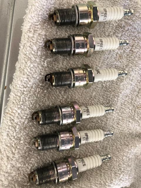

Put in new plugs, results in the picture below. Seems like we're doing better on the color when compared to before, cylinders 6-1 as you look top to bottom.
Good news is that the idle seems to be holding now after the continued carb tuning. I'll drive again this afternoon to confirm this is the case.

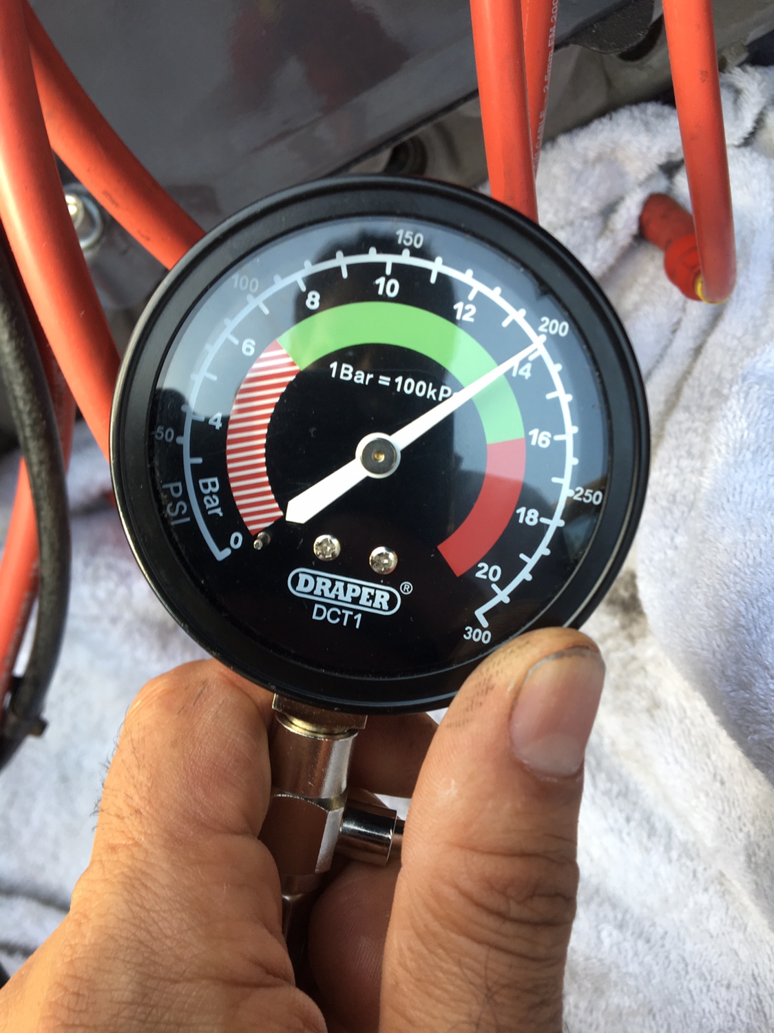

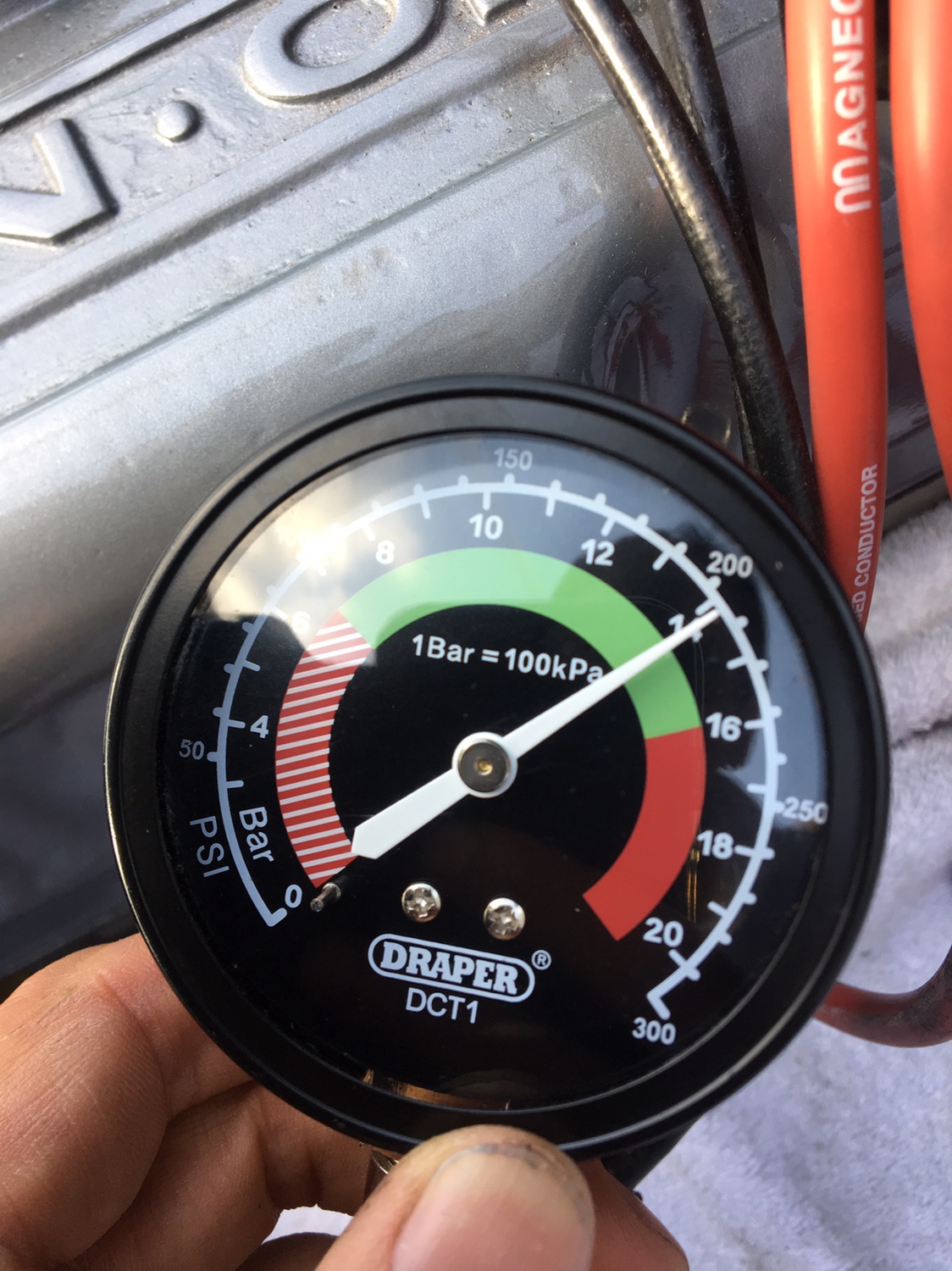

AK260, thanks for the support! Got back in the saddle today with new tool, and also increased starter time from 3-4 seconds per cylinder to ~10 seconds per cylinder to test. Here are the results:
  1. 110
  2. 125
  3. 160
  4. 155
  5. 140
  6. 160
So, feeling much better about things but still have something to investigate in cylinders 1 and 2. Any concern about cylinder 5?
