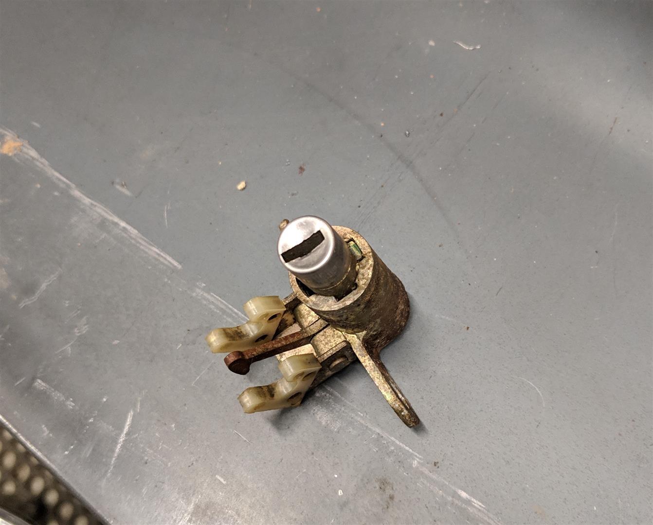

Posted November 20, 20186 yr comment_562023 Anyone know how to pick a glove box lock? I tried all my various Datsun keys and screw drivers to no avail. I ended up removing it but would like to get it unlocked so I can at least use it! I don't have the original keys as this came from a parts car I took apart. Link to comment https://www.classiczcars.com/forums/topic/61116-picking-a-glove-box-lock/ Share on other sites More sharing options...

November 21, 20186 yr Author comment_562142 The lock tumbler on the passenger door was rusted badly that I couldn't read the numbers and nothing in the glove box. I just want to get it unlocked so the glove box can be used then sell the dash. I don't want to really pay a locksmith and figured the lock would be like a "general" lock that about anything would unlock it but that's not the case or my lock picking skills are lacking! So I did take the dash out and remove the lock. Even with the dash out and glove box torn out it's a chore to get that lock out since it's locked to the glove box door. I'll give it another go when I find some more patience or someone with lock picking skills can tell us the method they used. Link to comment https://www.classiczcars.com/forums/topic/61116-picking-a-glove-box-lock/#findComment-562142 Share on other sites More sharing options...
